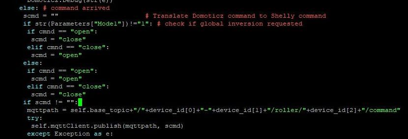

    After upgrading Domoticz to version 2022.2, there was a problem with the roller shutters that I think we all know.
    My roller shutters built on shelly 2.5 and controlled from domoticz via the Shelly_MQTT plugin.

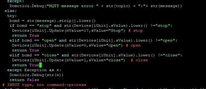

    I managed to get the roller shutters working by changes to the plugin in the plugin.py file
    Here are the changes made:
    Domoticz 2022.2: Inverted roller shutter state descriptions on Shelly 2.5 with the Shelly_MQTT plug-

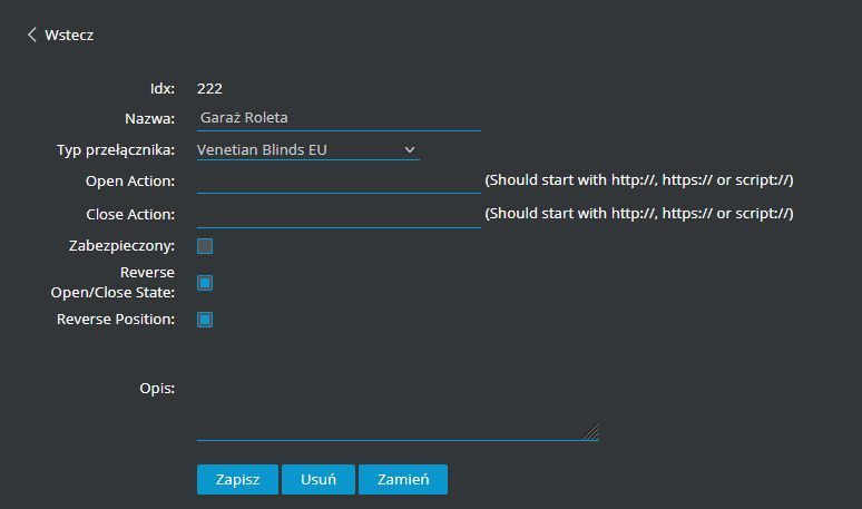

    For this, the corresponding position setting in the switch edit:

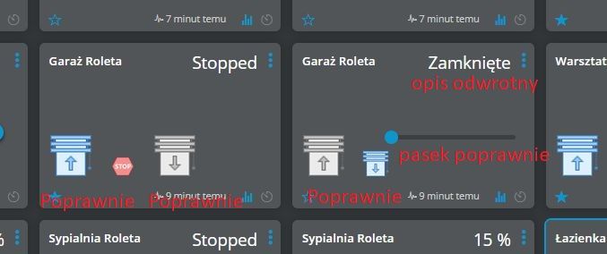

    The close/open buttons work correctly while the description is reversed if the roller shutter is open the description is that it is closed if the roller shutter is closed the description is that it is open as per the following description:
    Is it the same with you ? Or do you still change three things somewhere ?
