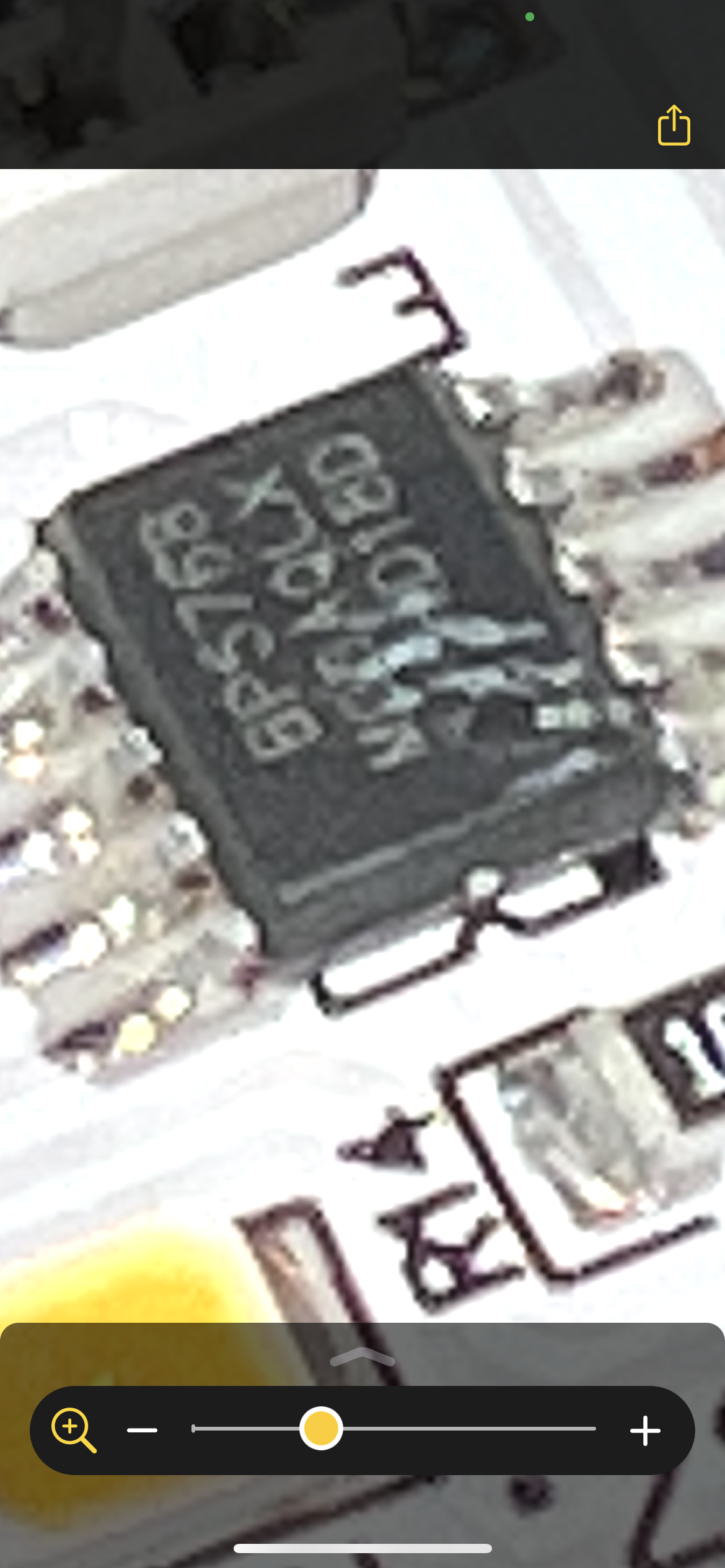

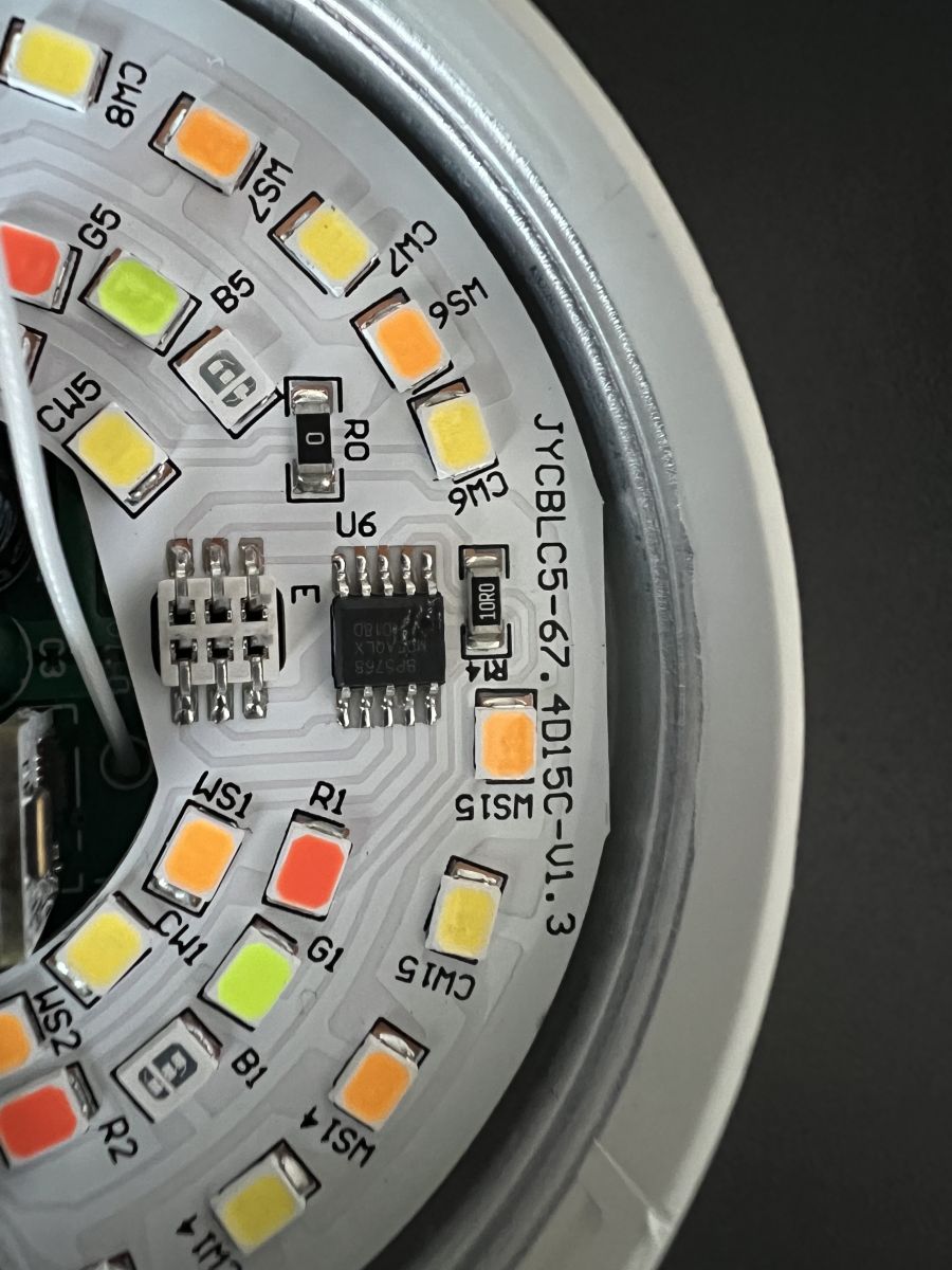

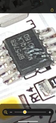

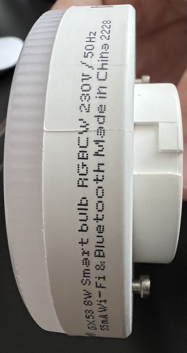

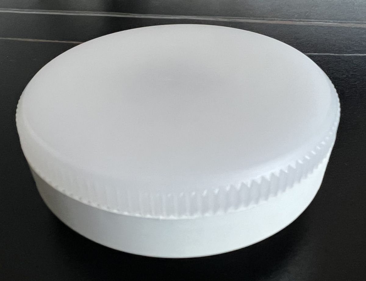

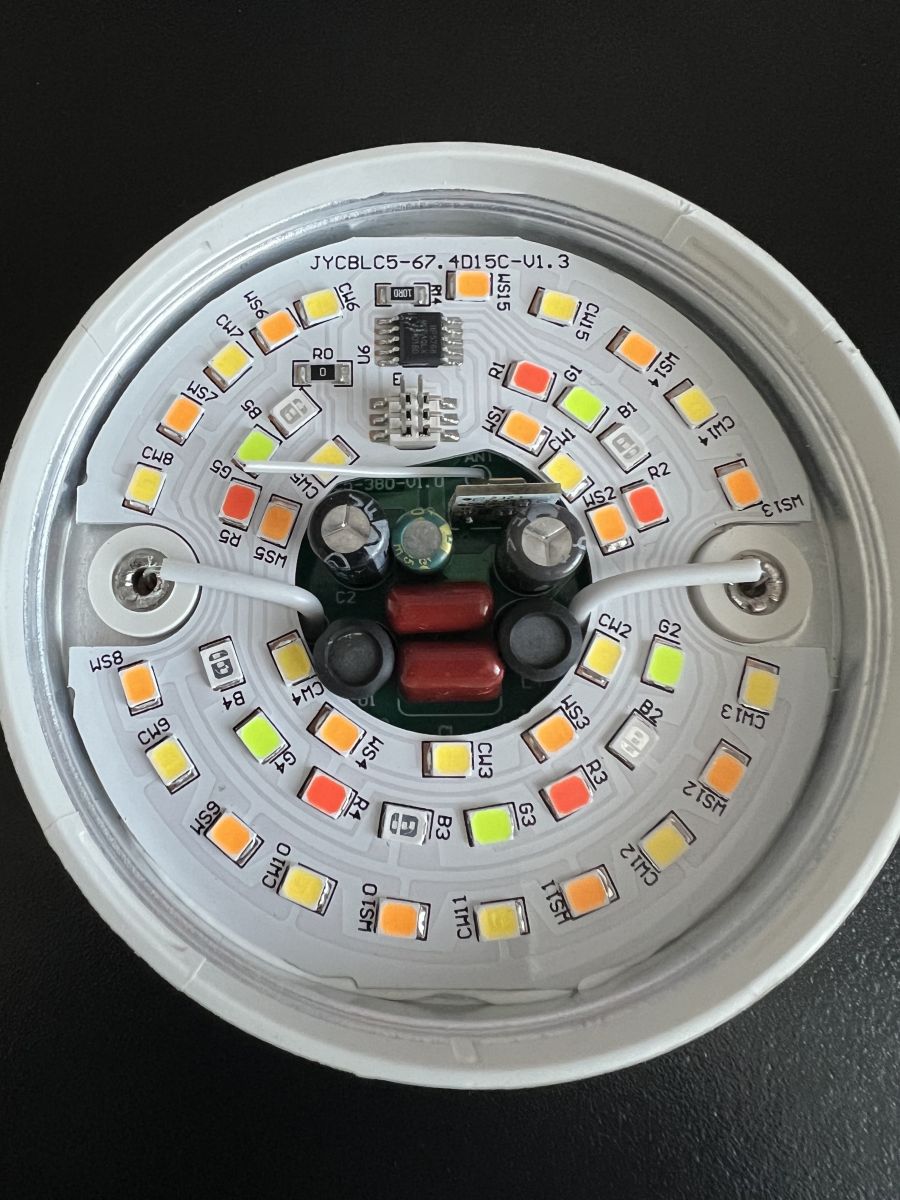

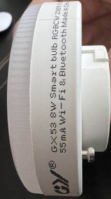

    I just did a teardown of these bulbs that are sold on Amazon:
    https://amzn.eu/d/fqGawlL
    They pair with Smart Life and Tuya app (it seems to pair with BLE for setting up WIFI network and then operate via WIFI.
    It has the annoying problem that after only three switch on/off it resets and loses settings.
    Here are the teardown pictures:
    Teardown and Analysis of GY GX53 Alexa 8W 600LM RGBCW Dimmable Bulb [BK7231N/BP5768]
    Teardown and Analysis of GY GX53 Alexa 8W 600LM RGBCW Dimmable Bulb [BK7231N/BP5768] Teardown and Analysis of GY GX53 Alexa 8W 600LM RGBCW Dimmable Bulb [BK7231N/BP5768] Teardown and Analysis of GY GX53 Alexa 8W 600LM RGBCW Dimmable Bulb [BK7231N/BP5768] Teardown and Analysis of GY GX53 Alexa 8W 600LM RGBCW Dimmable Bulb [BK7231N/BP5768] Teardown and Analysis of GY GX53 Alexa 8W 600LM RGBCW Dimmable Bulb [BK7231N/BP5768] Teardown and Analysis of GY GX53 Alexa 8W 600LM RGBCW Dimmable Bulb [BK7231N/BP5768] Teardown and Analysis of GY GX53 Alexa 8W 600LM RGBCW Dimmable Bulb [BK7231N/BP5768] Teardown and Analysis of GY GX53 Alexa 8W 600LM RGBCW Dimmable Bulb [BK7231N/BP5768]

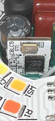

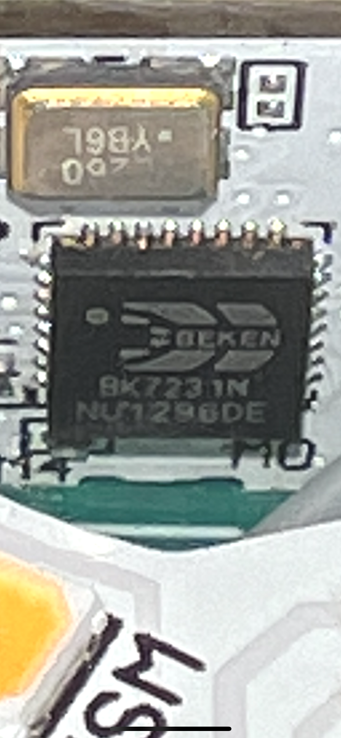

    Chipset is BK7231N - NU1296DE.
    Any chance to load custom firmware?
    Thank you
    Chris

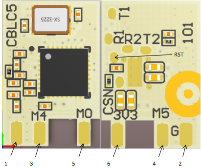

    Hello, no problems here, here is CBLC5 pinout:
    SymbolI/O typeFunction
    ANTOPad pin for the external antenna
    GNDPGround pin
    M4I/OSupport hardware PWM and correspond to PA 24 on the internal IC
    M5I/OSupport hardware PWM and correspond to PA 26 on the internal IC
    M0I/OSupport hardware PWM and correspond to PA 6 on the internal IC
    3V3PPower supply pin
    R2I/OUART2_RX, LOG RX, which corresponds to P1 on the internal IC
    T2I/OUART2_TX, LOG TX, which corresponds to P0 on the internal IC
    R1I/OUART1_RX, user serial interface RX, which corresponds to P10 on the internal IC
    T1I/OUART1_TX, user serial interface TX, which corresponds to P11 on the internal IC
    CSNIIf connected to the ground before powered on, enter the RF test mode. If not connected or connected to VCC before powered on, enter the firmware application mode.
    NoneIRST pin, which corresponds to CEN on the internal IC
    Procedure will be similar to the one here, but without desoldering the module:
    BP5768 is also supported in obk.
