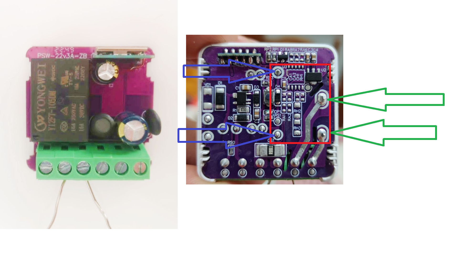

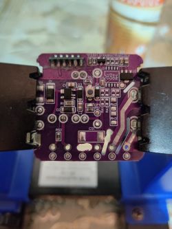

    Good evening, I have this Smart Switch Zigbee version, I hope I'm not off topic, I would like to ask if anyone has tried to modify it to have a clean contact at the output? How to modify smart switch into dry contact mode (detach mains from relay)
  • #2 20417791
    Posts: 14771
    Rate: 12914
    What do you mean by clean contact? A relay contact that is separated from mains voltage?

  • #5 20418521
    quasar87
    Level 4  
    Posts: 8

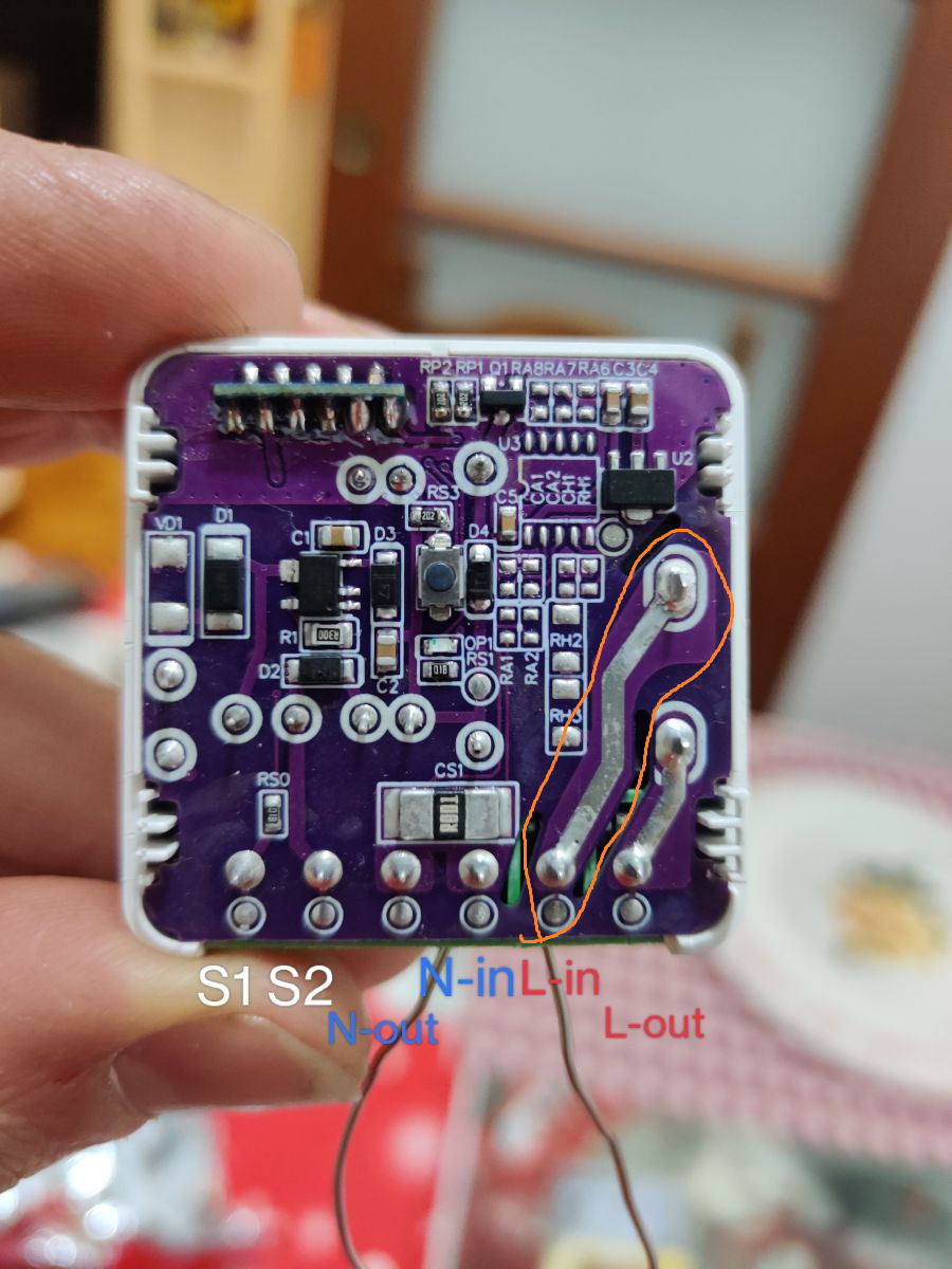

    How to modify smart switch into dry contact mode (detach mains from relay) I attach the photo above where the components are, it is mirrored to better understand.. in the past I have already modified a similar device, brand Sonoff, following the tutorial, I am able to weld and cut tracks if necessary, thanks for the advice :)

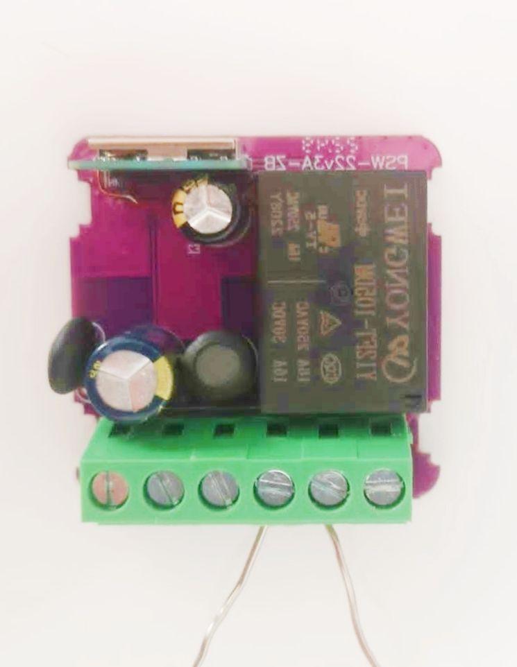

  • Clarifying relay terminals and mains connection
    #6 20418554
    Posts: 14771
    Rate: 12914
    Can you also include the description of screw terminals of the product?
    Again, it's very easy to do when you have a device in front of you, but hard to do remotely.
    So far I can see:
    It seems that right two terminals (when looking from the bottom), marked also with green arrows, are controlled by relay (it can close and open circuit here) and the pins marked with blue arrows are a relay coil (that is powered by 5V to turn on the relay).
    I am unable to see yet where you'd have to cut something. Are you saying that the most right two terminals (or one of them) are connected also somehow to mains input?

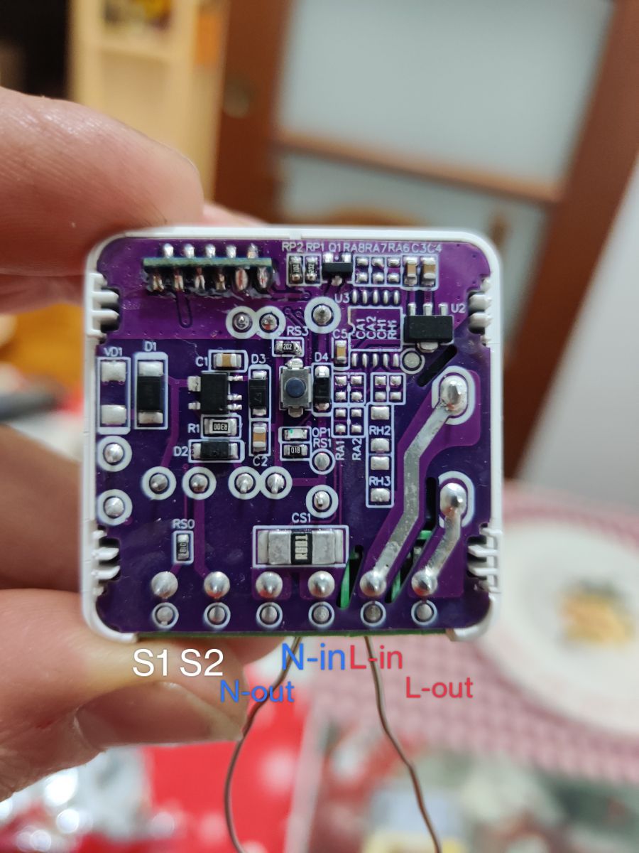

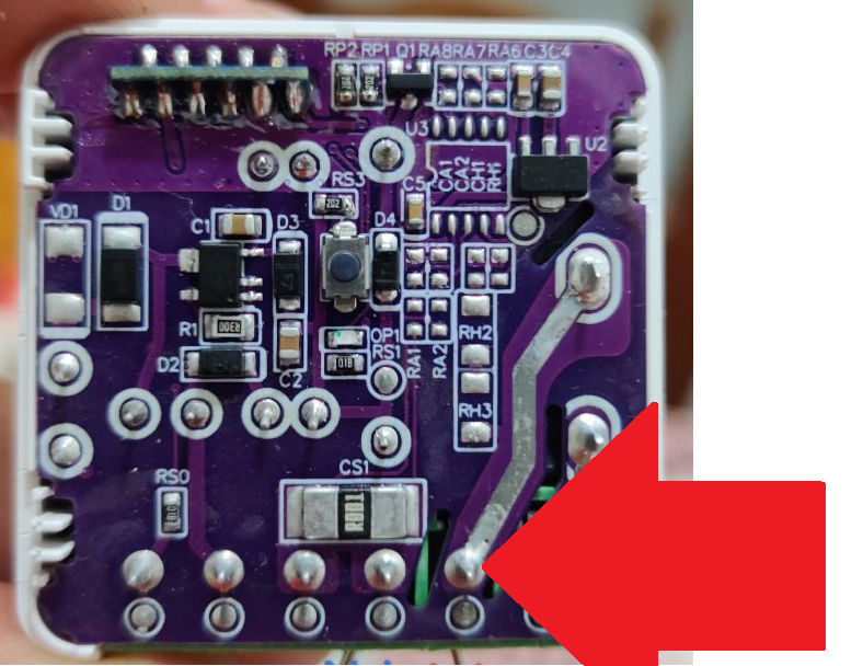

    This is the description How to modify smart switch into dry contact mode (detach mains from relay)
    Sorry for the sketch, I do it with smartphone while I am driving;) however your analysis is correct, I think I have to remove the Resistance for separate N, but then I don't know continue
    Trace L-in branch to isolate relay power

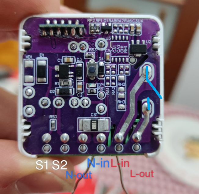

    #8 20418723
    Posts: 14771
    Rate: 12914
    Please don't play around with phone while driving, IoT "hacking" can wait!
    So the relay switch is here (unless I'm much mistaken), it connects L-in to L-out:
    Ok, so if you markings are correct, then I'd say that L-in has to go somewhere to the power supply circuit. We know that L-in is here:
    The question is - where does the L-in branches to the power supply to make 5V for Relay and later 3.3V for WiFi module?

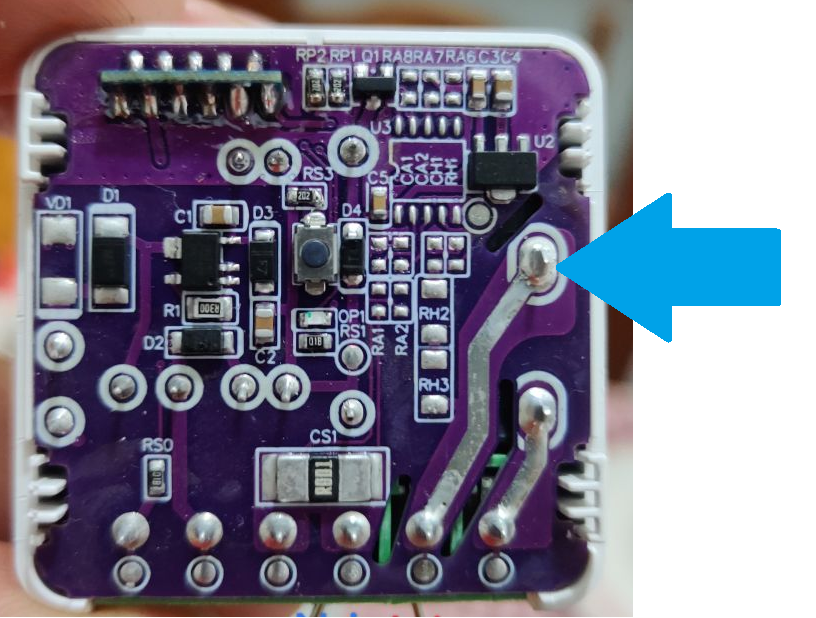

    Well, there are are two options:
    if it branches where the red arrow shows, at this joint, on the top of the PCB (top layer), then you can easily cut the trace to disconnect relay from L.
    The option two is:
    if it branches where I drawn the blue arrow (at the Relay pin, branches at the top layer of the PCB), then hacking this relay is hard, because cutting the trace won't just do the job...
    At the moment I am not able to tell more. There are multiple ways to proceed from here. You can:
    - just try looking at PCB?
    - just give it a try, cut of the trace going from L-in to Relay switch and check if board still powers on (if not, then that's not good, restore the trace, board is not easy to modify)
    - just desolder relay with flux and solder wick...

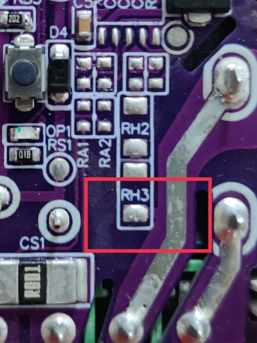

  • #9 20419329
    quasar87
    Level 4  
    Posts: 8
    it seems that from the L-in input a power branch goes to RH3, could this be the 5V power supply and then 3.3V?
  • #10 20419717
    Posts: 14771
    Rate: 12914
    Sorry but I can't see well on that photo. For me it looks like the trace goes only to RH3 pad and RH3 is not soldered. Or is the trace going somewhere further there?
  • #11 20419913
    quasar87
    Level 4  
    Posts: 8
    you're right man, the track stops there and nothing is soldered, tonight I'm unsoldering the relay and I'll try to find where L branches, thanks for your time, I'll keep you posted;)

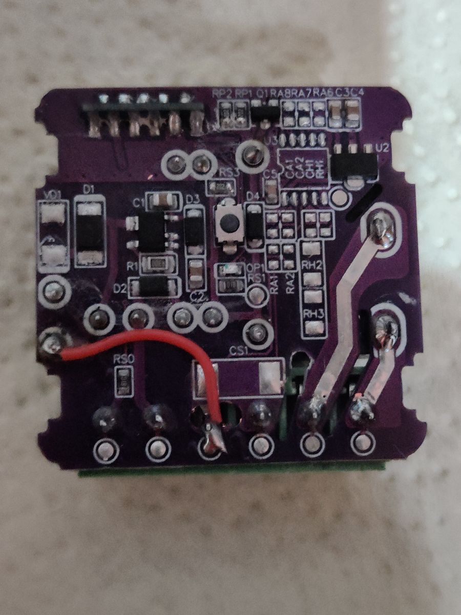

  • Cut hidden power track and separate neutral pads

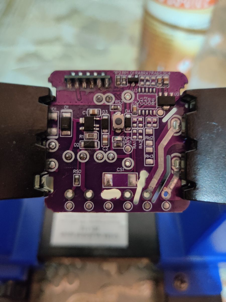

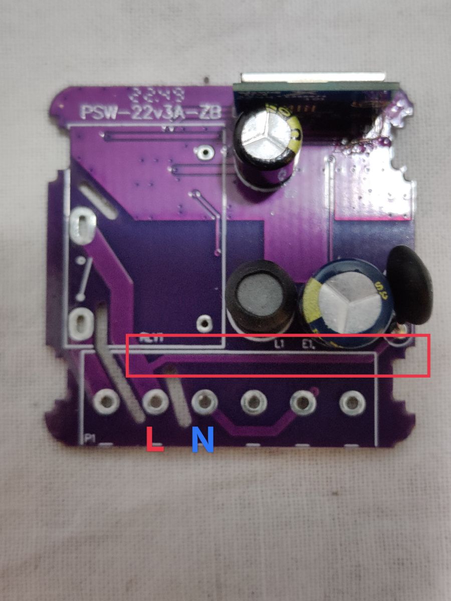

    #13 20421148
    quasar87
    Level 4  
    Posts: 8
    hello man, then the hack was successful!;) the power track was hidden under the terminal block,
    I cut it, I separated the two neutral pads, and I reconnected the power supply with a wire,
    How to modify smart switch into dry contact mode (detach mains from relay) How to modify smart switch into dry contact mode (detach mains from relay)
    I hope it's not too thin, however I plan to power the switch with a maximum of 9/10V.. Thanks for your support, you've been very helpful :D
    #14 20421522
    Posts: 14771
    Rate: 12914
    Good job. I think it's also worth to note that it has turned out the L power trace is on the two sides of the board. Manufacturer at least tried to handle higher currents.
  • #15 20549645
    quasar87
    Level 4  
    Posts: 8
    The solution can be found in previous posts, the key is to unsolder the terminal block to access the track to be cut
