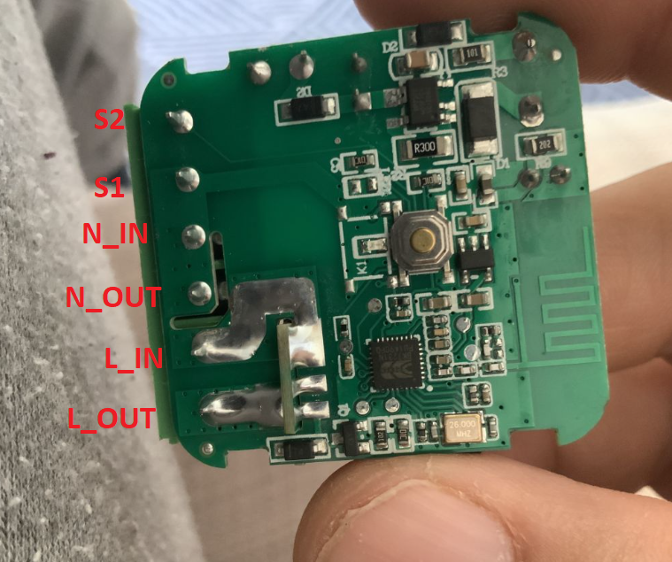

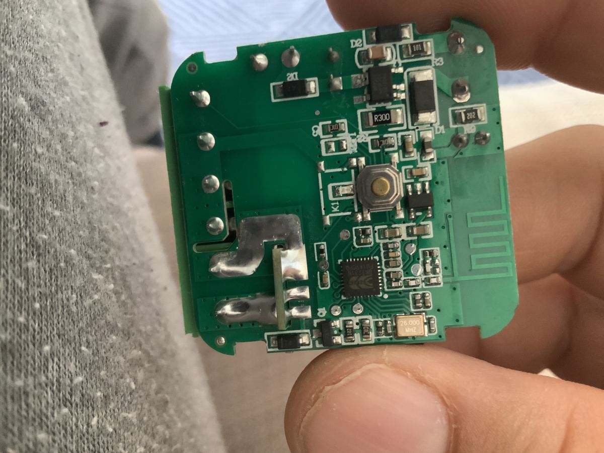

    Hi everybody,
    As mentioned on the post, I really would like help for transforming the switch on the picture so that I can have a dry contact.
    Thanks a lot for the help! Interior of an electronic device with a visible switch and components on a green PCB. Printed circuit board in hand, featuring a FANHAR FH17-1A2TLE relay and several capacitors. Back of a smart switch with technical information.

    This device looks somewhat problematic at the conversion, do you have enough soldering skills to desolder temporarily relay so we can see how L PCB track connects futher?
    Here is marked photo:
    PCB with labeled connections S2, S1, N_IN, N_OUT, L_IN, L_OUT.

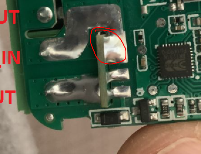

    You could always try to just remove the connection here:
    Close-up of a circuit board with a marked soldering area.
    and solder to that connection on the other side of the relay board, but it has to be done in a clean and safe manner, and I am not sure if you can do it, mains voltage is VERY DANGEROUS.
    Do you have and known how to use a multimeter?
