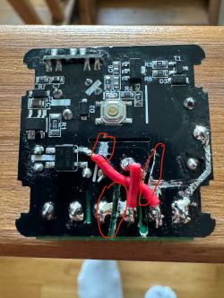

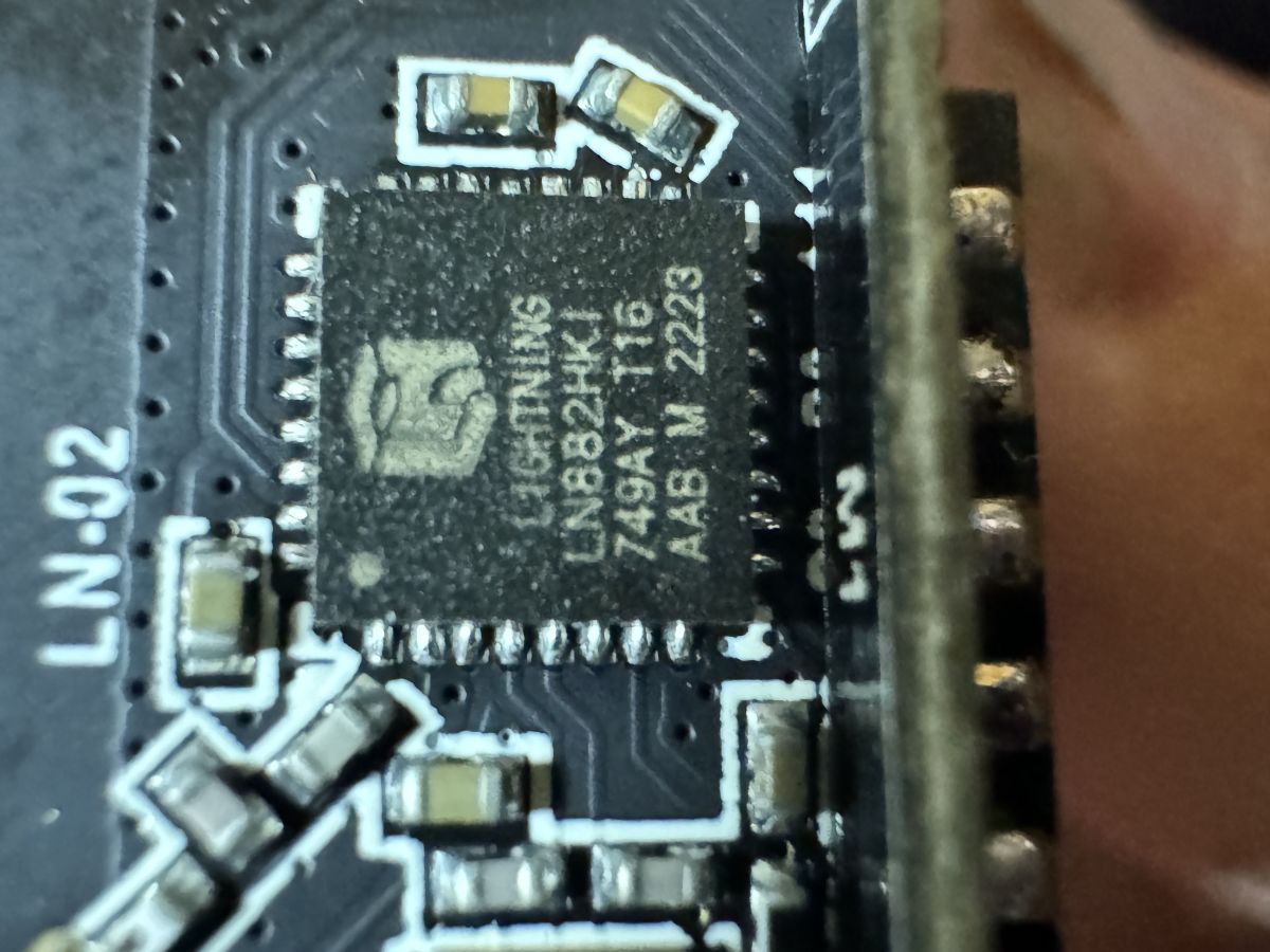

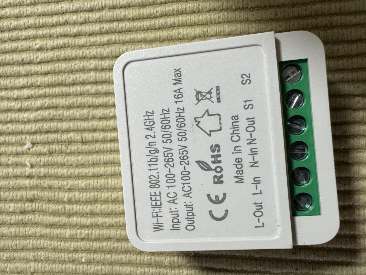

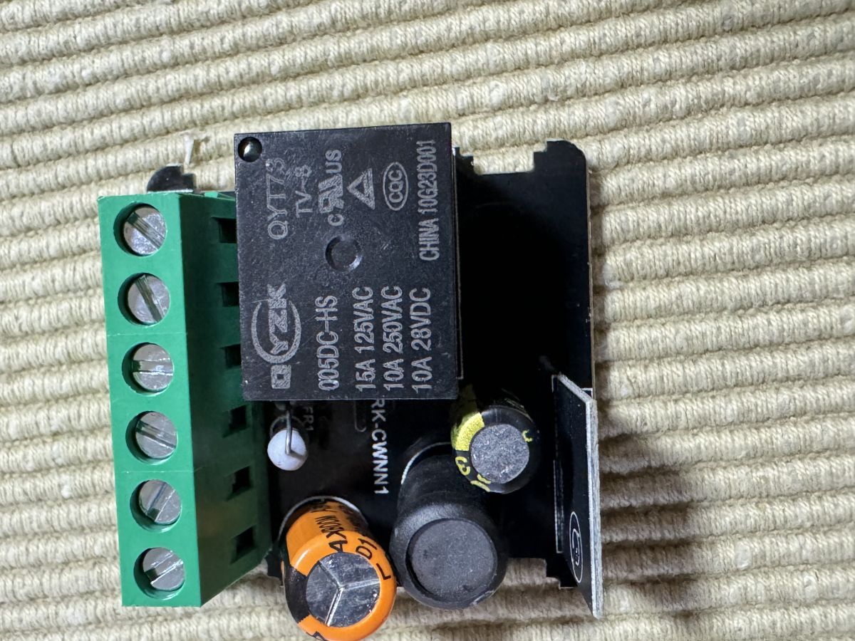

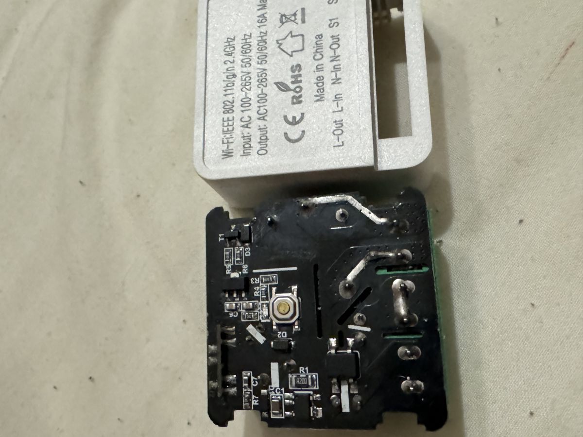

    Hi folks. I have a smart switch successfully flashed with OpenBeken. Any way to hack this switch to make it dry contact for L-out and N-out, instead of getting 220 v on it? Thank you, much appreciated for any help.

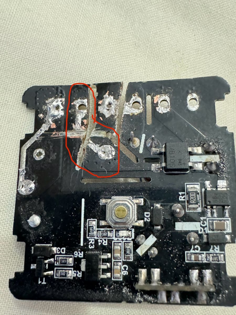

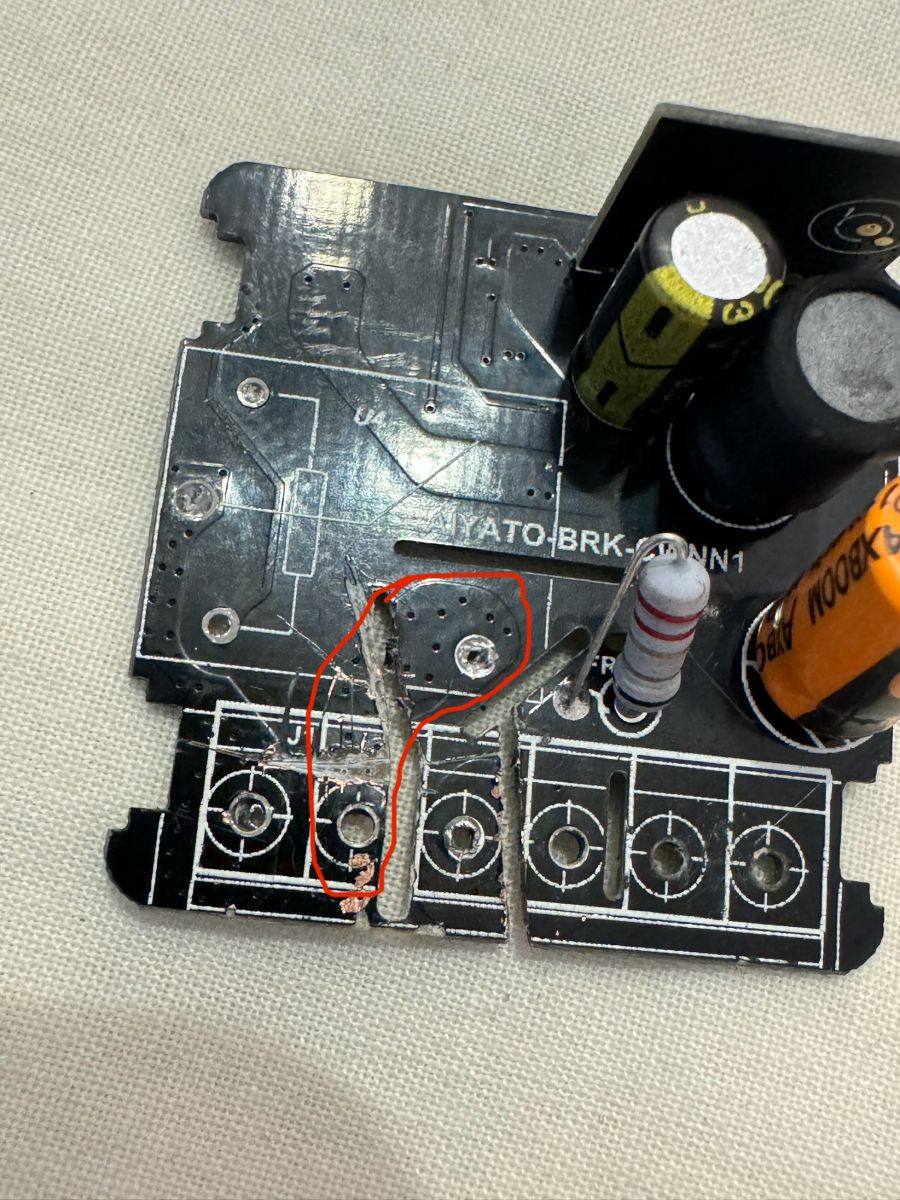

    You cannot do without cutting tracks on the board. You need to cut off the 230V AC supply from the relay contact (it is hard to see in the photos) and lead (preferably with wires) the contact output outside the device. I did this with similar Tuy WIFI relays (the ones with a potential-free contact were 2x more expensive).
    Greetings. J.

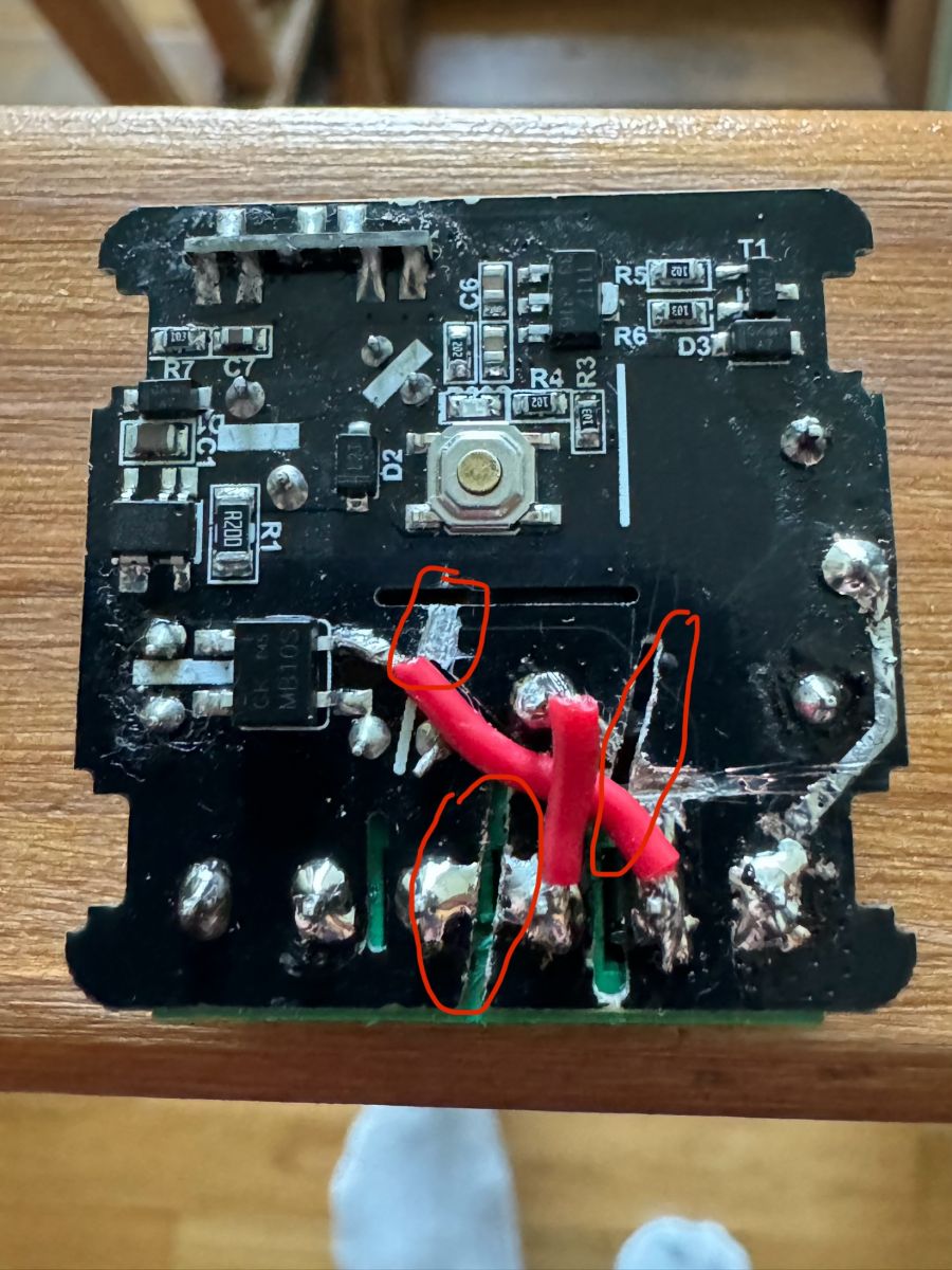

    Thanks for your tips, I saw the similar post here, but with completely different PCB. Finally managed to figure out to solve my problem. Maybe someone will have the same device like mine, I will post final results here

  • #4 21485301
    flyzet
    Please check above how I solved my problem. Thanks
