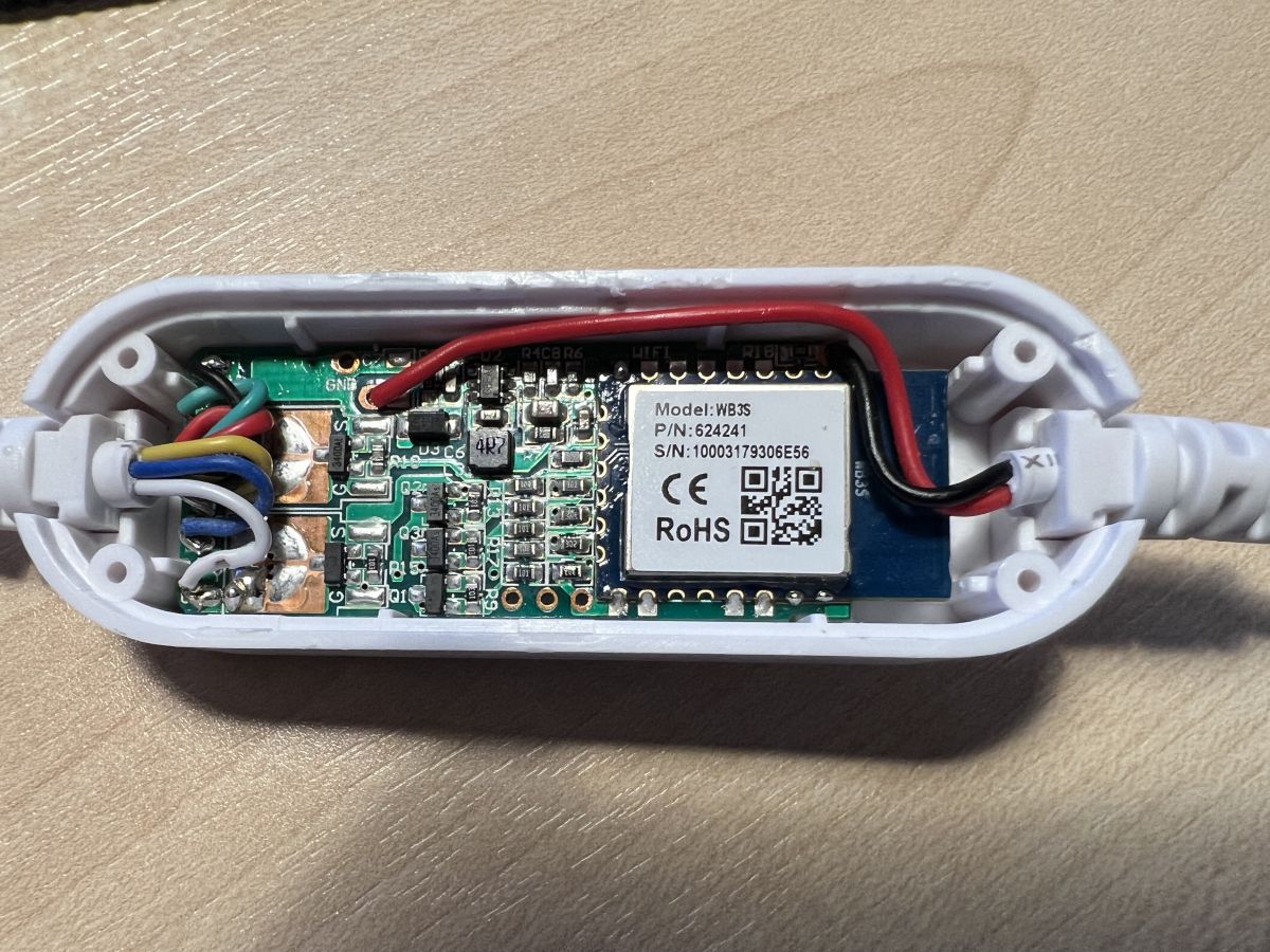

  • Hi, here's a quick teardown and a pinout for Nedis WIFILS50CRGBW led strips.
    It uses a BK7231T WB3S chip.
    Product official name: Nedis SmartLife LED Strip | Wi-Fi | Cool White / RGB / Warm White
    Product code: WIFILS50CRGBW
    Product EAN: 5412810303106
    Product Page: Link
    [BK7231T WB3S] Nedis SmartLife LED Strip | Wi-Fi | RGBCW - WIFILS50CRGBW [BK7231T WB3S] Nedis SmartLife LED Strip | Wi-Fi | RGBCW - WIFILS50CRGBW

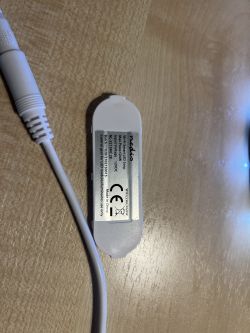

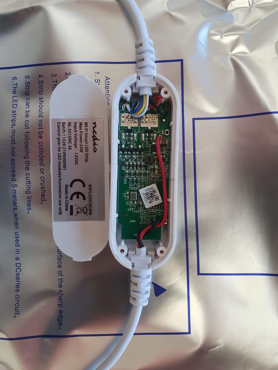

    Teardown
    Just pry it open, starting from where the cables are going to the controller, there are 3 small clips on either side of the housing.
    I used a small screwdriver to get it open but brute force would probably do it as well.
    I'd start on the power connector side since there is more slack on the cable on that side.

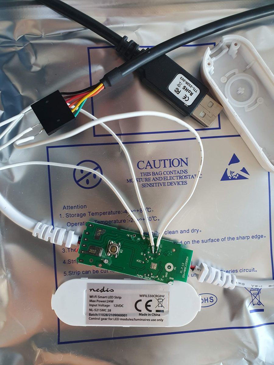

    Flashing
    I used OpenBK7231_app for the flasing and Tuya datasheet as a pinout reference
    PS. Please make sure that your board is the correct way, the easiest way is to check which pin is the gnd and which one VCC.
    OpenBK7231_app: Link
    Tuya datasheet for WB3S: Link
    Pinout
    PIN Assignment
    P6 PWM 5
    P8 PWM 4
    P9 PWM 1
    P14 Btn_n
    P24 PWM 2
    P26 PWM 3

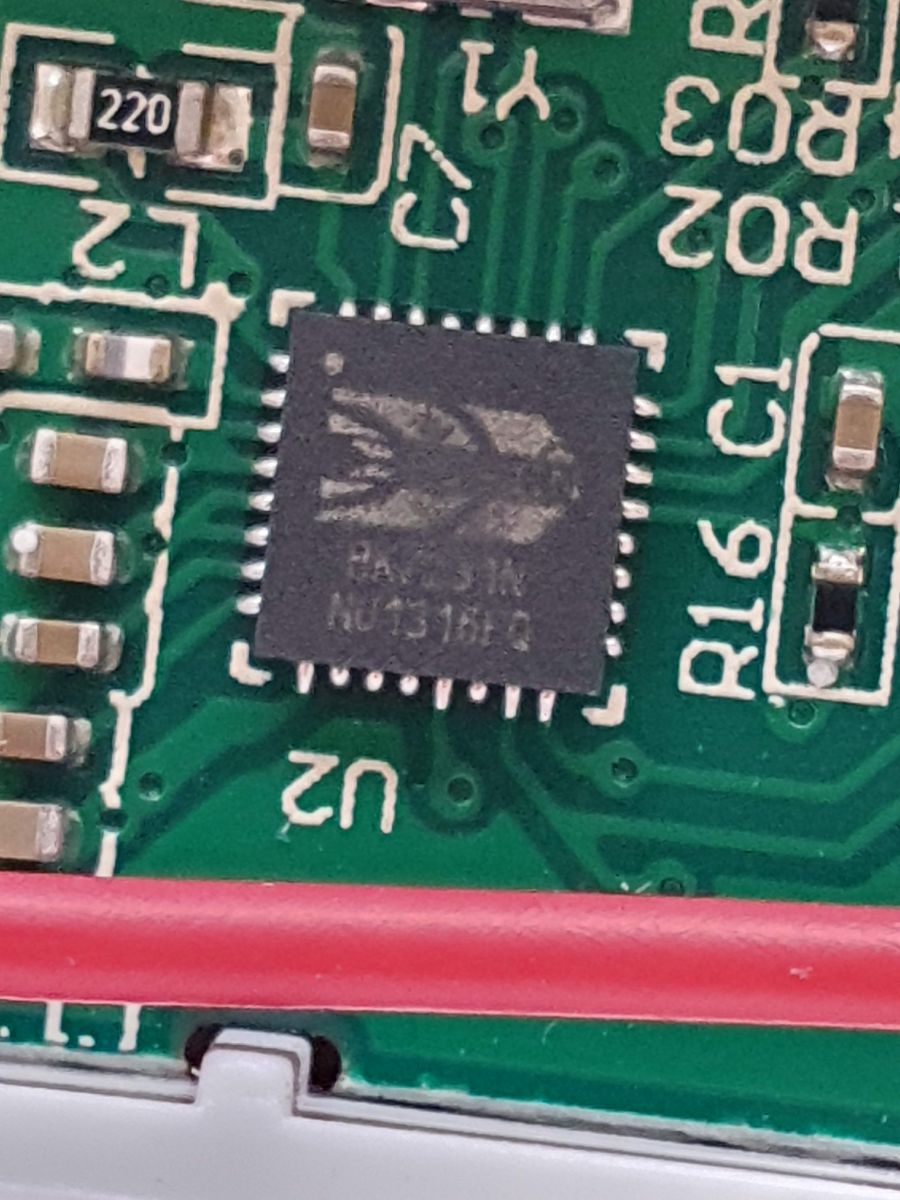

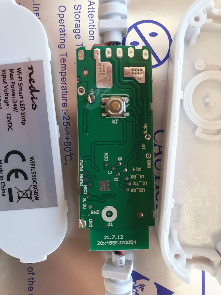

    Have the same device, but it seems to be a new PCB with BK7231N chip on main PCB.
    PinAssignment
    P6PWM 3
    P7PWM 4
    P8PWM 1
    P9Btn_n
    P24PWM 2
    P26PWM 5
    [BK7231T WB3S] Nedis SmartLife LED Strip | Wi-Fi | RGBCW - WIFILS50CRGBW [BK7231T WB3S] Nedis SmartLife LED Strip | Wi-Fi | RGBCW - WIFILS50CRGBW [BK7231T WB3S] Nedis SmartLife LED Strip | Wi-Fi | RGBCW - WIFILS50CRGBW [BK7231T WB3S] Nedis SmartLife LED Strip | Wi-Fi | RGBCW - WIFILS50CRGBW
  • #8 20509850
    Posts: 14763
    Rate: 12893
    Can you copy config from Web Application in JSON format? Thanks!
  • #10 20509933
    Posts: 14763
    Rate: 12893
    Thank you, it's nice to see someone able to create a pull request.
    Btw, are you sure about that Button_n?
  • Button_n avoids long-press log flooding
    #11 20509976
    wanders1337
    Yes, if I use "Button" instead of "Button_n" log is flooded with: Info:GEN:9 Button_OnLongPressHold
    (also there is some "Button/Btn" confusion. The "Export Current Template" section in webapp has "Btn_n", but it must be "Button_n" for it to work with "Copy Device Settings". One comes from device (/api/pins) and one comes from hardcoded list in info.vue ( https://github.com/OpenBekenIOT/webapp/blob/gh-pages/vue/info.vue#L123 ). Which is the right? Can they be made the same without messing things up?)

    ewengauvin
    >>20509842
    hello, I have a card that allows me to connect the BK7231N to my computer but I can choose 3.3 V and 5 V and I don't know which is the right one and as I'm a beginner I'm afraid to make error can you help me?
  • Use 3.3V supply for BK7231 flashing
    #13 20599050
    Posts: 14763
    Rate: 12893
    Hello @ewengauvin , you have to use 3.3V for BK7231, just like we do for ESP8266.
    Please consult our flasher guide before flashing:
    It would be good for you to also watch our Youtube flashing guides, which are very detailed and will show you step by step whole process (with soldering tutorial included):
    https://www.youtube.com/playlist?list=PLzbXEc2ebpH0CZDbczAXT94BuSGrd_GoM
    Feel free to ask if you have any further questions.
