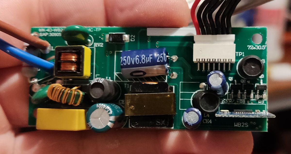

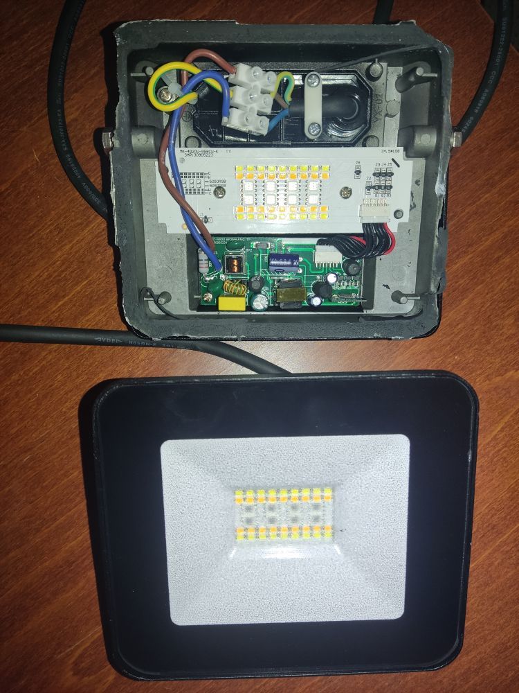

    Opened up one to get the pinout
    PWM0 Blue
    PWM1 Green
    PWM2 Red
    PWM4 Whitebalance / ratio of Coldwhite and Warmwhite, controlled by a BP5926, needs to be "inverted" in the pin-config
    PWM5 Brightness of white color
    Needs flag nr 8 - [LED] Alternate CW light mode (first PWM for warm/cold slider, second for brightness)
    Nedis SmartLife LED floodlight PCB with electronic components.
    Interior of an LED floodlight with a PCB and connected wiring.

  • WB2S pinout and Tuya JSON for RGBCW floodlight
    #3 20782345
    slools
    Sure! It seems to have the cloudcutter AP
    And not sure about the text description either
    - LED Green (Channel 2) on P7
    - LED Cool (Channel 4) on P26
    - LED Blue (Channel 3) on P6
    - LED Warm (Channel 5) on P24
    - LED Red (Channel 1) on P8
    Device seems to be using WB2S module, which is using BK7231T.
    And the Tuya section starts at UNCOMMON POSITION 0
    And the JSON from the tool:
