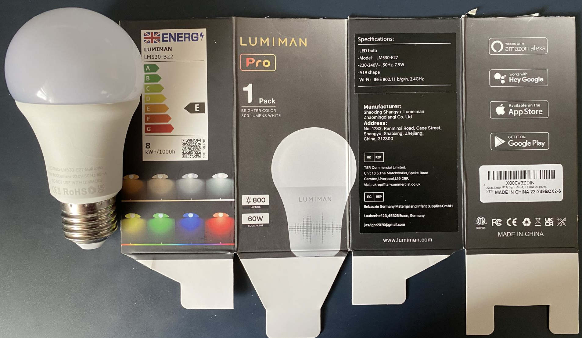

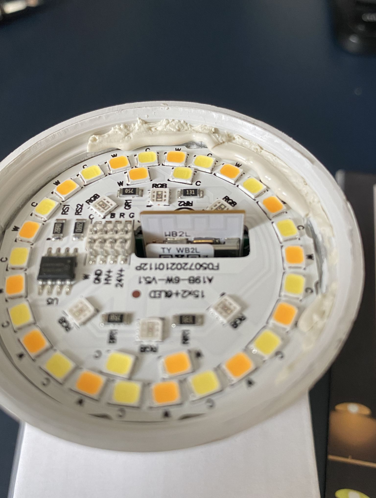

    Successfully flashed OpenBK7231T_UG_1.15.455.bin OTA using tuya-cloudcutter.
    Bought from Amazon UK Feb 2023
    Chips are BK7231T and WB2L
    Pin assignments in OpenBK7231T are:
    P6 PWM 2
    P7 PWM 5
    P8 PWM 4
    P24 PWM 3
    P26 PWM 1

    Thanks, btw I can see the model name is LM530-E27 but on another side of the package is it also printed as LM530-B22, probably a labelling error.
