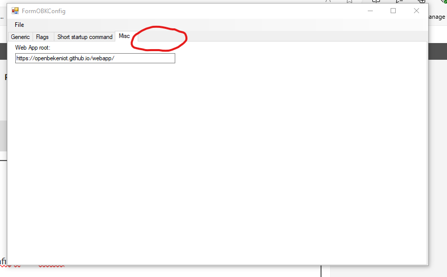

#1 20750783 28 Sep 2023 19:08 davidorsak davidorsak Level 2 Posts: 2 Topic author Post #1 20750783 28 Sep 2023 19:08 Hello!I have this issue:Device: LSC Mood LED Light (BK7231N)FW: OpenBK7231N_QIO_1.17.261.bin I can not set up IP config after flashing this FW. The card with IP config is not visible.Thanks for any advice!!! DO

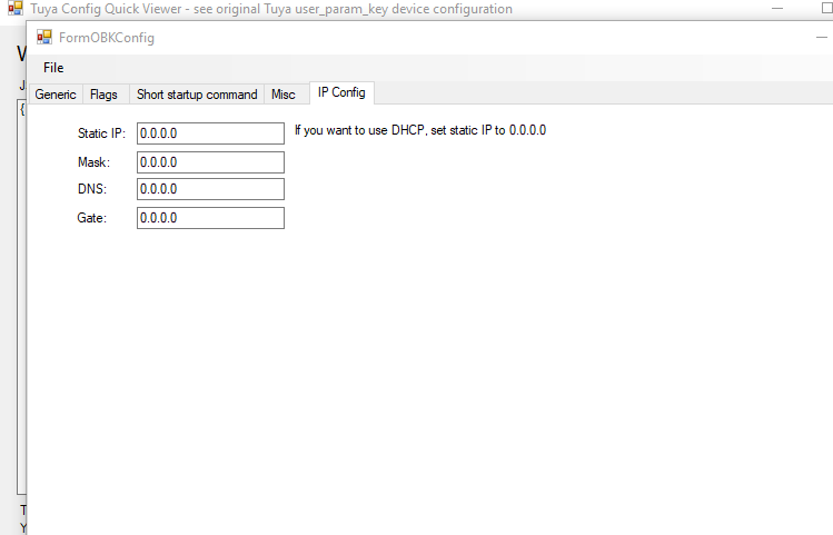

#2 20750815 28 Sep 2023 19:39 p.kaczmarek2 p.kaczmarek2 Moderator Smart Home Posts: 14756 Help: 659 Rate: 12883 Helpful post? (0) Post #2 20750815 28 Sep 2023 19:39 Hey, it seems that I have to push the latest version as the release. Wait a moment... Added after 6 [minutes]:can you try this version: https://github.com/openshwprojects/BK7231GUIFlashTool/releases/tag/v1.1.2 I am creating multiplatform open source firmware (Tasmota replacement), right now supporting BK7231T, BK7231N, XR809, BL602, W800, W600, LN882H and soon supporting RTL and W701: https://github.com/openshwprojects/OpenBK7231T If you like my work, support me at: https://paypal.me/openshwprojects Helpful post? Buy me a coffee.
#3 20750854 28 Sep 2023 19:54 davidorsak davidorsak Level 2 Posts: 2 Topic author Helpful post? (0) Post #3 20750854 28 Sep 2023 19:54 Bingo!!Looks good!!!Thanks very much!!!
