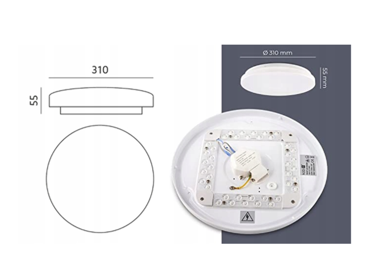

    [BK7231T/WB2S] Smart Led Moon 18W 1260lm CCT
    1. The light has WB2S module based on BK7231T
    2. Flashed OTA with tuya cloudcutter with OpenBK7231T_UG_1.15.223.bin - bring laptop as close to the light as possible
    3. Openbeken configuration (pins and flags).

  • WB3L identified in similar lamp teardown
    #4 20435164
    Posts: 14743
    Rate: 12839
    @galgavu where did the information that WB2S come from? I had an almost similar product (a user from the forum sent it to me to change the firmware), I did a detailed teardown and it was WB3L:
    https://www.elektroda.pl/rtvforum/topic3956918.html#20435155
    The above topic contains instructions for flashing by soldering (and how to unsolder the WiFi module on the pin connector) of a lamp very similar to the one presented here in the first post.
