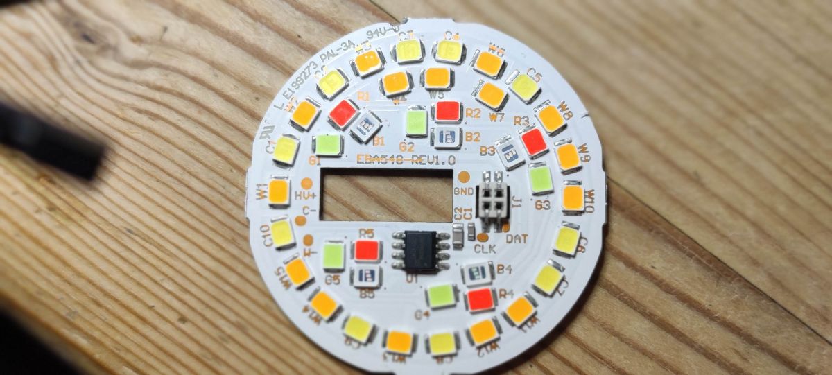

    I found a bulb which doesn't appear to be listed. I attempted to add it but the interface insists that I haven't said enough and I really don't have anything else to add.
    Lepro | LE Wifi Smart LED Bulb A19 E26, WB2L with SM2135
    Deconstructed as all other similar bulbs. Did not use a pipe wrench but rather pried the base off with a sharp utility knife.
    Flashed with BK7231T using the Windows flash tool. A bit of a Pfaff using the "quickly toggle power on/off" technique to enter boot mode.
    1.) Lepro | LE Wifi Smart LED Bulb A19 E26 Model No. 901003-US
    2.) Chip: WB2L with I2C SM2135 LED driver
    3.) WB2L Pin mapping:
    WB2L P1 --> SM2135 I2C Data --> Pin 7 BK7231T
    WB2L P2 --> SM2135 I2C Clock --> Pin 8 BK7231T
    WB2L P0 P5 P4 --> Unused
    4.) SM2135 Pin mapping (SM2135_MAP 2 1 0 3 4):
    OUT1 --> Blue
    OUT2 --> Green
    OUT3 --> Red
    OUT4 --> W
    OUT5 --> C

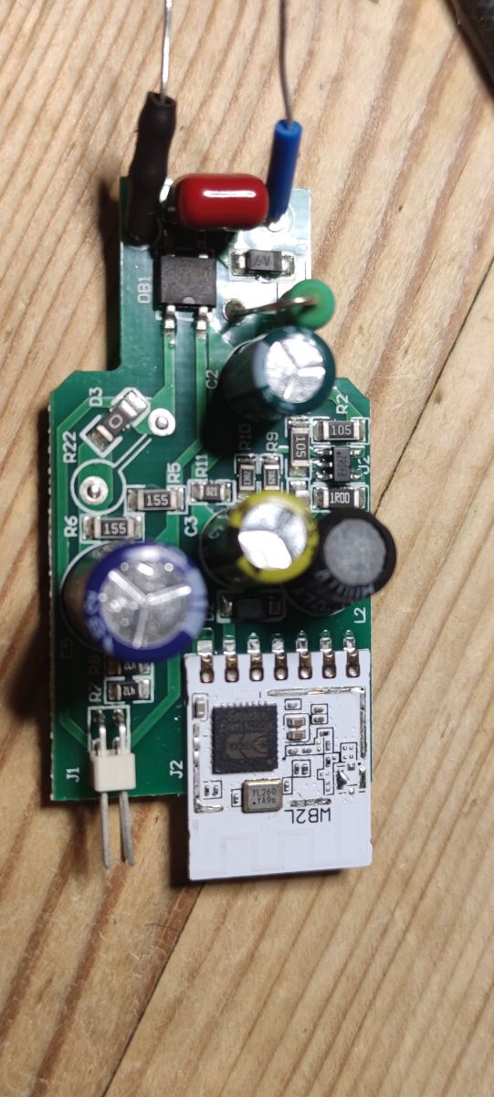

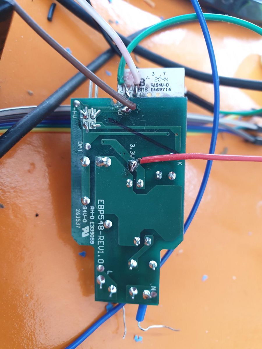

    5.) Two images of deconstructed bulb attached. RST on WB2L is not accessible with chip removal. Tx, Rx, V , V- are easily reached.

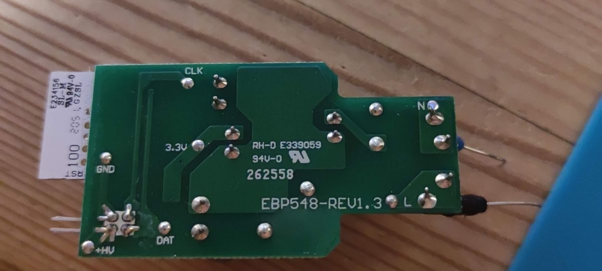

    You have been lucky with those RX/TX pins access. In case of our bulbs, we had to desolder the WB2L_M1:
    Do you happen to also have photos of bulb packaging?
  • #3 20445857
    foobarfart
    Bulb packaging and reverse of WB2L PCB board showing soldering points. Bulb was purchased on Amazon.ca

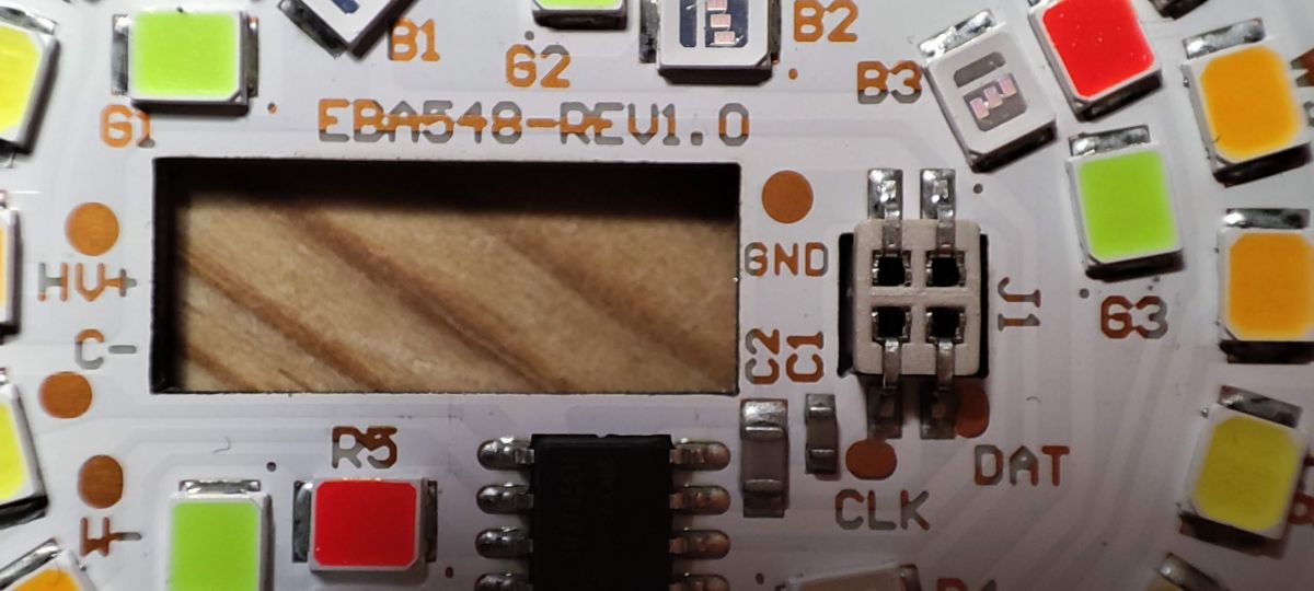

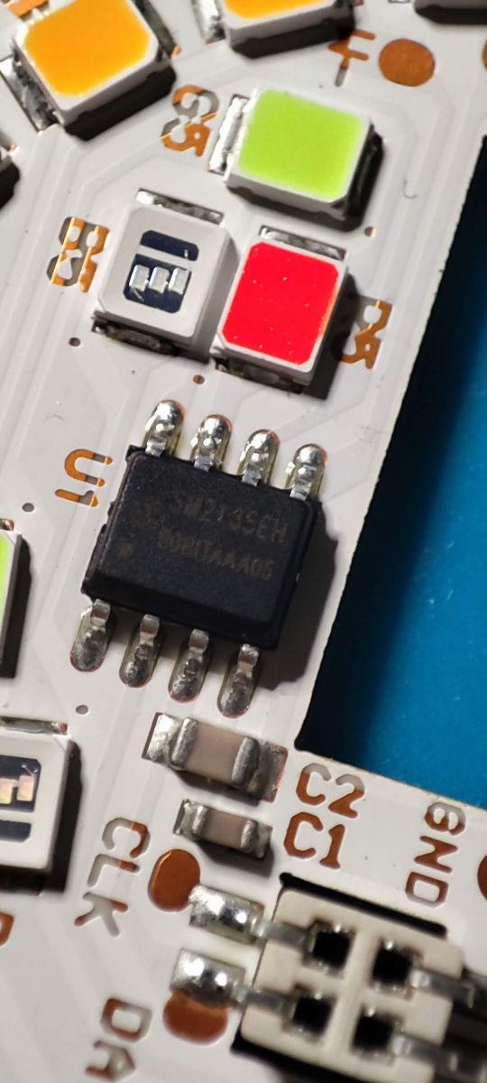

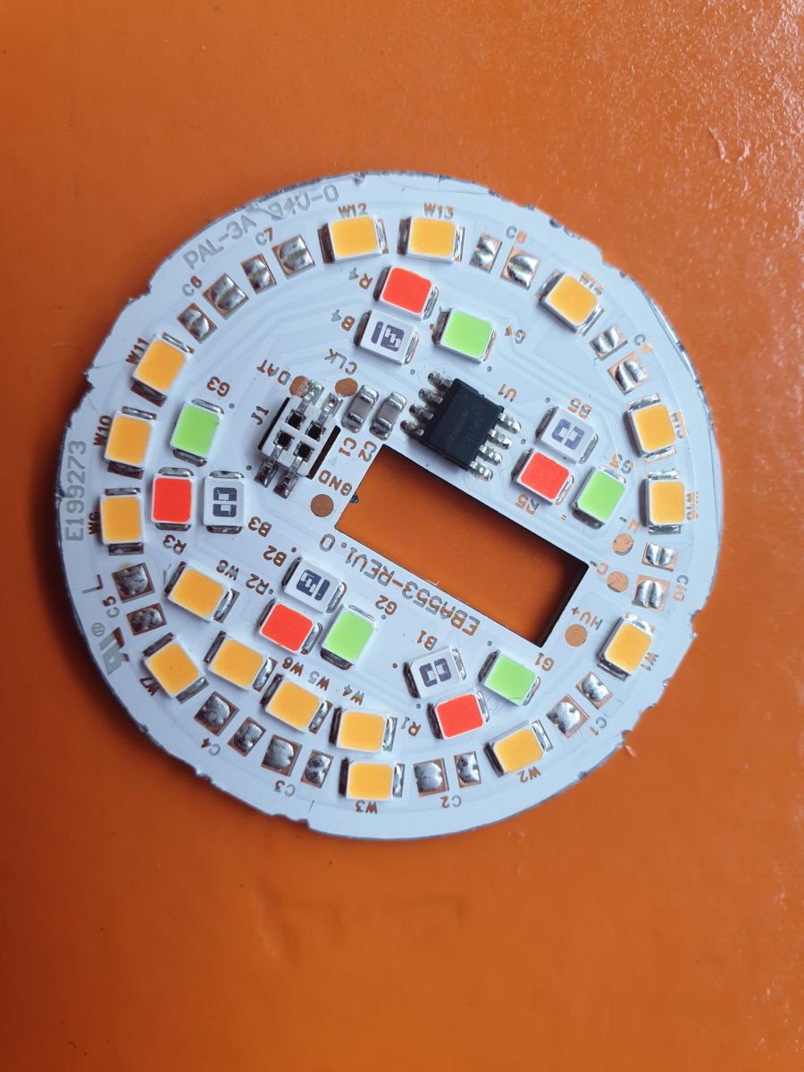

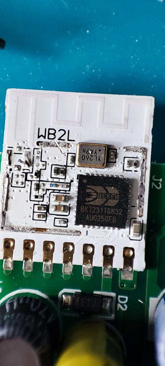

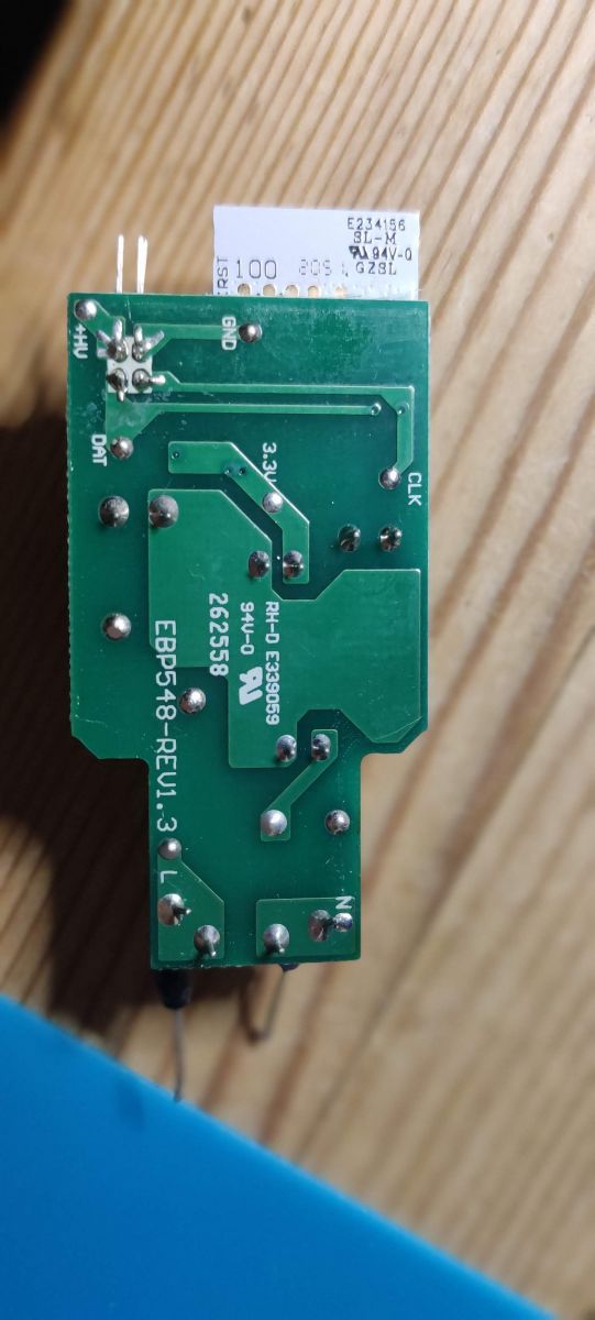

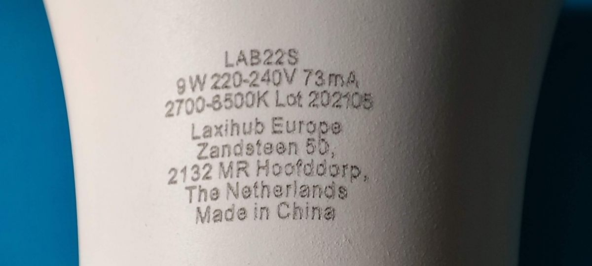

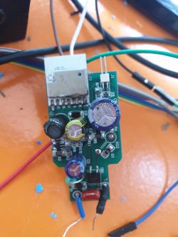

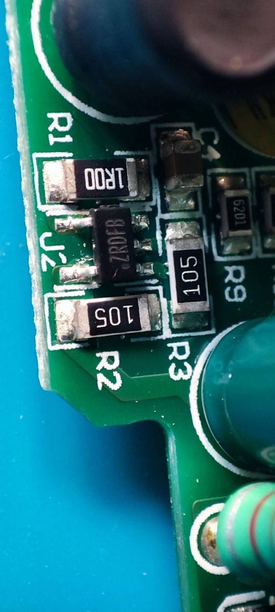

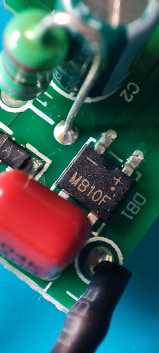

    I have almost identical bulb but labelled as a Laxihub brand, model LAB22S. This example has a bayonet A60/B22 fitting. This device is the only other device in the list so far with matching GPIOs: https://www.elektroda.com/rtvforum/topic3954346.html
    Some pics
    WB2L module with BK7231T chip on a printed circuit board. Close-up of electronic components of a bulb with SM2135EH chip. Close-up of a printed circuit board with colored LEDs and connections labeled GND, DAT, CLK. LED printed circuit board with connector and chip on a wooden surface. View of a circuit board with model markings EBP548-REV1.3. Image of a printed circuit board with markings and connectors Circuit board with electronic components and a WB2L module. Close-up of an electronic circuit with an MB10F bridge rectifier on a green PCB. Close-up of a circuit board with several resistors and transistors. Packaging of Laxihub A60/B22 9W smart bulb with Wi-Fi and BLE support Laxihub Smart Light Bulb box with barcode and product information. Close-up of a Laxihub LAB22S bulb with technical details and manufacturer's address.

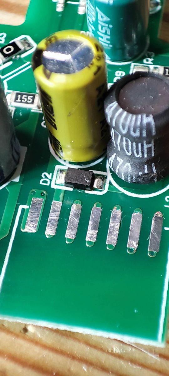

    I decided to desolder and flash module rather than solder in-situ
    Close-up of a circuit board with visible capacitors and a diode.
    boot
    also required is
    to limit RGB LEDs to 15mA and CW to 40mA though maybe better to go lower to prolong the life of the LEDs.
    This makes the OBK template

    How did you desolder the WiFi module? It looks like a good job, I see even pads are cleaned.
  • #7 21031349
    Posts: 5236
    Help: 449
    Rate: 918
    I added a little bit of pb solder to each contact, rather than creating a big sausage covering the whole module bottom. this was enough to make contact with the factory solder when I held the tip of the soldering iron along the whole bottom and it all melted at once.
    I always clean with IPA after soaking up final solder from the PCB with copper braid.
