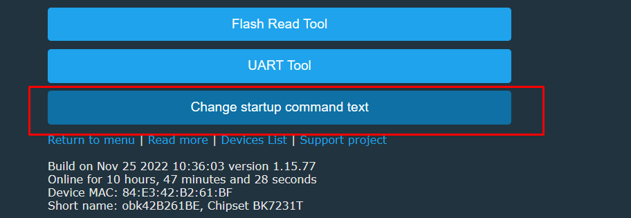

    Hi,
    I did see a passing reference to this in the forums and now I can't find it. I have a LePro LED bulb with the WB2L chip and a SM2135 driver (I have posted the description).
    How do I set up the configuration so that when the bulb is powered on and the chip boots, the light comes on?
    Thanks for all the great work.
    Yours, J

    I assume you dont want to just "remember last state", you want to force set a new state on reboot, right?
    Then you can use short startup command:
    Setting Up LePro LED Bulb with WB2L Chip and SM2135 Driver to Auto-Ignite Upon Power-On
    We support Tasmota syntax there, so use something like:
    backlog Dimmer 100; CT 500; Power ON
