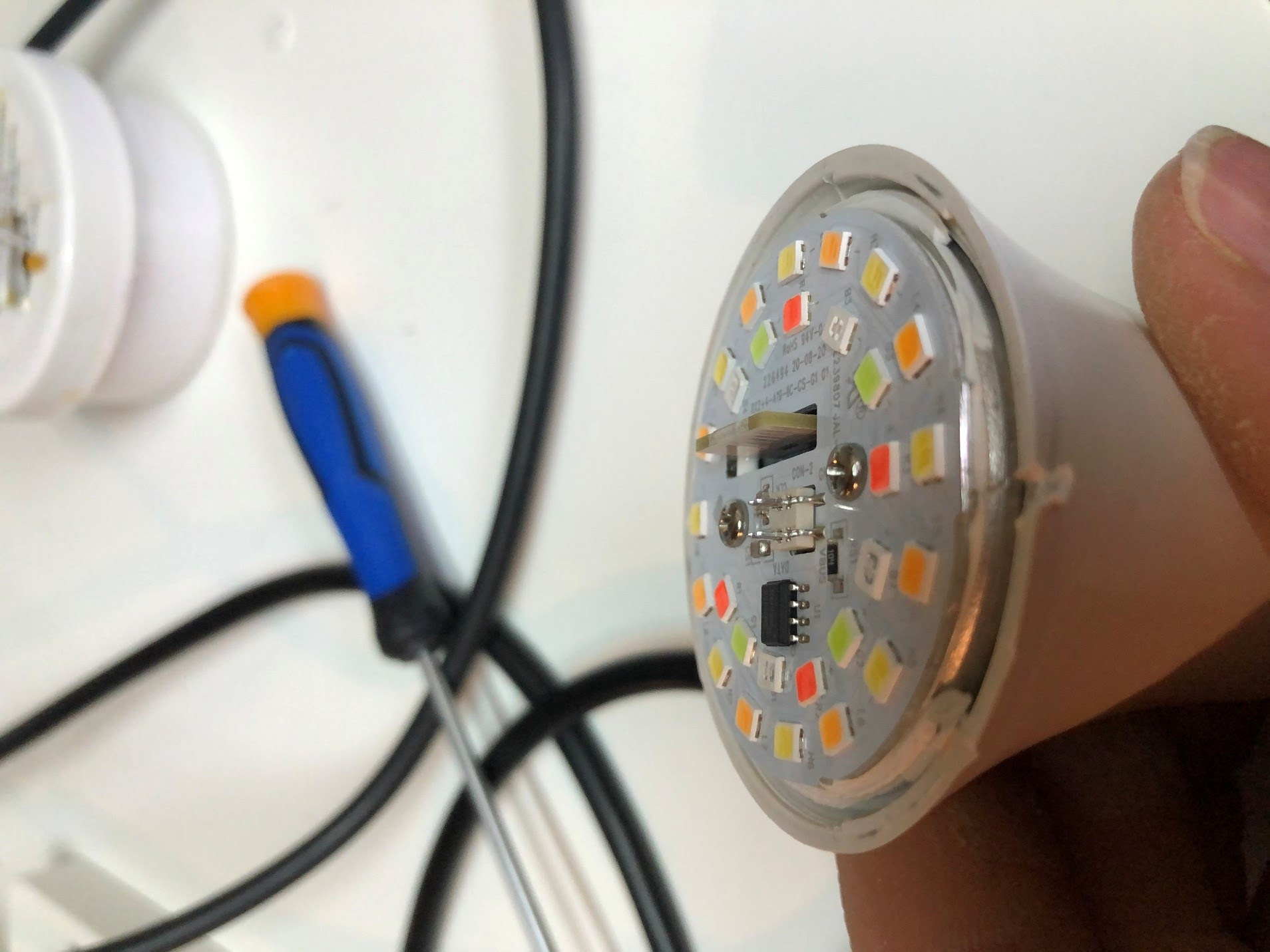

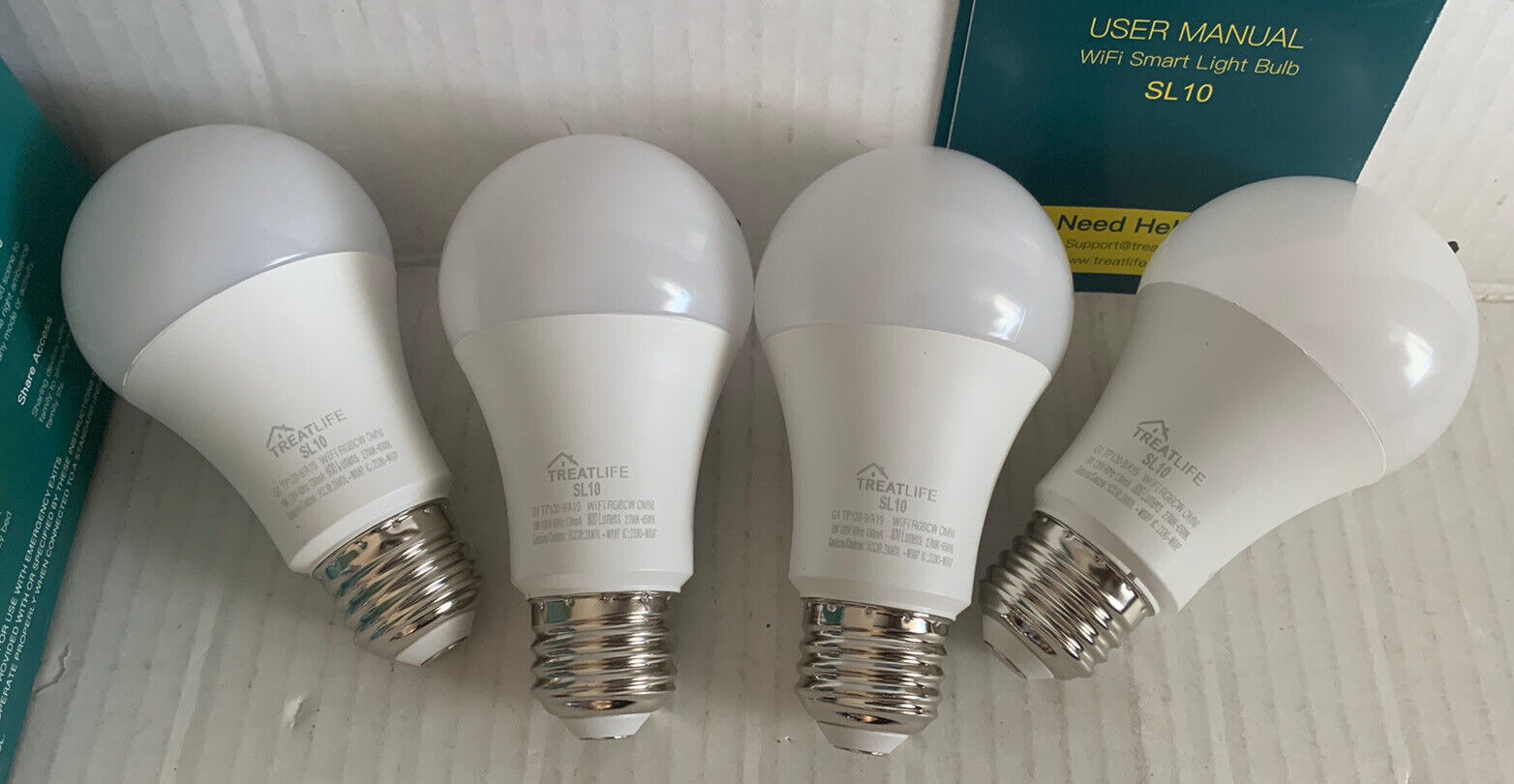

    Chip - WB8P (BK7231T)
    Led Driver - SM2135
    Pictures:
    Four Treatlife SL10 smart LED bulbs with a user manual.
    Electronic circuit board with LED components and capacitors on a wooden table.[/url]
    Close-up image of an LED bulb with visible colored LEDs and an integrated circuit.
    Flashing:
    Cloudcutter - Using firmware version 1.1.10
    Serial method - All the pins are exposed & can be soldered or using probe clips.
    Pinout:
    Pin 8 = SM2135DAT
    Pin 7 = SM2135CLK
    Configure Startup --> Short start up command:
    SM2135_Map 2 0 1 4 3

    Hi, I have a problem
    Only RGB lights up, but cold and warm doesn't light up
    Any way to fix this?
  • #4 20904824
    Posts: 14749
    Rate: 12858
    Maybe flag 9:
    9	[SM2135] Use separate RGB/CW modes instead of writing all 5 values as RGB
    can you try?
