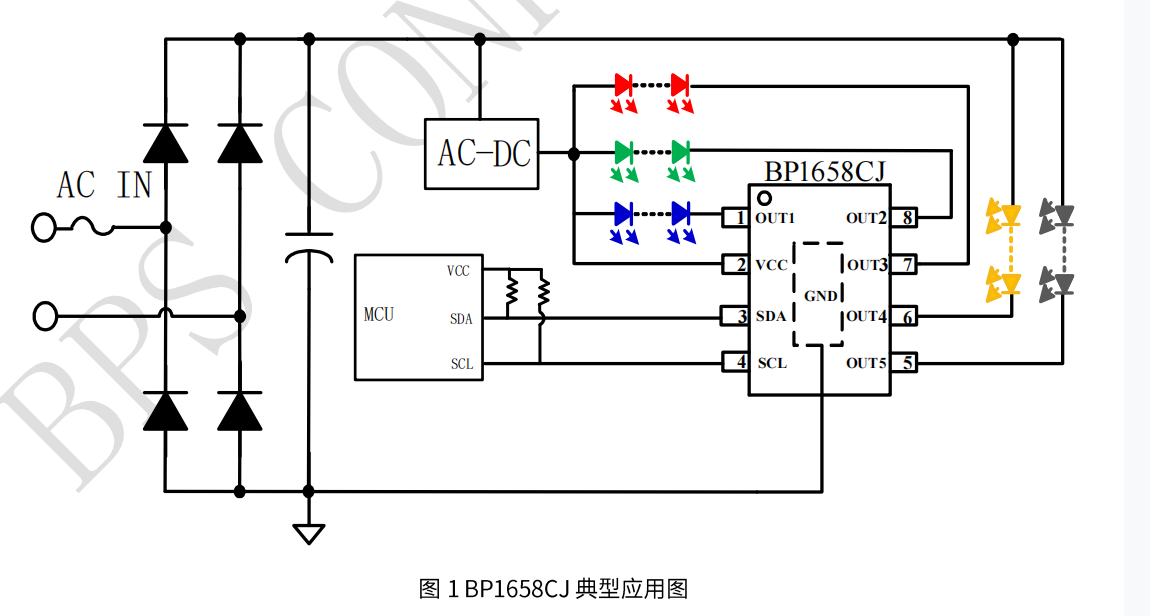

    BP1658C is 5ch LED controller so I don't know if the color temp slider can be removed.
    BP1658CJ schematic showing LED controller.
    https://bpsemi.com/col368/492
    You can try with flag 24 or with LED_Map 0 1 2 3 4 ( LED_Map RGBCW - where 0 is red, 1 is green, 2 is blue 3 is cold and 4 is warm) so you can try with LED_Map 2 1 0 4 but again I don't think it will remove the slider in the current build.

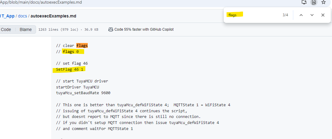

    karldonteljames wrote:
    is there a command i can issue to clear and set flags in bulk?
    to clear all
    to set flags 4,10,12,17,18,23,24,37 to true
    my source for this was the autoexec examples page https://github.com/openshwprojects/OpenBK7231T_App/blob/main/docs/autoexecExamples.md
    Screenshot from a text editor showing an example of using commands to manage flags in autoexecExamples.md from a GitHub repository.

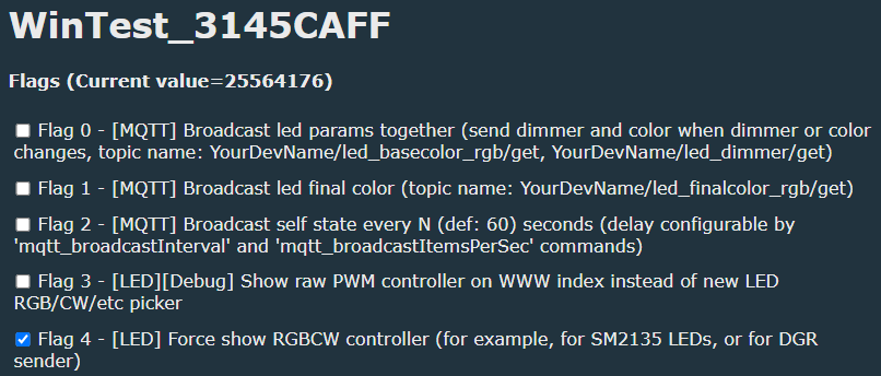

    I thought you could also use
    which is some calculation of all the flags enabled. You'll notice the "current value" change as you make changes and save.
    Screenshot of the flag settings panel for WinTest_3145CAFF with flag 4 highlighted.
    but it appears some flags are excluded from this calculation and make no difference to the flags value. I'm not sure what the story is with that
