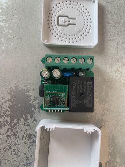

    Hi, so i bought a tuya mini wifi relay module. I was expecting another beken device but this is the chip that it came with.
    Anyone has encountered this?
    Googling the chip name leads to this doc
    https://fccid.io/2AUUL-TR6260/User-Manual/User-Manual-4520594

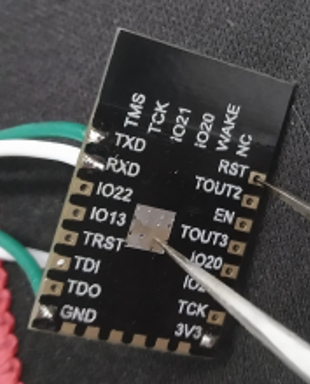

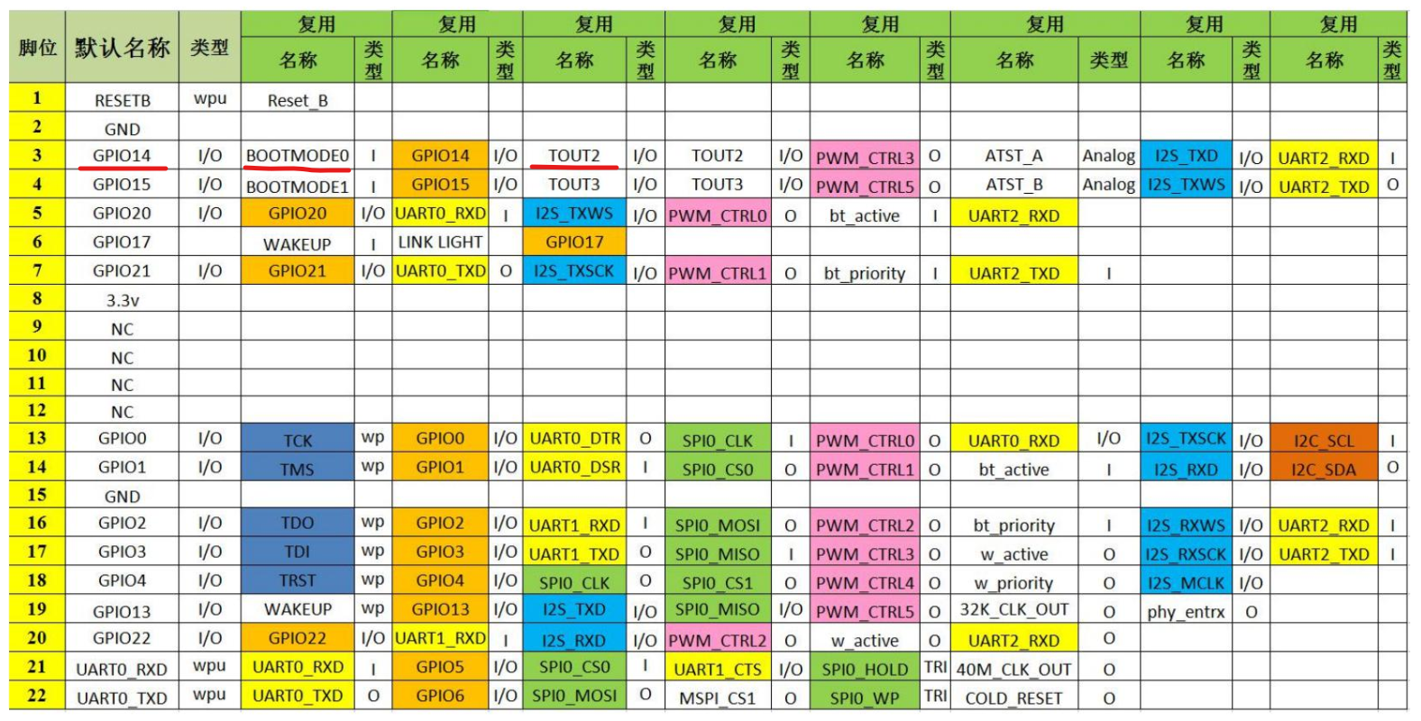

    It seems that this dev board:
    HLK-M20 Serial Port 2.4G WiFi Wireless Module IOT Serial to WiFi Transparent Transmission Low Power SDK M20 Development Board Ki
    is using TRS:
    Screenshot of an AliExpress listing for the HLK-M20 WiFi module.
    TR6260S1 WiFi module on a PCB.
    TRS6260S1
    Development board with TR6260 WiFi module on a white background. Image of two WiFi modules with the TR6260S1 microcontroller. Set of boards with a WiFi module and pin labels. Specifications of the HLK-M20 module with TR6260 chip.

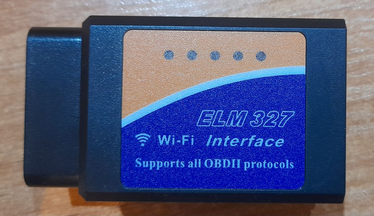

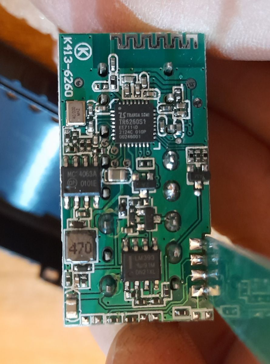

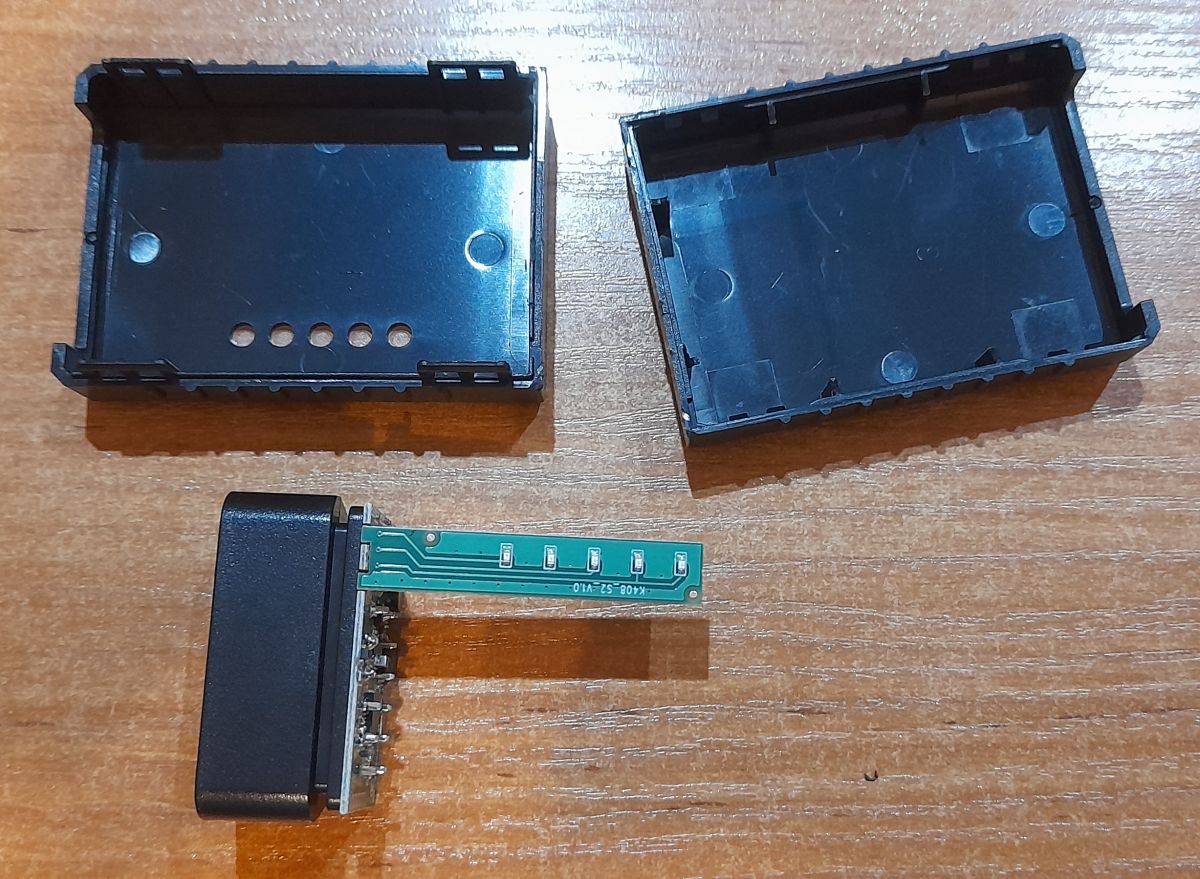

    The mentioned TR6260S1 chip is found in the "ELM 327 WiFi diagnostic interface" ELM 327 Wi-Fi diagnostic adapter with casing and label. Close-up of circuit board featuring TR6260S1, MC4063A, and LM393 components. Open ELM 327 WiFi diagnostic interface with visible circuit board featuring TR6260S1 chip Open ELM 327 WiFi diagnostic interface with visible circuit board featuring TR6260S1 chip Electronic module with various integrated circuits on a wooden surface. In addition to the aforementioned TR6260, there are MC4063A and LM393 in the interface.
    This is how it came into my hands by chance - maybe such information will be useful to someone.

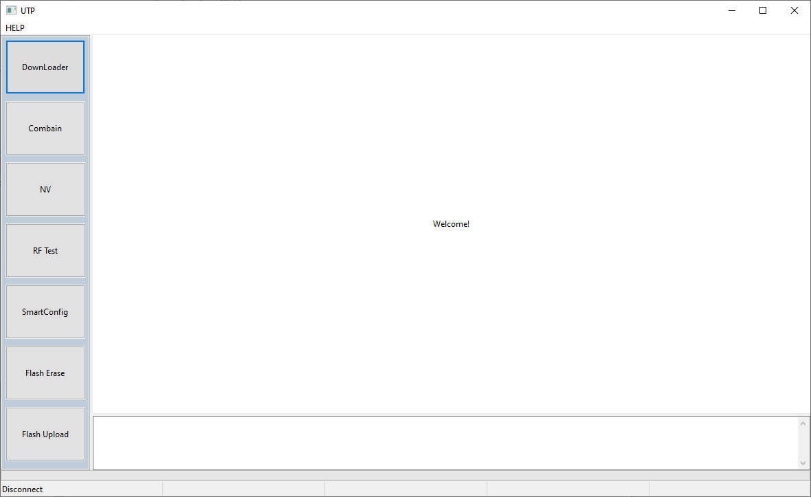

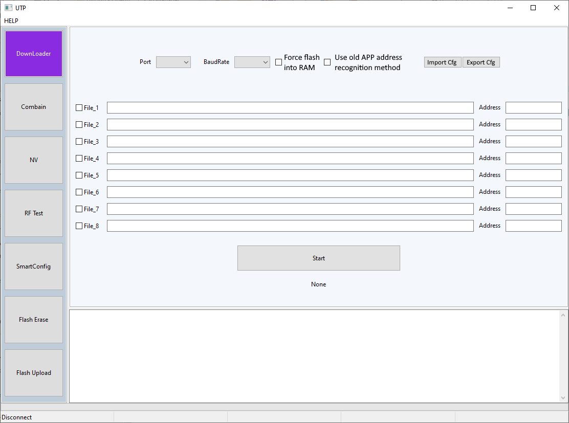

    Christmas has come early!
    TR6260 SDK and flash tool "UTP" attached. This is from Skylab who are behind the LSC6260 module.
    Screenshot of Skylab's flash tool UTP.

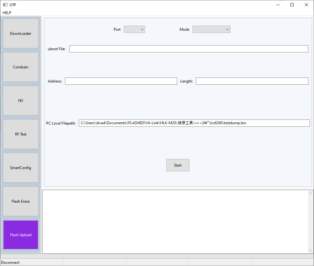

  • #14 21291368
    Posts: 14756
    Rate: 12881

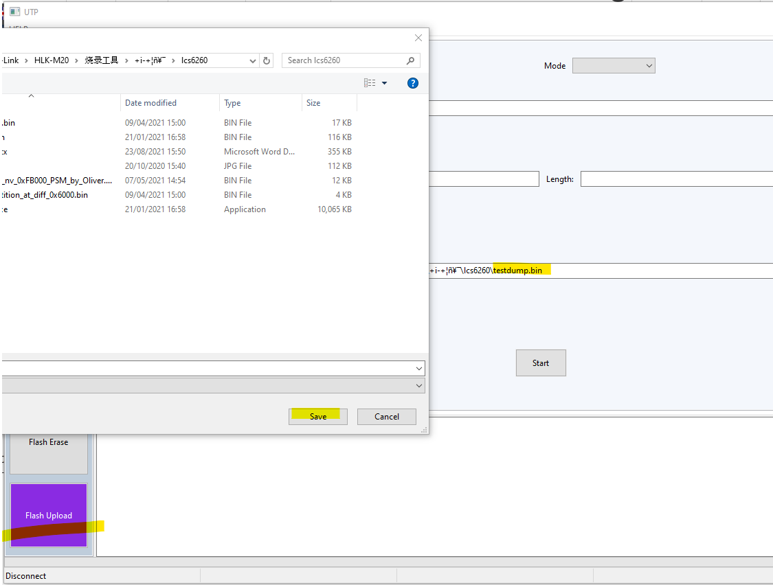

    Nice, what is the difference between "DownLoader" and "Flash Upload"? Can it both read and write?
  • #15 21291411
    Posts: 5213
    Help: 446
    Rate: 914
    potentially. the file path field is a save path, so it looks to be.
    I don't yet have any TR6260 devices to test. ELM327 and HLK-M20 in post
    Screenshot of a program with an open window for saving a binary file.
    Screenshot of UTP software interface with options and file path to testdump.bin.
    the readme file is useless
    Added after 57 [seconds]:
    do you still have the Transa Semi LED controller to test with?

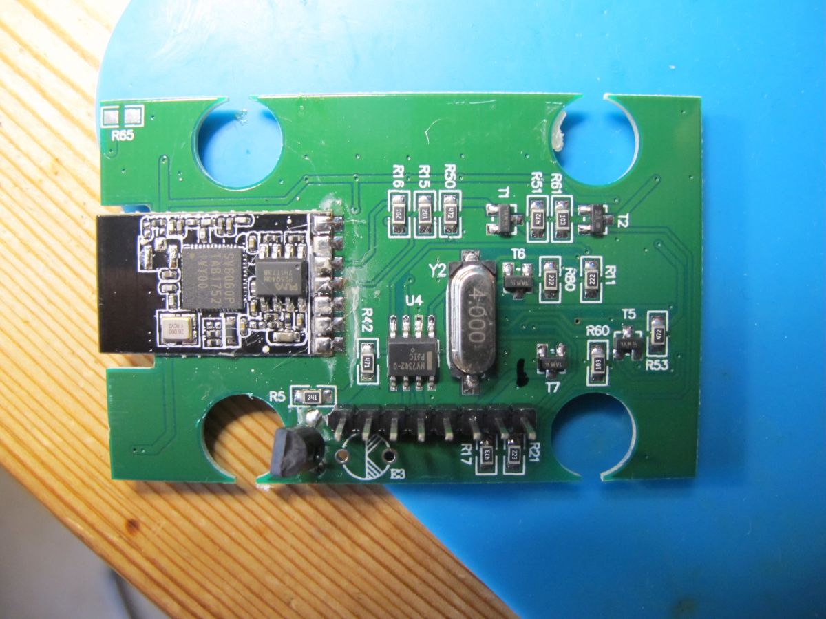

    >>20812359
    boo. my ELM327 came with an SV6060P
    Circuit board with an electronic chip and components.
  • #19 21297598
    Posts: 14756
    Rate: 12881
    That sounds like a totally new chip, can you open separate topic and we will look for SDK?
    I should still have TR6260 somewhere...

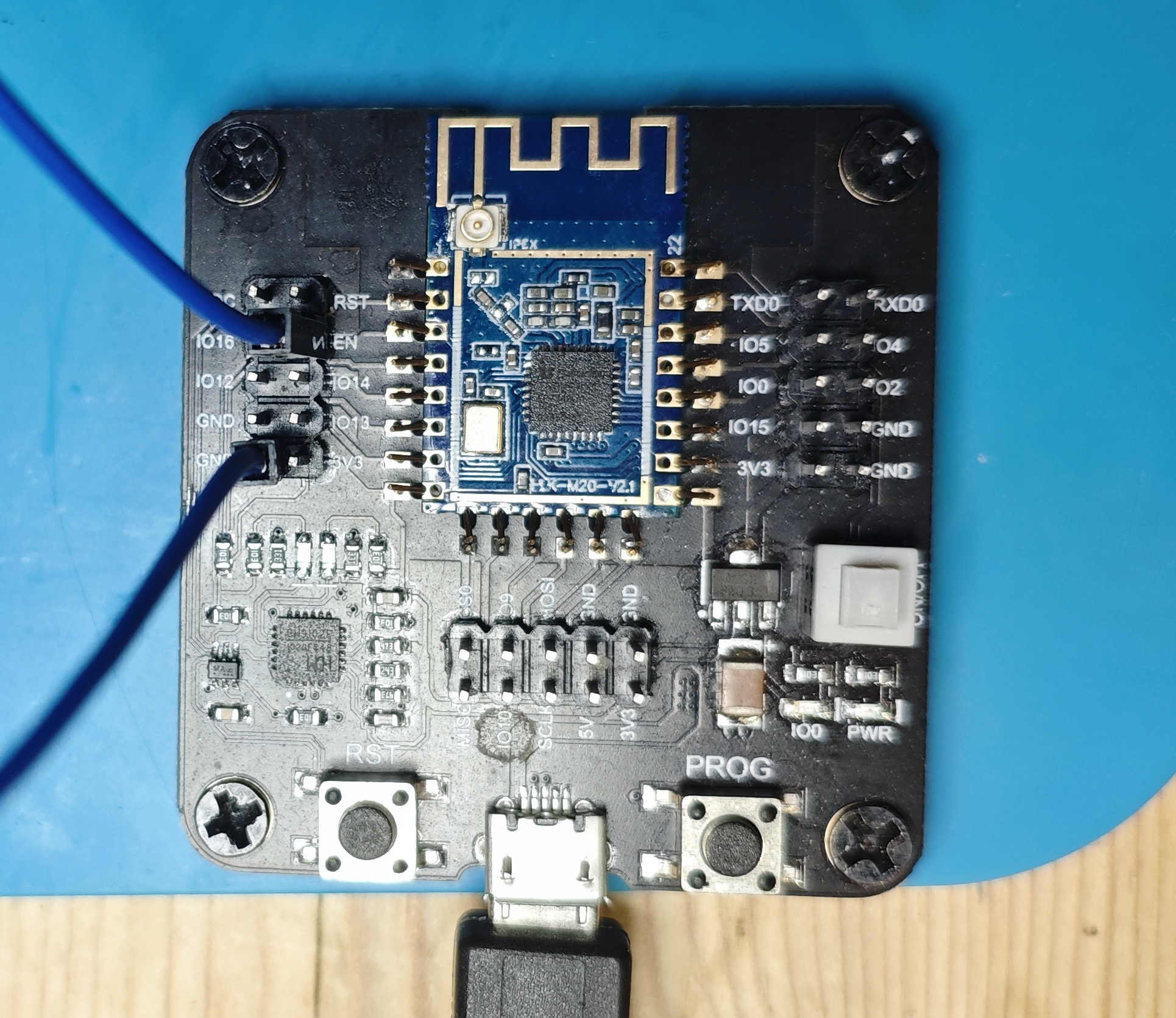

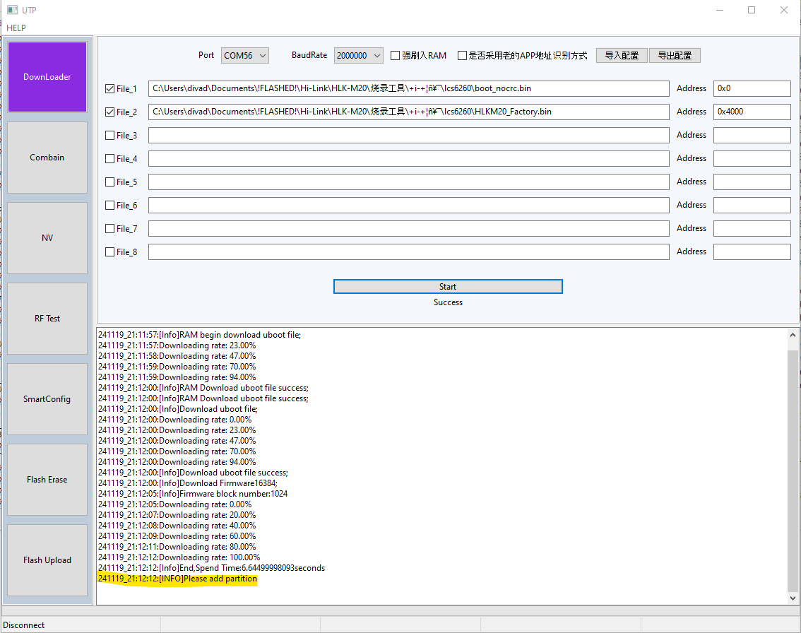

    I've received my HLK-M20 module but not worked out the UTP program yet. The HLK-M20 does broadcast an AP. I'm expecting it to be similar to their other shipped firmwares. AT command tests and such (detailed in HLK-M20 PDFs).
    Screen to connect to HLK-M20_10AA Wi-Fi network.
    I attach the annoyingly difficult to obtain HLK-M20.7z mentioned here https://ask.hlktech.com/question/1039.html as well as the natively-English FCC PDF for the HLK-M20

    then configure the UTP program as follows, using the boot_nocrc.bin from the 烧录工具.zip file posted above. The flash is 1mb so length is 0x100000
    PC Local Filepath is just where you want to save the file
    Screenshot of the UTP application showing flash upload settings.
    And so attached is the HLK-M20 factory firmware backup. It took 2-3 mins so could well be transferring at the 57600 baud used to capture log out.
    On the HLK-M20 module GPIO14/TOUT pad is the location of EN on ESP-12F, so if using an ESP universal adaptor it's just a case of grounding EN header.
    Diagram of an electronic module with highlighted pins
    HLK-M20 module mounted on a PCB with pin labels and wiring.
    The LSC6260 module is a little different (pic only added to show TOUT2 location difference - ignore the grounding of RST depicted)
    Close-up of an electronic module with visible pins labeled as TMS, TCK, IO21, IO20, and others.
    GPIO pin assignment table for the HLK-M20 module.

    If you flash the whole factory backup file from 0x4000 then it doesn't detect the partition table where it's supposed to start - 0x6000
    Screenshot from a hex editor showing data in hexadecimal format with addresses and highlighted entries.
    and the programmer complains with [INFO]Please add partition:
    Screenshot of firmware flashing software with file list and operation log.

    and finally, a blank English translation of the Downloader tab
    Screenshot of firmware flashing application interface with the Downloader tab visible.
