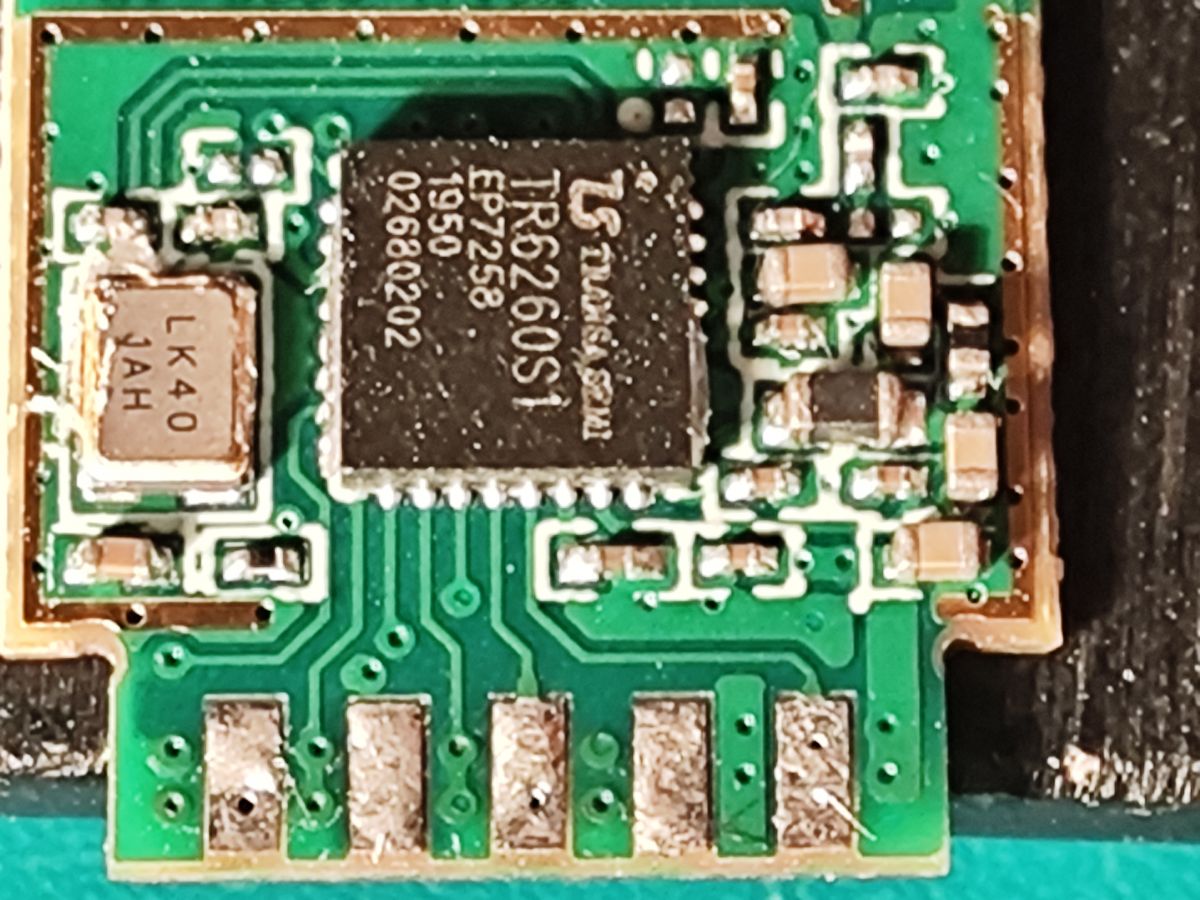

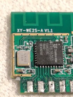

    A5F-53F1-02 WIFI mini switch
    Is it possible to flash this Tuya chip?
    TR6260S1

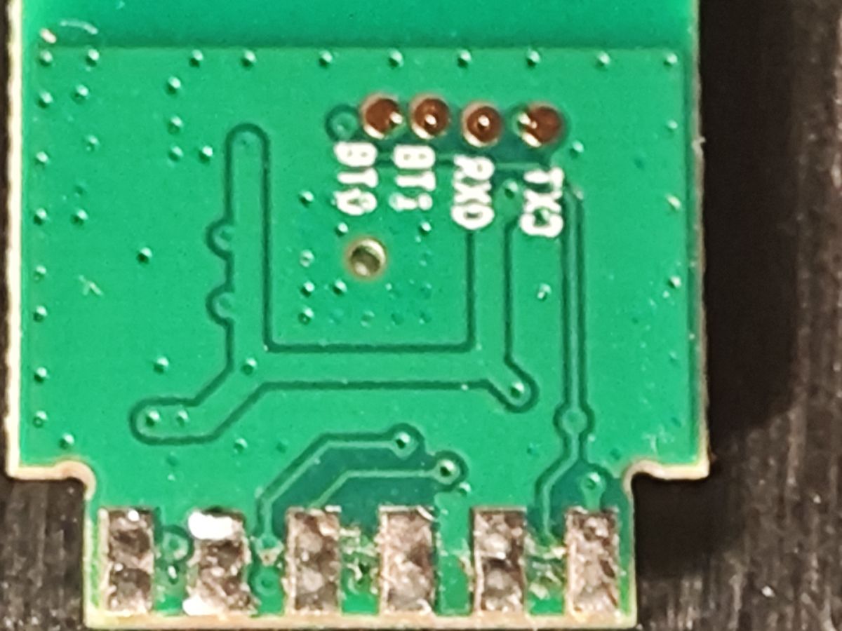

    I could not flash it. Maybe I used the wrong pin for boot mode?
    But I did get some info in a sniff from RX2/TX2 pins.
    See attached file.
    Newbie but want to learn this stuff a little better :)
    The chip is replaced with an ESP-02S and working with Tasmota.
    {"NAME":"RS01-TAS-1","GPIO":[0,0,0,32,576,0,0,0,0,224,160,0,0,0],"FLAG":0,"BASE":18}
    But it is lighting on 2 sec off 2 sec after pairing. Any solution?
    Is there a standard? What info do you pros need?
    I will gladly provide

    TR6260 is not currently support, but we've already done some research and I think it may be possible to port OBK to this platform in the future. However, I currently do not have any TR6260 modules at hand so I can't do any testing. Futhermore, we would need to find a flash tool for TR6260, but I've heard it's possible to be done with at least SPI
