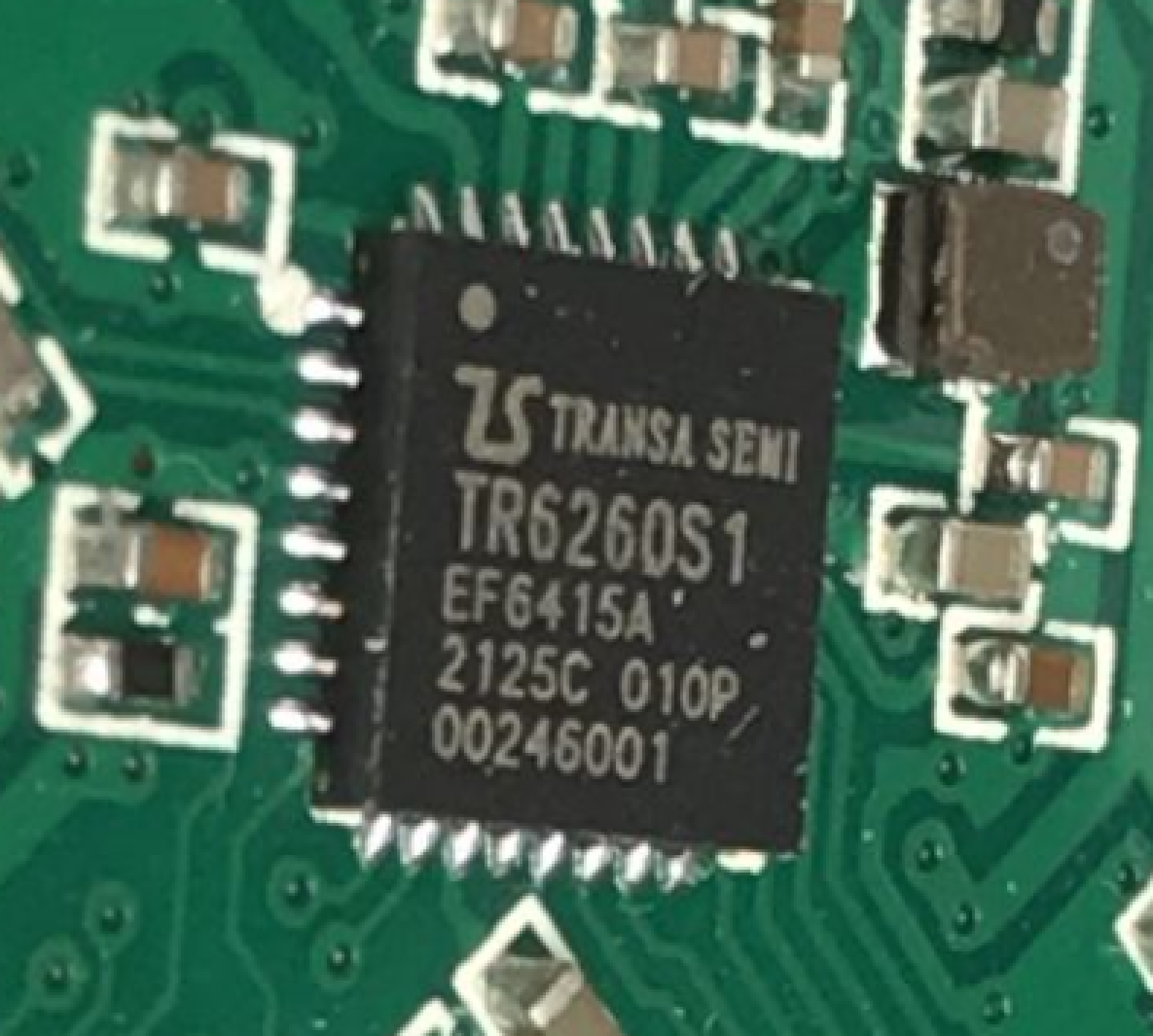

  • Close-up of the TR6260S1 microchip on a green PCB.
    Here's a detailed flashing guide for new TR6260 WiFi chips that can be found in some Tuya smart devices. TR6260 can be easily flashed and run free from the cloud, fully locally, without Tuya servers. This way you can easily pair TR6260 with Home Assistant via Home Assistant Discovery, add custom sensors (like DHT sensors family series or BMP280/BME280 etc), and run local scripts and automations.

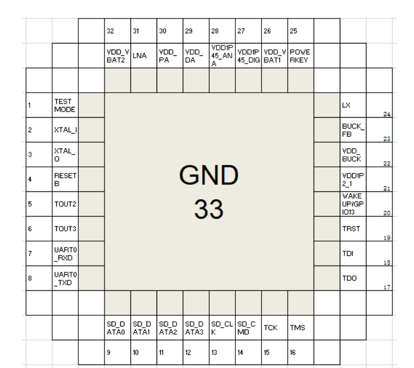

    TR6260 is 32-bit, 2.4GHz WiFi-enabled SoC optimized for smart home/IoT applications, featuring 6x PWM, single ADC, flexible IO interfaces and 1MB of Flash.
    TR6260 chip pinout diagram with pin labels.

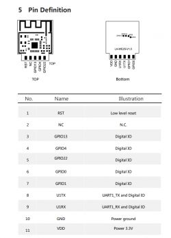

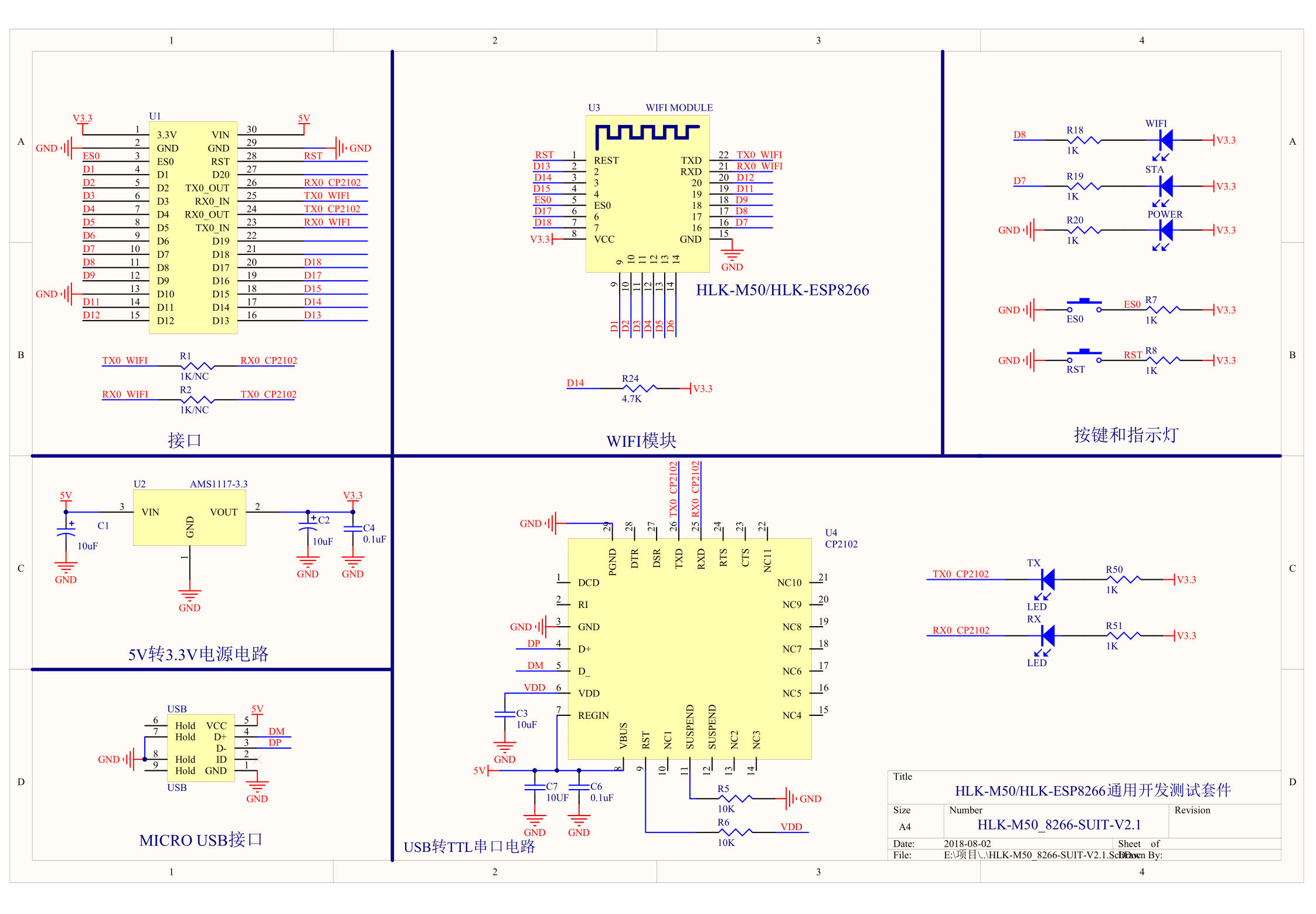

    Schematic:
    Schematic of HLK-M50/HLK-ESP8266 development board with WiFi module.
    In case of this board, everything needed to flash is already present, but if you're going to flash IoT device with TR6260, you will need to have your own USB to UART converter...

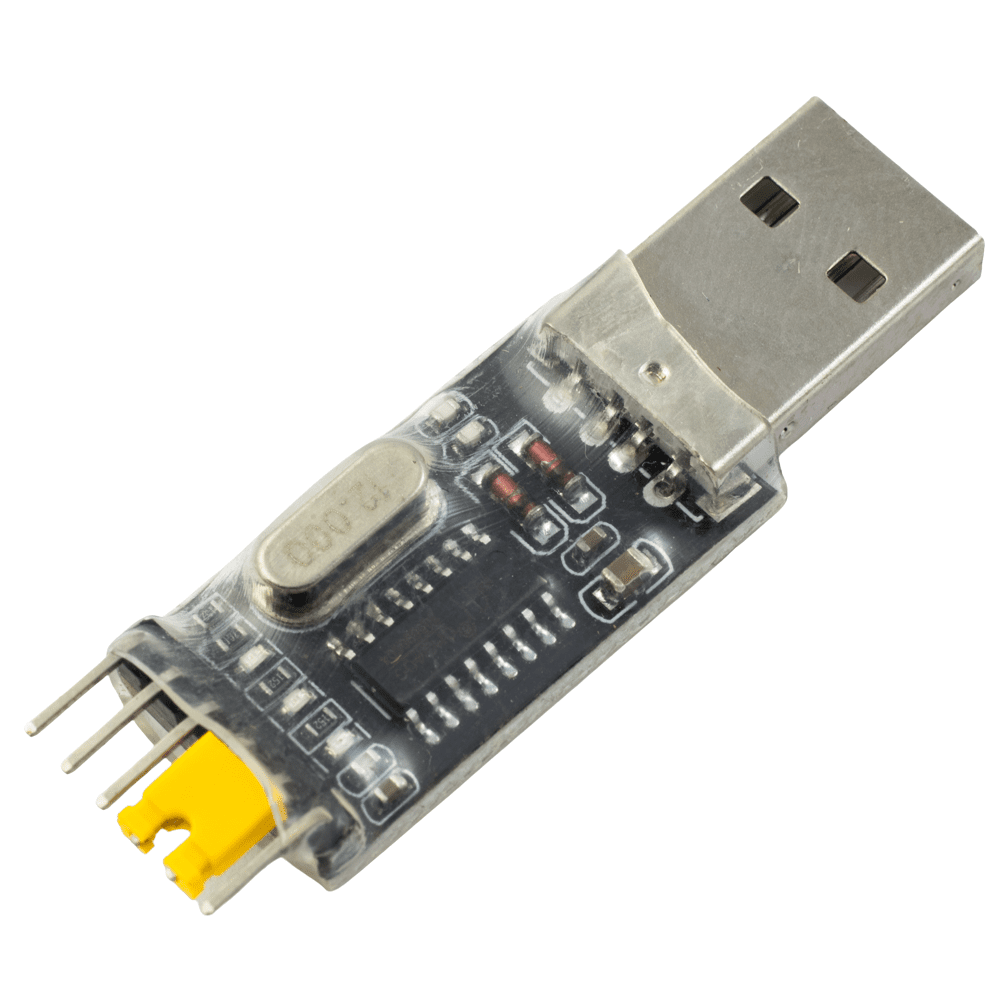

    What do I need to flash TR6260?
    To flash TR6260 found in IoT device, you need a classic USB to UART converter, similiar to ones used for ESP8266/ESP32/BK7231 flashing.
    USB to UART converter with plug and pin connectors.
    You will need to make some GPIO connections, so basic soldering skills are required.

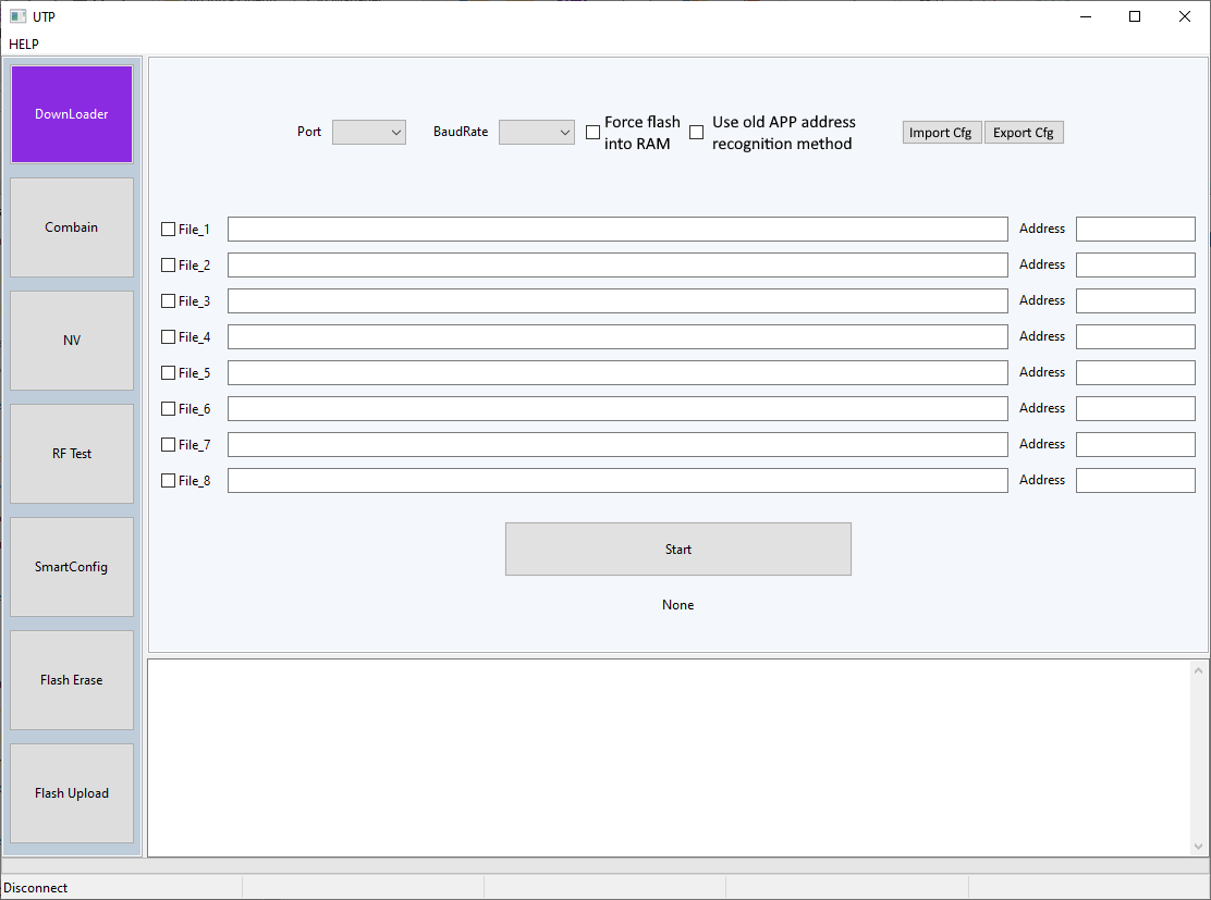

    Here's English translation of UTP gui:
    UTP software interface for flashing TR6260 chips

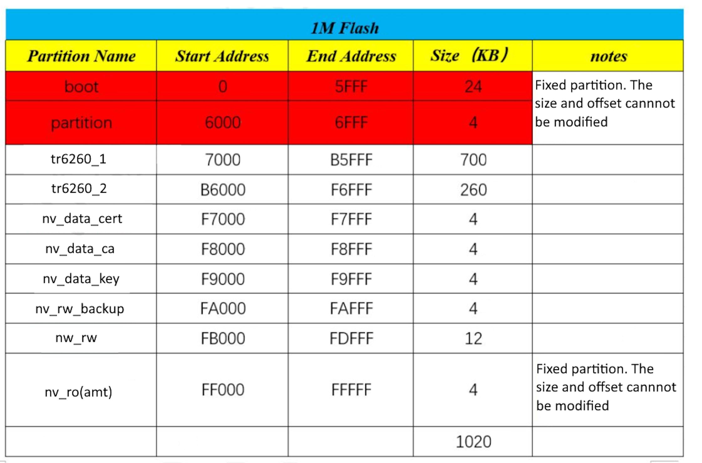

    Translation of the partition table layout:
    https://obrazki.elektroda.pl/5232196400_1732140400.png

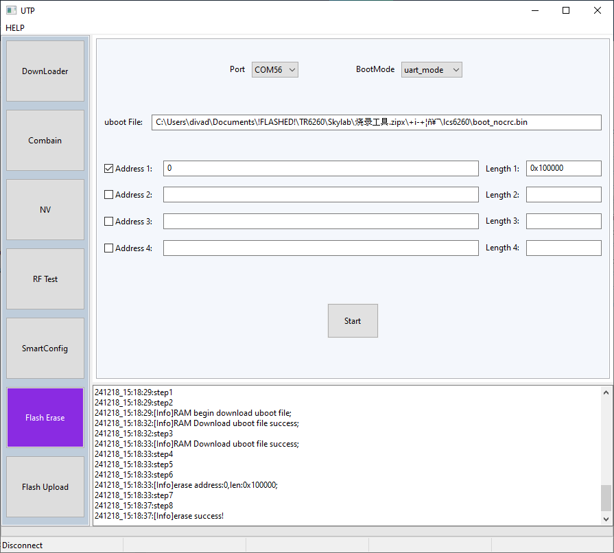

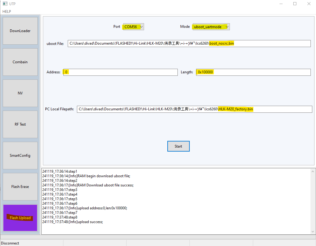

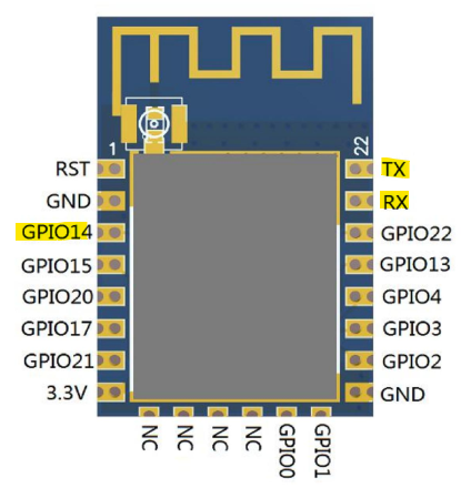

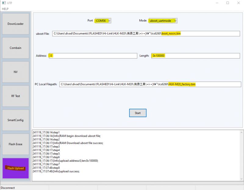

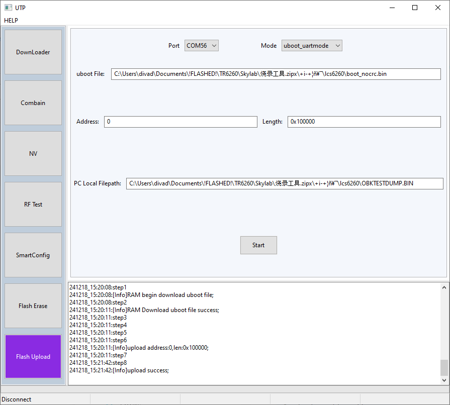

    How to prepare connections and make TR6260 flash dump?

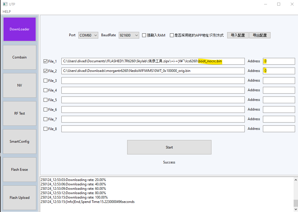

    In the case of the TR6260S1-based Hi-Link HLK-M20 module, which can be used as a template for any TR6260S1 device, a backup of the factory firmware can be achieved as follows:
    GPIO14/TOUT2 needs to be grounded at power-on. Like LN882H this needs to be before power to USB-TTL. Just resetting the device (RST->GND) with GPIO14 grounded will bring it up in spi-flash boot mode, that being standard boot, NOT UART boot mode:
    Screenshot showing a console set to a baud rate of 57600 with messages entry BootRom and spi-flash boot mode.
    If you're watching TX then the correct procedure will give this output:
    Fragment of a terminal window displaying boot mode messages with a selected baud rate of 57600.

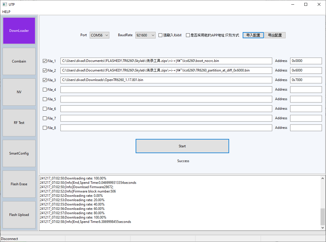

    then configure the UTP program as follows, using the boot_nocrc.bin from the same zip file. The flash is 1mb so length is 0x100000
    PC Local Filepath is just where you want to save the file
    Screenshot of the UTP application showing flash upload settings.
    It takes 2-3 mins and it may look like it has stalled.

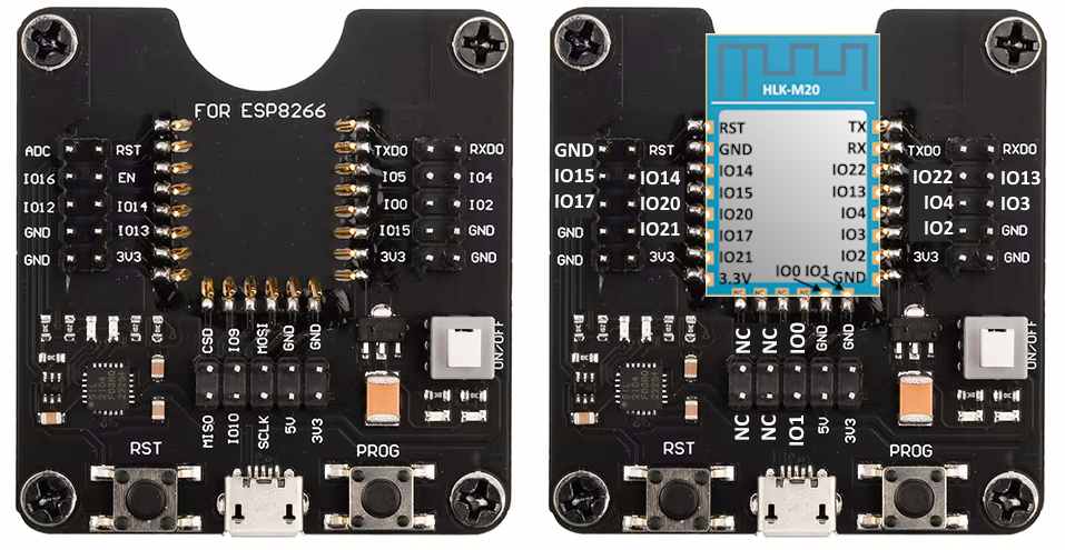

    On the HLK-M20 module GPIO14/TOUT2 pad is the location of EN on ESP-12F, so if using an ESP universal adaptor it's just a case of grounding EN header.
    Diagram of an electronic module with highlighted pins HLK-M20 development board with EN and GND connection points marked.
    If successful, the resultant backup file will be exactly 1,048,576 bytes.

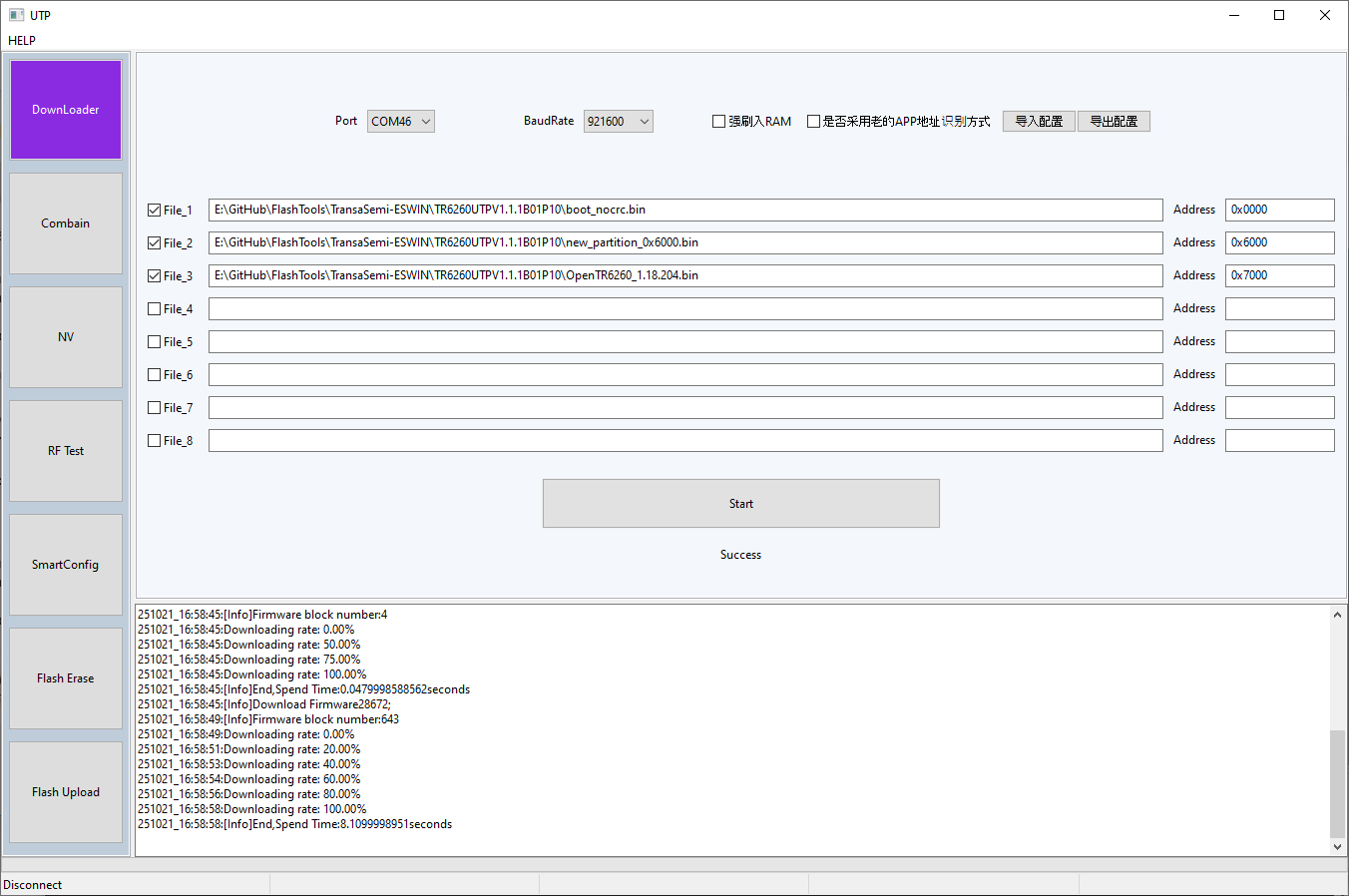

    How to flash new firmware to TR6260?
    Before proceeding, make sure that you have a backup of factory flash. Once you are sure that everything is backed up, it's time to proceed with flashing.
    Ground GPIO14/TOUT2 as shown in the backup procedure and power-on the device
    Set appropriate COM port for your setup and a baud rate. Perhaps start at 921600 baud but reduce if there are issues with stability or connecting at all.
    Download the latest OpenTR6260_xxxx.bin firmware from the releases page.
    Using the partition binaries alongside the UTP program in the zip, configure your file list on the downloader tab to resemble this:
    How to flash TR6260 with open source Tasmota/Esphome style firmware? Guide, pinout, booting
    That being:
    File_1 : boot_nocrc.bin | Address: 0x0000
    File_2 : new_partition_0x6000.bin | Address: 0x6000
    File_3: OpenTR6260_xxxx.bin | Address: 0x7000
    Click Start.
    On completion, power-off and remove GPIO14/TOUT2 from ground. Power on the device and you should see it broadcast an AP like this

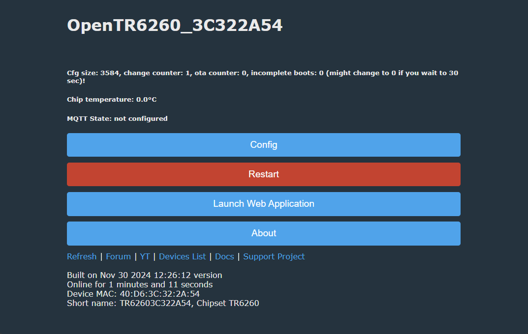

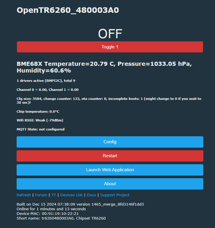

    Wireless network interface OpenTR6260 visible on the screen.

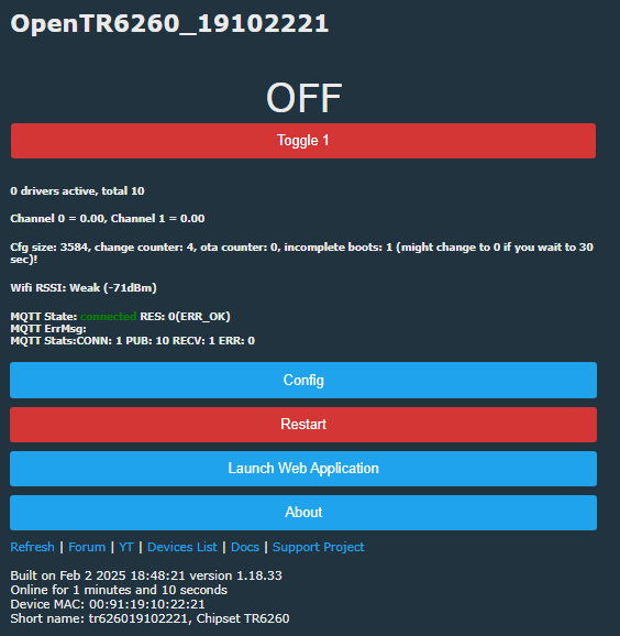

    Connect to the AP (no password required). When connected browse to 192.168.4.1 where you can configure OpenBK as normal.
    OpenTR6260 user interface with configuration information and buttons

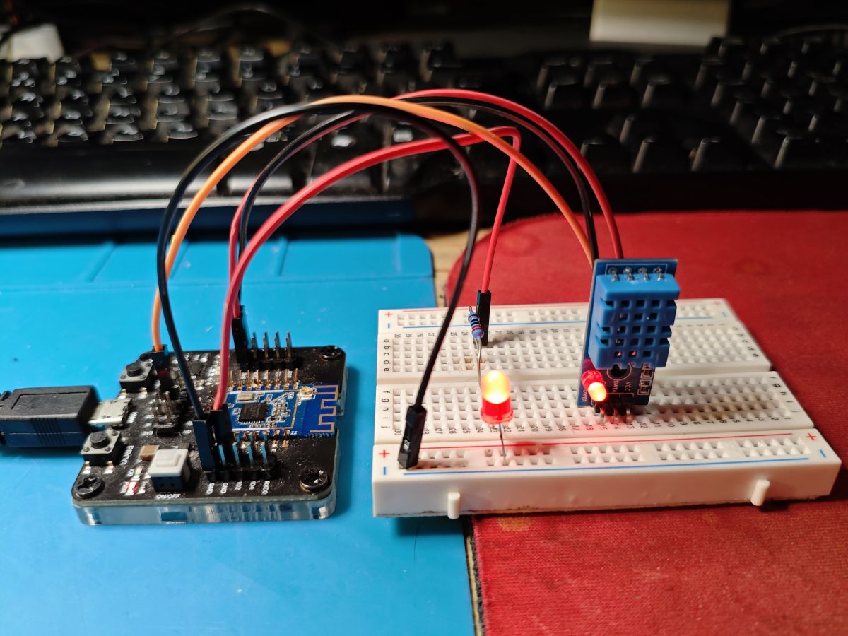

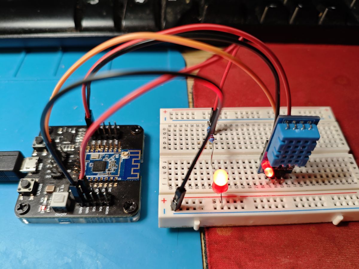

    OpenTR6260 demo - DHT11 sensor
    OpenBeken port for TR6260 supports DHT11, which can be configured just like we've shown on our "Weather station" video for W600:
    Sample connection:
    Development board with a WiFi module and sensor connected to a breadboard with an LED. Development board with WiFi module and DHT11 sensor on a breadboard
    Video presentation - there is also a LED on Rel pin, so clicking button toggles it as expected. The read humidity and temperature is also visible on the main page as expected.
    OpenTR6260 demo - DME280 sensor
    BME280/BMP280 is also supported. For that, you need to create autoexec.bat with script:
    //startDriver BMPI2C [CLK] [DATA] [ChannelForTemp] [ChannelForPressure] [ChannelForHumidity] [Addr]
    startdriver bmpi2c 0 1 2 3 4
    If driver is missing, make sure that it is included in build - check obk_config.h.
    OpenTR6260 configuration interface with temperature, pressure, and humidity details.

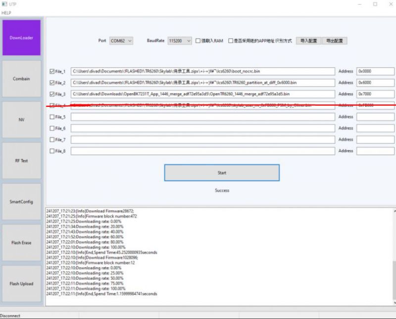

    Erasing flash showed no data at FB000
    #2 21353666
    Posts: 5232
    Help: 449
    Rate: 918

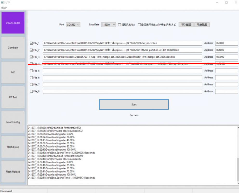

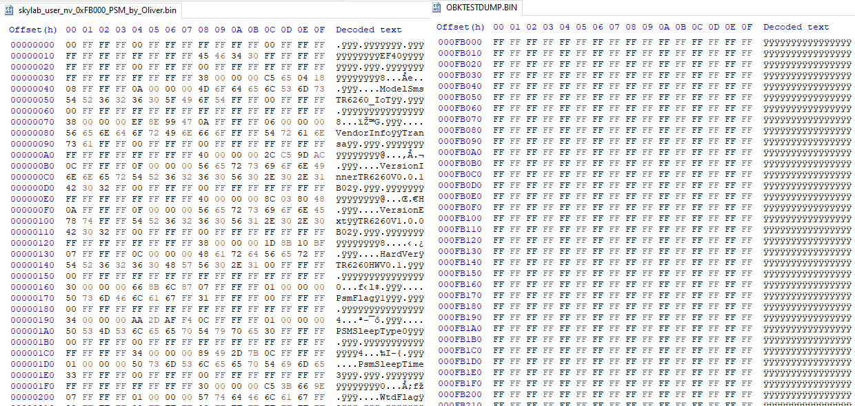

    File_4: IGNORE IT, no longer needed.
    I didn't consider dropping this file to determine the effect. To see what was at FB000 after flashing without the skylab_user_nv_0xFB000_PSM_by_Oliver.bin file selected, I first erased the whole flash. This was done as follows with TOUT2/GPIO14 grounded:
    Screenshot of UTP software with Flash Erase option selected.
    then flash again fresh
    Screenshot of Flashing Software with several binary files selected.
    boot OBK, join to wifi. then read the whole flash to file
    Screenshot of a software flashing program with flash settings and log.
    then compare from FB000 of the OBK backup to the start of skylab_user_nv_0xFB000_PSM_by_Oliver.bin in HxD
    Nothing
    Comparison of two binary file contents in a hex editor.

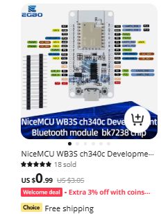

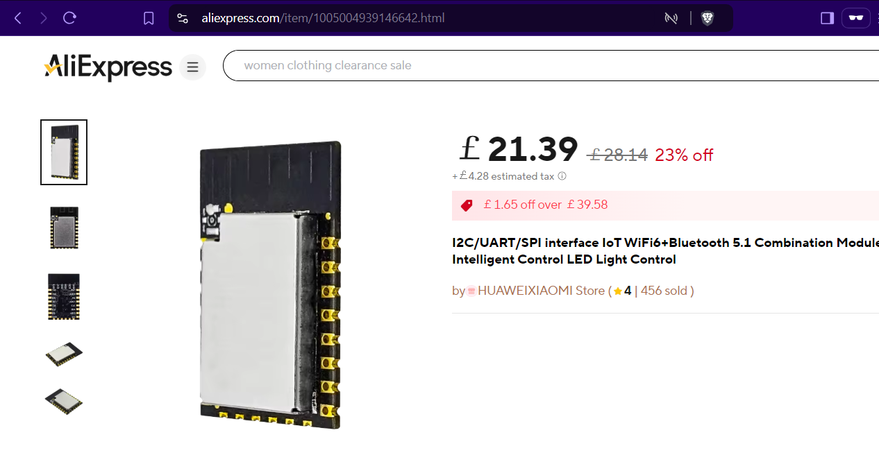

    What's there? A module image flashes for a second and then I get "not available in my country". I can't view this offer.
    Btw, some devices can be bought cheaper if you're creating a new aliexpress account. For example, BK7238:
    Image of a NiceMCU WB3S ch340c development module with BK7238 chip on AliExpress.

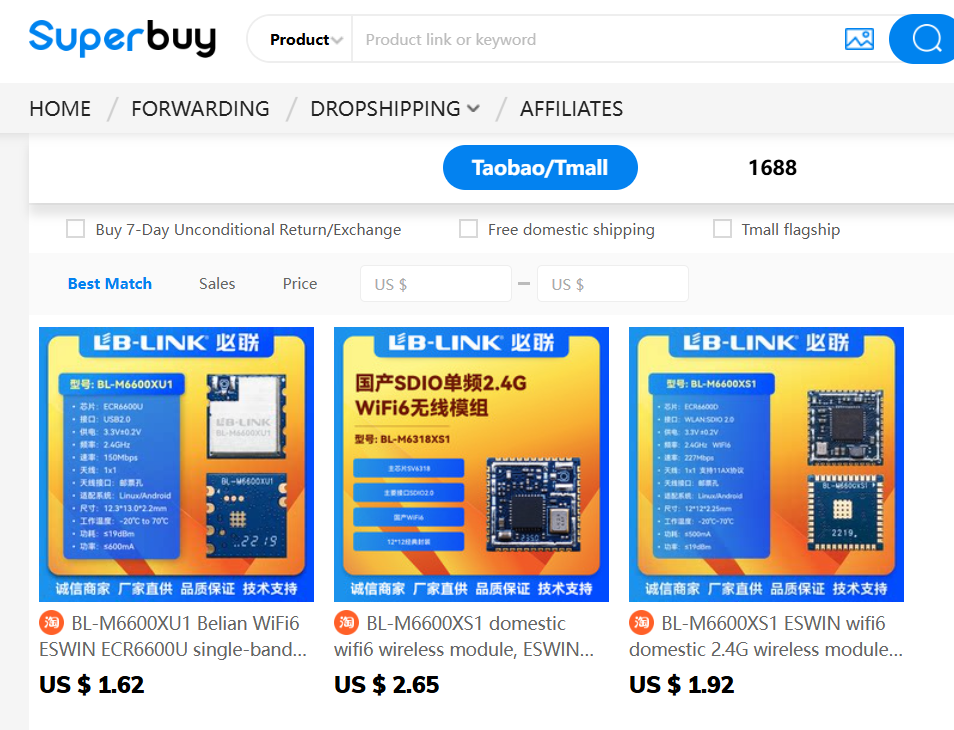

    rip-off.
    Some other options maybe:
    Screenshot of the Superbuy website featuring BL-LINK WiFi modules. Screenshot from Superbuy site showing wireless module BL-M6600XS1 priced at $1.18 from Guangdong warehouse.
    no welcome deal on those Skylabs on Ali for me
    IoT electronic module with WiFi6 and Bluetooth interface displayed on an AliExpress page at a promotional price of £21.39.

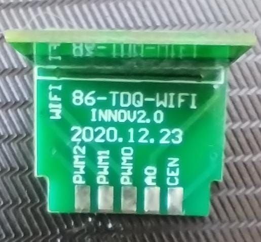

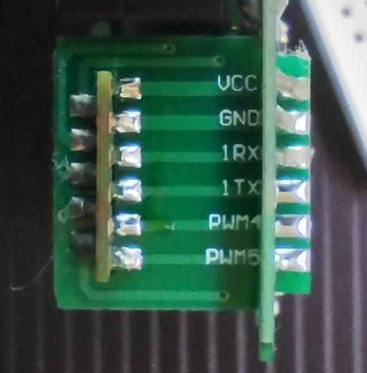

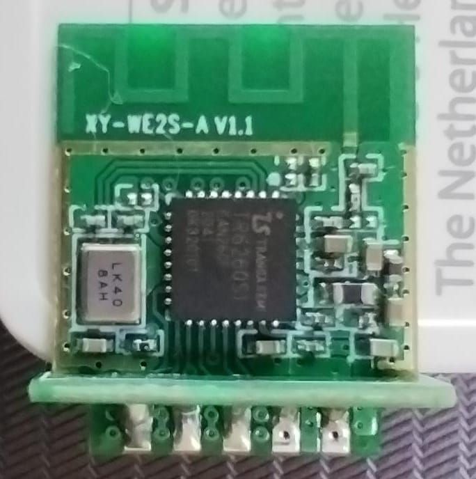

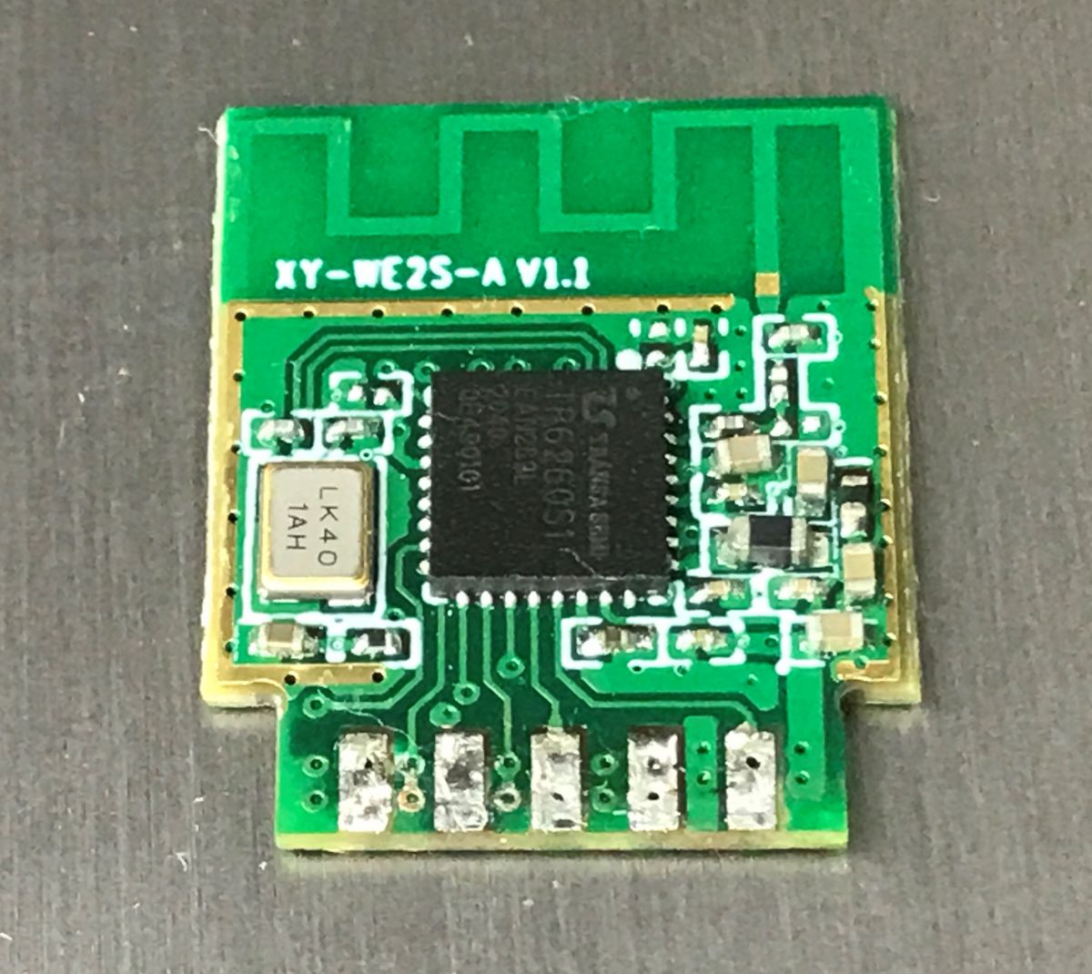

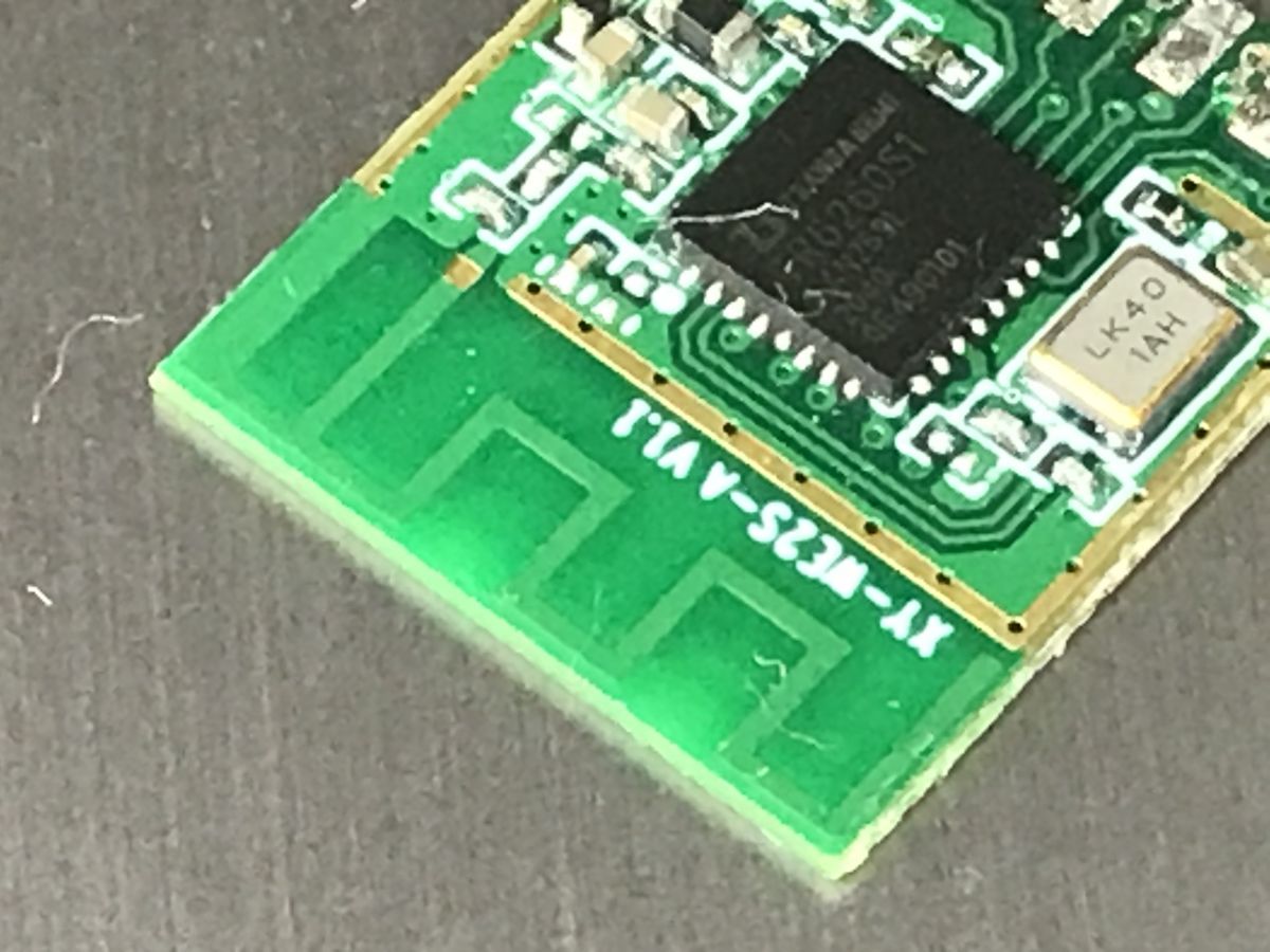

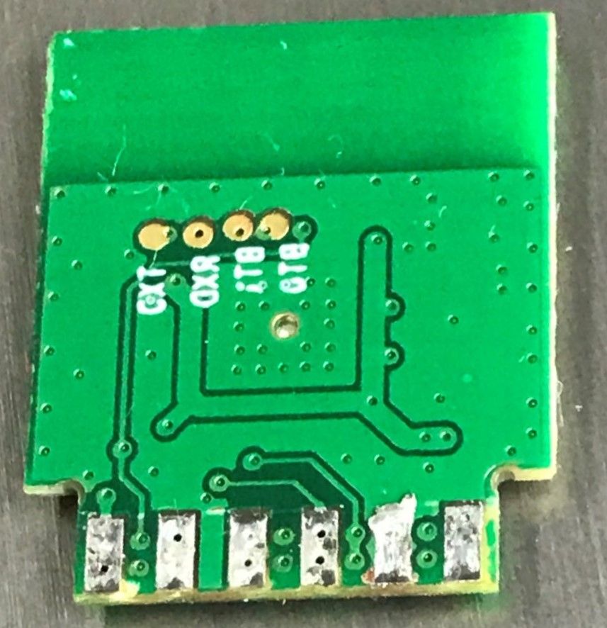

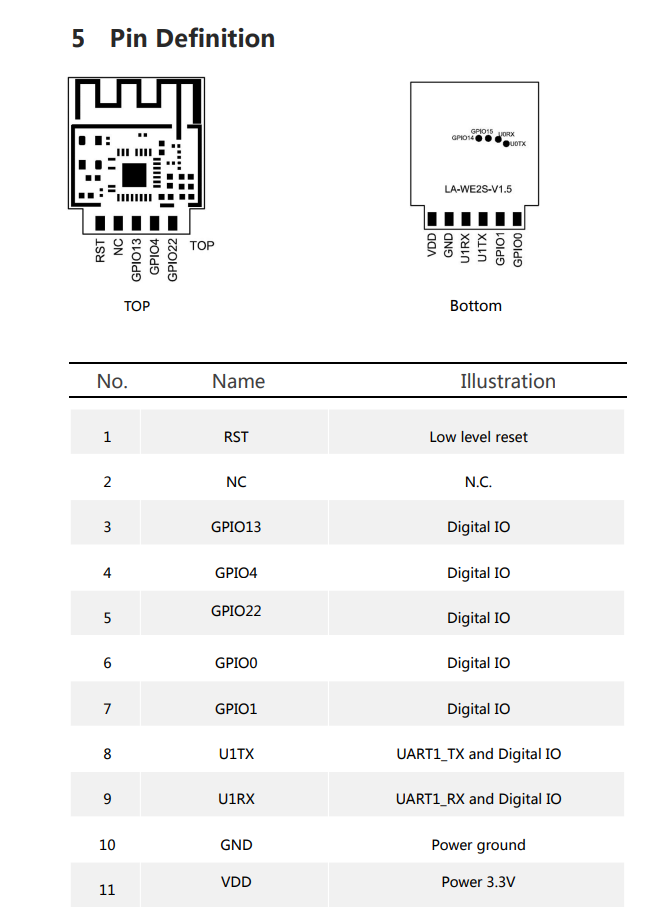

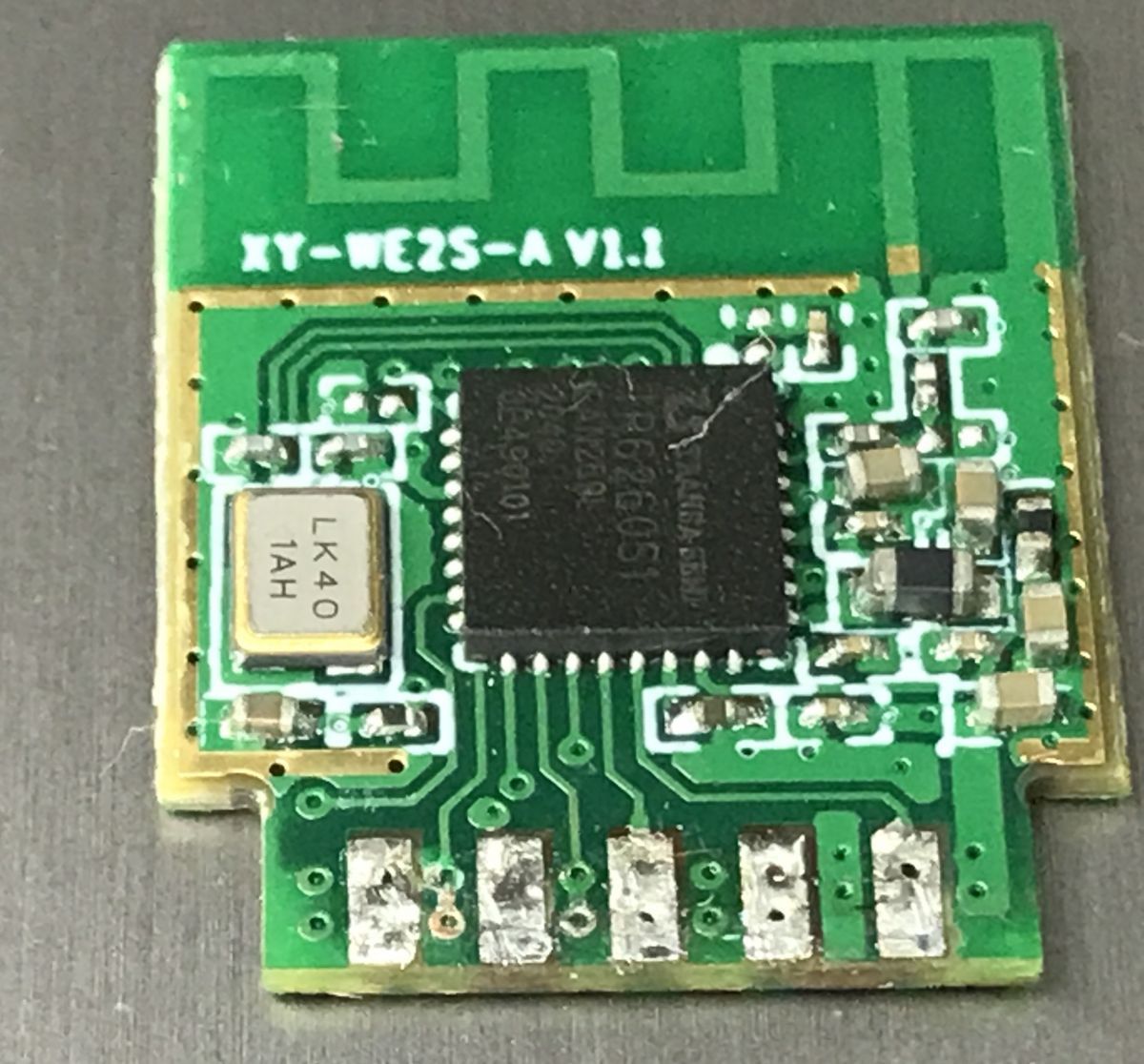

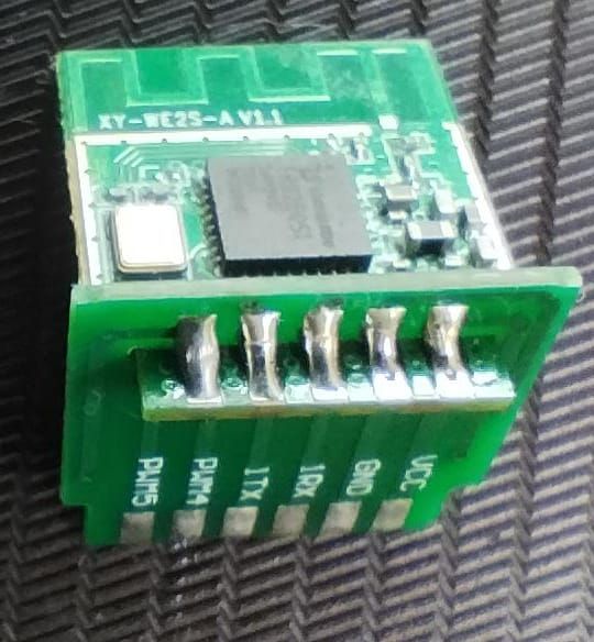

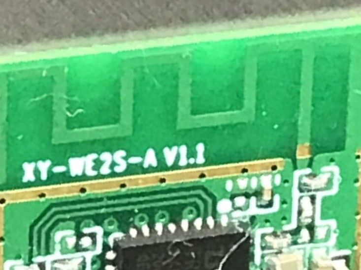

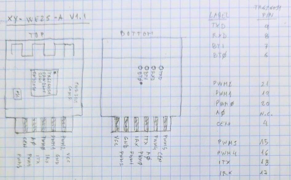

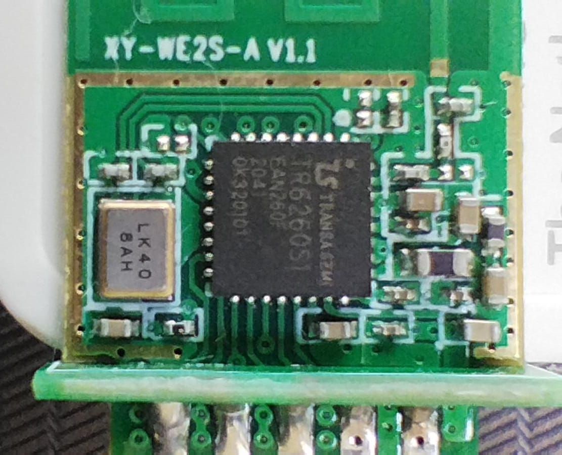

  • Request for info on XY-WE2S-A V1.1 module
    #7 21361629
    Posts: 14791
    Rate: 12937
    I've found this module. Some reader must have sent it to me.
    Image of a green electronic module labeled XY-WE2S-A V1.1. Close-up of a green electronic module XY-WE2S-A V1.1 with visible tracks and soldering points. Close-up of an electronic module labeled XY-WE2S-A V1.1 with visible components and traces. Close-up of an electronic board labeled XY-WE2S-A V1.1.
    XY-WE2S-A V1.1
    Hmm https://www.elektroda.com/rtvforum/find.php?q=XY-WE2S-A+V1.1
    Anyone has any info? If not, I will have to try tracing the tracks...

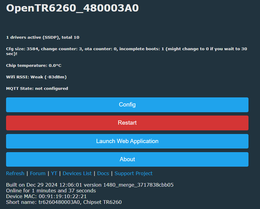

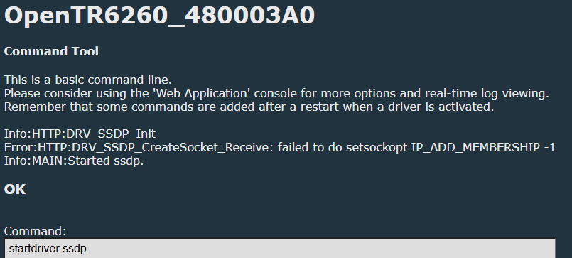

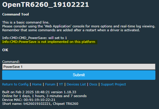

    SSDP on TR6260 observation
    Command tool interface with SSDP error messages.
  • #11 21367078
    Posts: 14791
    Rate: 12937
    We need to enable multicast in LWIP like we did on Beken

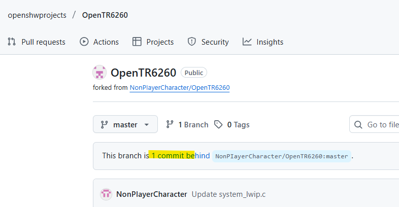

    https://github.com/openshwprojects/OpenBK7231...mmit/b0f232db5f17b3ac558580767a677f2a2ee6d488
  • Wemo emulation works and Alexa discovers device
    #13 21367101
    Posts: 5232
    Help: 449
    Rate: 918
    just saw you make that. was looking for the TR6260 SDK in openshwprojects initially :)

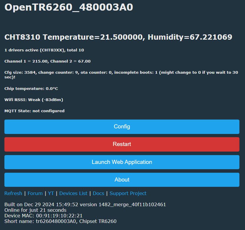

    Added after 21 [minutes]:

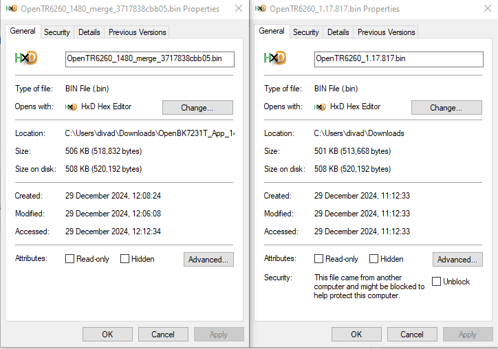

    File icon with the name OpenTR6260_480003A0.
    OpenTR6260 user interface with system status information
    Properties windows for two binary files displayed in the HxD hex editor.
    Added after 9 [minutes]:
    maybe already tested, but here's WEMO success anyway. Alexa discovers successfully.
    Screenshot from an app showing a file named OpenTR6260_480003A0 labeled as Recently added.

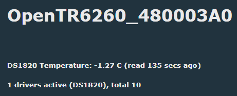

    Display of OpenTR6260 system with DS1820 sensor temperature.
    DS18B20 unchanged. I'm just refreshing my memory on what is working and what isn't right now
    Added after 3 [hours] 25 [minutes]:
    Screenshot of the user interface for the OpenTR6260 device with temperature and humidity information. Properties windows of two BIN files in HxD Hex Editor.
    Added after 1 [hours] 32 [minutes]:
    what's the deal with the SHT3X driver not being definable as ENABLE_DRIVER_SHT3X in obk_config.h?
    Added after 53 [seconds]:

    Some useful info on ECR6600
    E103-W11_U...N_v1.3.pdf (1.1 MB)You must be logged in to download this attachment. E103-W11 A...ual_EN.pdf (644.61 kB)You must be logged in to download this attachment.
    Real pinout mapping for XY-WE2S-A module
    #15 21405320
    morgan_flint
    Posts: 251
    Rate: 63

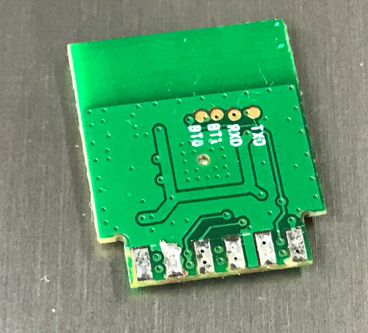

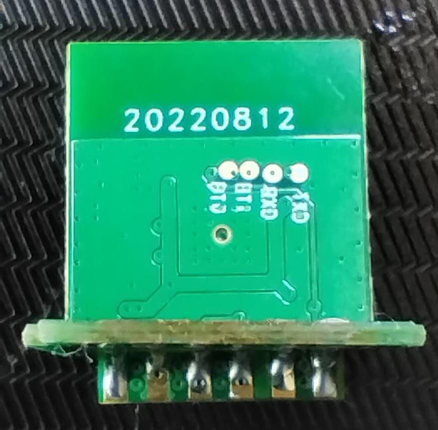

    Flashing module XY-WE2S-A
    Although almost all of the info is already included in some posts in this other thread (read from this post), I think it's good to order it a bit and put it here in the flashing thread.
    First of all, some photos of the module (mine has a 90º adapter that has the advantage of including labels of the pinout in the silkscreen):
    XY-WE2S-A module with pin labels on the side Bottom side of module XY-WE2S-A, showing pads and pin labels. XY-WE2S-A module with visible pins. View of the bottom side of the module with pin labeling and production date. XY-WE2S-A V1.1 module with visible components and integrated circuit. XY-WE2S-A module with TR6260S1 chip Side view of the XY-WE2S-A module showing pins: VCC, GND, 1RX, 1TX, PWM4, PWM5.
    Three more pictures, borrowed from this post, that I edited to help me to trace the tracks to find the pinout:
    Image of the bottom side of the XY-WE2S-A module with visible pinout. Close-up of electronic module XY-WE2S-A V1.1 with visible components and traces. XY-WE2S-A V1.1 module with visible electronic components
    (the photo of the bottom side is mirrored to help match vias from the top layer)
    The pinout and the correspondence between chip pins and module pads:
    Sketch of the pin layout for the XY-WE2S-A V1.1 module
    Unfortunately, the chip's pinout doesn't coincide with any of the datasheets or images posted in this forum! @divadiow also encountered this problem with HLK-M20 module, as he explained here. This table shows the differences between the datasheets and the "real" pinout of the chip in our modules:
    LABELIC PIN TR6260S1 datasheetTR6260 datasheetdivadiowReal Pin
    TX09 UART0_RXD SD_DATA0TXUART0_TXD
    RX08 TOUT3 UART0_TXDRXUART0_RXD
    BT1 7 TOUT2UART0_RXD-TOUT3
    BT0 6WAKE_UPTOUT3IO14TOUT2
     -10UART0_TXDSD_DATA1-?
    PWM221VDD1P2_1VDD1P2_1-GPIO22
    PWM119TRSTTRST-GPIO4
    PWM020GPIO13GPIO13-GPIO13
    A0not connected----
    CEN4TEST MODERESETB-RESETB
    PWM515TCKTCK-TCK-GPIO0
    PWM416TMSTMS-TMS-GPIO1
    ITX18TDITDI-TDI-GPIO3
    IRX17TDOTDO-TDO-GPIO2
    Maybe somebody here can find a TR6260S1 datasheet that is consistent with the "real" pinout... I've tried, unsuccesfully.
    So, to read or flash the module, we need to use the pads at the bottom side of the PCB, and connect those labeled TXD and RXD to USB to serial adapter's RXD and TXD, respectively. BT0 should be connected to GND, to set the chip in UART boot mode (as specified in the first post). Of course, VCC and GND should be connected to 3.3V and GND in the USB to serial adapter (which should be prepared for 3.3V levels at TXD and RXD). In my case, I prefer to connect VCC the last after plugging the USB to serial adapter to the PC.
    The rest of the backup/flashing procedure is as described in the first post. Many thanks to @p.kaczmarek2!!
    BTW, to have a correct log of the serial output when booting with BT0 grounded (to check it was booting in the correct mode), I had to set the baud rate to 58000, instead of the standard 57600, which showed strange characters:
    BT0 to GND - 57600 baud:

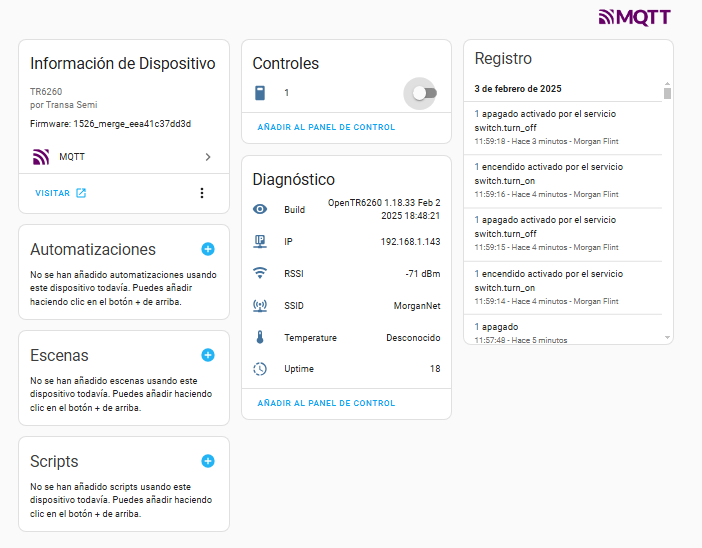

    This is the output at the serial port after flashing OBK:

  • Requesting pinout and flashing info for XY-WE2S-A V1.1
    #16 21405622
    micbanand
    Posts: 13
    XY-WE2S-A V1.1
    it was me who send you 2 of them :)
    is there a solution for it know.
    Gues I have to read upon this new thread

  • Flashing full backup requires boot_nocrc.bin first
    #20 21407688
    Posts: 5232
    Help: 449
    Rate: 918
    also worth mentioning that although I said about splitting the file here you can flash the whole backup from 0 as long as you also choose boot_nocrc.bin from 0 first
    Screenshot of a flash management program with visible file paths and port settings.
    with just the 1mb backup specified it'll fail with
  • #21 21416923
    morgan_flint
    Posts: 251
    Rate: 63
    Yes, I can confirm that, that's the way I flashed my backup (provisionally) to the device after having tested the module with OBK

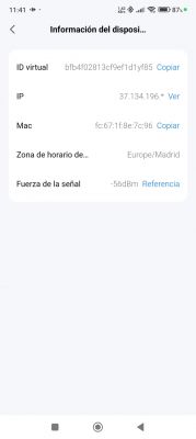

  • Weak WiFi RSSI after flashing OBK firmware
    #26 21421792
    morgan_flint
    Posts: 251
    Rate: 63

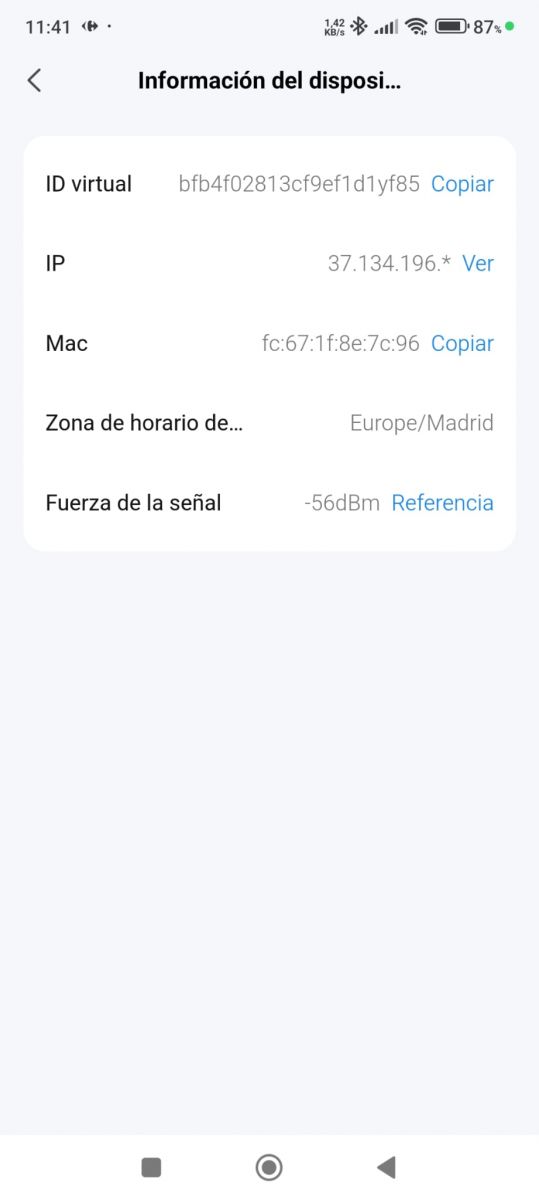

    I saw the PR is now merged, so I flashed the last official version and everything went well:
    Screenshot of OpenTR6260 interface displaying device information.
    I also configured MQTT to test it from Home Assistant, with good results:
    Screenshot of a user interface displaying information about the TR6260 device.
    I understand that the temperature is "unknown" because the sensor must be missing in this chip. If I remember well, it appeared before on the main OBK page but has already been removed. Shouldn't it be removed from MQTT as well?

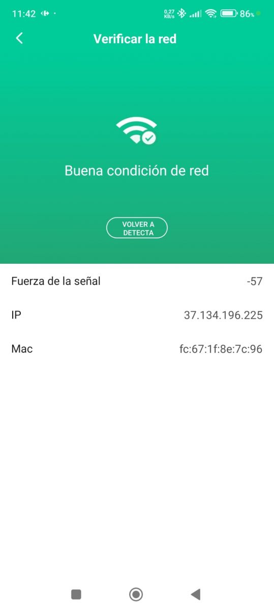

    Another question: Although the device is in the same room as my router, the WiFi signal appears to be very low. This doesn't happen with my other OBK devices. Could it be because of some kind of RF configuration (similar to that in Belken chips) that could have been lost in the flashing process? In this case: Could it be recovered from the initial backup?
    EDIT: Just seen I hadn't really flashed the latest official release, as the screenshot still showed the merged one. I flashed OBK again (previous screenshot updated) after first flashing the original FW (full 1MB backup), to check if that corrected the WiFi signal strength issue, with no luck, as it continues to be weak (-71dBm) at 1.5 meters from the router. With the original FW, the RSSI in the same exact location was -56 - -57 dBm:
    Screenshot displaying device information, including ID, IP address, MAC, time zone, and WiFi signal strength. Screenshot of an app displaying WiFi signal strength, IP address, and MAC address.
    Has anybody else noticed this weakening of the signal strength?
  • Questions about PowerSave 1 and WiFi RSSI on TR6260
    #27 21426466
    morgan_flint
    Posts: 251
    Rate: 63
    @p.kaczmarek2 and/or @insmod, some more questions about OpenTR6260: I've seen here that PowerSave 1 is advisable in these "Smart switches" to avoid overloading the power supply. Is it also the case for those with TR6260?
    Also, regarding the issue with WiFi RSSI mentioned before, is there an explanation for that? Is that important? I mean, could it simply be a problem in the reported data, being WiFi connection still as good as with the original FW?
    Thank you very much in advance!
    EDIT: Sorry, this answers my first question:
    Screenshot of the OpenTR6260 interface indicating that PowerSave is not implemented.

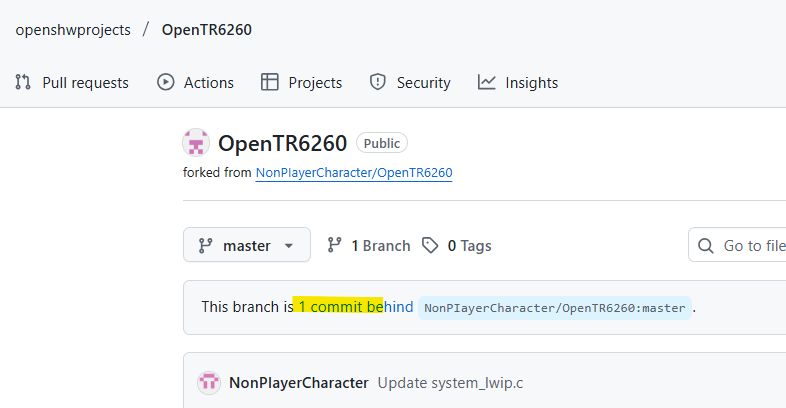

  • #30 21620017
    Posts: 5232
    Help: 449
    Rate: 918
    should this be a PR and merged?
    Master branch is 1 commit behind NonPlayerCharacter/OpenTR6260:master
