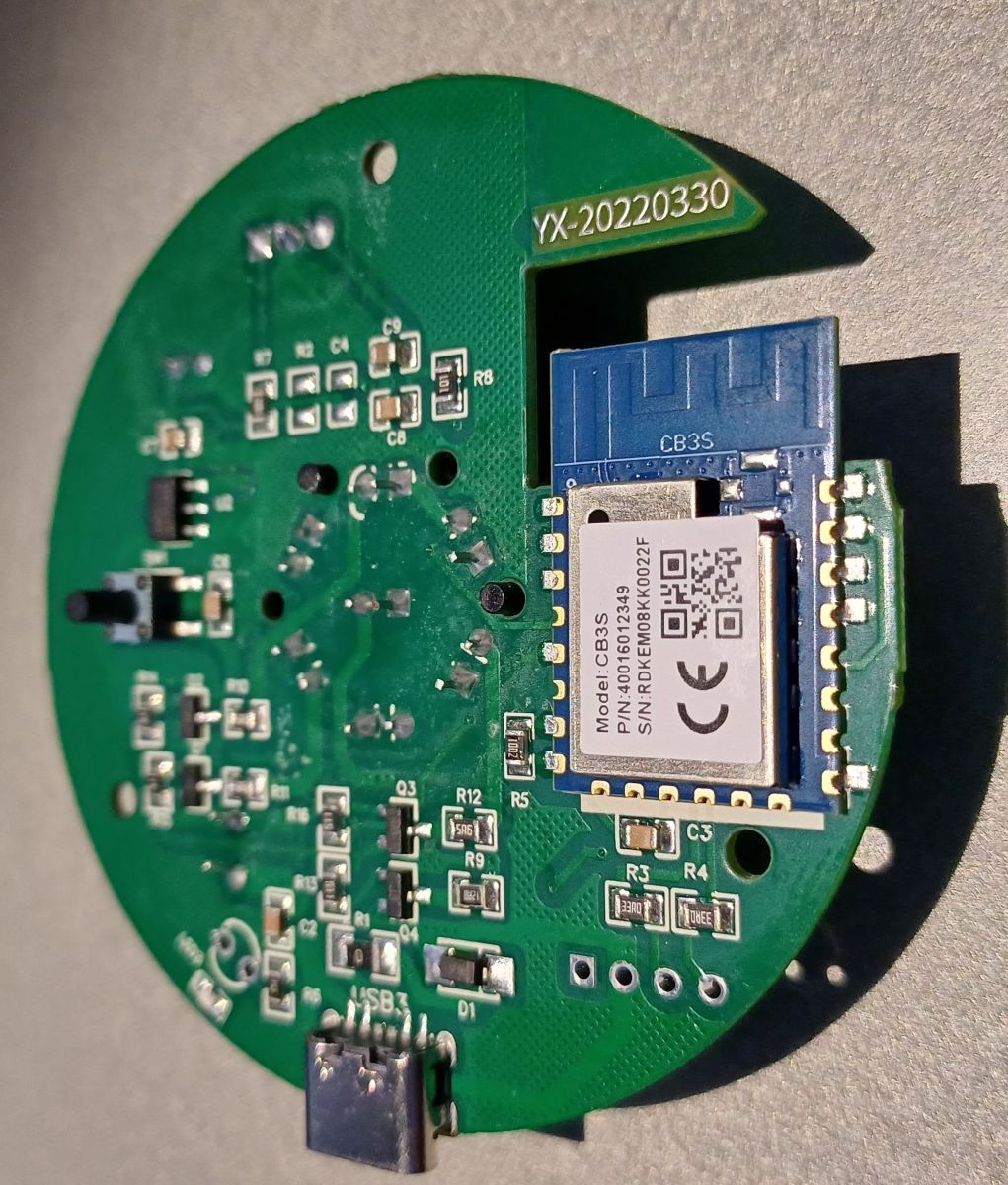

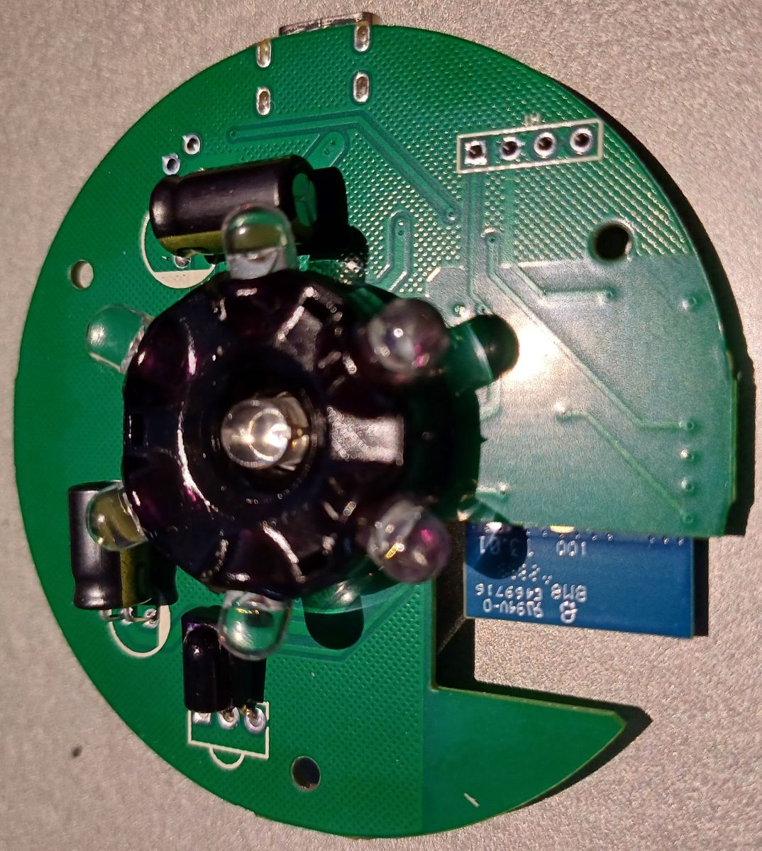

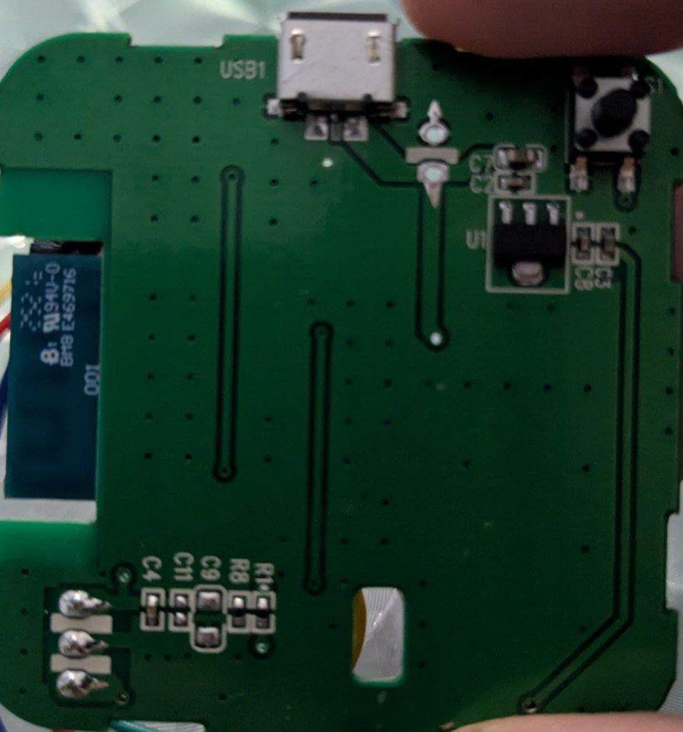

  • The Tuya S06 IR Blaster uses a CB3S module, and the S06Pro comparison shows a similar case but a different PCB and chip.
  • Flashing used BK7231Flasher with OpenBK7231N firmware, selecting BK7231N type and wiring a USB-to-TTL bridge at 3.3V.
  • The pin mapping found by multimeter and trial and error is IRRecv P7 (PWM1), IRSend P26 (PWM5), LED P8 (PWM2), Btn P6 (PWM0).
  • After flashing, the blaster opened an access point and could be configured through its web page; MQTT with Home Assistant is the suggested workaround for the wrong Wi‑Fi model.

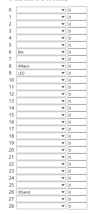

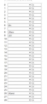

    I managed to get it working, model with chip (WB3S) I attach the 100% working configuration =)
    Screenshot of a device configuration with WB3S chip, showing a list of settings numbered from 0 to 28, including functions like Btn, IRRecv, LED, and IRSend.

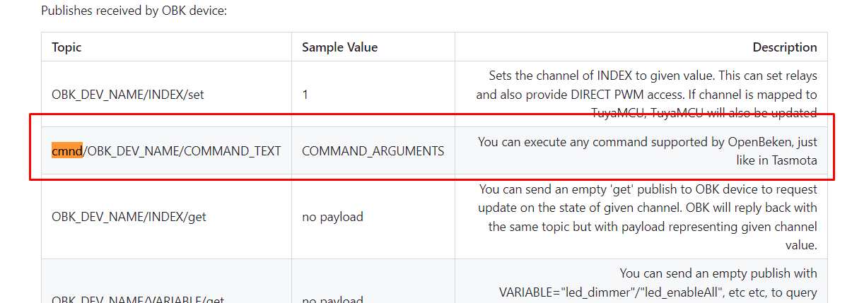

    If you can send IR commands from logs tab, then you can also run them via MQTT. We have a cmd interface to execute commands via HASS:
    https://github.com/openshwprojects/OpenBK7231T_App/blob/main/docs/mqttTopics.md
    A section of a table from MQTT documentation with a highlighted field regarding commands.
    Then you just need to make the certain MQTT publish on Home Assistant side. You can check out this topic to see how to make such a button in hA:
    https://www.elektroda.com/rtvforum/topic4015423.html

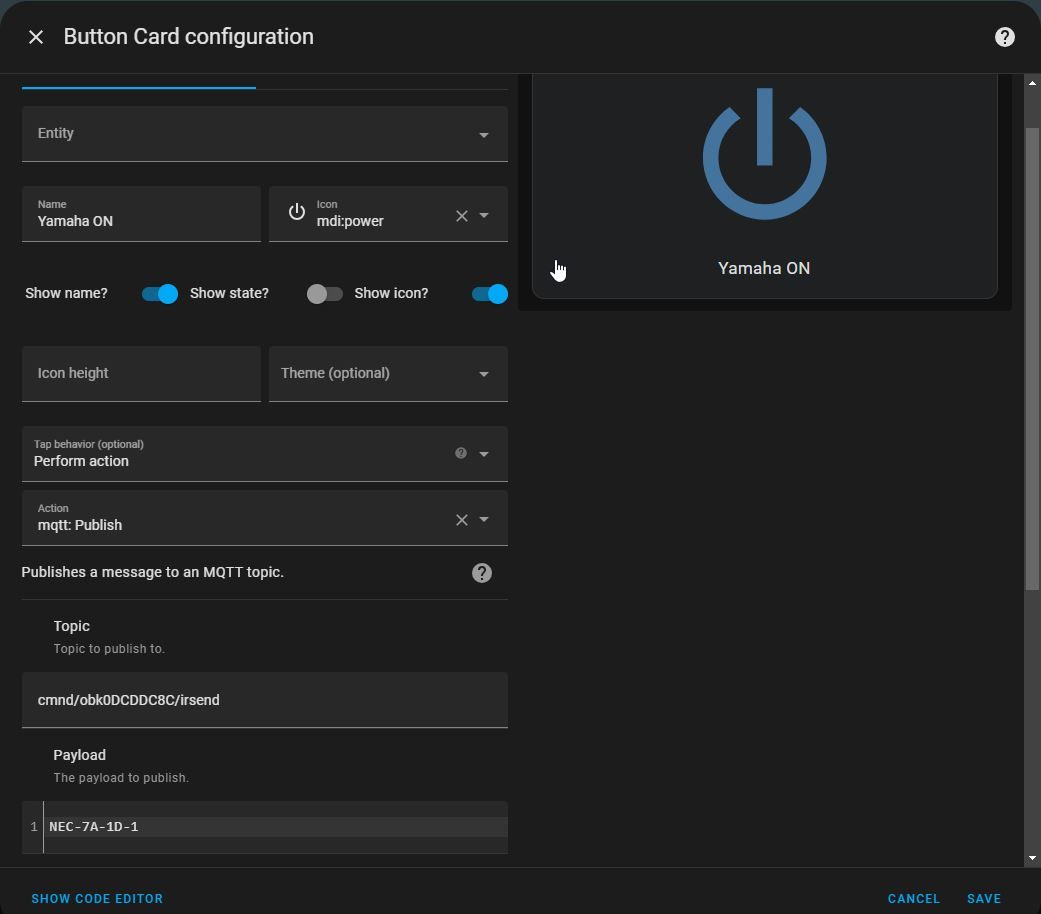

    Thanks a lot, it was really helpful. I've managed to create a button in HA that will turn on my Yamaha receiver.
    The button card config is as follows:
    Screenshot of button card configuration in Home Assistant for turning on Yamaha amplifier.
  • #38 21209673
    Posts: 14755
    Rate: 12879
    If you want, you can also share Yaml code, it's possible to copy it from HA as well
  • #39 21209679
    campeanu
    Here it is:

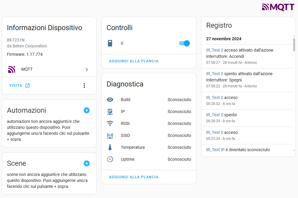

    #40 21321614
    Buddy79
    Hello everyone.
    I purchased this IR transmitter, I performed the various operations:
    Flash the chip
    WiFi connection
    Setting the device name
    MQTT configuration
    Discovery on Home Assistant
    The device is now working and connected to Home Assistant. It works correctly both to receive IR signals and to send them to my TV.
    My problem is that on Home Assistant it only sees the Button entity and the diagnostic entities do not update.
    Home Assistant configuration interface for an IR transmitter with device information, controls, and diagnostics.
    If I click on the button it works, the LED turns off and on.
    How can I also add the IR entity to be able to send / receive commands and enable the diagnostic entities?
    I think I'm missing a step to configure them... but I haven't found it.

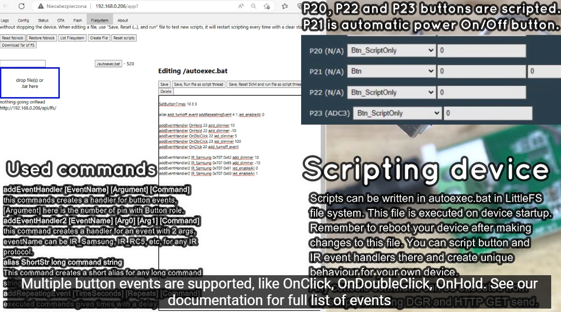

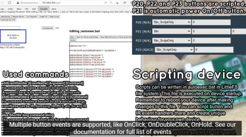

    Screenshot showing the interface for editing the autoexec.bat script in an IoT device with support for commands and scripting.

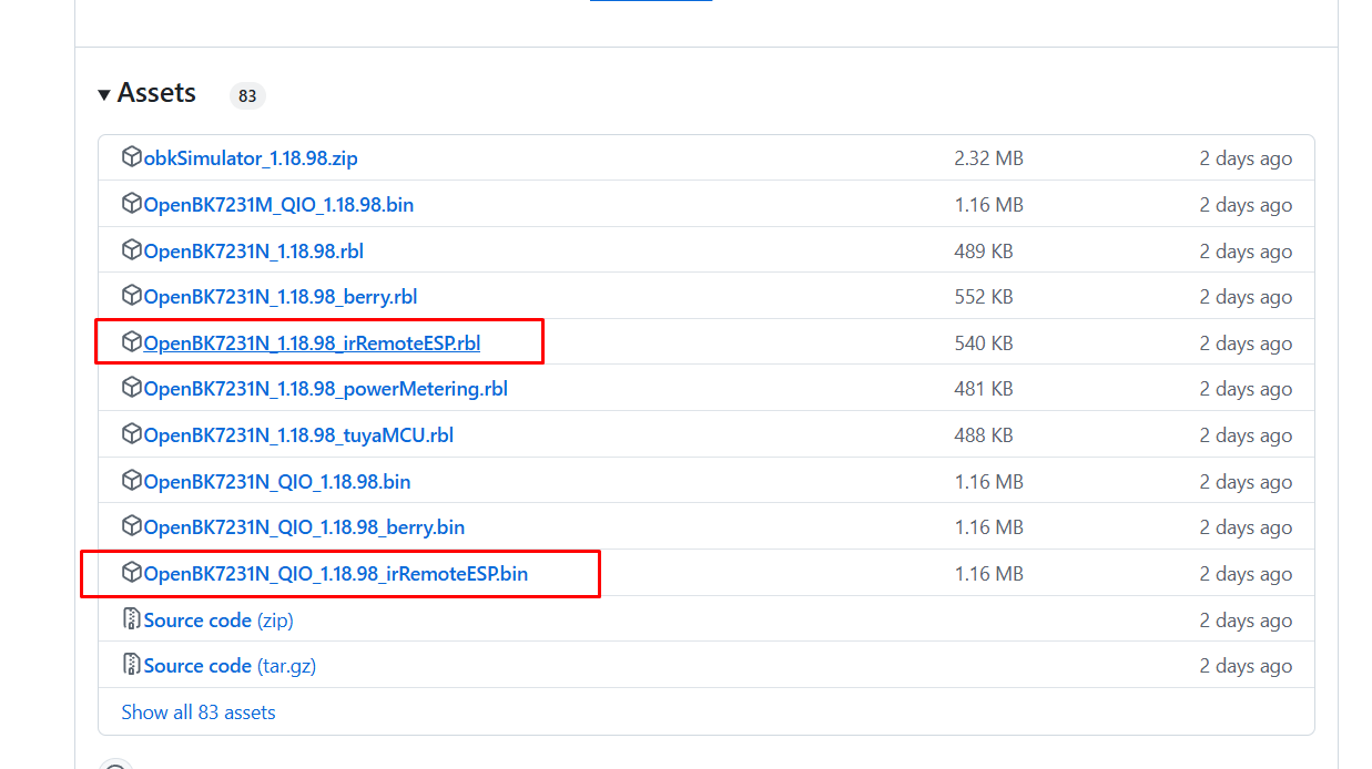

    OBK alternative IR library (the one with hvac codes) can now be downloaded from Releases as well:
    https://github.com/openshwprojects/OpenBK7231T_App/releases
    A list of downloadable files for the OpenBK7231N project, with two irRemoteESP-related files highlighted.
    It's based on old vfonov'PR . Core OBK is using Arduino-IRRemote, while the marked extra binary is using IRRemoteESP port. Choose whatever works best for you.

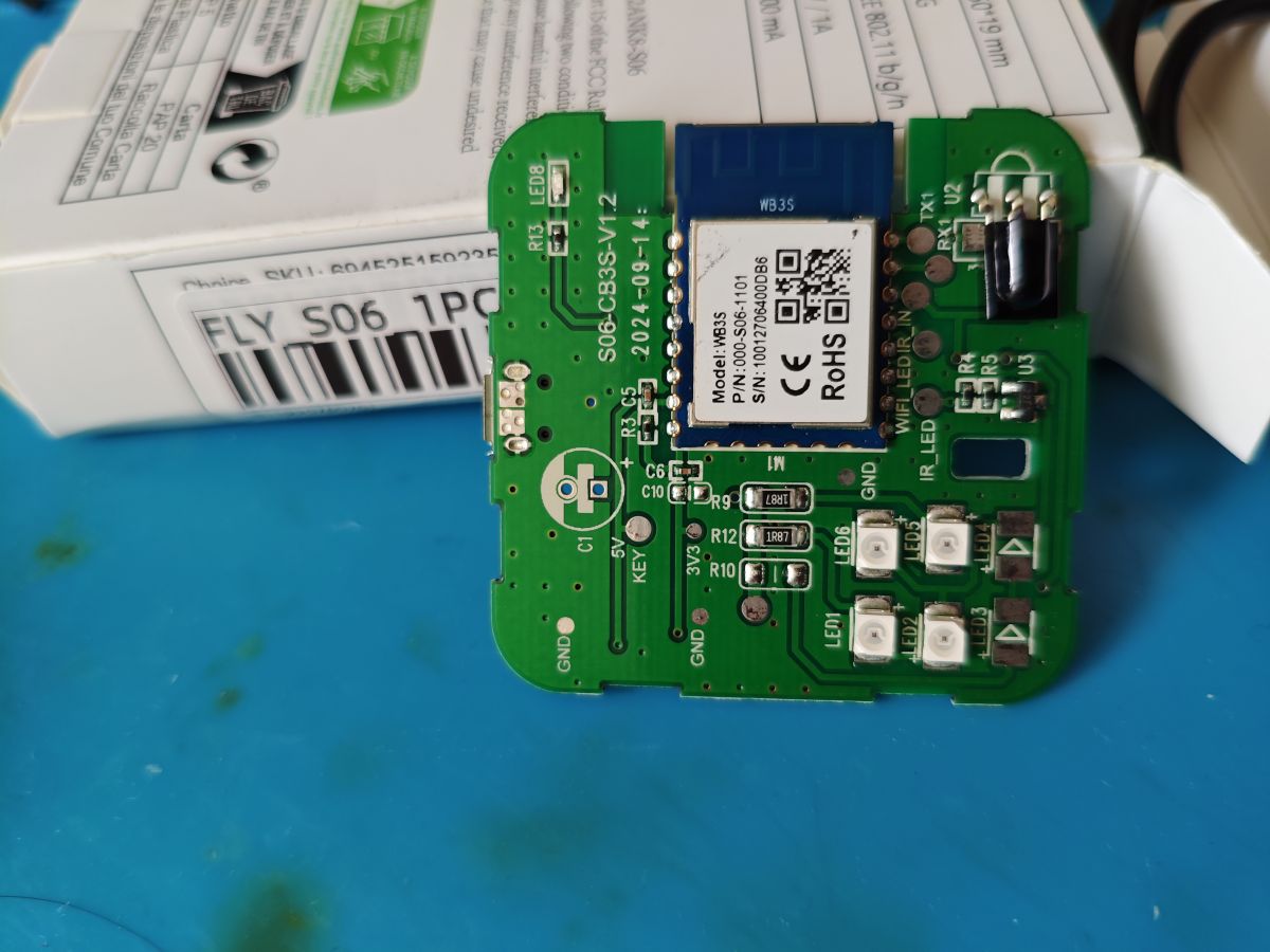

    Just received an S06 - some still come with WB3S it seems
    S06 PCB board with WB3S module mounted, visible package label in background
  • #57 21631219
    Posts: 14755
    Rate: 12879
    Interesting, your PCB says CB3S along with date 2024-09-14, but it has WB3S on it.

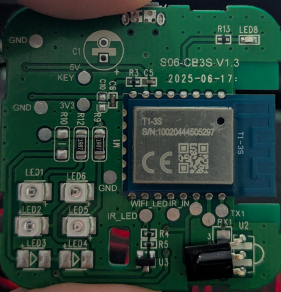

    I have this (new version)
    Close-up of a PCB with a T1‑3S module, GND/3V3/5V labels, and multiple LEDs Close-up of a green PCB with a micro‑USB port, a small push button, and a ribbon labeled “SAMSUNG”
    my 1.3 dump in attach
    I flashed esphome as described [here](https://devices.esphome.io/devices/avatto-s06-ir-remote-no-temp-no-humidity-new-version/) (esphome website) using ltchiptool. But when I power up device nothing happens. No led, no wifi AP. Someone can help me ?
    Thanks
    • avatto-s06-dump-cb3s-1.3.bin (2 MB) You must be logged in to download this attachment.
  • #59 21838771
    Posts: 14755
    Rate: 12879
    I don't think that Esphome supports BK7238. You can only brick device that way. Did you also overwrite bootloader? OpenBeken supports a wide variety of devices, including BK7238...
  • BK7238 detected despite BK7231N label
    #60 21838777
    snakuzzo
    Hi!
    No, I didn't overwrite bootloader. I flashed original fw again and it works...no bricked.
    So...now I can try with Openbeken, but I need to use ltchiptool 'cause I'm on linux.
    I have to use OpenBK7238_QIO_1.18.261.bin or OpenBK7231N_QIO_1.18.261.bin ?

    Added after 38 [minutes]:
    I used BK flasher
    Backup again firmware with this informations
    - Button is on P9
    - WiFi LED on P24
    - IR Receiver is on P26
    - IR Transmitter is on P6
    No module information found.
    Device internal platform - T1, equals BK7238.
    And the Tuya section starts at 2052096 (0x1F5000), which is a default T1/XR806 and some T34/BK7231N offset.
    But when I start flash
    MAC seems to be 80:64:7C:66:61:D9

How do I send an IR code from Home Assistant?
Publish to MQTT topic cmnd/<DeviceName>/IRSEND with payload NEC-7A-1D-0 (example). A HA button card definition was shared by a user [Elektroda, campeanu, post #21209679]
