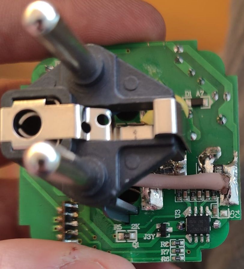

  • Woox R6113 EU Schuko smart plugs with energy monitoring use BK7231N/CB2S hardware and a BL0937 chip.
  • The case opens at four clip edges, and flashing uses an FT232RL USB-to-TTL adapter wired to the CB2S BL0937 chip, with the red cable for reset.

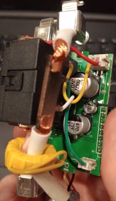

    Carefully open case (there are clip on the 4 edges). But it's quite easy to open. (see also [BK7231N/CB2S] Teardown CALEX Smart Powerplug EU plus 16A)
    [BK7231N / CB2S BL0937] Woox R6113 Smart Plug

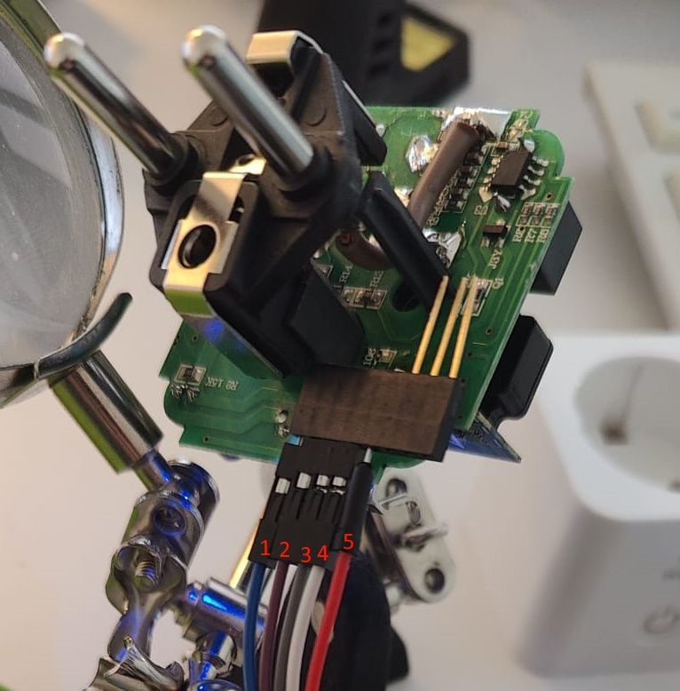

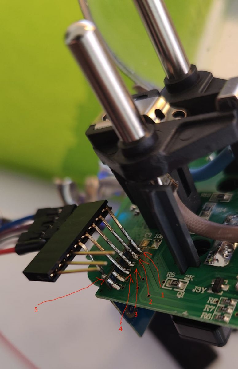

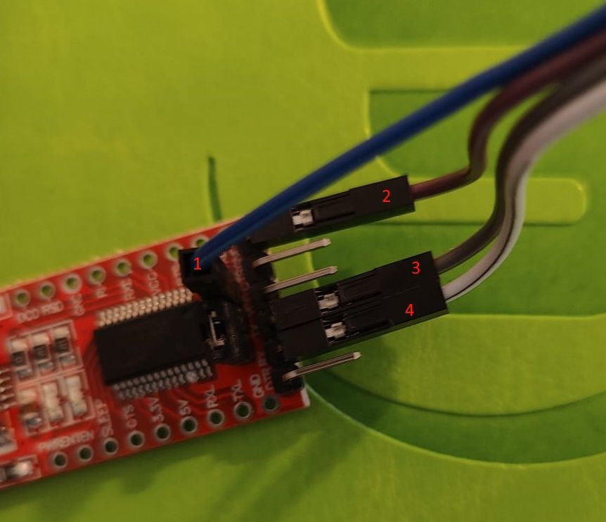

    For flashing I connected my FT232RL USB to TTL serial adapter as follows with the CB2S BL0937 chip:
    The red cable is for reset (=start flashing).

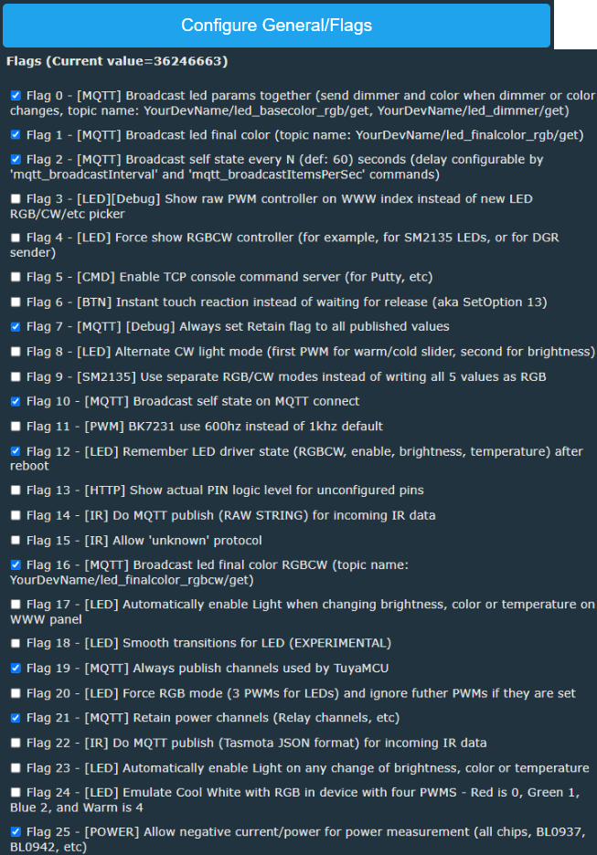

    And as I'm mainly using MQTT:

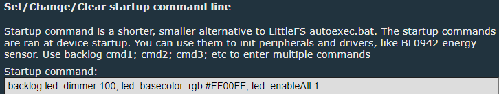

    Start-up command:
    Web-App config:

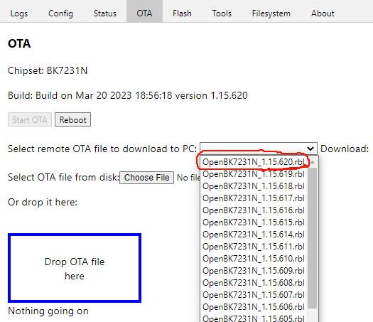

    You can easily do updates later with the OTA feature in the web app:
    See also the related repository to find the releases.

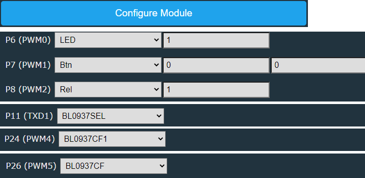

  • Woox R6113 pinout and configuration snippet
    #3 20501111
    clemensfabig76
    you mean this:
  • #4 20501623
    Posts: 14743
    Rate: 12839
    Yes, thank you. This is the correct template export in JSON format.

    Start-up command:
    I only realized it now, but why do you have LED commands for a relay switch (on/off) plug?
  • #6 20534628
    clemensfabig76
    Oh I have not even realized! I guess it was still from "playing around"!

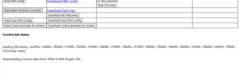

  • Backup read fails with serial buffer overflow
    #7 20689920
    asteinmitz
    I have the same plugs, but I am not able to backup the orginal OEM-Firmware. I just succeded with flash without backup. Can you explain how you did the backup to be able to revert again?

  • Try lower baud rates and flash the module off-board
    #8 20689994
    Posts: 14743
    Rate: 12839
    It always works for me, but we indeed had some similiar issues reported on forum. First I would suggest you to try multiple baud rates (preferrably lower ones), next try to shorten your flashing wires, try other USB to UART converter if it fails, you can also try hid_download_py Python script if new app fails for you, and I also recommend to flash (or read) WB2S (or CB2S) outside the circuit. You can take a look here, this video shows desoldering and soldering method for CB2S:
    And this method shows the hid_download_py usage, which is an older, but still good and reliable Python script for BK7231 flashing:
