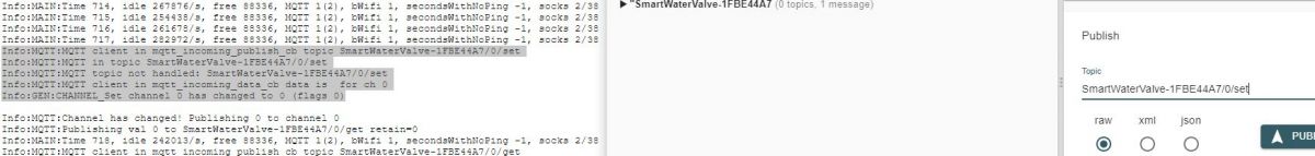

    if it's been toggled to "ON" and I leave it blank (no payload) the log tab returns with the following:
    Info:MQTT:MQTT client in mqtt_incoming_publish_cb topic SmartWaterValve-1FBE44A7/0/set
    Info:MQTT:MQTT in topic SmartWaterValve-1FBE44A7/0/set
    Info:MQTT:MQTT topic not handled: SmartWaterValve-1FBE44A7/0/set
    Info:MQTT:MQTT client in mqtt_incoming_data_cb data is for ch 0
    Info:GEN:CHANNEL_Set channel 0 has changed to 0 (flags 0)
    and my valve moves...that means it's toggled (see below picture)

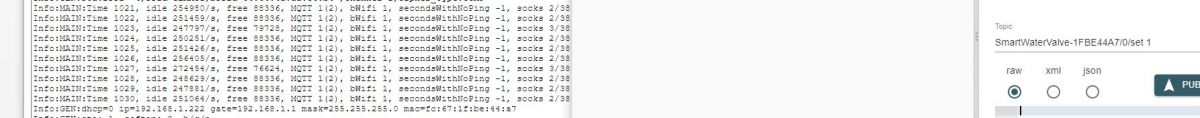

    whenever my valve has been toggled to "0" no matter what payload I use, I have no reaction and log tab shows nothing

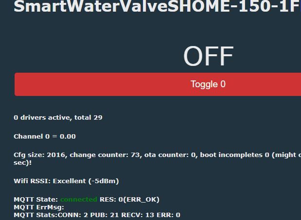

    valve can be moved easily though the main web interface acting on the "toggle0" button
    OpenBeken MQTT Issues: Smart Water Valve Commands not Working (Tasmota Syntax & Regular)
    HTTP interface works perfectly

    I don't know the environment you are using, but the screenshot attached below:
    strongly suggests that you are indeed doing a publish under an incorrect topic:
    SmartWaterValve-1FBE44A7/0/set 1
    The OpenBeken command expects you to put the following string in the topic:
    and then, separately, put 0 or 1 in the payload.
    And it seems that you are trying to put both topic name and payload in the topic name...
