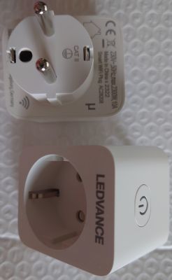

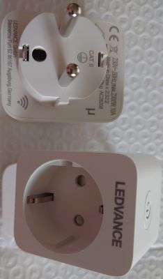

    LEDVANCE Smart+ Indoor Plug with Metering: BK7231T Chip, Model LDV+ PLUG, WB2S LEDVANCE Smart+ Indoor Plug with Metering: BK7231T Chip, Model LDV+ PLUG, WB2S
      "vendor": "LEDVANCE",
      "bDetailed": "WB2S",
      "name": "LEDVANCE SMART  INDOOR",
      "model": "LDV  PLUG",
      "chip": "BK7231T",
      "board": "TODO",
      "flags": "1024",
      "keywords": [
        "TODO",
        "TODO",
        "TODO"
      "pins": {
        "6": "Btn_Tgl_All;0",
        "7": "BL0937CF;0",
        "8": "BL0937CF1;0",
        "10": "LED_n;0",
        "24": "Rel;0",
        "26": "BL0937SEL;0"
      "command": "backlog  SetupEnergyStats 1 60 60; startDriver ntp",
      "image": "https://obrazki.elektroda.pl/6126100800_1680079103.jpg",
      "wiki": "https://www.elektroda.com/rtvforum/topic3968074.html"
    Weird current measurement - reported. https://github.com/openshwprojects/OpenBK7231T_App/issues/755
    OTA Flashed OpenBK7231T_UG_1.15.633.bin without teardown with: https://github.com/tuya-cloudcutter/tuya-cloudcutter/blob/main/INSTRUCTIONS.md
    Device configuration found here: https://github.com/tuya-cloudcutter/tuya-clou...aster/devices/ledvance-smartplus-plug-eu.json
    and translated with this little dictionary:
    ele_pin = BL0937CF
    vi_pin = BL0937CF1
    sel_pin_pin = BL0937SEL
