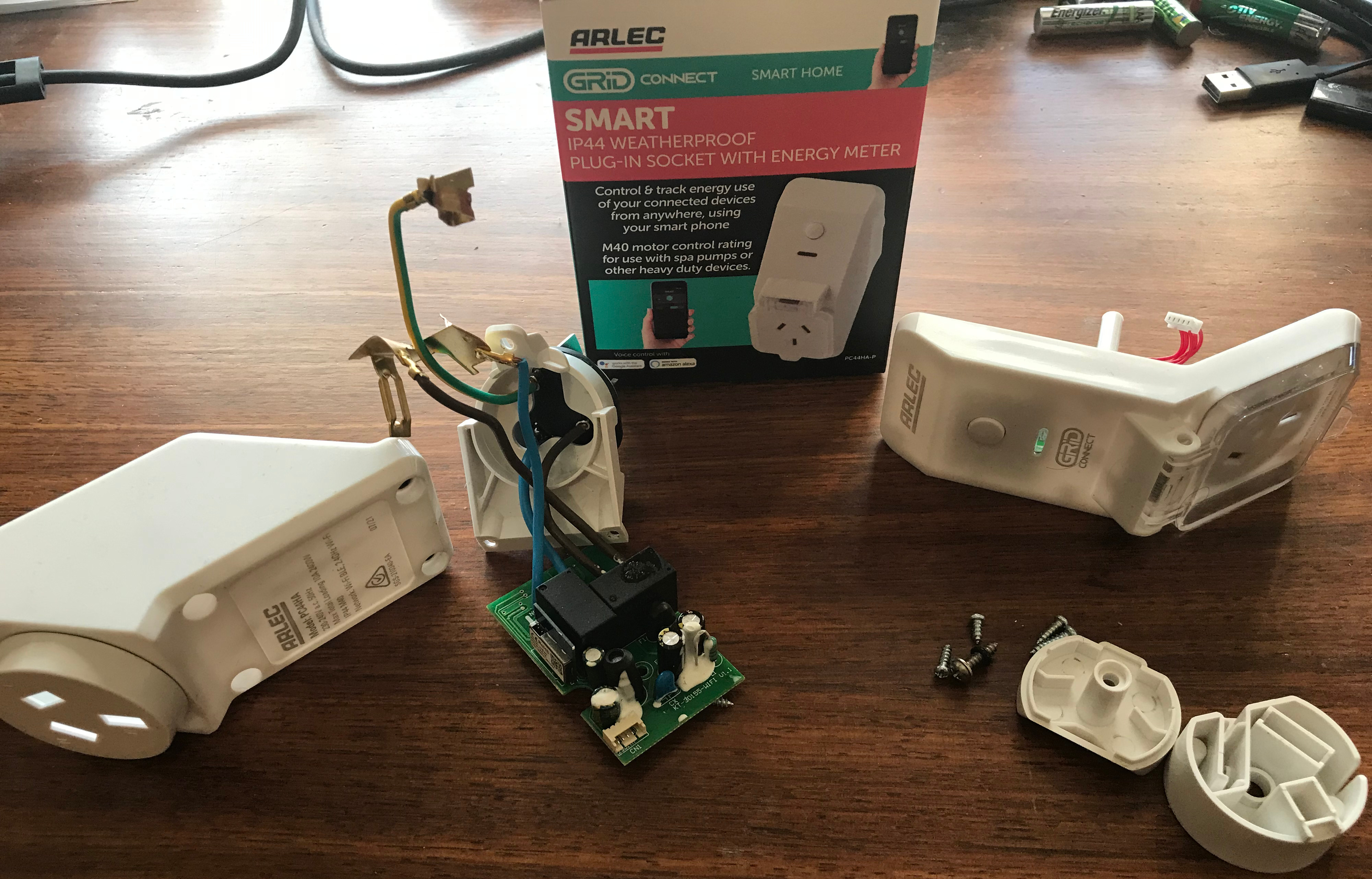

    I was hoping for some help in regards to this plug.
    Product in question:
    https://www.bunnings.com.au/arlec-grid-connect-smart-ip44-heavy-duty-timer_p0273373
    [BK7231T/WB2S] Arlec PC44HA - Bunnings Outdoor IP44 Smart Plug w/ Energy Monitoring
    Teardown (Not my pictures - credit to SleepingNerd from Reddit): https://imgur.com/gallery/k73TnCq
    [BK7231T/WB2S] Arlec PC44HA - Bunnings Outdoor IP44 Smart Plug w/ Energy Monitoring [BK7231T/WB2S] Arlec PC44HA - Bunnings Outdoor IP44 Smart Plug w/ Energy Monitoring [BK7231T/WB2S] Arlec PC44HA - Bunnings Outdoor IP44 Smart Plug w/ Energy Monitoring
    [BK7231T/WB2S] Arlec PC44HA - Bunnings Outdoor IP44 Smart Plug w/ Energy Monitoring [BK7231T/WB2S] Arlec PC44HA - Bunnings Outdoor IP44 Smart Plug w/ Energy Monitoring [BK7231T/WB2S] Arlec PC44HA - Bunnings Outdoor IP44 Smart Plug w/ Energy Monitoring [BK7231T/WB2S] Arlec PC44HA - Bunnings Outdoor IP44 Smart Plug w/ Energy Monitoring [BK7231T/WB2S] Arlec PC44HA - Bunnings Outdoor IP44 Smart Plug w/ Energy Monitoring
    I extracted the Tuya Config using the Easy Flasher and was able to convert it to the following OBK template:

    However, I found I had to manually change pin 24 to BL0937SEL_N in order to get the voltage and current to read correctly.
    Now that I believe it's setup correctly... when I compare it to a different energy monitoring plug, there are some anomalies with the voltage monitoring stats. Whenever load is applied (a heat pump hot water system) I have found that the voltage will increase by a few volts but with no load, the voltage readings are almost exactly the same as the other plug.
    I just wanted to ask if this is normal behaviour of electronics and house wiring or is it down to a faulty plug or even poor calibration by me?
