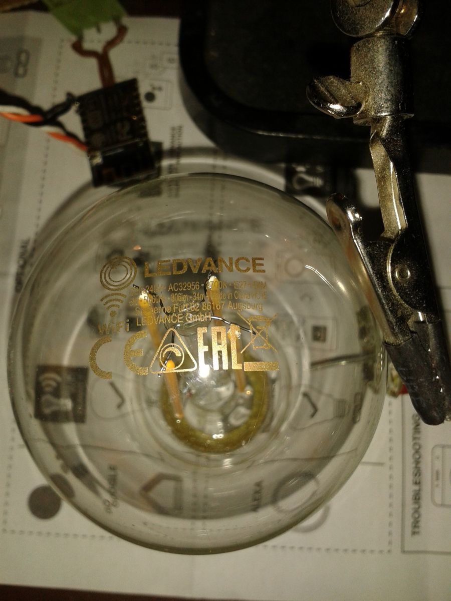

    Maybe a duplicate, but I didn't find the exact model at the list of devices.
    [BK7231T][WBLC5] LEDVANCE SmartPlus AC32956 Filament Classic Bulb, E27

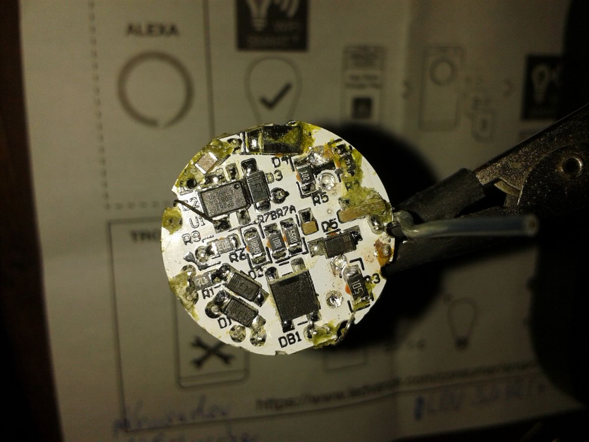

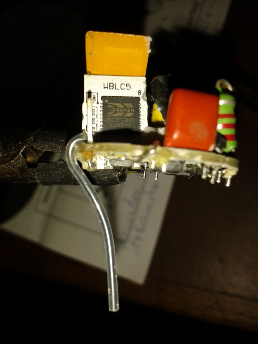

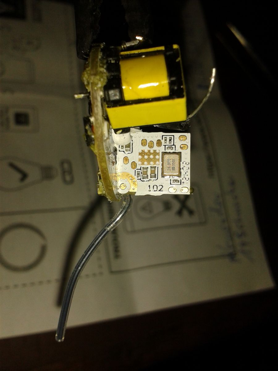

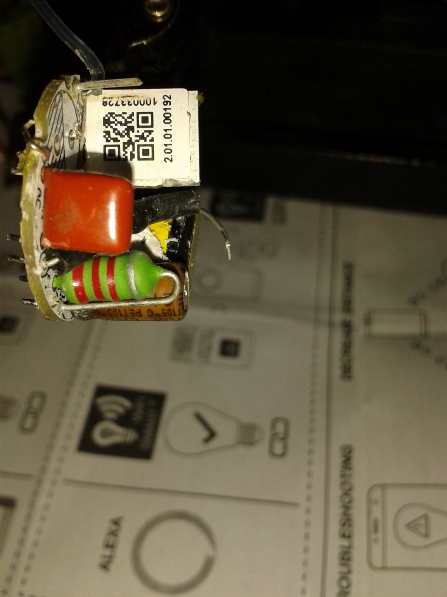

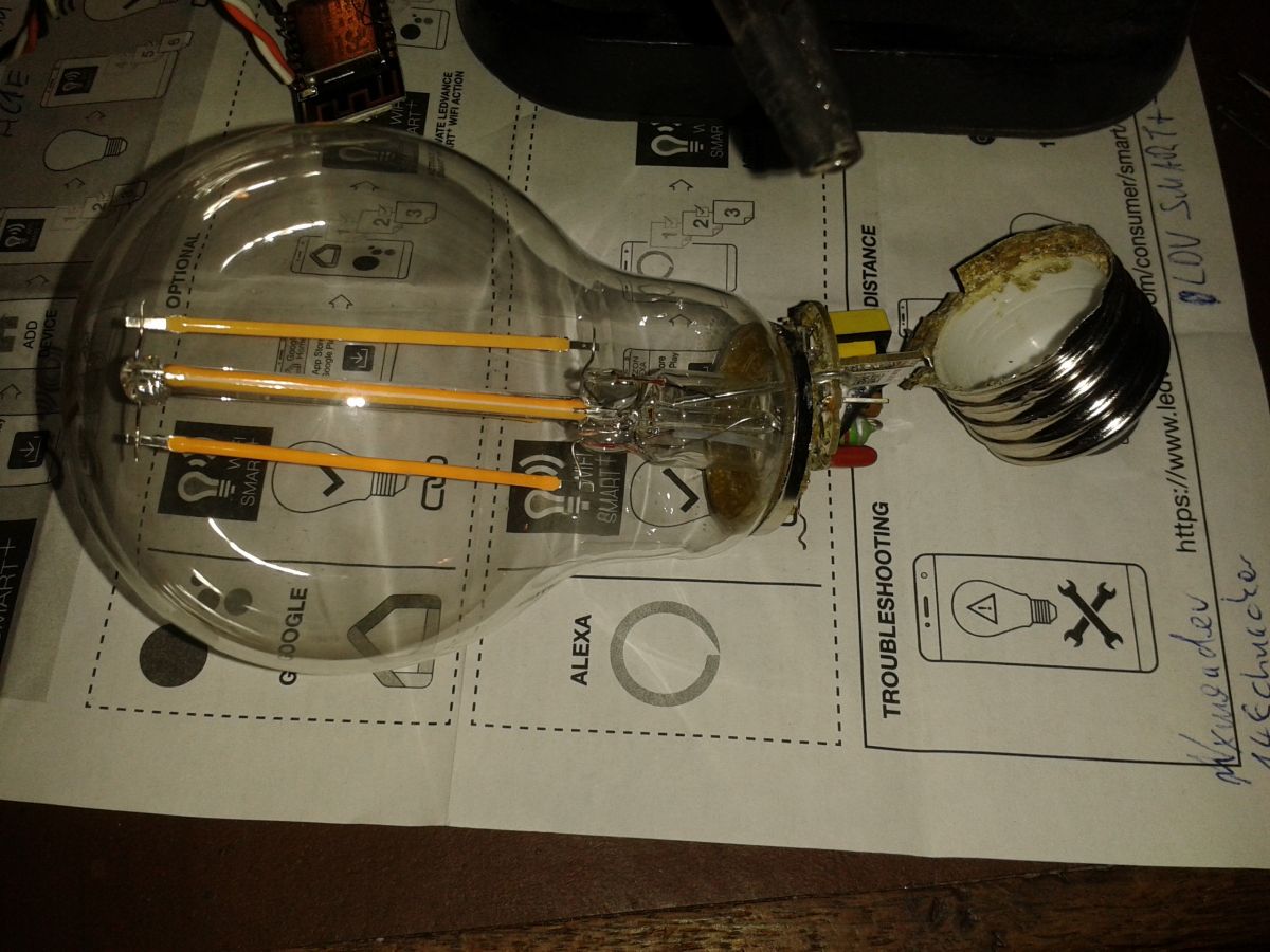

    I managed to cut it via tuya-cloudcutter finally, but impatient me had it already apart. So here are some insights:
    [BK7231T][WBLC5] LEDVANCE SmartPlus AC32956 Filament Classic Bulb, E27 [BK7231T][WBLC5] LEDVANCE SmartPlus AC32956 Filament Classic Bulb, E27 [BK7231T][WBLC5] LEDVANCE SmartPlus AC32956 Filament Classic Bulb, E27 [BK7231T][WBLC5] LEDVANCE SmartPlus AC32956 Filament Classic Bulb, E27 [BK7231T][WBLC5] LEDVANCE SmartPlus AC32956 Filament Classic Bulb, E27 [BK7231T][WBLC5] LEDVANCE SmartPlus AC32956 Filament Classic Bulb, E27
    I successfully recovered the firmware v.2.9.15 as backup. Feel free to ask if there is anything more of interest.
    I fear for this specimen, I need a custom socket now :-).

  • P26 PWM on channel 0 fixed bulb control
    #4 20527050
    glasreiniger07
    Got it working! The configuration was just P26 PWM for Channel 0.

  • LSC Smart Connect may need second pin enabled
    #6 20726333
    nielspiersma
    Posts: 60
    Rate: 20
    Guys,
    Seems that the LSC Smart Connect from Action in the Netherlands is roughly the same. I do have that issue that only 2 of the 4 filaments turn on. So maybe there is a second pin we need to enable.
    Device info:
    LSC Smart Connect 3001686
    7 watt coming with 2.9.27 firmware, ran tuya cloudcutter without any issues.
    For now
    Have not crushed / opened device and it is already running OpenBeken, so any tips are welcome.
    Niels

    Have you tried GPIO doctor from the Web App?
  • #8 20726358
    nielspiersma
    Posts: 60
    Rate: 20
    Figured them out based on the JSON code.
    For this one, the settings are:
    P24, PWM 0
    P26, PWM 1
    Now the controls are perfect.
    Niels
