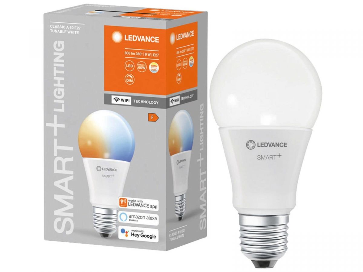

    I ordered a LEDVANCE SmartPlus Classic A60 Tunable White Bulb E27 (AC33909), 9 W, 806 lm, 2700…6500 K.
    LEDVANCE SmartPlus bulb with packaging in the background

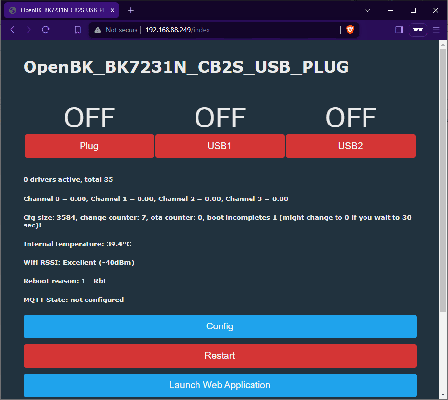

    Flashed openbeken via OTA by cloudcutter using the "ledvance-tunable-white-a60-b27-bulb-v1.1.4" profile.
    My Openbeken settings are:
    It was necessary to disable flags for correct behavior:
    • * 8 "[LED] Alternate CW light mode (first PWM for warm/cold slider, second for brightness)"
      * 24 "[LED] Emulate Cool White with RGB in device with four PWMS - Red is 0, Green 1, Blue 2, and Warm is 4"
