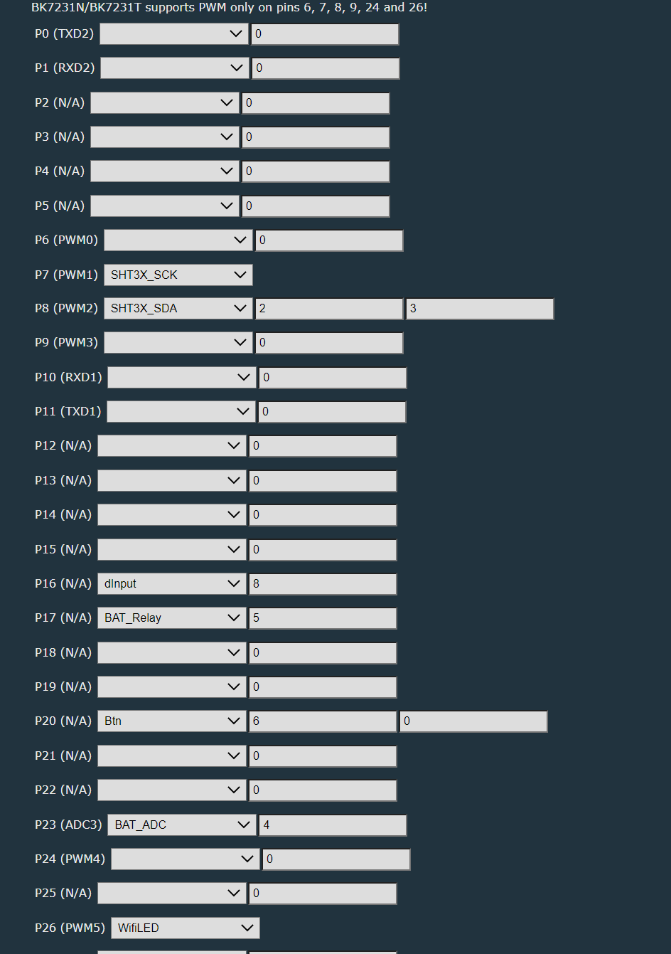

    Normal IOR_BAT_ADC and IOR_BAT_RELAY is available on last releases. you just need to map you ADC to BAT_ADC and Relay to BAT_Relay in module.
    i'll ask for a merge to correct auto_config on webapp.
    https://github.com/OpenBekenIOT/webapp/pull/45
    "7": "SHT3X_SCK;0",
    "8": "SHT3X_SDA;2,3",
    "16": "dInput;8",
    "17": "BAT_Relay;5",
    "20": "Btn;6",
    "23": "BAT_ADC;4",
    "26": "WifiLED;0"
    for the delay, i tested that and seems fine without the delay it works flawlessly.

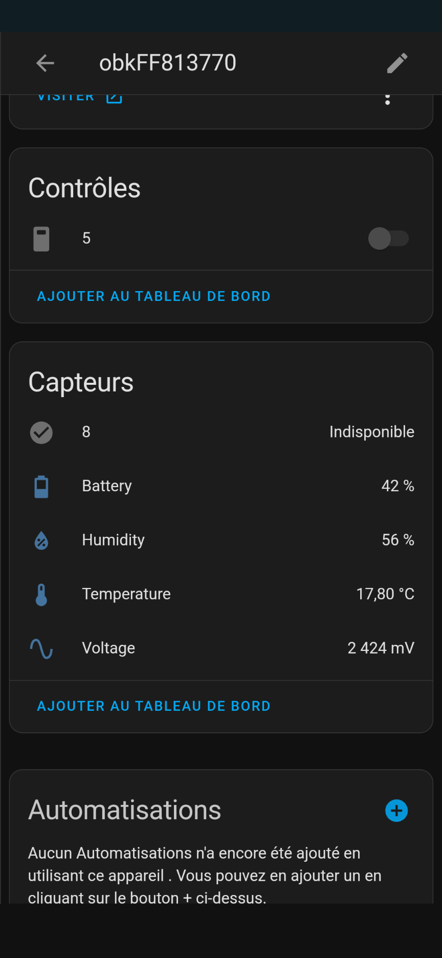

  • Questioning missing temperature and humidity channel setup
    #124 20480411
    akkipro
    Level 4  
    >>20465075
    Does autoexec.bat still need the channel set commands from earlier posts i.e:
    echo "Init driver and powersave "
    startDriver TuyaMCU
    setChannelType 1 temperature_div10
    setChannelType 2 humidity
    setChannelType 3 toggle
    setChannelType 4 Voltage
    setChannelType 5 toggle
    PowerSave
    I have got this working fine using DeepSleep but temperature and humidity don't seem to arrive in Home Assistant, only the binary sensors and battery sensors [BK7231N CBU] Generic Temperature and Humidity Sensor
    I figure I am missing something obvious but would love it if someone could point me in the right direction.
  • #125 20480428
    dheenhasty
    Posts: 111
    Rate: 17
    No it's not needed. You have temp and humidity showed correctly on web ui ?
    Try to launch a scheduleHAdiscovery again

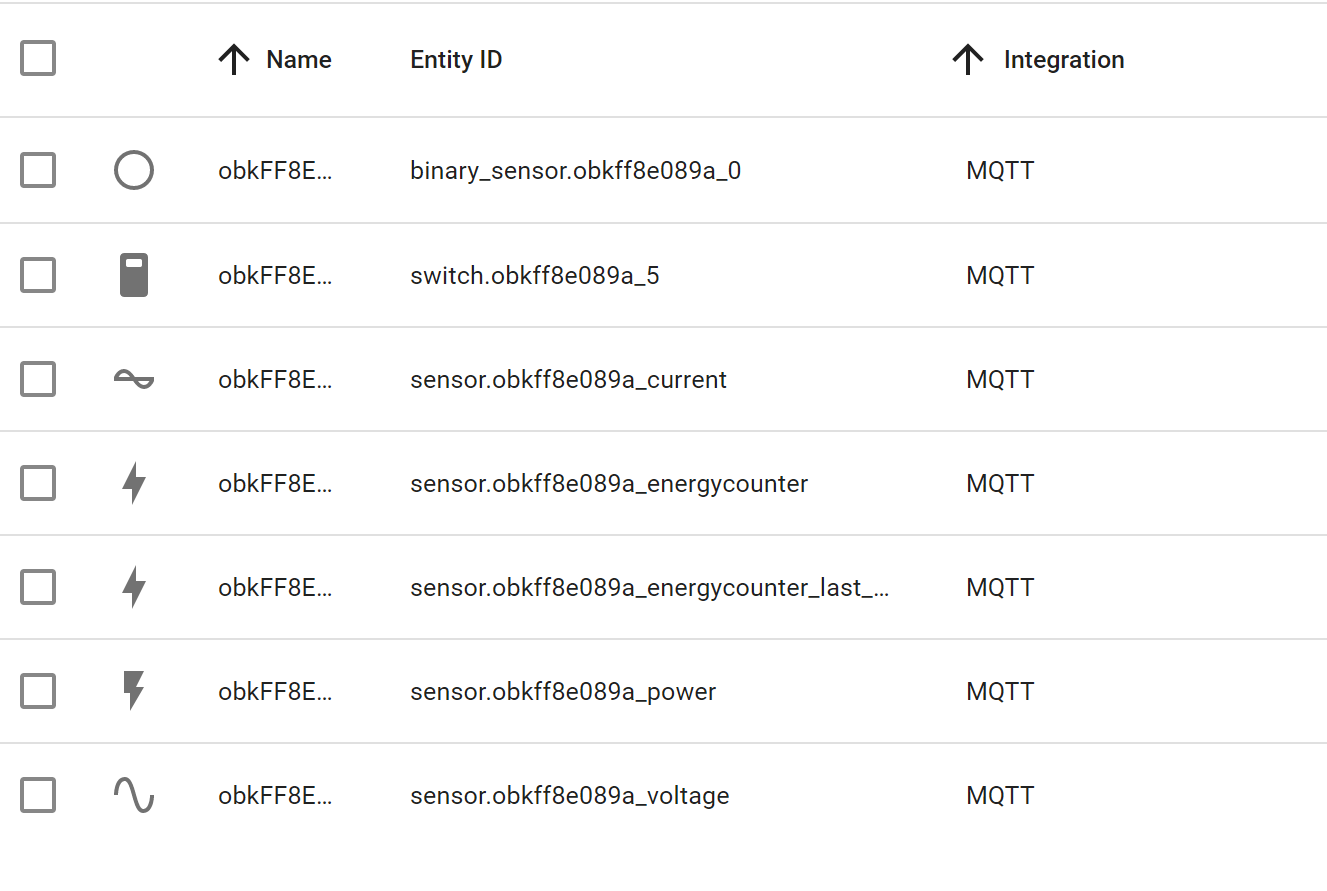

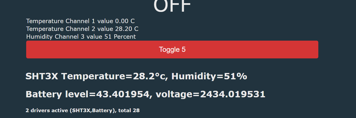

  • Home Assistant auto-discovery not showing SHT3X readings
    #126 20480434
    akkipro
    Level 4  
    Thanks for the quick reply!
    My autoexec.bat is simply:
    PowerSave
    startDriver SHT3X
    startDriver Battery
    Battery_Setup 2000 3000 2.29
    scheduleHADiscovery
    delay_s 90
    DeepSleep 300
    The webui shows correctly:
    The module is set as follows:
    But deleting the device from Home Assistant and repeated auto discovers doesn't seem to cause temperature and humidity to display. Any ideas?
  • #127 20480435
    dheenhasty
    Posts: 111
    Rate: 17
    In latest releases you don't need to start batt and sht driver. If pin is assign it will start automatically.
    Maybe there's a bug .... I will try to reset my device today to check that.
    Something strange is that you should not have all the energy counter on discovery
    It should be only this :

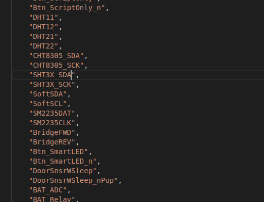

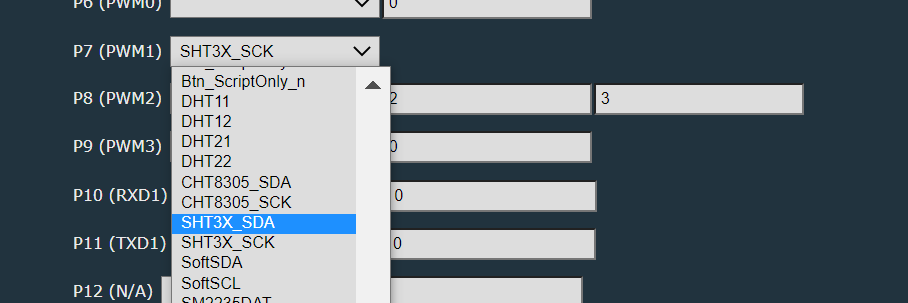

    Edit : ok i found the issue @p.kaczmarek2 :
    #define IS_PIN_TEMP_HUM_SENSOR_ROLE(role) (((role)==IOR_SHT3X_DAT) || ((role)==IOR_CHT8305_DAT))
    but the name of the pin has been switch to SDA since your standardisation of I2C.
    i will push the modification. if you can merge it :)
    Forget it ..... @akkipro i think you had an old firmware with bad pin name on it (Or store one is not correct). you can try to update and change the pin for SHT3X :
    SHT3X_SDA => should be SHT3X_DAT
    SHT3X_SDC => should be SHT3X_CLK
  • #131 20480766
    akkipro
    Level 4  
    Just updated to version 1.15.576 to check this but the old names still appear:
    Sorry if there is something I am missing?
  • #132 20480787
    dheenhasty
    Posts: 111
    Rate: 17
    No your right .... just check on web interface it's still the old name .... but it should not be an issue :
    ok i will try to do some test on my side

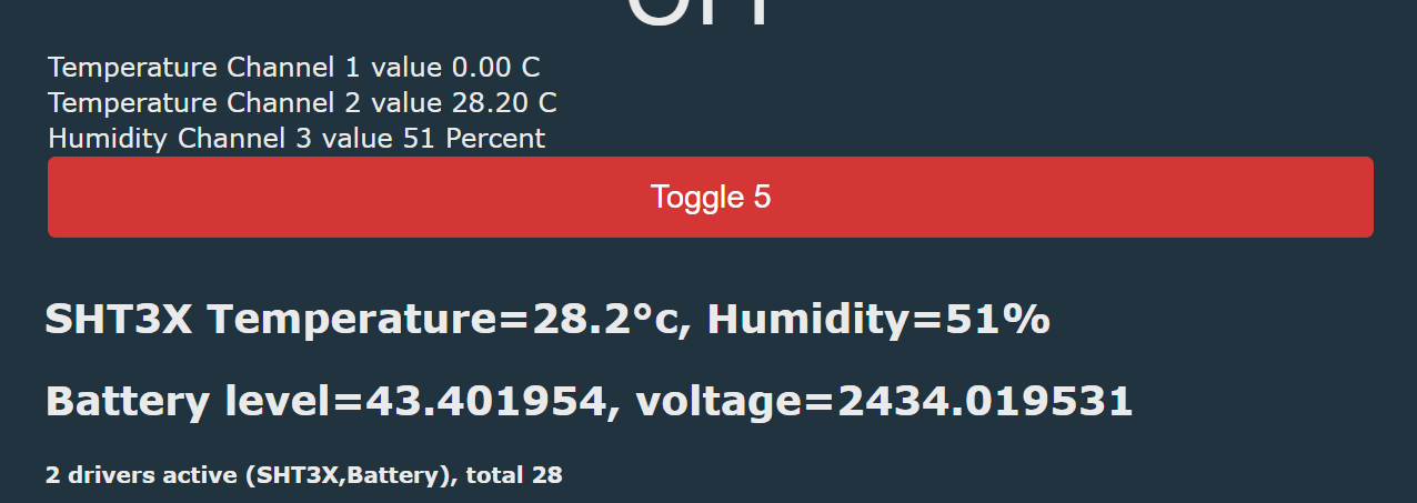

  • #133 20480945
    Posts: 14767
    Rate: 12908
    Why are there two temperature channels?
    @akkipro please perform some simple tests with console commands, for example, do
    publish myTest 123
    and see if the obkDev/myTest/get value 123 is received by HA

    Ok i have done some test.
    i have reset the firmware on my device with the last and delete the Home Assistant. and i have the same issue has you.
    battery not detected correctly and temp/hum not pushed by discovery ......
  • #135 20481206
    Posts: 14767
    Rate: 12908
    It seems we need to add more self-tests of automatic discovery to self-tests system on WIndows
    Added after 7 [minutes]:
    @dheenhasty I found at least one bug, why was Battery included in DRV_IsMeasuringPower ? I will push fix soon
  • Battery power field broke discovery for temp and humidity
    #136 20481228
    dheenhasty
    Posts: 111
    Rate: 17
    yes just saw that it's an issue a will push a correction ... it broke the discovery .....
    i'm currently testing a correction
    Edit : https://github.com/openshwprojects/OpenBK7231T_App/pull/721
    test on HASS ok and and Tasmota Admin Ok too.
    I add put by mistake the battery in measuring power for the tasmota json file ..... and forget to create a separate void for battery. it's corrected and more clean now
    By changing that it bring back temp and humdity .... that is really strange. i think of another bug in Discovery when you measure power.
  • #137 20481276

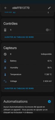

  • Suggesting retained MQTT payloads for deep-sleep sensors
    #142 20486075
    minusync
    Posts: 57
    The deep sleep setting is nice, but it makes using the sensor in HA more or less pointless. The side-effect of deep sleep is that 90% of the time it shows now sensor unavailable instead of the actual sensor reading. In fact, it is possible to see the reading in HA only if you randomly look at the exact moment when the sensor is on. I don't have much experience with mqtt, but would it be possible to improve this situation by adding the mqtt payload "retain= True" flag? As I understand it, the retained message flag should keep the information in mqtt broker active until new data is received.
    Also, thought for p.kaczmarek2, shouldn't it be nice to create a rule or at least a good practice, that all teardown initiators of the device, place in the first post, when the device is ready into operation, the exact step-by-step instructions for the users on how to do this with a particular device, so that sometimes they don't have to review hundreds of posts to do that?
  • Flag 35 needed before HASS discovery
    #143 20486265
    Posts: 14767
    Rate: 12908
    You are incorrect. This will happen only if you publish availability topic during HASS discovery. It will not happen if this topic is not set. You just most likely have to remove sensor from HA and then pair it again after Door Sensor driver is started, so it knows that is using Deep Sleep mode and pairs with HA correctly.
    EDIT: Wait, you are referring to the humidity sensor... then procedure is a bit different

    yes the flag 35 for avty publishing for sensor.
    i'm not quite satisfied with this sensor, it's really consuming a lot of battery. event in deep sleep . and it's not due to OpenBeken you had some consumption but i have the same sensor with original firmware and it consume the same .....except that with OBK you can set your battery level lower :)
    so i decided to do a little bit of tuning so an am117 later and usb connector :
    i decided to desolder the CBU from mainboard cause now that i'm on usb i want it to retrieve temp more often and no deepsleep. so the board will heat if CBU is on it . (it's a conception issue first ..... SHT should be isolate from the mainboard. )
    next step is adding more sensor to it (CO2 and UV) and do a proper case 3D printed :)
  • #145 20488133
    Posts: 14767
    Rate: 12908
    Don't forget that we have a DIY section:
    https://www.elektroda.com/rtvforum/forum513.html
    With some strange projects submitted by me few years ago:
    https://www.elektroda.com/rtvforum/topic3789324.html
    Why do you think that the sensor is responsible for current consumption? Have you tried to do measurement?
  • #146 20488276
    dheenhasty
    Posts: 111
    Rate: 17
    it's not the sensor who is responsible of the consumption :)
    i just think Beken with wifi is not made for 2AA battery .......
    with and usb and ampmetter i got 5v with 70 mA so an average consumption of 350mw and it's within the low spec of the CBU datasheet with wifi on. it's pretty good, it's just not suited for battery. Zigbee is clearly better
  • Reducing wake time and transmitter power to save battery
    #147 20489033
    minusync
    Posts: 57
    I just noticed that this sensor is consuming an insane amount of power. This is definitely not the way it should be. If the battery wears out in a week, it makes the battery sensor useless. For normal use, this time should be at least tenfold.
    I don't know how Tuya does it, but here are some thoughts that might be worth considering. I have no idea if any of this is possible to realize at all so they are just thoughts.
    First of all, it is obviously beneficial to reduce the working time. One option is to extend the overall rest time, another option would be to see what exactly the sensor does when it starts. Right now it seems to me that it takes at least a minute for the data to transfer when it wakes up - although I have no way of measuring it exactly. This time seems too long. When I look at the HA log, it shows that in one session the sensor turns on and off as many as five times before going to sleep. It seems kind of excessive. What for all this? Would it have any effect if the temperature data were transmitted a little more frequently, but other data only every few hours?
    Is it possible to reduce the power of the transmitter? Less power = less energy consumption.
    The CBU has also a Bluetooth transmitter. When the sensor starts, does it also start the Bluetooth transmitter along with the wifi (even if it doesn't transmit anything from there) If this should be true, it will probably at least double the energy consumption immediately?
  • Reducing BK7231N sleep time to save battery
    #148 20489079
    dheenhasty
    Posts: 111
    Rate: 17
    In fact, your right, consumption is an issue.
    That's why tuya with the default firmware wake up device every hour. For around 45 seconds.
    You can do the same with obk :
    Under général/flags =>
    - Tick flag 37 for quick connect
    - change value of boot time to 10.
    Then on your script :
    - change the delay to 45 seconds (could be less but mqtt might need more time)
    - deepsleep for 3600.
    And close the web pages if your on logs :)
    You should have the same behavior has tuya.
    Equation is pretty simple :
    AAA battery => 800mAh usable by cbu ( below the dc behave strangely)
    Average usage=> 70mAh
    So roughly 11 hours of constant usage in stock.
    So with param upthere =>
    11 x 3600 / (10 + 45 )=> you have 720 runs
    So arround 30 days if we have one run per hour
    With my test script =>
    11 x 3600 / ( 30 + 60 ) => 440 runs
    We count 2 runs per hour do ~9 days.
    No that powersave is activated by default you have all power consumption optimisation.
    Another option is to use pindeepsleep with the alert mode of the sht sensor (for climate in hass) the cbu will wake up depending on you define high and low temperature. You have the detail to implement that in tutorial section of the sht.
    But even with that my other sensor with tuya firmware last 3 or 4 weeks....
    It's sad cause the sht sensor is pretty cool ! And the cbu also. That's why i decided to tune it a little bit :)
