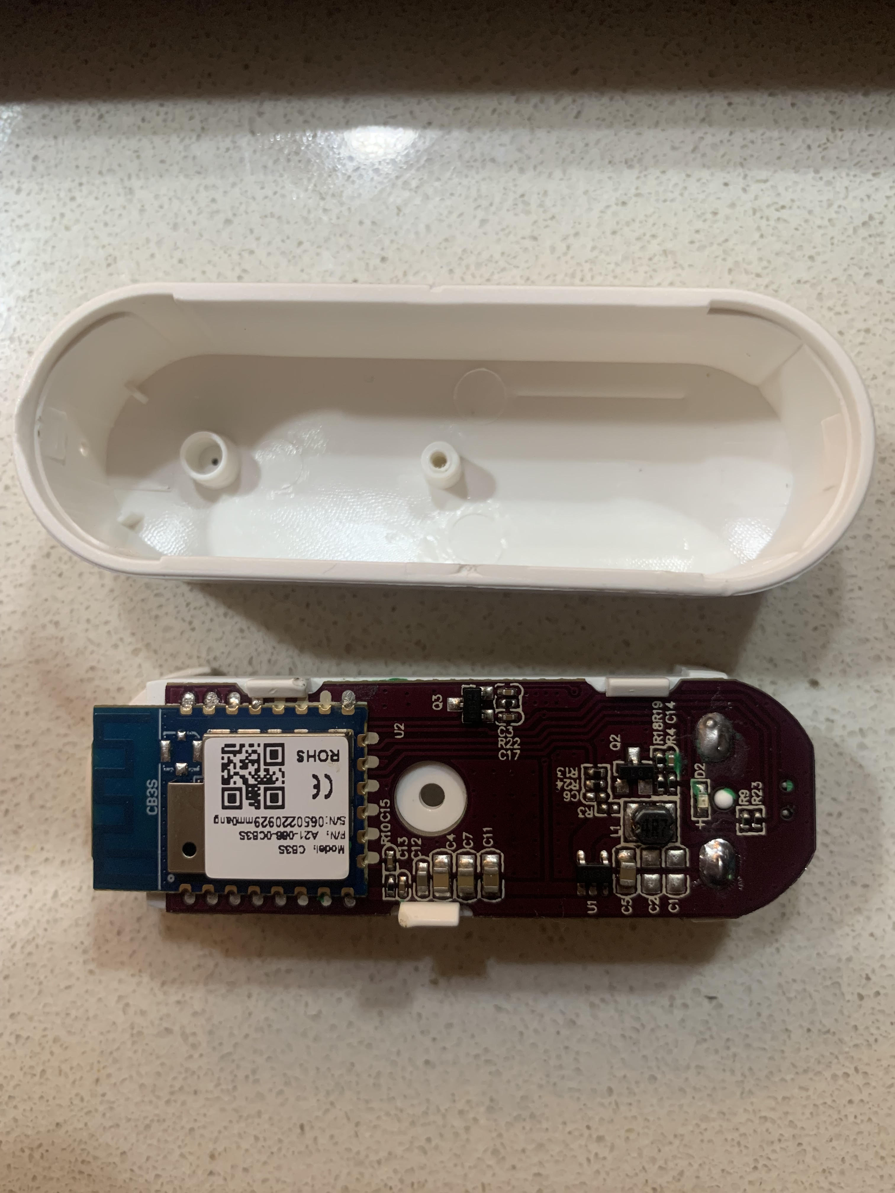

    Hello all
    Have a simple door sensor without tuyamcu
    The chip is BK7231N and the firmware version 1.15.665
    When I configure the P8 (PWM2) to DoorSnsrWSleep it works and starts to 60 sec every time I move the sensor but if the device goes to deep sleep it never resumes
    I also didn't figure out how to config battery power measure and to activate the led on the device
    Thank you for support
    Oded

    Do you have original flash dump?
    How device looks like?
    Can you look at the traces and follow them to the Button to see which GPIO is used?
  • #7 20532228
    oded00
    I don't have the original dump
    Adding picture of my device
    When I look at the log after short press on the reset button:
    Info:GEN:7 Button_OnInitialPressDown
    Info:GEN:7 key_short_press
    • Configuring P8 (PWM2) to DoorSnsrWSleep on BK7231N Chip, Firmware Version 1.15.665 unnamed (1).jpg (797.82 KB) You must be logged in to download this attachment.
  • #8 20532298
    Posts: 14782
    Rate: 12920
    Good, so P7 is a RESET button, now, does this button wake up the device after it goes to sleep?
  • Sleep wake triggered by door state change to 0
    #9 20532759
    oded00
    Yes
    Pushing the button when the device is in sleep wakes up the device
    One more strange thing that I notice is that the device also wakes up when it goes to sleep when the channel is on 1 (door open) and then it changes to 0 (door close)
    So the only state that does not wake up the device is when the device goes to sleep when the channel is on 0

    Do you have a multimeter? Can you power off the device and then check the resistance first between sensor GPIO (pad on CB3S) and ground, and then between sensor GPIo and VDD?
    Maybe IOR_DoorSensorWithDeepSleep_NoPup can work for you?

    Posts: 14782
    Rate: 12920
    @spin55 it looks like you have configured that sensor manually. It's a nice approach, but it's not needed if you are using DoorSnsrWSleep functionality. The new door sensor driver does the things you have scripted automatically.
    For me, it looks like OP has an extra pull up/down resistor on sensor and it breaks wake up for him.

    Posts: 14782
    Rate: 12920
    There is still very imporant thing left to do. The perfect system should shut down as soon as MQTT confirms reception of the update. Constant delay is not desired here.
    There is still a lot of room to improve.
    Okay, to get back on topic - @oded00 is the version without pull up working for you?
    I had very similar problem as your described here when I tried to wake by GPIO that had also external pull up resistor on PCB.

    Posts: 14782
    Rate: 12920
    oded00 wrote:
    So the only state that not wake up the device is when the device go to sleep when the channel on 0
    The problem has been solved.
    See:
    https://www.elektroda.com/rtvforum/topic3971140.html
    The solution is to update the firmware, and then try out DSEdge options, first try DSEdge 1 and then DSEdge 0. Default one is DSEdge 2 and may not work with your device.
