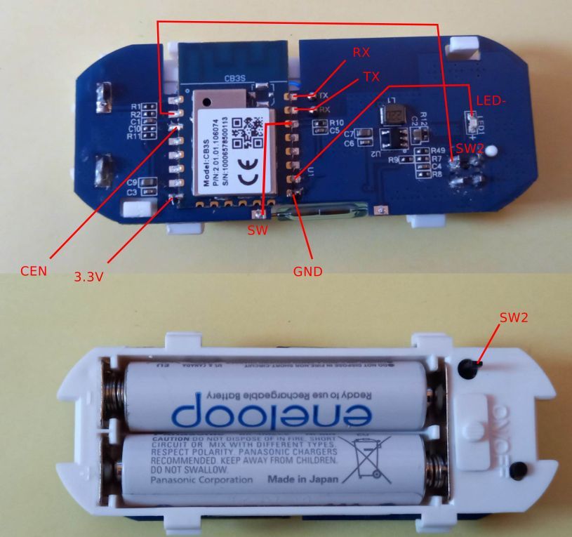

    Czujnik kupiony na tej aukcji (snapshot): https://allegro.pl/oferta/autonomiczny-czujni...jYmZhMmNmYjk2YTE4NjY3ZWQzOWQ5NDlhYTZmOTgyNTk=
    1. Connected by CH341A programmer. Shorting CEN to GND for a moment allows you to download and save the flash memory.
    2. BK7231GUIFlashTool via mono on linux turned out to be useless and throws the same error every time as in many other forum threads:
    Going to start reading at offset 0x00...
    Reading 0x00... failed with serial.BytesToRead 4095 (expected 4111)
    The beginning of buffer in UART contains 040EFF01E0FCF4061009000000200069 data.
    failed! There was no result to save.
    3. uartprogram with hid_download_py it works without any problem.
    4. Loaded OpenBK7231N_QIO_1.15.668.bin
    5. Leads as in the picture below.
    pin 5 = GPIOP_26 PWM5 - (Btn 1 0) battery case button
    pin 10 = GPIOP_9 = PWM 3 = (LED 0) diode-
    pin 14 = GPIPP_7 = PWN_1 = (DoorSensorWSleep_nPup 0 [regular DoorSensWSleep doesn't work at all]) reed switch
    Using CH341A Programmer for BK7231N/CB3S Door/Window Sensor PB-69W VER 1.3: UART & OpenBK7231N_QIO
    6. The LED lights up after the reed switch is opened, and goes out after the short circuit and the information goes through the MQTT to HomeAssistant. Time until deep sleep is also extended correctly. However, wake-up only works when the sensor has entered deep sleep in the open reed (off) position. When the magnet shorts it (on) and in this state it is put to sleep, there is no possibility of waking up and a reset by turning the power off and on again is necessary.

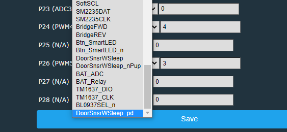

  • Try the _pd pin with version 1.15.674

    Hello, it seems that your device has a slightly different electronically implemented sensor than devices that I had reported as working with the controller. Maybe it's a matter of pull up or down resistors. Does the reed switch have such on the PCB?
    It's hard to say anything more remotely, but I have an idea - if the programmable pull up version and without resistors doesn't work for you, maybe the pull down version will work?
    I uploaded an update. Version 1.15.674. Select the _pd pin and try again:

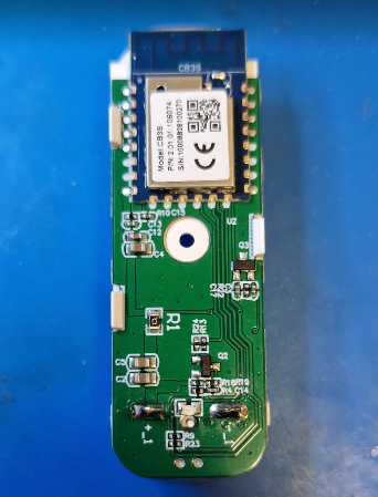

    You can also physically check on the PCB what are the resistances between the reed switch GPIO and ground and 3.3V and give them to me.

    I had already set the wake-up to reset pin to make it easier, and before I saw the answer, I had already uploaded autoexec.bat to run DoorSensor. However, the result is the same, i.e. it does not wake up after entering sleep when the magnet is applied.
    The GPIO of the reed switch to Vcc has no transition, and strange things happen with GND, because with the sensor off (switch) but with batteries inserted, the meter in the 2000Ω mode shows me 1700Ω, with the 20k setting it shows 4.6kΩ, and in the 200k mode 25.8kΩ. No connection with batteries removed.

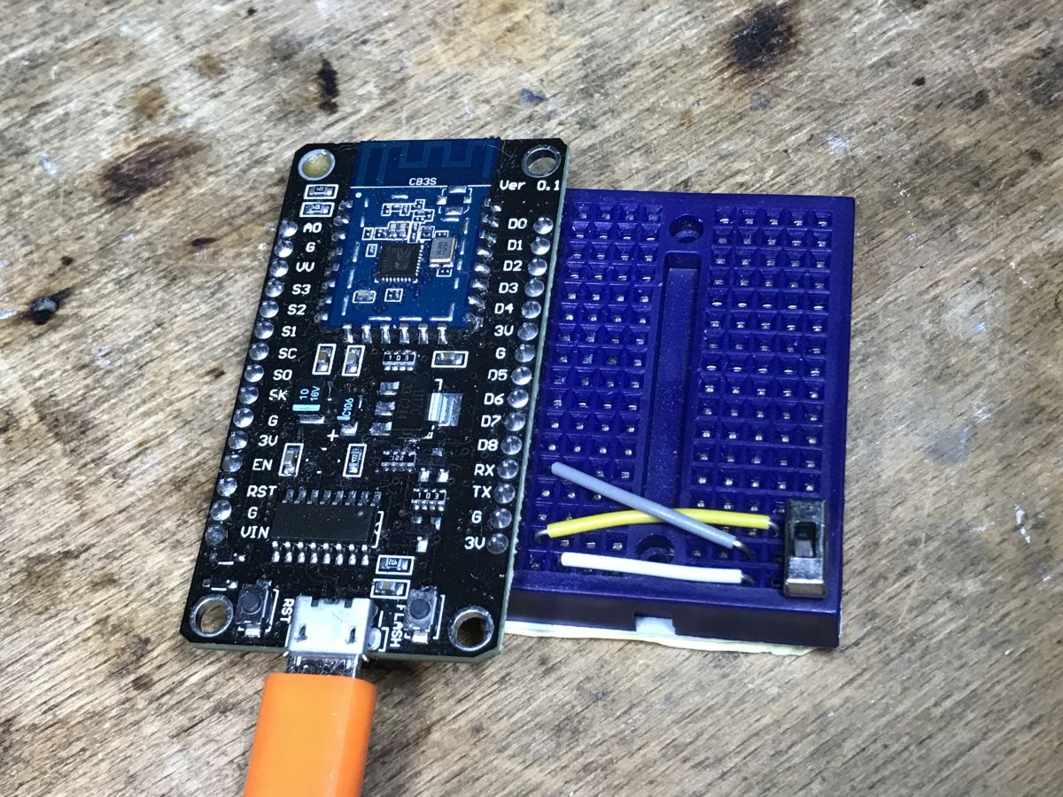

    It's weird. I checked on my board with CB3S in the configuration shorting the GPIO to ground or power and it works for me:

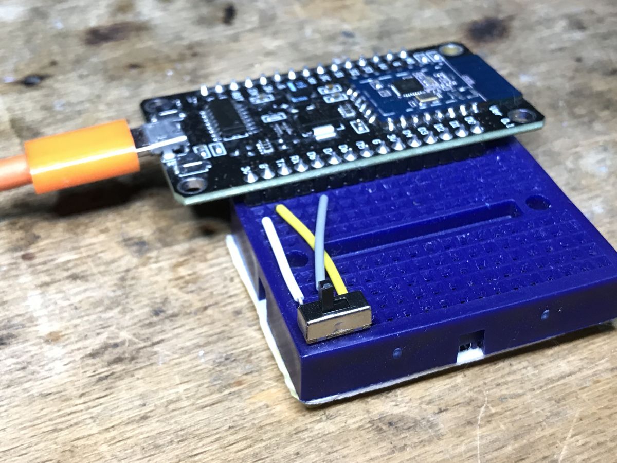

    Test layout:
    Using CH341A Programmer for BK7231N/CB3S Door/Window Sensor PB-69W VER 1.3: UART & OpenBK7231N_QIO Using CH341A Programmer for BK7231N/CB3S Door/Window Sensor PB-69W VER 1.3: UART & OpenBK7231N_QIO
    I need to figure out how to reproduce your problem.

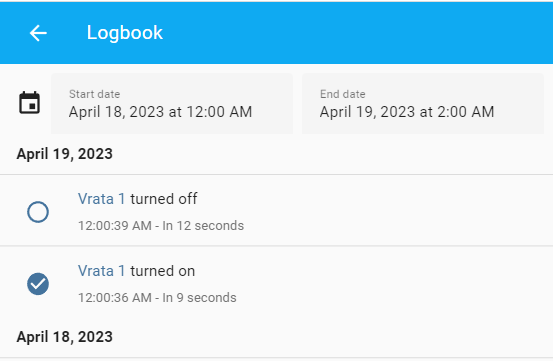

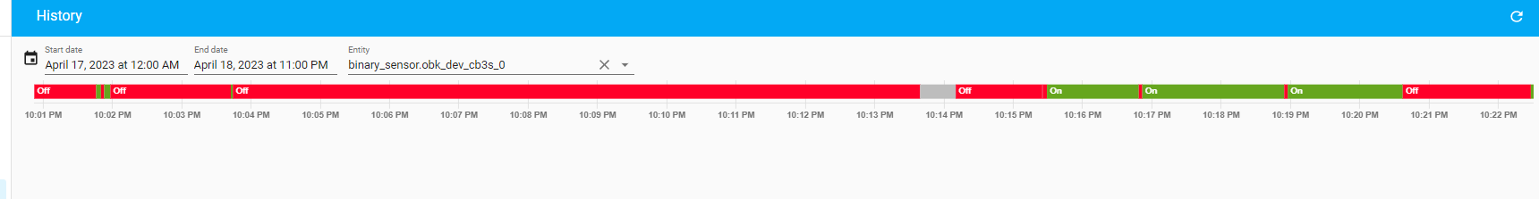

    It is still the same with this fw, i.e. it wakes up nicely when it falls asleep with the reed switch open, but sleep with the closed one is eternal. Apparently, falling asleep with a closed reed switch does more than falling asleep with an open one.
    I also checked the voltage on the reed switch pin with GND and it is 2.6V when closed, 0 when open (normally and during sleep). But when it goes to sleep, it jumps to 3.3V when closed and after opening, it maintains 3.3V all the time.
    EDIT: However, there is a difference in sleep in the open state, because before the diode was constantly on, and now it goes out and only applying a magnet wakes it up again.
    EDIT: Shorting the GPIO to ground wakes up the sensor dormant in the closed state. However, apparently opening the reed switch does not short GPIO with GND when the sensor was put to sleep in this state.

    Indeed, it looks like you have exactly the same technical problem as @4139ggn . I'm not sure what else I can do at the moment, because basically we can only set the pin to input mode, either input_pullup or input_pulldown, there's nothing else to do here. You could also combine and dynamically set the mode to pullup or pulldown just before the start of sleep, depending on whether we read on pin 0 or 1, but it probably won't do anything.
    I had a similar door sensor but on XR809, and XR809 I desoldered for testing, maybe I can find its board and try to reproduce your problem on a physical device.
    when testing at home, I short-circuit directly to ground / VDD and therefore I am not able to reproduce your problem. I thought pullingdown with this might help, but apparently it didn't help anyway.... That's the _pd we tested.
    If you have a moment of time and, for example, you have a soldering iron and a resistor, e.g. 10k, you can do an experiment and check whether, for example, soldering 10k between the sensor's GPIO and ground will help wake up from closed mode ...

  • Fixed IP reduces HA sensor update delay
    #25 20546258
    nihildiximus
    Posts: 32
    Rate: 23
    With the new fw, the symptoms are:
    - Setting "DSEdge 0; DSTime 15;" in "Set/Change/Clear startup command line" doesn't change anything. Still 60 sec. countdown.
    - After setting a fixed IP, the time was significantly shortened - in HA, the open state appears within 6 seconds and the closed state within 9 seconds (it's strange that both states do not pop up at once, one after the other). It's a bit slower than with the original fw (I checked again and it's 1-2 sec. state change in HA via localTuya), but acceptable, although I don't understand where this 3 sec. delay when sending the second state (I test by doing a quick disconnect and reconnection).
