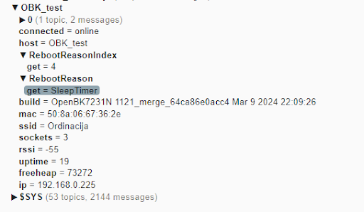

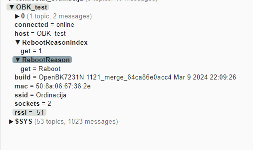

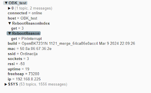

    In order to check the reboot reason (whether it was a timer wake up or GPIO interrupt wakeup), you can use our variable:
    $rebootReason
    Following variable can be used in OBK scripts. For example, you can report the reboot reason via MQTT in the following way:
    // For best results, you need to
    // have at least one pin role
    // set to Button (with a button
    // between pin and the ground)
    // now wait for MQTT
    waitFor MQTTState 1
    // publish int
    publishInt RebootReasonIndex $rebootReason
    // publish str
    if $rebootReason==0 then publish RebootReason Power
    if $rebootReason==1 then publish RebootReason Reboot
    if $rebootReason==2 then publish RebootReason Watchdog
    if $rebootReason==3 then publish RebootReason PinInterrupt
    if $rebootReason==4 then publish RebootReason SleepTimer
    // give user time to play
    delay_s 60
    // sleep either until pin wakeup or until 60 second timer
    PinDeepSleep 60
    After a brief testing, you can see that the published value changes depending on the way you've booted your device:

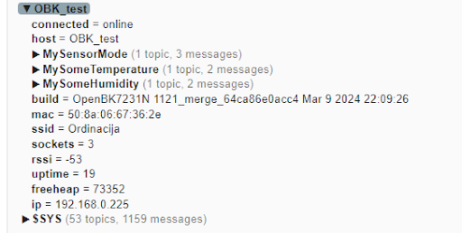

    The following can be extended to make a configuration mode for temperature sensor. Let's say that temperature sensor wakes up every 10 minutes to do a measurement and you also want to be able to wake it up by a button so it stays online so you can reconfigure it. Here is a sample script that offers the said feature:
    // detect reboot by a button
    if $rebootReason==3 then goto config_mode
    // do emergency sleep if no MQTT in 30 seconds
    // addRepeatingEvent	[IntervalSeconds][RepeatsOr-1][CommandToRun]
    addRepeatingEvent 30 1 PinDeepSleep 60
    waitFor MQTTState 1
    // publish data
    publish MySensorMode Normal
    publishFloat MySomeTemperature 12.34
    publishFloat MySomeHumidity 56.78
    // wait 3 seconds more
    delay_s 3
    // sleep for 60 seconds or until next button press
    PinDeepSleep 60
    config_mode:
    waitFor MQTTState 1
    // publish data
    publish MySensorMode ConfigMode
    // do nothing, do not sleep

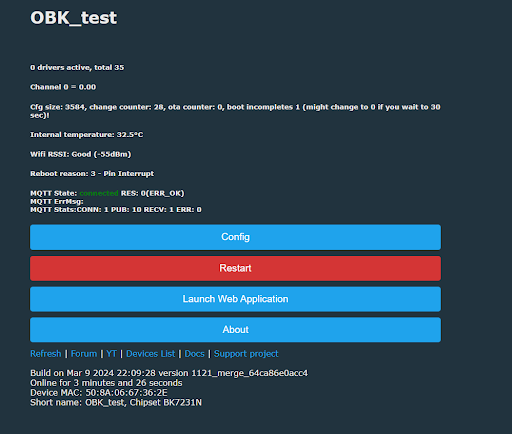

    The script shown above determines the reboot reason and then splits the execution depending on that.
    As you can see, the script works well:
    Screenshot of the MQTT interface with OpenBeken sensor information.
    Screenshot of the OpenBeken application showing the status of the BK7231N controller with various configuration options.
