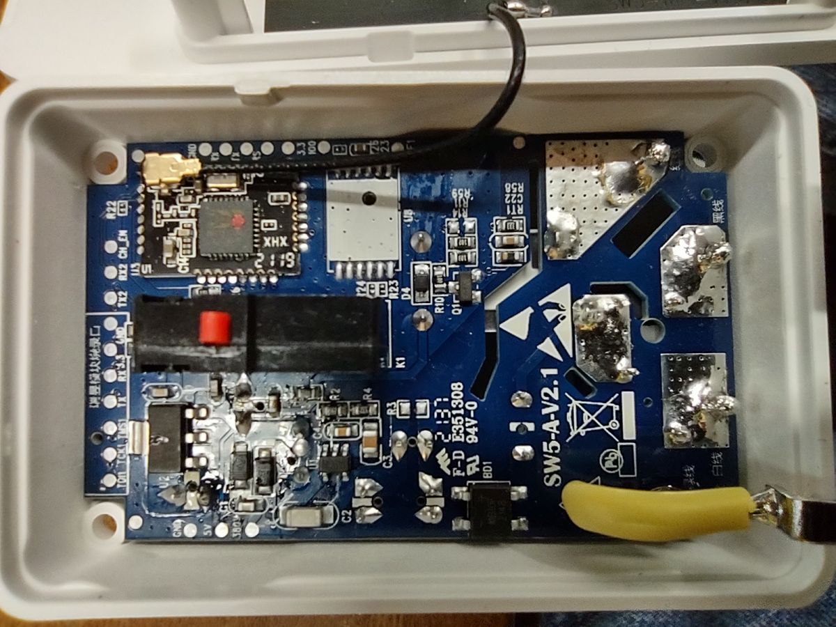

    I purchased a couple of smart switches from Amazon because they appeared to be identical to some Kuled switches that I previously flashed with OpenBeken and they worked well. They are listed as OHMAX Smart Switch. The box lists them as being from ShenZhenCUCO Smart Technology and the switch itself just says Smart Switch Model: SW5. Here's a picture of the switch insides:
    Identify OHMAX Smart Switch: Similar to Kuled, ShenZhenCUCO, Model SW5 - Flashing & Setup Tips
    So does this look familiar to anyone? To be honest I'm not even sure yet how to get the circuit board out of the housing to more easily access the solder pads to tack a few wires for flashing. Any help or suggestions appreciated.

    Hello, the very similiar device, Gosund Smart Switch SW5-A-V2.1 , was described here:
    https://www.elektroda.com/rtvforum/topic3892160.html
    The topic includes desoldering of WiFi module and the GPIO roles.
    I think if you apply force to wires the board will come out. I had no problems with that.

    Yes, that appears to be identical. I will attempt to flash today and report back
    Thanks,
    Bob
    Added after 2 [hours] 31 [minutes]:
    I just flashed this switch with your instructions and it worked perfectly. The only caveat was that I couldn't get bk_writer 1.60 to work - probably my fault. However 1.0.7 worked flawlessly. I also greatly appreciate the new option to set the static IP address, I have a hard time keeping up with all of your improvements.
    Thanks again,
    Bob
