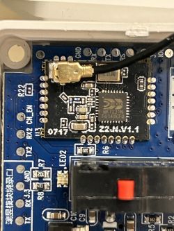

    I used this great teardown to get some Gosund SW5s working.
    https://www.elektroda.com/rtvforum/topic3892160.htm
    Everything worked great, but my version was a bit different.
    Before considering things I include here, read the post above. I won't repeat things here.
    My version:
    Externals:
    Gosund SW5 smart Wi-Fi switch
    Model: SW5
    Manufacturer: Shenzhen Cuco Smart Technology Co Ltd (from box)
    Date code: 11/23 and 12/23
    Internals:
    PCB: SW5-A-V2.1
    Module: Z2-N-V1.1 has other "0717" marking
    MCU: BK7231N
    Smart life app reports:
    Main Module: V1.0.1
    MCU Module: V1.0.1
    P7: LED (main, green, most visible)
    P8: Btn
    P14: Rel
    P16: LED_n 1 (red, visible through same switch window as green)
    Close-up of a circuit board featuring a Z2-N-V1.1 module and BK7231N microcontroller.
    The only real significant difference I see is the module and chipset are different. (new module version# with an N Beken chip vs. the T)
    The openBeken N firmware was available here: https://github.com/openshwprojects/OpenBK7231T_App/releases and serial flashing worked well.
    There was not a device-profile supported for this chip/firmware on tuya-cloudcutter. Cossid helped get that sorted super quick https://github.com/tuya-cloudcutter/tuya-cloudcutter/issues/598. I was able to get it flashed OTA without opening one up using this guide here: https://github.com/tuya-cloudcutter/tuya-cloudcutter/blob/main/HOST_SPECIFIC_INSTRUCTIONS.md
    I really want to get another auxiliary input working (Maybe those TX/RX TX2/RX2 pads) but I'm getting stumped as the bootloader and firmware are making use of those pins for serial programming and logging. I was able to get TX/RX freed up and working as GPIO (with a custom FW hack to the SDK source), but I'm concerned I might be messing up future serial loading capabilities. TX2/RX2 have been more resistant to my novice hacking. I want the extra input because I like using it for controlling a 3-way switch for another light with a dumb switch in the same electrical box. Anyway, I'll probably be posting for help on that soon (10 more bangs of the head on desk first)

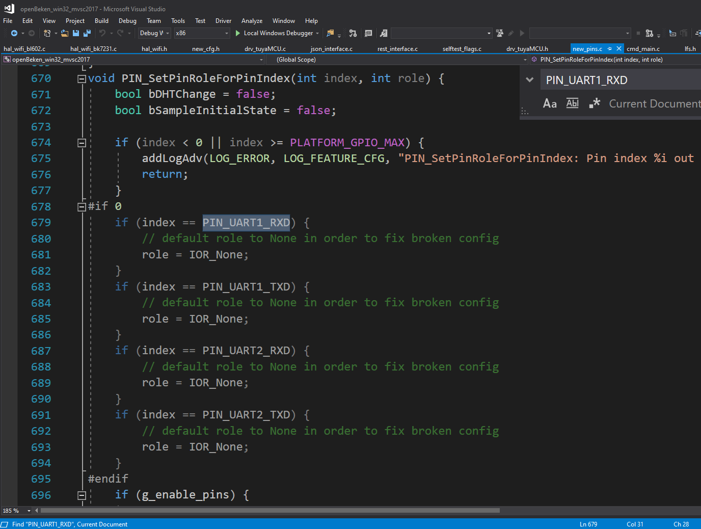

  • #4 20925342
    Posts: 14765
    Rate: 12899
    So it's a soldering issue, I see. Very well. Let's try to reuse UART ports, then.
    Okay, from what I can see in the code, the UART ports protection is disabled already:
    Screenshot of code in Microsoft Visual Studio related to UART port settings.
    Why do you think that you are unable to tamper with them? I think they should work okay when you set a Relay role for them or something.

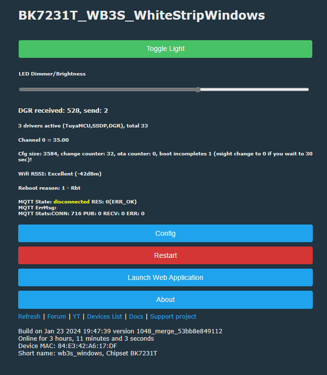

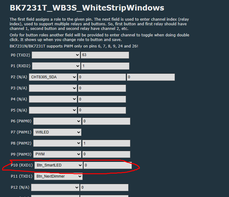

    #6 20925622
    Posts: 14765
    Rate: 12899
    First of all, I must admit that I am confused. Even my light strip that I use daily has a button on RXD1 and it works for 3 years already:
    Screenshot of BK7231T settings with pin configuration.
    But still, if you think that something overwrites your settings, try autoexec.bat with:

  • #8 20925629
    Posts: 14765
    Rate: 12899
    This is current version:
    Screenshot of the LED lighting management interface for BK7231T.
    I update it every week or two and it always works.
    Btw, you can also search templates to check which devices are using P0, etc, for some role:
    https://github.com/OpenBekenIOT/webapp/blob/gh-pages/devices.json
