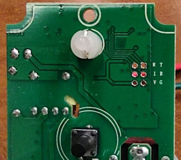

    It appears that "Touch Switch US (Hidin Tech)" in the tear down list is nearly identical to my switch but, when I click on the link for the tear down, it just takes me back to the full list. Am I doing something wrong?
    Also the pin layout appears to be 2mm spacing and I only have 0.1" headers so I have soldered temporary wires for flashing. Just need to figure out how exactly to do that.
    Thanks

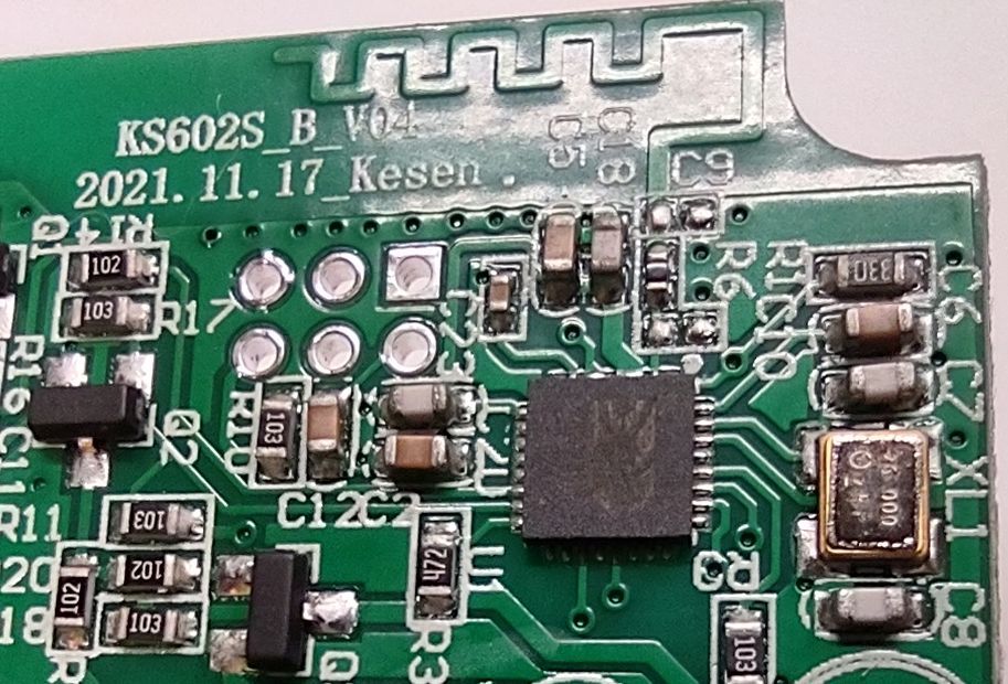

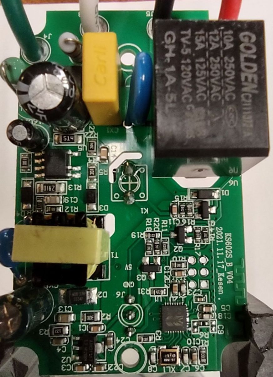

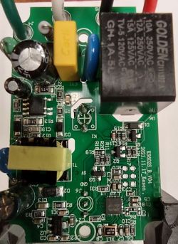

    Hello, can you provide more detailed photos? I can't even see the WiFi module (nor the BK chip, if it's directly on board).
    The markings near the place for programming header are also not clear. We might need to follow the PCB traces.
    V and G might be VDD and GND, but R and T? RX and TX? But what about the remaining two ones? And why is R twice? No idea yet.
    The link from teardowns list might be missing if the original author didn't provide the teardown, just gave us the information about the device. Once we have figured out the flashing, I might add a link to that topic there.

    Okay let me try to provide better pictures although it's really difficult to read the name on the chip without some powerful magnification and getting the light just right. The chip is a BK7231N and here is the chip side of the board.
    Flashing Kuled Smart Switch with BK7231N Chip using OpenBK7231T_App on Windows
    and here is a close up of the chip

    Finally here is an image of the opposite side of the board

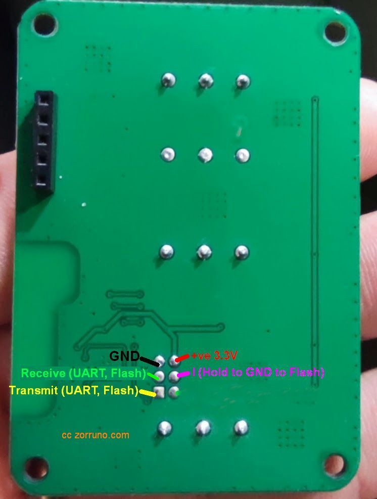

    I found this image from another flashing tutorial and I expect that this is the same layout for the 2 X 6 header
    Does this help?

    I have done some additional probing and V and G are 3.3V and ground. R and T go to pins 26 (RXD) and 27 (TXD) respectively. The second R appears to go to pin 21 (CEN) and I goes to pin 19 (SDA/TMS). This is a little confusing but I think is correct.
    Hope this helps.
