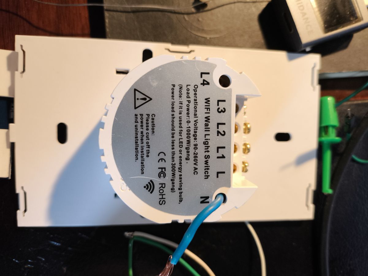

  • Close-up image of the inside of a light switch showing the PCB and CB3S module. .
    Here is another product that, after a firmware change, can be run 100% locally and linked to Home Assistant. This time it's a single light switch, appearing under vendor code 72-087#, but related models may also have designations: DS-101, DS-111, DS-151, DS-161, DS-1011ZC. Firmware is uploaded as usual via UART.
    I got the product in a kit from a reader - I was changing the firmware for him at his request in exchange for the opportunity to take photos. I received a whole series of these gadgets, but for now we will discuss the switch. The whole set can be bought for a few dozen zlotys (from China you can even order for 30 zlotys, in our country more like 60):

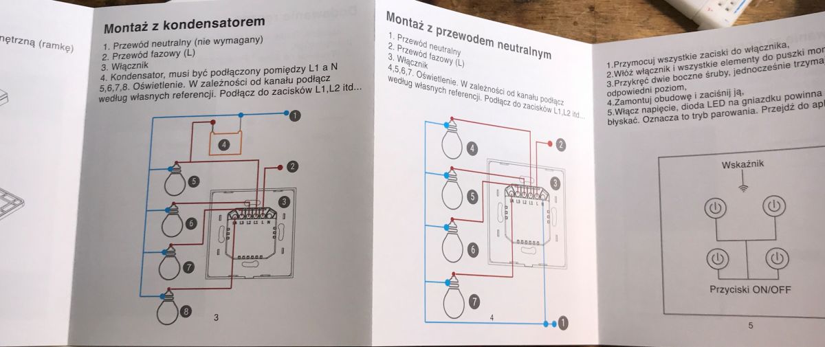

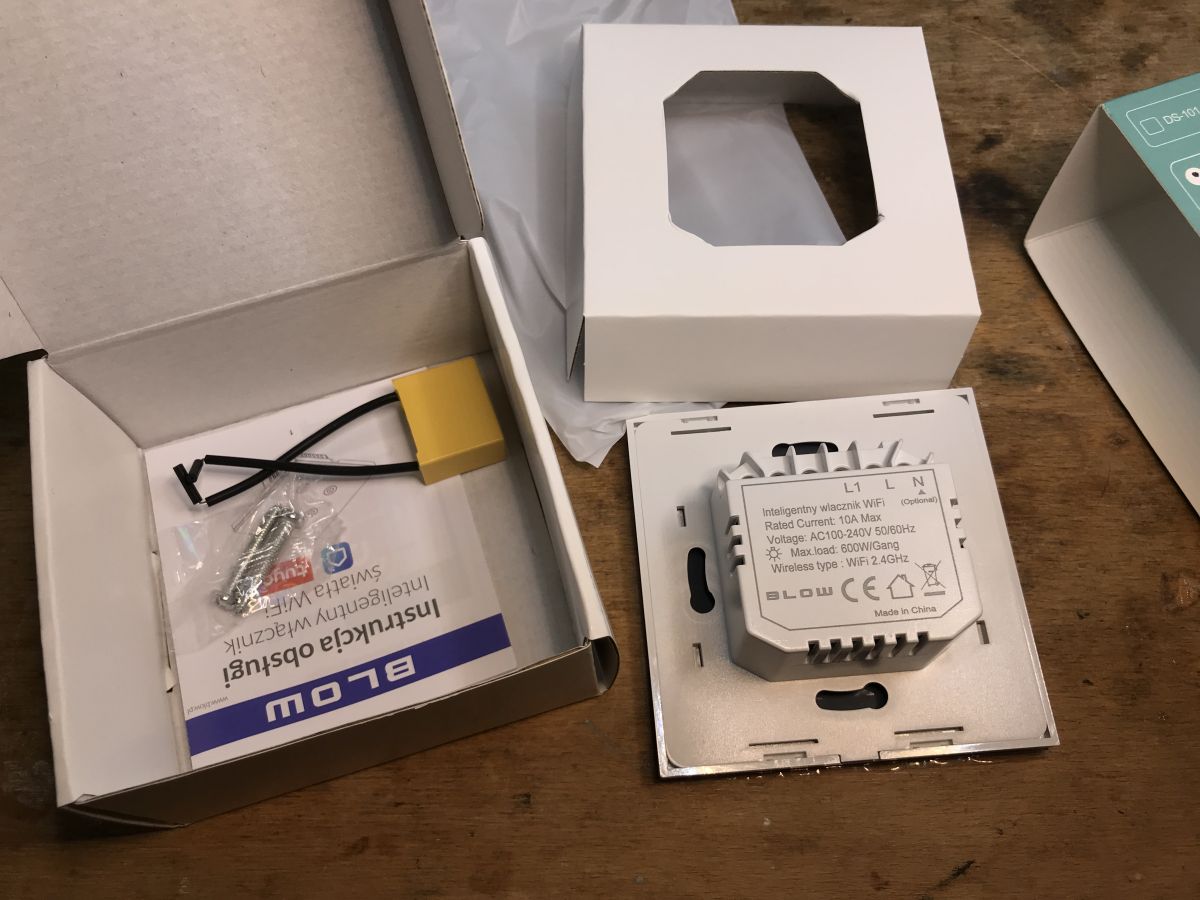

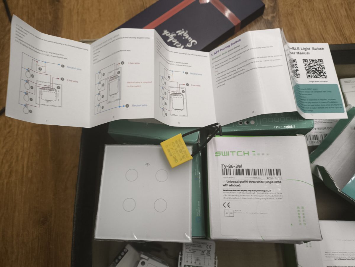

    Included is a capacitor, referred to rather oddly by the vendors as an 'adapter', and an instruction manual:
    Smart WiFi light switch with accessories in a box. .

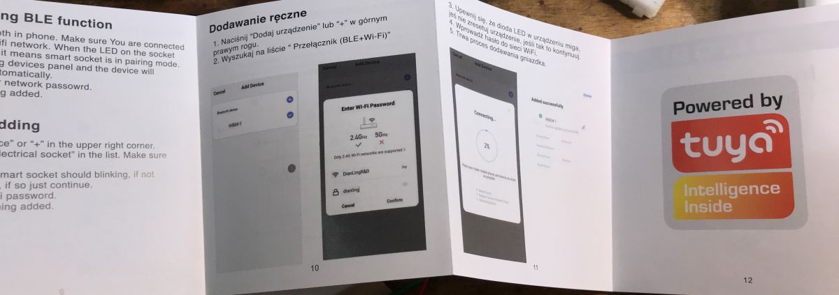

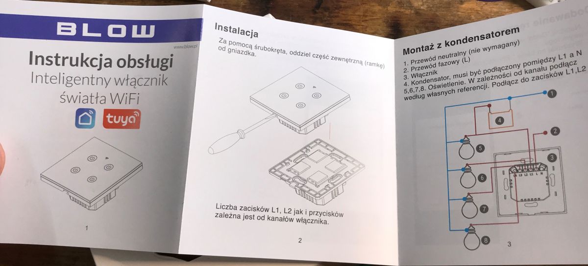

    The manual is in our language, the seller has already taken care of that:
    User manual for Blow WiFi smart light switch. .
    Installation manual for light switch with capacitor and neutral wire. .
    Light switch manual with installation instructions and QR codes. .
    User manual for smart light switch .
    Instruction manual for pairing a Tuya device with BLE feature. .
    The manual describes pairing with Tuya, but I have other plans....

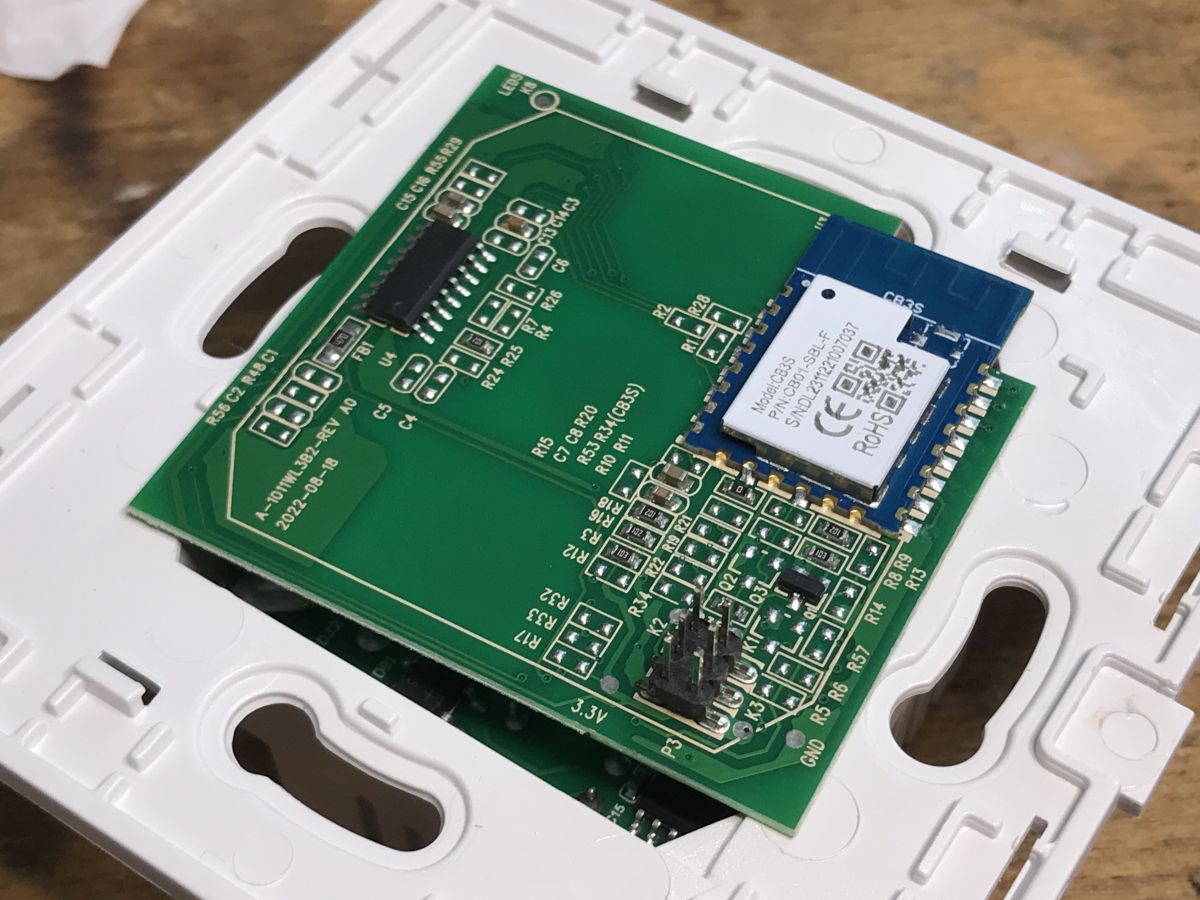

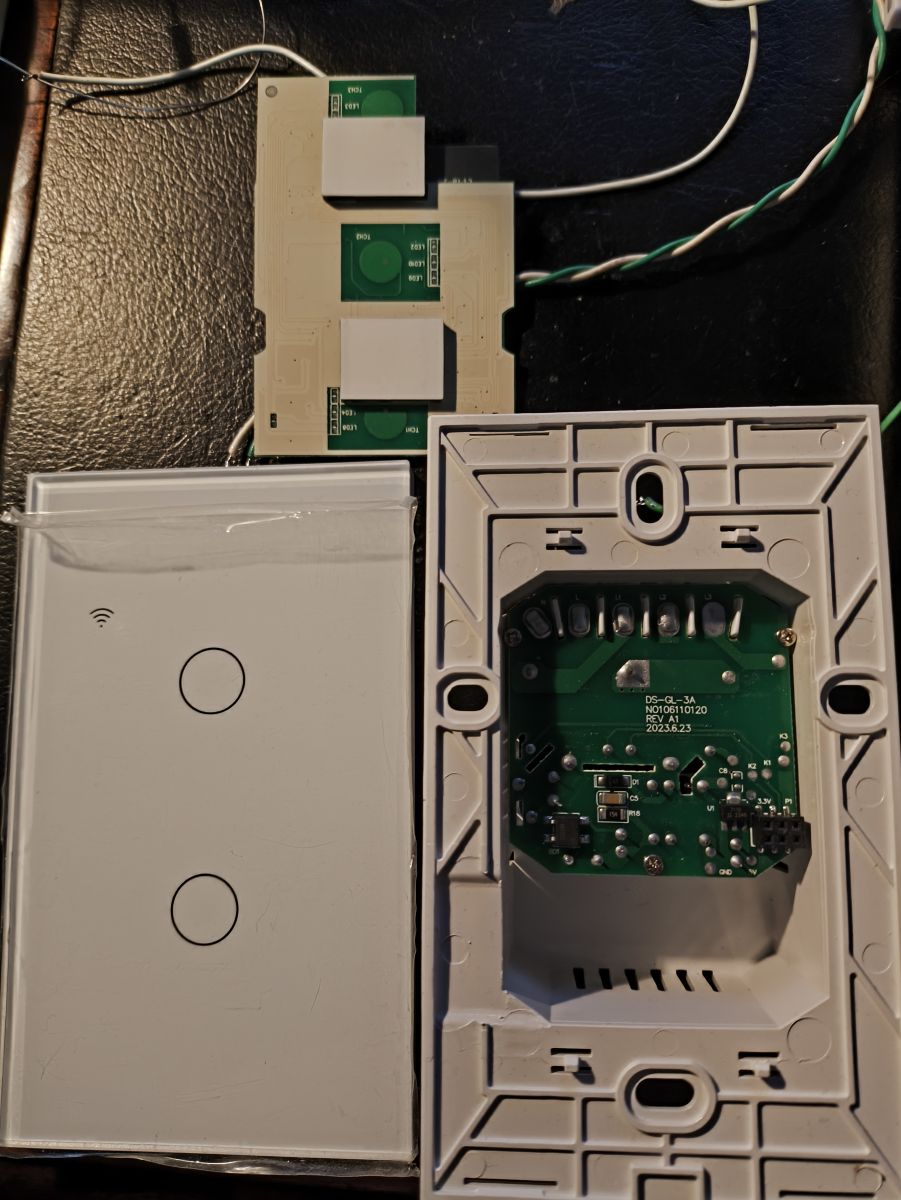

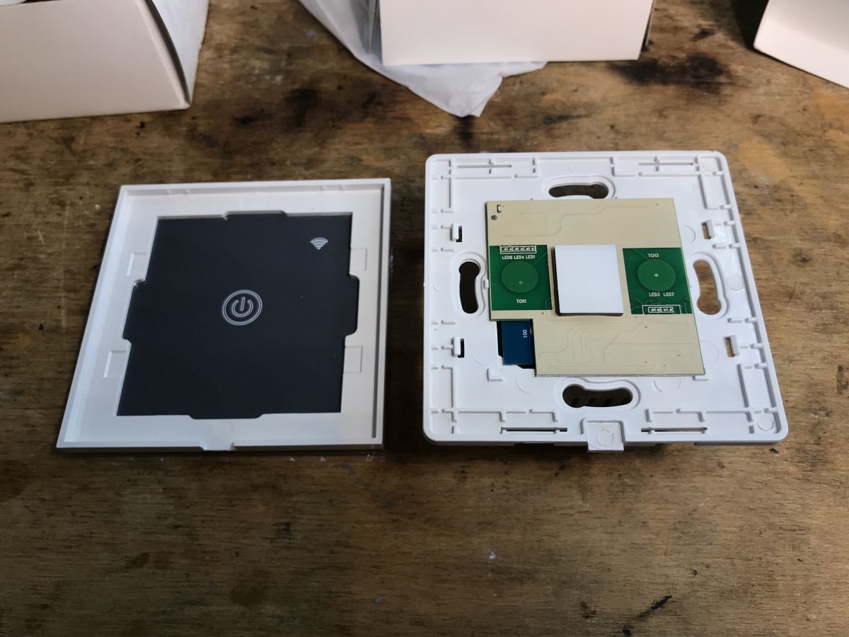

    Interior 72-087 .
    Removing the front panel:

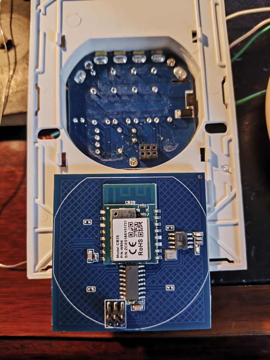

    Light switch with exposed PCB and visible touch panel. .

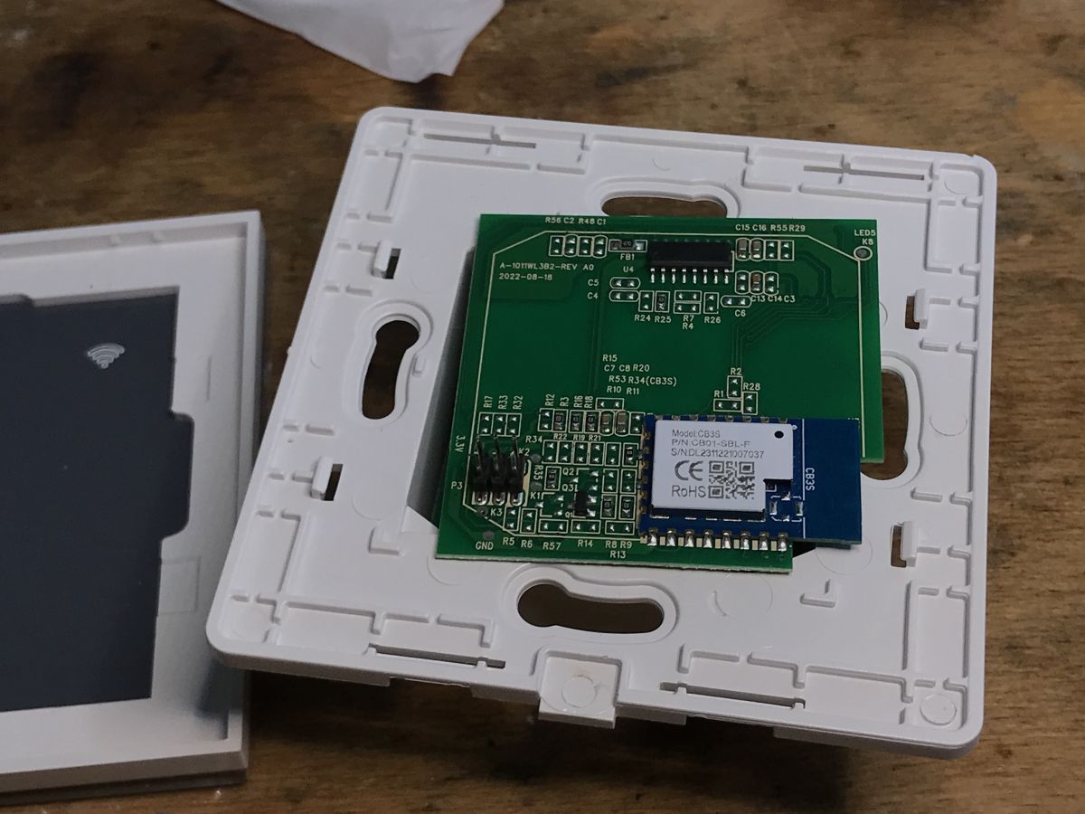

    The same PCB is used by the three versions of the switch - single, double and triple.
    Close-up of the PCB board of a single light switch with a CB3S module. .

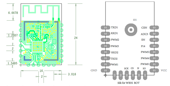

    The switch is based on the CB3S module (similar to the WB3S):
    Electrical schematic and pinout of the CB3S module. .
    PCB designation: A-1011WL3B2-REV A0 2022-08-18
    Close-up view of the interior of a light switch with a CB3S module. .

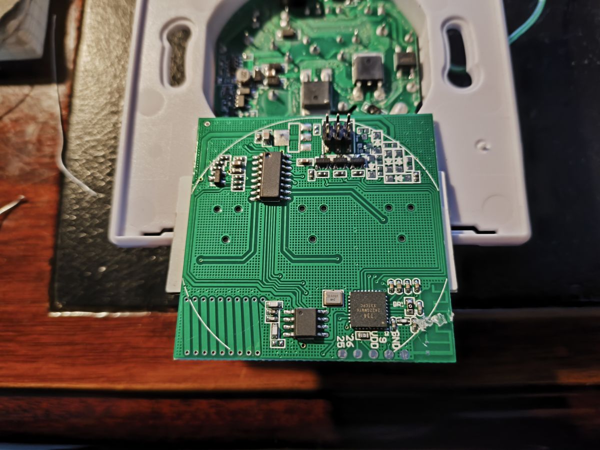

    This large component in the SOIC is the touch button controller.

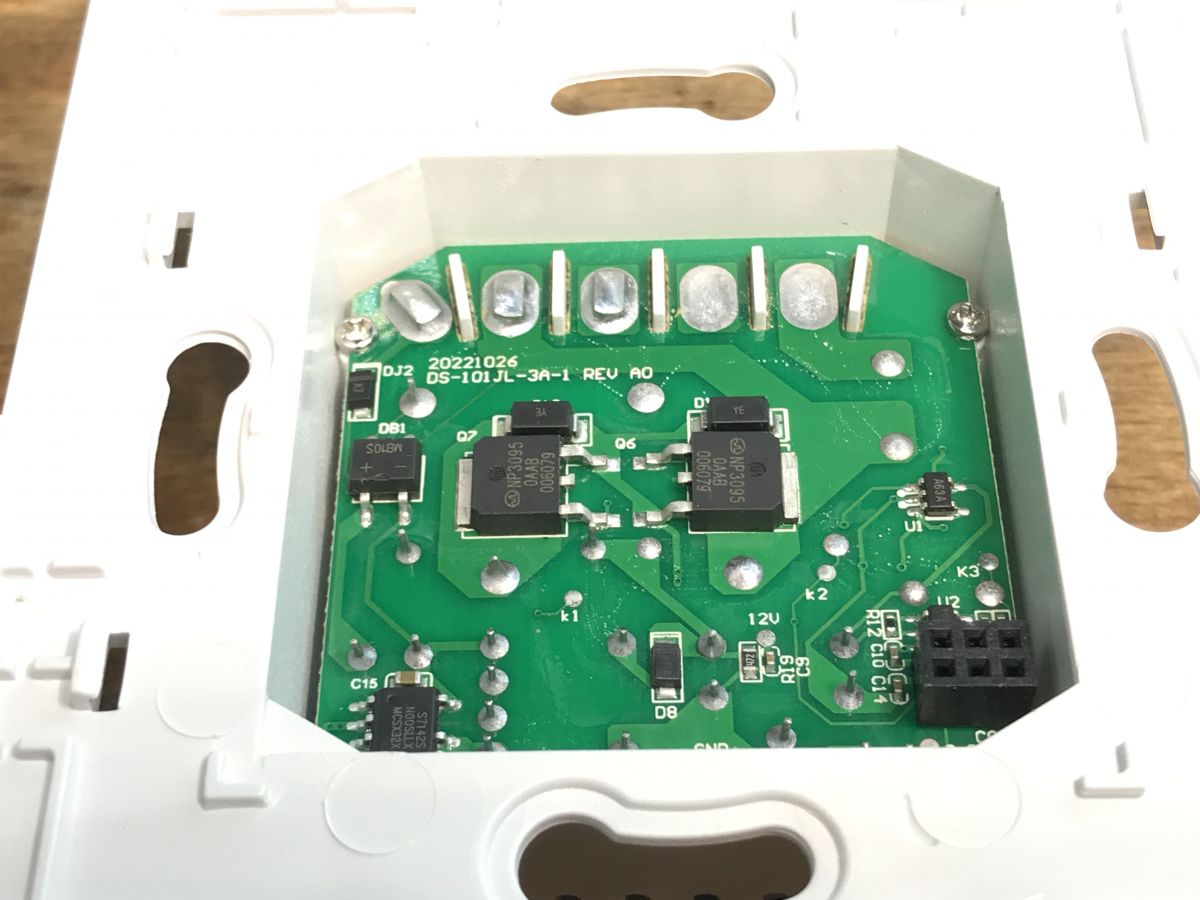

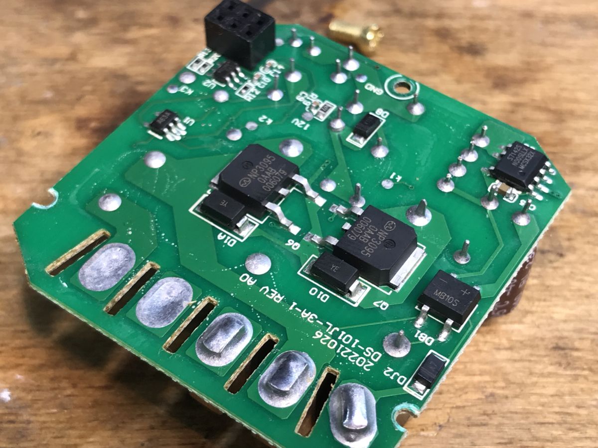

    A second PCB remains:

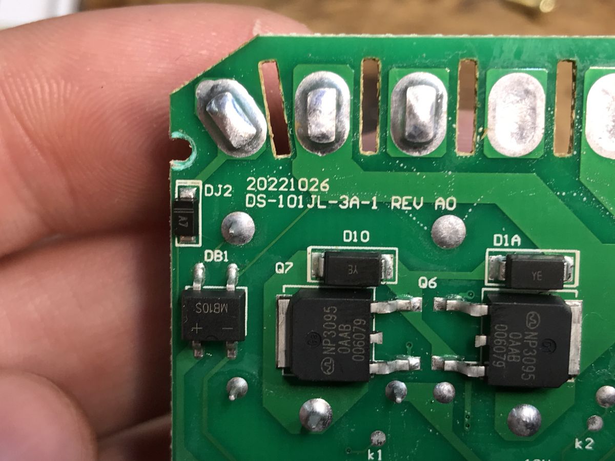

    Printed circuit board in the DS-101 light switch. .

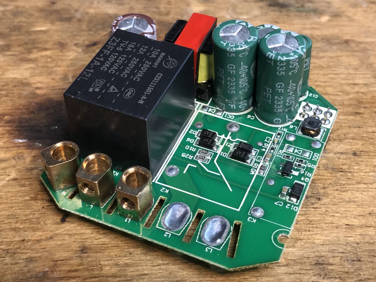

    Designation of the second PCB: DS-101JL-3A-1 REV (A), 20221026.
    Light switch PCB with visible capacitors and relay. .
    Close-up of a PCB with a relay and capacitors. .

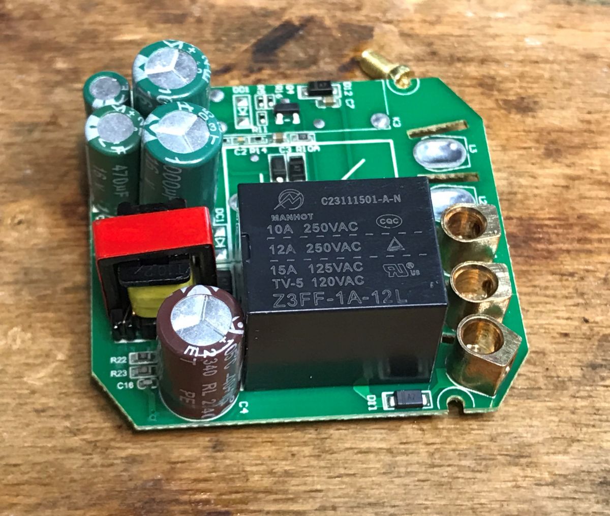

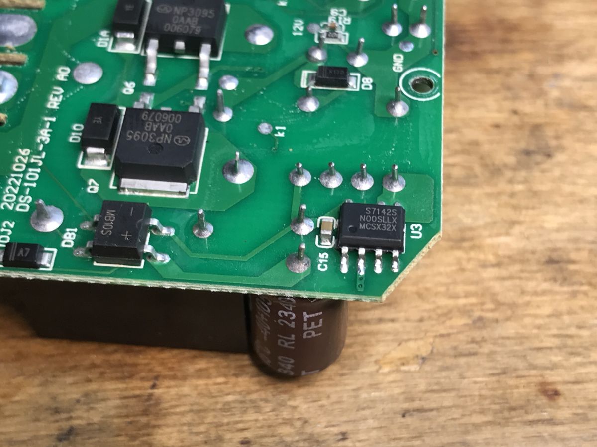

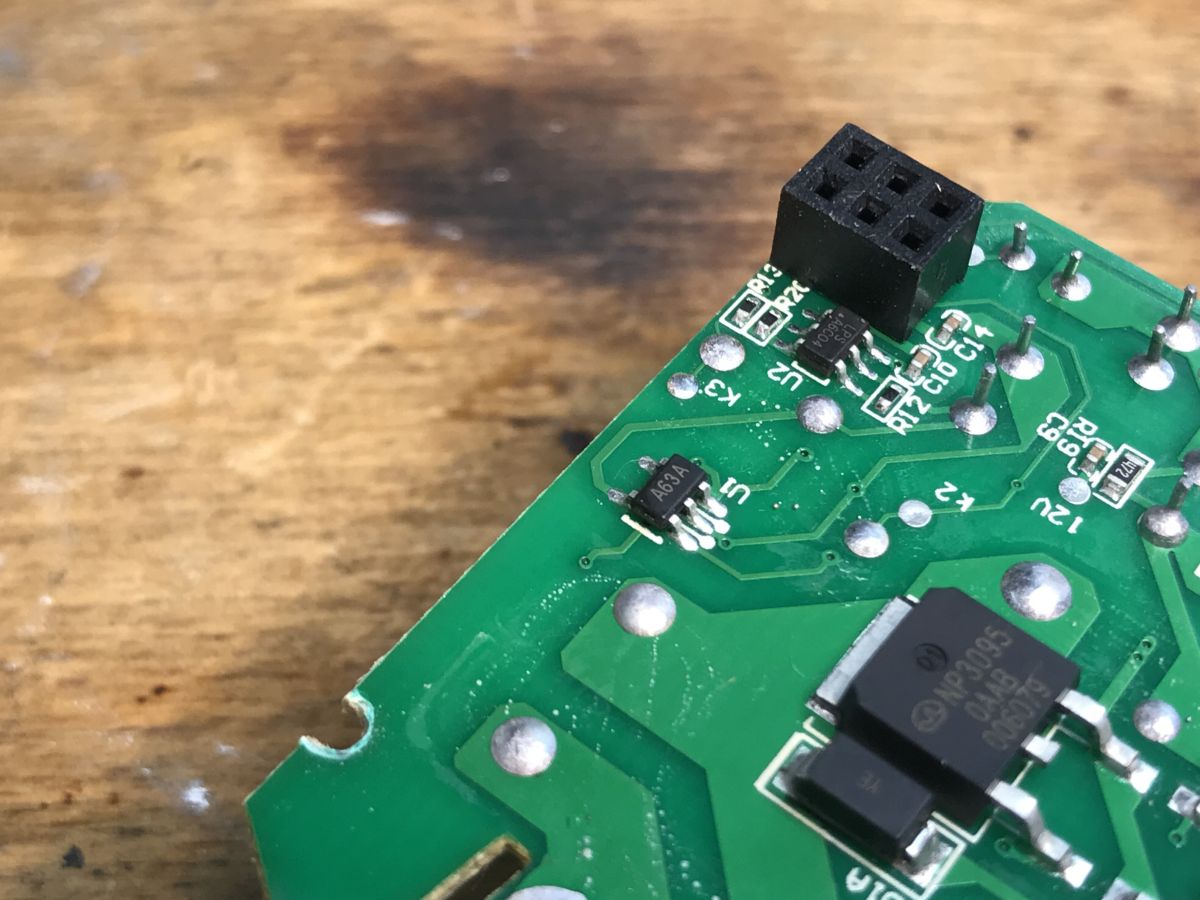

    On the board there is a small power supply in flyback topology and one relay. From underneath I can see additional electronics:
    PCB board of a switch with markings and electronic components. .
    Close-up of a PCB with electronic components, including the S7142S integrated circuit. .
    Close-up of a circuit board with electronic components. .
    Close-up of a PCB marked DS-101JL-3A-1 REV A0. .

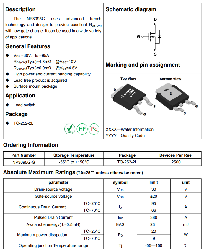

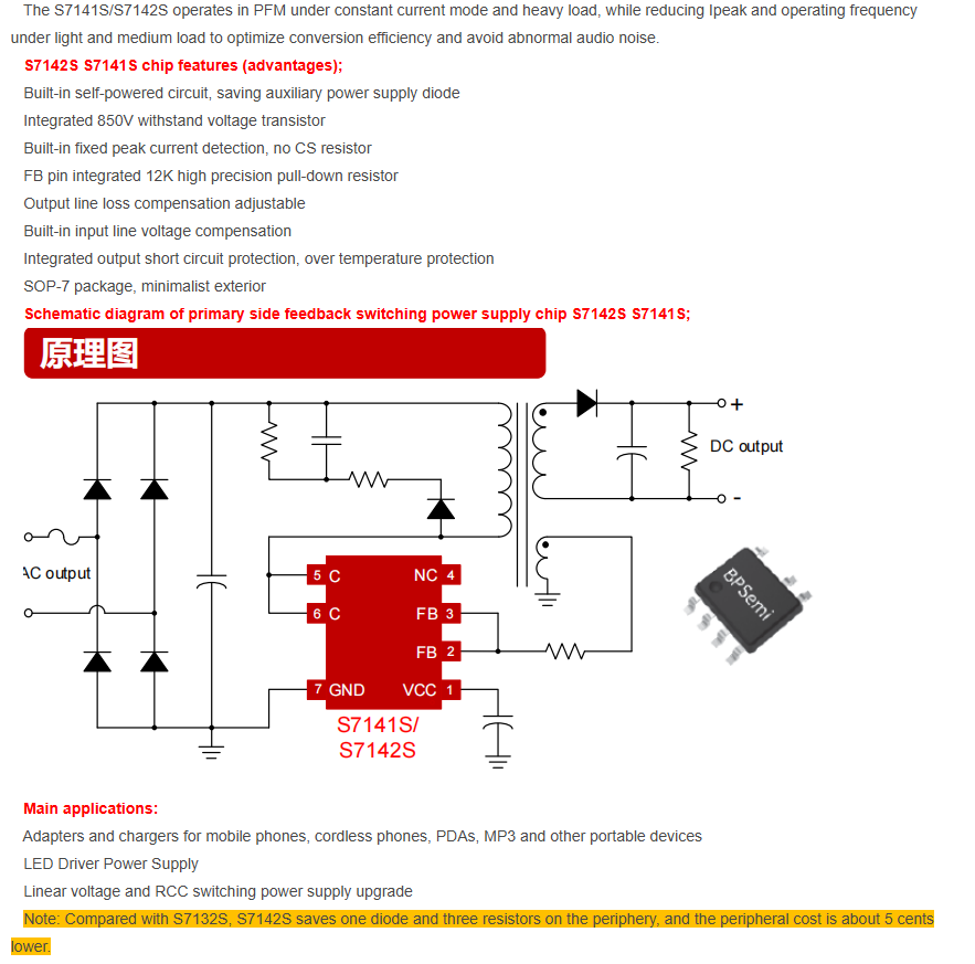

    The power supply is based on the S7142S:
    Diagram of a switching power supply based on S7141S/S7142S chip. .
    What I don't know is why these NP3095s are there?
    Datasheet for NP3095G transistor.

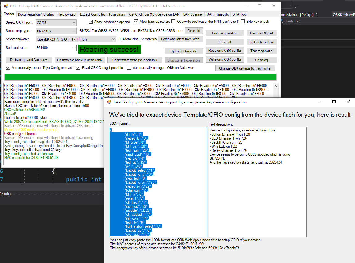

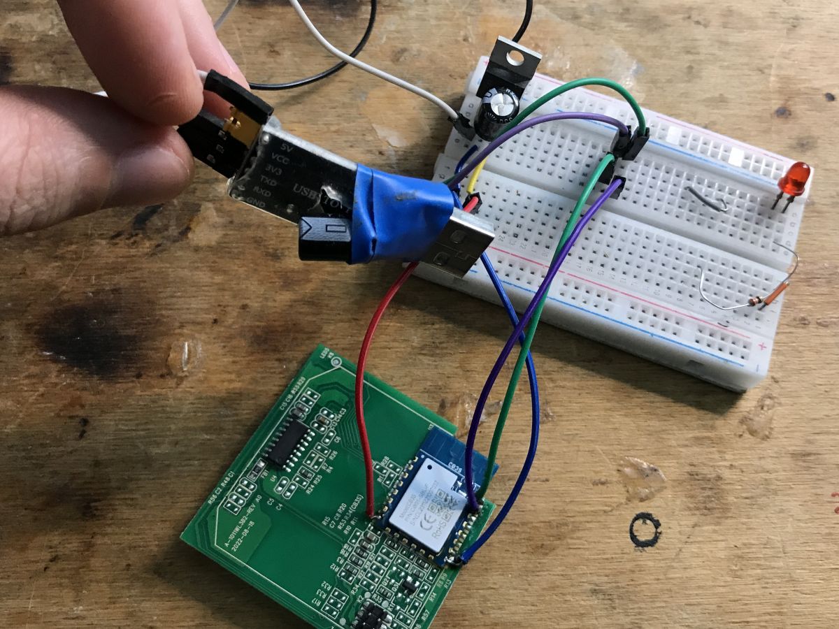

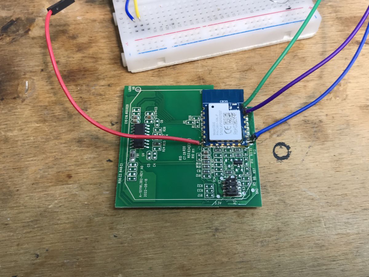

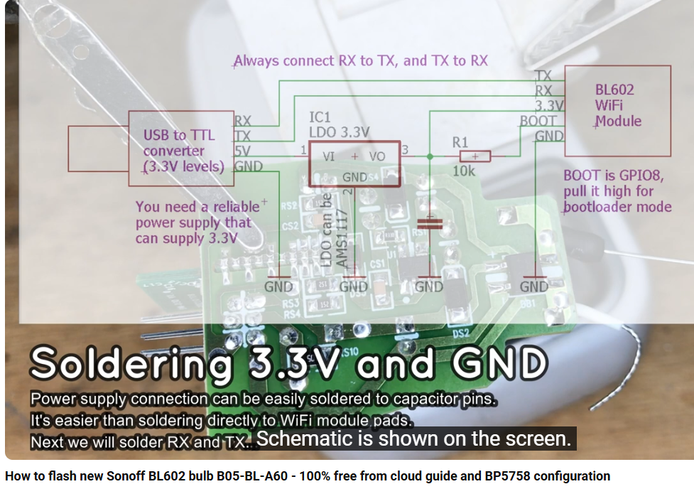

    You will need a USB to UART converter. According to the flasher instructions:
    Or according to our YT video:
    Soldered wires (see pinout CB3S):
    Light switch PCB with connected wires. .
    PCB with attached wires and light switch. .
    Flasher correctly reads GPIO configurations:
    Firmware flashing tool screen displaying JSON files for device configuration.
    JSON Tuya:
    OBK template:
    Import instructions:
    Instructions for pairing with HA:
    Copy of factory software:
    https://github.com/openshwprojects/FlashDumps/commit/0d2ae0b9796aaf6172a2d76beac313c8526a474c

    I have unbranded ones from Ali, at ~$7 for 4p and $5 for 2p, and was just about to go for them too.
    Two electronic modules with visible circuit components and QR codes on a table. .
    Box with touch switch components and instruction manual. .
    User manual and boxes of smart switches on a table. .
    Boxes of electronic components in a cardboard box. .
    differ in the front plate only because of the number of buttons

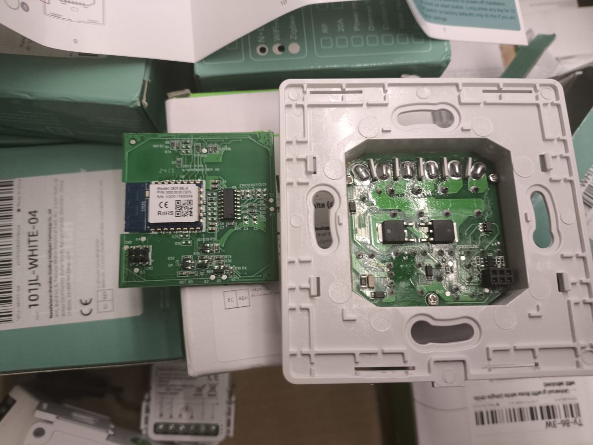

  • CB3S pin map and Tuya config extracted
    #6 21427232
    chemik_16
    Posts: 1000
    Help: 75
    Rate: 128
    here we go:
    101JL-WHITE-04
    CB3S
    readResult_BK7231N_QIO_2025-06-2-12-23-50.bin
    	"rl1_lv":"1",

    - Button (channel 1) on P24
    - Backlit IO pin on P23
    - WiFi LED on P22
    - Relay (channel 2) on P8
    - Relay (channel 1) on P6
    - Relay (channel 3) on P9
    - Relay (channel 4) on P26
    - Button (channel 4) on P14
    - Button (channel 3) on P7
    - Button (channel 2) on P20
    Device seems to be using CB3S module, which is using BK7231N.
    [/code].
    • readResult_BK7231N_QIO_2025-06-2-12-23-50.bin (2 MB) You must be logged in to download this attachment.
  • Tuya pinout for 4-gang BK7231N switch

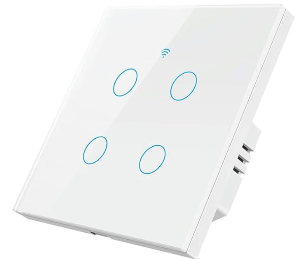

    I see that separately there is WiFiLED and backlight IO, not bad....
    Does the photo agree?
    White touch panel with four illuminated buttons and a WiFi icon on top.

    @chemik_16 if possible I would recommend checking if these switches have an RF receiver inside too? I've bought so many of these products that I know that even sometimes you get a surprise RF that isn't announced in the listing description. If it is, there will be a separate antenna (path) on the PCB and probably a circuit in SOIC8 with an additional quartz resonator.

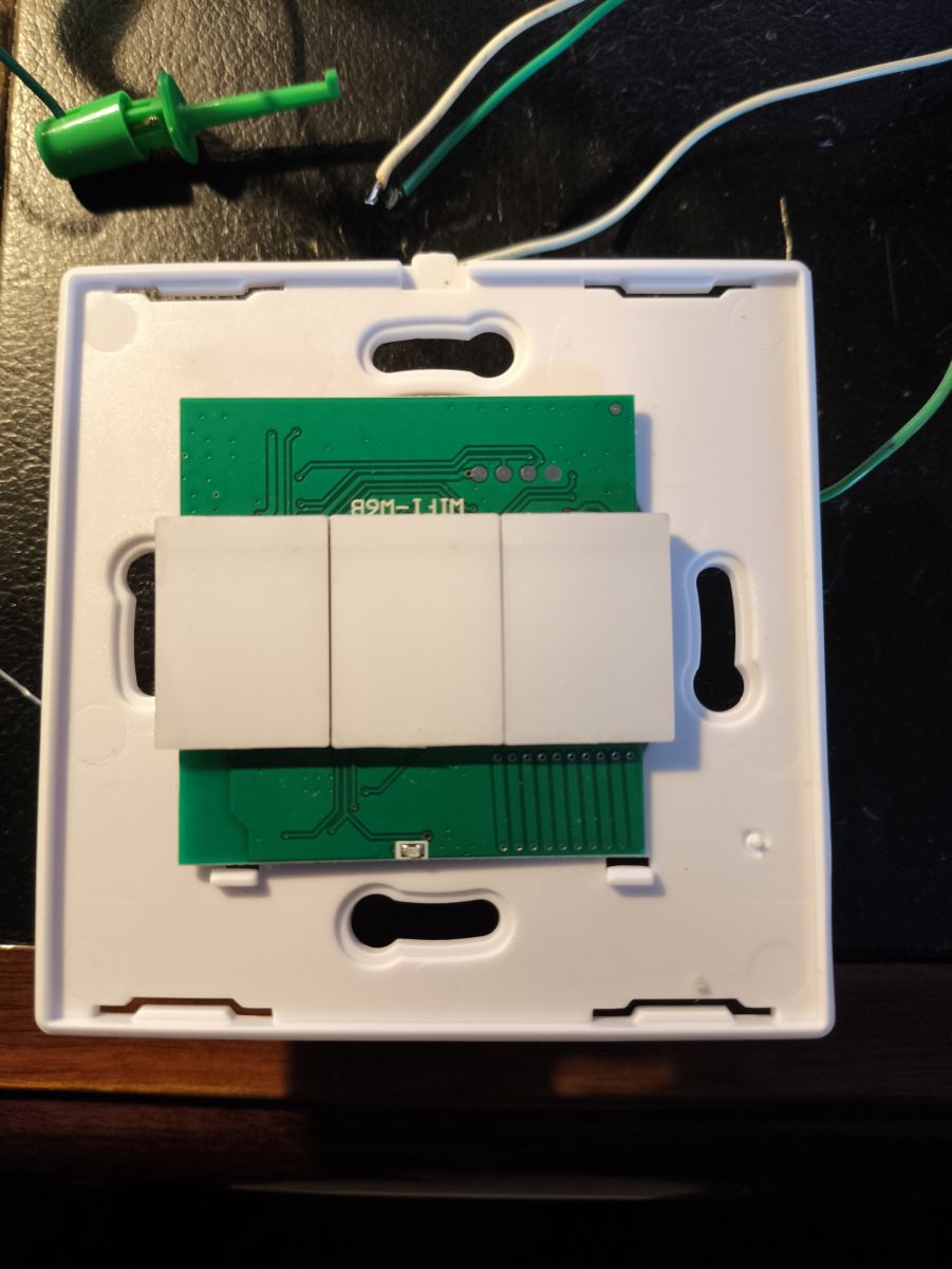

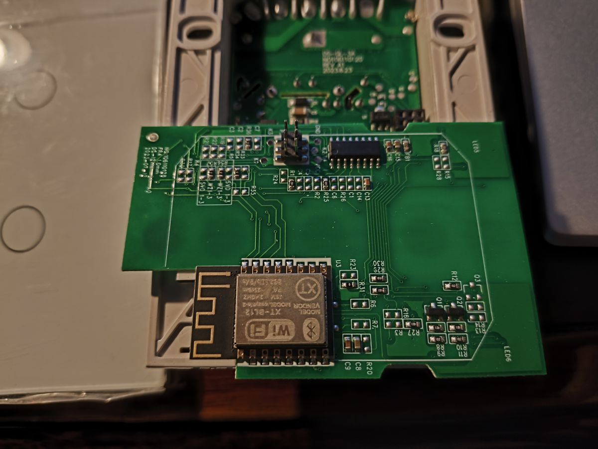

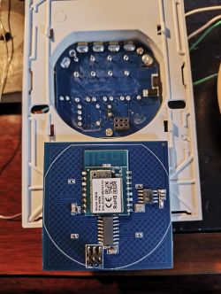

    This triple more interesting, T34 is bk ?
    TY-86-3W
    pcb - Wifi W6B
    Image of a printed circuit board with electronic components, resting on the casing of another device.
    PCB marked Wifi W6B in housing.
    I think this one has rf
    edit: the T34 is definitely faster to get up, in 0.5sec it's already flashing wifi. The previous one took 3-4sec to do it.

    It's also a BK7231N core, you flash the same way. I think the newer Tuya devices on T34 are becoming more common.
    But fart, a T34 with pads derived?
    Also rip a 2MB batch and you can upload OBK.
    We've already had a T34 without derived pads:
    [BK7231N / T34] Teardown Tuya Generic Wifi Wall Switch 3-fold .

  • BK7231T T34-3 pinout and OBK template
    #11 21427275
    Posts: 14743
    Rate: 12839
    Flash tool is not yet perfect. I poked around on my side and got it:
    Device seems to be using T34-3 module, which is BK7231T chip.
    - Relay (channel 1) on P9
    - Relay (channel 2) on P15
    - Relay (channel 3) on P17
    - WiFi LED on P7
    - Button (channel 1) on P16
    - Button (channel 2) on P14
    - Button (channel 3) on P8
    - Pair/Toggle All Pin on P24
    OBK template:
    Added after 0 [seconds]: .
    The small one in the SOIC8 is the RF. He is connected to the button controller with more legs. When you change the firmware of the WiFi/T34/BK7231 module, you still have RF working, because the WiFi module "doesn't know" about the circuit from RF.
    PS: Oddly, it also found: - Pair/Toggle All Pin on P24 - to check this is....

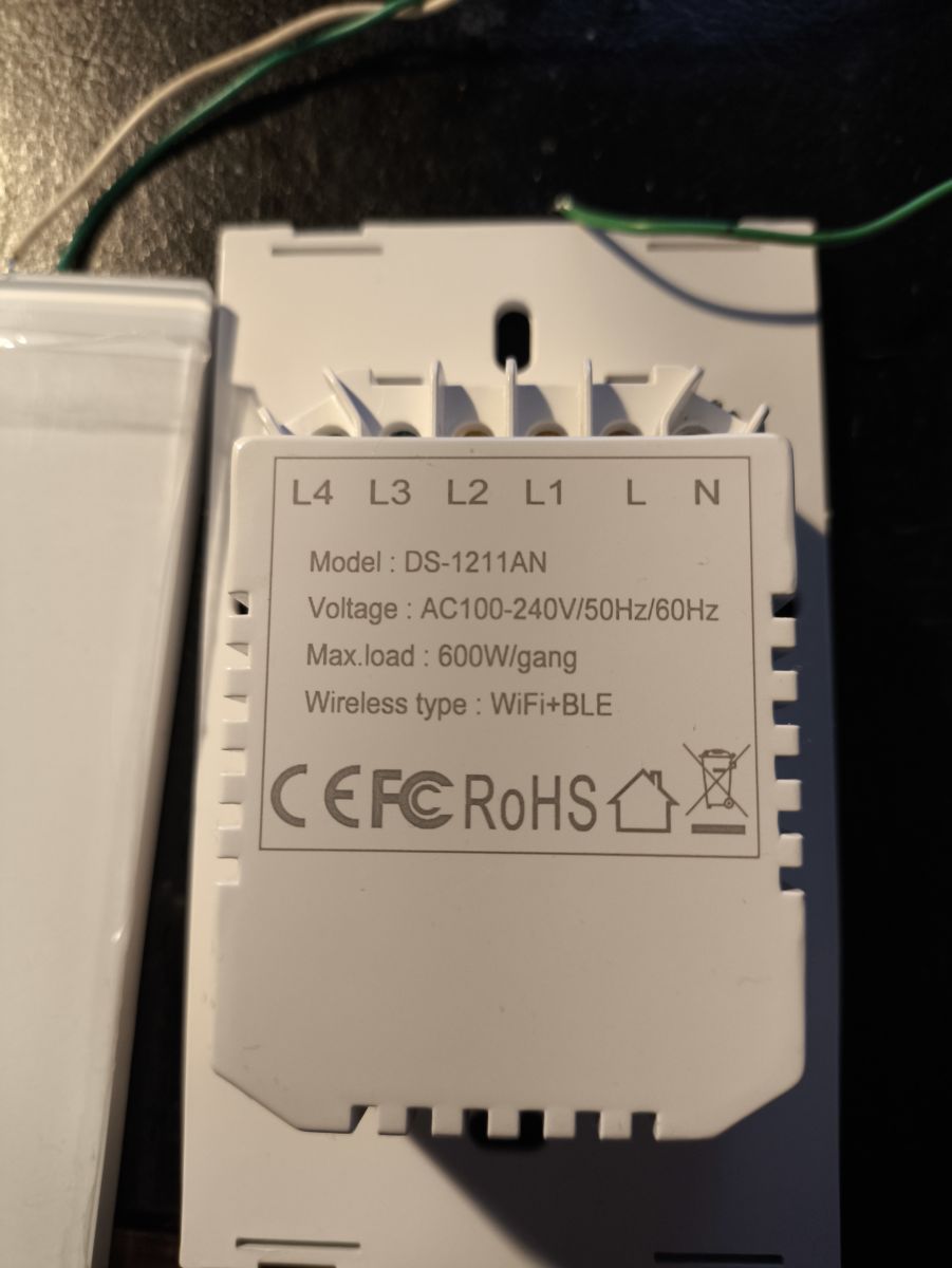

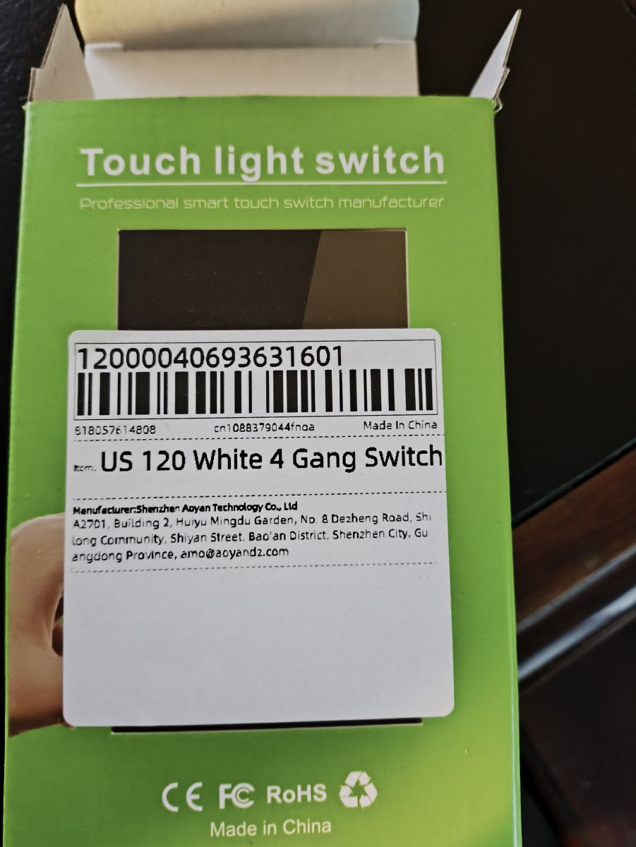

    Another one, 4p ala brazil, but it fits into EU cans (I'm about to give one that doesn't fit as well ;D)
    I do not have a box from it, but I will see on ali
    edit: https://pl.aliexpress.com/item/1005007420510766.html

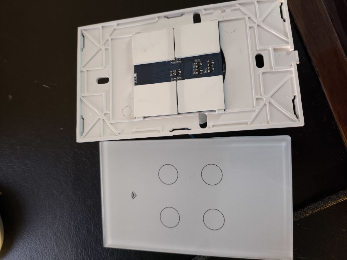

    Touch switch box with an informational label.
    Touch panel with a white casing and four buttons for wall mounting, showing interior electronics. .
    Electronic module with a blue PCB and components. .
    WiFi wall switch with visible L1, L2, L3, L4, and N terminals. .
    these did not obliterate the RF, probably the same circuit
    they didn't clean too much after soldering ;D

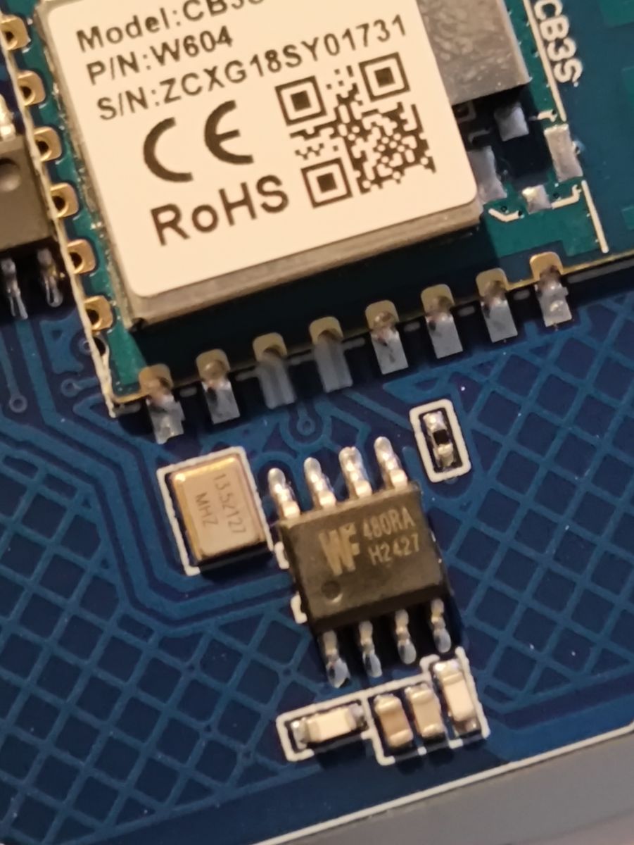

    The WF480RA has already appeared on the forum https://www.elektroda.com/rtvforum/find.php?q=WF480RA
    I wouldn't worry about it though, here it is also connected to the button controller, so RF will continue to work after the firmware change. Show a copy of the 2MB batch.

  • CB3S pinout for 4-gang no-neutral switch
    #15 21427333
    Posts: 14743
    Rate: 12839
    Tuya smart touch panel with four buttons, supporting RF433, Alexa, Google Assistant, and other apps. .
    Tuya JSON:
    Verbal description:
    - Button (channel 1) on P9
    - WiFi LED on P11
    - Relay (channel 2) on P24
    - Relay (channel 1) on P26
    - Relay (channel 3) on P14
    - Relay (channel 4) on P6
    - Button (channel 4) on P10
    - Button (channel 2) on P8
    OBK:
    With this number of additional buttons, it is easy either in the OBK itself or in the HA to make automations like "light switch (additional button) turns on LED strip from above the window", etc.

    That was my goal ;) and these 4p and 1p cost the same after coin discounts. I'll stick some icons on the buttons or laser engrave them.
    Next, brasil
    Close-up of the back of a control panel model DS-1211AN with voltage and connectivity information. .
    Brazilian can, does not fit EU/US cans
    Close-up of a green printed circuit board (PCB) with a WiFi module and electronic components. .
    Disassembled touch switch with circuit board and casing. .
    My first, pcb on rich ;) .
    common for 1-4P, can be extended
    variant with BT+wifi
    but its already BK does not move
    probably the one here
    https://www.elektroda.com/rtvforum/topic4086736.html
  • BL602 with 1 MB flash needs trimmed build
    #17 21427357
    Posts: 14743
    Rate: 12839

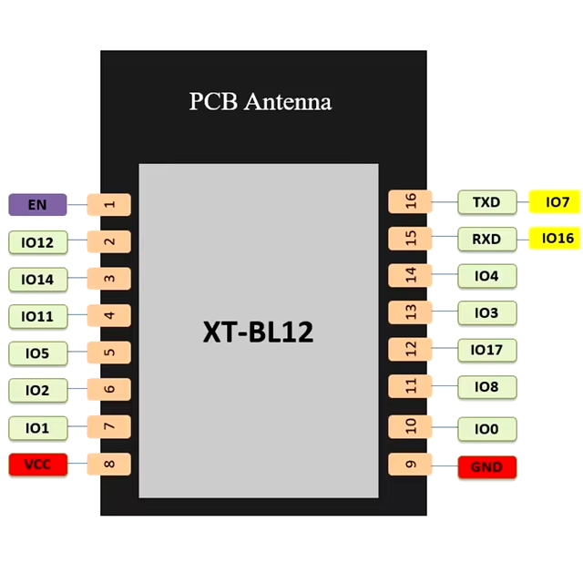

    But is it BT alone or also with WiFi?
    XT-BL12 I see, which indicates BL602:
    Cozylife DS-1211AN 3Gang Touch Switch: 1MB BL602L10 [XT-BL12][DT-BL12] - Images, firmware ia .
    Worse, according to the information, it's a BL602 with 1MB Flash, so it would require a bit of playing around. Need to post in the linked topic (but on Elektroda.com), maybe @divadiow still has this switch and will take part in testing.
    You would need to disable unnecessary drivers in obk_config.h to reduce the size of the flash used....
    You can make a copy of the batch anyway, but that's with BLDevCube. We have a collection of flash tools here:
    https://github.com/openshwprojects/FlashTools
  • BL602 flashing fails despite UART wiring checks

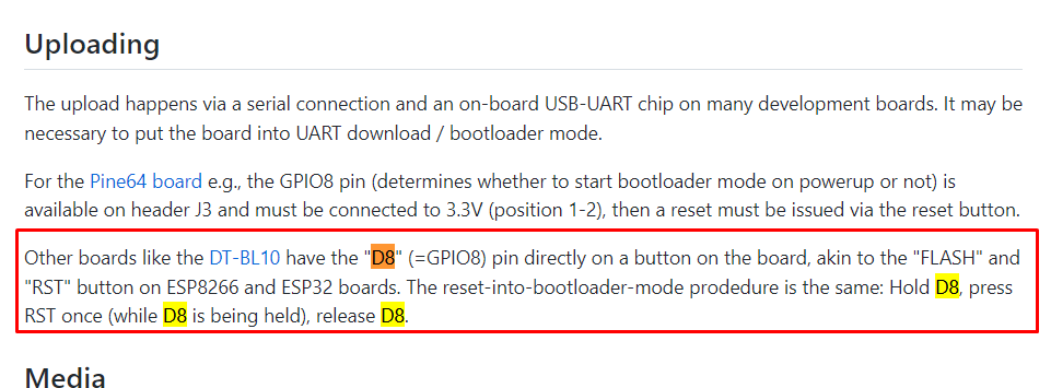

  • BL602 boot pin needs 3.3 V high level
    #25 21434181
    Posts: 14743
    Rate: 12839
    As far as I can see, on these BL602s the boot needs to be at a high level to enable the bootloader from the UART. That is, up to 3.3V.
    I remember connecting it with a 10k resistor to the power supply. [EDIT] Now I don't know if this resistor can be omitted, better not.
    Schematic of soldering 3.3V and GND on a board with BL602 WiFi module. .
    First try reading the flash.
  • IO8 3v3 reset sequence enters BL602 flashing mode
    #26 21434649
    chemik_16
    Posts: 1000
    Help: 75
    Rate: 128
    nope, doesn't go anywhere. when i pull up 8 to 3v3 it just goes off led, it was pulled up by 8kom to ground.
    In the connection it continues the same, even the chip id can't be read.
    edit. now it seems to have died at all, only the bottom button lights up red, buttons don't work, no wifi flashes
    edit, oh it works.
    You have to connect the 3v3 to the io8, reset and disconnect. All in all, I don't know how to get out of this mode afterwards, because unplugging it doesn't reset it ;D

    I've encountered this flash reading, and I remember that I think I typed 1 megabyte there without a single byte (or 2 megabytes there, because I had 2MB).
    In the linked topic I think @divadiow fired it up somehow, I think even just selecting a different TOML partition map? I don't know, I haven't followed it that much. You can log on to elektroda com and ask there in English. This initiative with changing the firmware of various products on Elektroda is already so big that I'm not personally involved in every operation, users work too.
    chemik_16 wrote:
    what a wild monster this 602 is, after every operation you have to do a reset.
    Reset or power off/on? On the ESP8266 when I short-circuit GPIO0 to ground to enter UART bootloader mode I also have to cut and reconnect power after one operation with esptool, from what I remember.
  • BL602 stays in boot mode after flashing
    #28 21434970
    chemik_16
    Posts: 1000
    Help: 75
    Rate: 128
    Here I once shorted 3v3 to IO8, on/off.
    Since then I can perform 1 operation e.g.: checkID, read.
    on/off
    another operation.
    The bl602 is all the time in boot mode, the switch software doesn't start, I don't know how to get out of it, short to ground ? ;D
    but I downloaded it, the binary looks reasonable. All in all these Chinese programs are always full of errors, maybe they count from 0x01 :D or end +1

    Many BL602 pieces it was I didn't have, but I'm sure that after unplugging the boot pin and doing a power off/on cycle already everything was back to normal. Type yourself a BL602 on our channel:
    Or maybe you have uploaded something wrong and that is causing the bootloop?

How do I enter bootloader and back up a BL602-based wall switch?
Momentarily pull IO8 to 3 V3 through a 10 kΩ resistor, reset power, then read the 0x0–0xFFFFF range with BouffaloLab DevCube at 2 Mbaud. Always release IO8 before normal boot [Elektroda, #21434649; #21434181].
What’s the risk if I tie IO8 directly to 3 V3?
Long contact can lock the BL602 in boot mode or corrupt flash; one user’s board stopped responding after such a test [Elektroda, chemik_16, post #21440375]

Do I need a resistor when pulling IO8 high on BL602?
A 10 kΩ resistor is recommended to limit current and avoid latch-up, as demonstrated in the YouTube guide shared by p.kaczmarek2 [Elektroda, 21434181]
