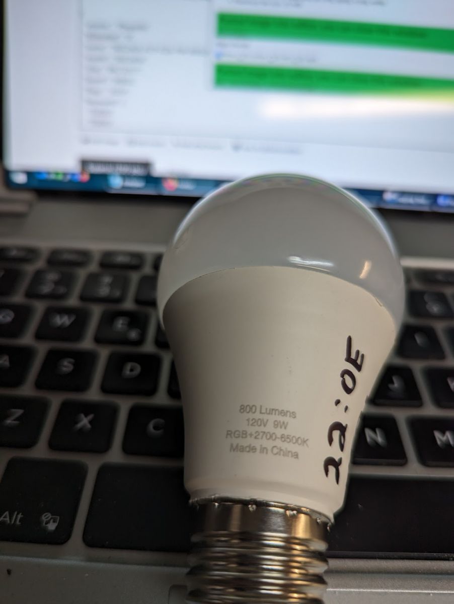

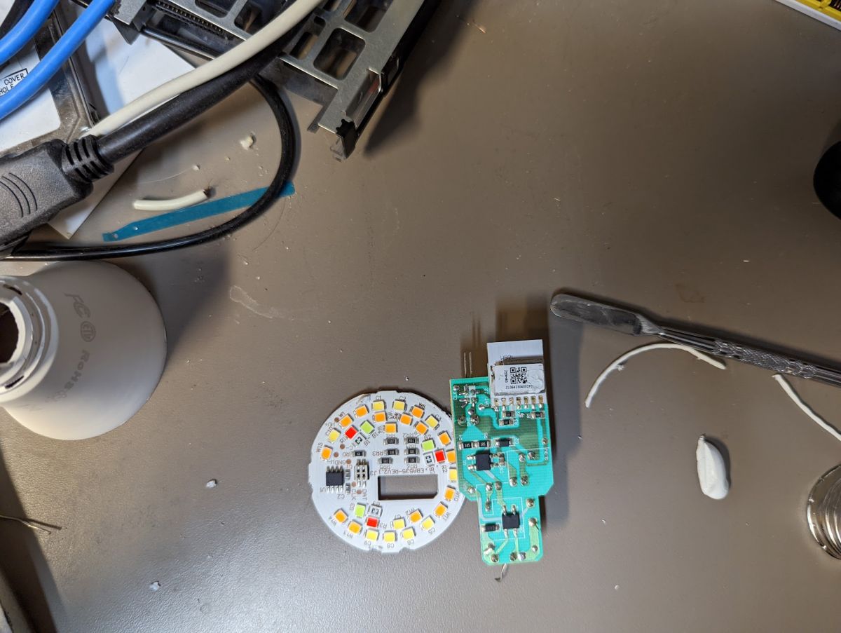

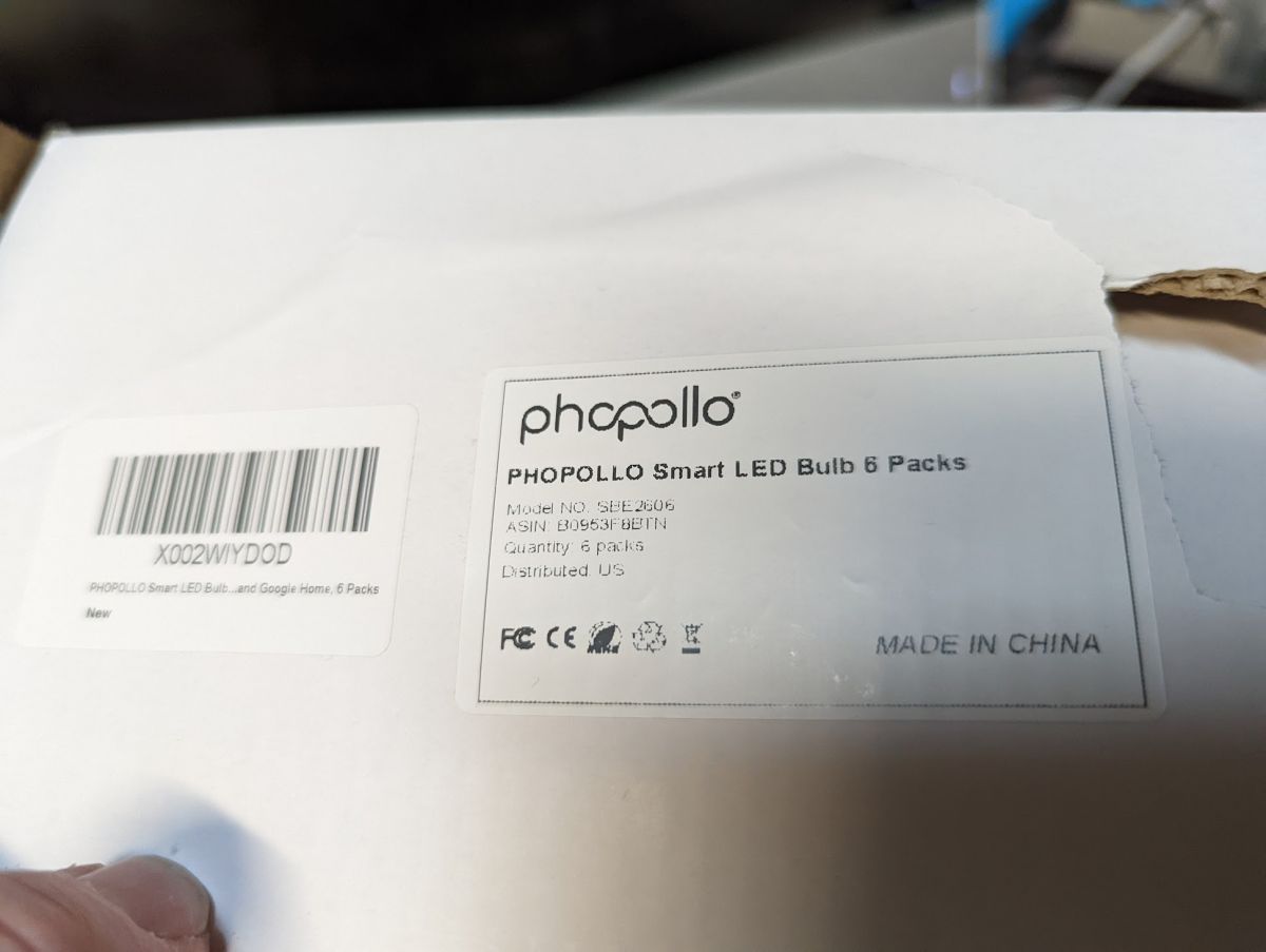

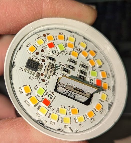

    Here's a template for Phopollo SEE2606 A19-E26-9W-800LM-RGBW Light Bulb.
    This device is supported by cloudcutter, so it can be flashed without opening.
    https://www.amazon.com/dp/B0953F8BTN

    Thank you, just remember to change your BP5758D_Current command - it now takes two arguments, so you can set separate current for RGB and for CW.
