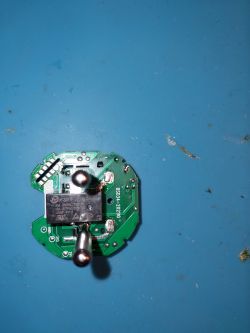

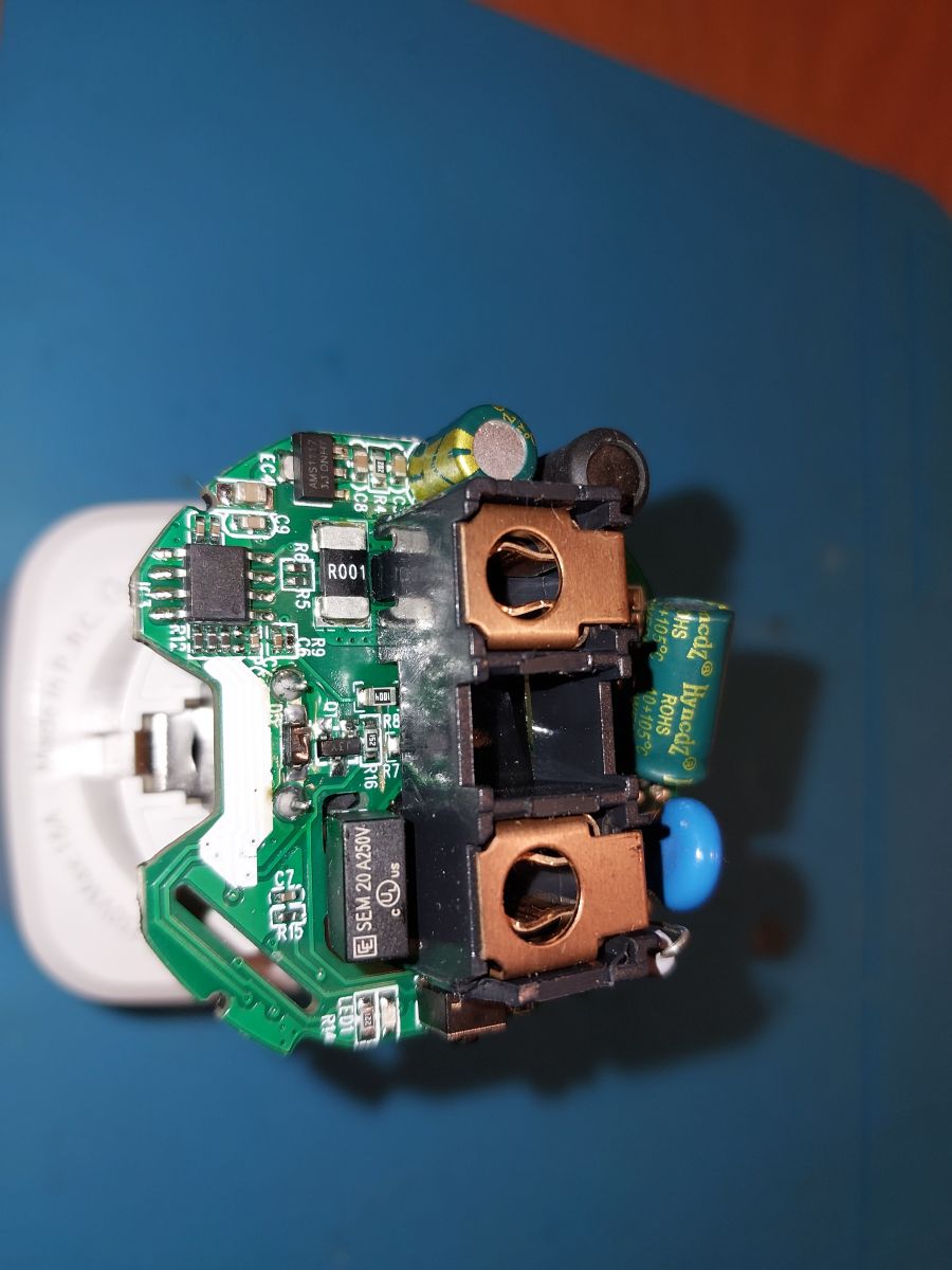

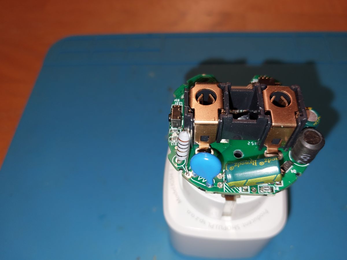

    I have a problem with uploading the batch to CB2S with BK7231N
    Socket with energy measurement: IGSH-1
    [BK7231N/CB2S] electrical socket with energy measurement IGSH-1 [BK7231N/CB2S] electrical socket with energy measurement IGSH-1 [BK7231N/CB2S] electrical socket with energy measurement IGSH-1 [BK7231N/CB2S] electrical socket with energy measurement IGSH-1

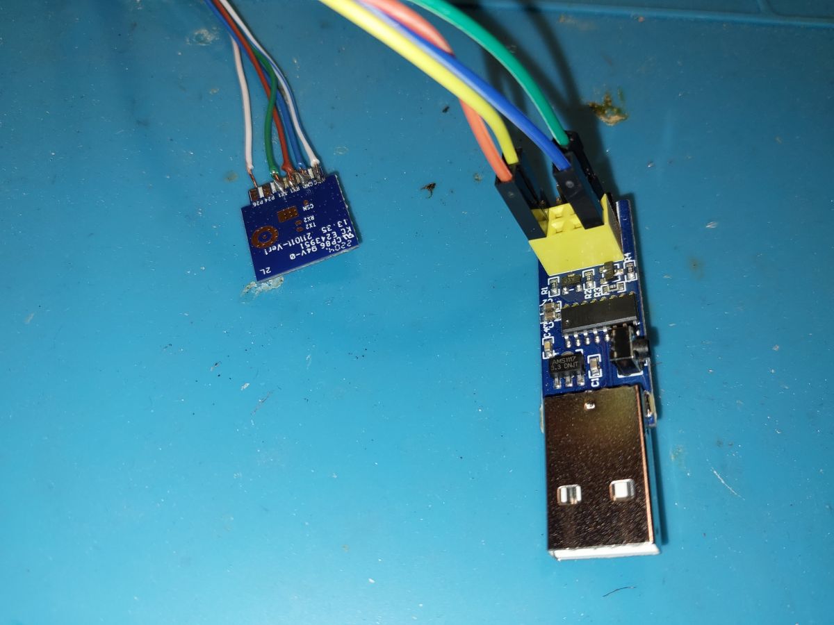

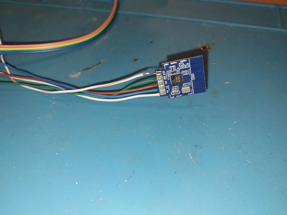

    I soldered the module and connected it to the programmer.
    I've done the program bk_writer1.60 .

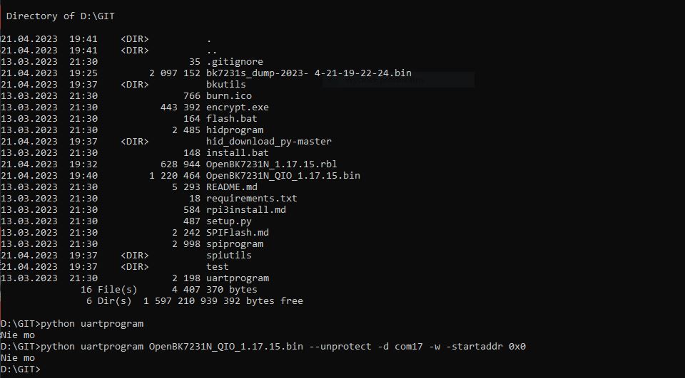

    I downloaded a new batch and attempts to upload end up like this:
    Any ideas?
  • #2 20550268
    Posts: 14622
    Help: 655
    Rate: 12638
    @Nargo try starting by using a newer flasher:
    Also post a 2MB backup here.
    From the screenshot it looks like something is wrong with the command, do you have python at all? But first try a windowing program anyway

    Attached is the downloaded batch by bk_writer1.60
    EDIT:
    I installed python
    I downloaded Backup BK7231GUIFlashTool again
    And I installed the latest batch.
    In the morning it will solder into one whole. The whitehead will tear my head off when I smell flux before bedtime :D
    Thanks for the help. I'll report back tomorrow.

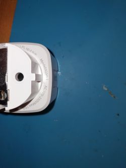

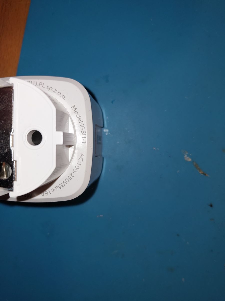

    What is the Polish web address written on it? Please provide more information as you have it, as I want to put a template for this socket on our website:
  • #5 20550322
    Nargo
    Posts: 495
    Help: 45
    Rate: 206
    Socket described SMART HARDWARE (leaflet has been consumed by children)
    "Manufacturer: SHOPUJ.co.uk.
    This worked with the Smatr Live app.
    I wanted to add this to HA and start playing, but it gave resistance and so I want to free myself from foreign servers.

    Soldered, it works.

    BK7231 Flasher was used.
    Configuration as in the thread.
    EDIT:
    My son came back from a concert and it turned out that Python was installed incorrectly by me.
  • #9 20550786
    Posts: 14622
    Help: 655
    Rate: 12638
    It is worth remembering that in new versions the calibration is also on the gui - on Web App -> Tools. No need to enter commands manually anymore.
