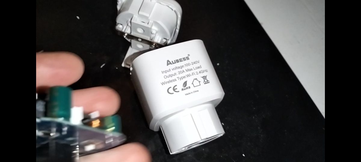

    Of course I'm going to share the information, especially as I want to put together a YouTube video of it and show what a brilliant project there is.
    The socket is called AUBESS 20A 230V and was bought still on Shopee for a pittance, maybe PLN15.
    AUBESS 20A 230V WIFI socket based on BK7231N - How to configure? .
    Image photo from Aliexpress.

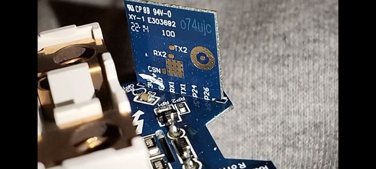

    A person holds a white smart plug with a socket, featuring a side power button. Image of an AUBESS 20A 230V smart plug with visible specification label. Hand holding a white AUBESS electric socket. .

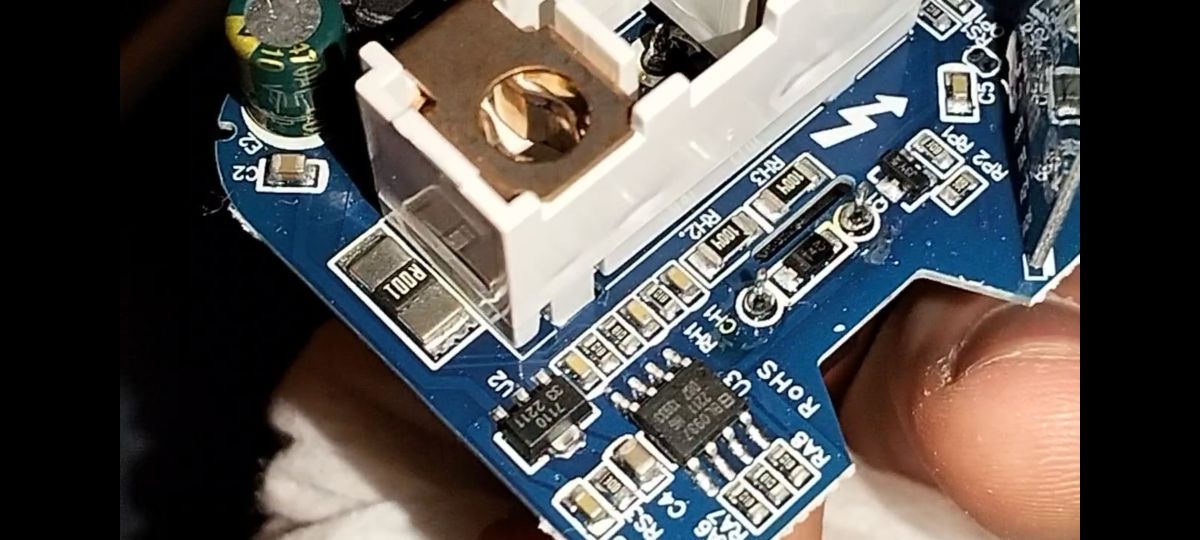

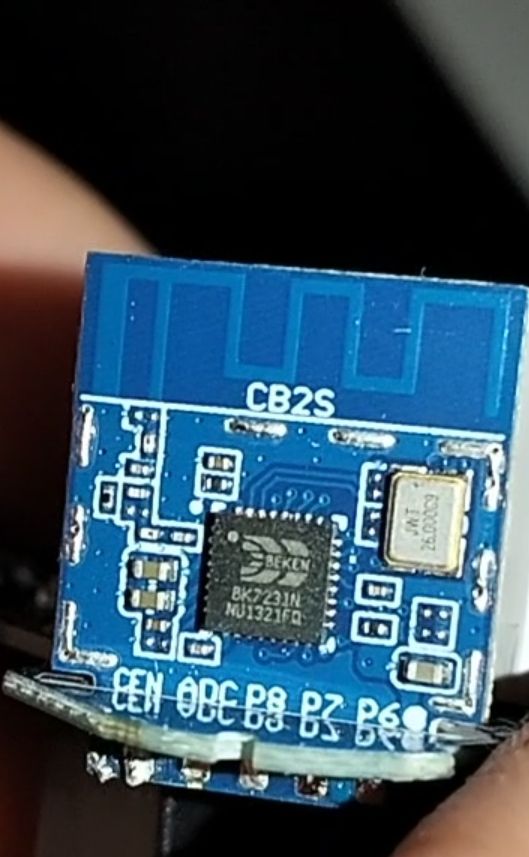

    SoC: BK7321N
    The circuit for measuring power consumption is BL0937
    Close-up of the AUBESS 20A 230V circuit board with visible components and integrated circuits. .
    The board is CB2S .
    Blue LED.
    Pinout
    CB2S board with BK7321N chip and electronic components. Close-up of a PCB with connector pin labels and indicators.
    The configuration in the first post is correct.
    You do not need to desolder the board! .
    The procedure to start flashing looked standard. Connect the UART adapter to the computer, install the drivers, enable the program BK7231N Easy UART , set the baudrate: 115200 , chip type: BK7231N , firmware: OpenBK7231N_QIO_1.17.592.bin , then click For firmware write on the board we short-circuit the pin for a moment. CEN with GND and all the magic begins. I won't describe the rest as it's in the above post. I hope someone finds such information useful.
