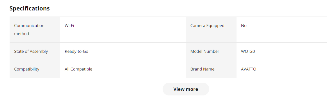

    Image of an AVATTO WiFi Tuya wall socket with a power monitor.
    Product specifications table from AliExpress.
    https://www.aliexpress.us/item/32568045880987...US%213489641176%21&curPageLogUid=fc42pj50kRIv

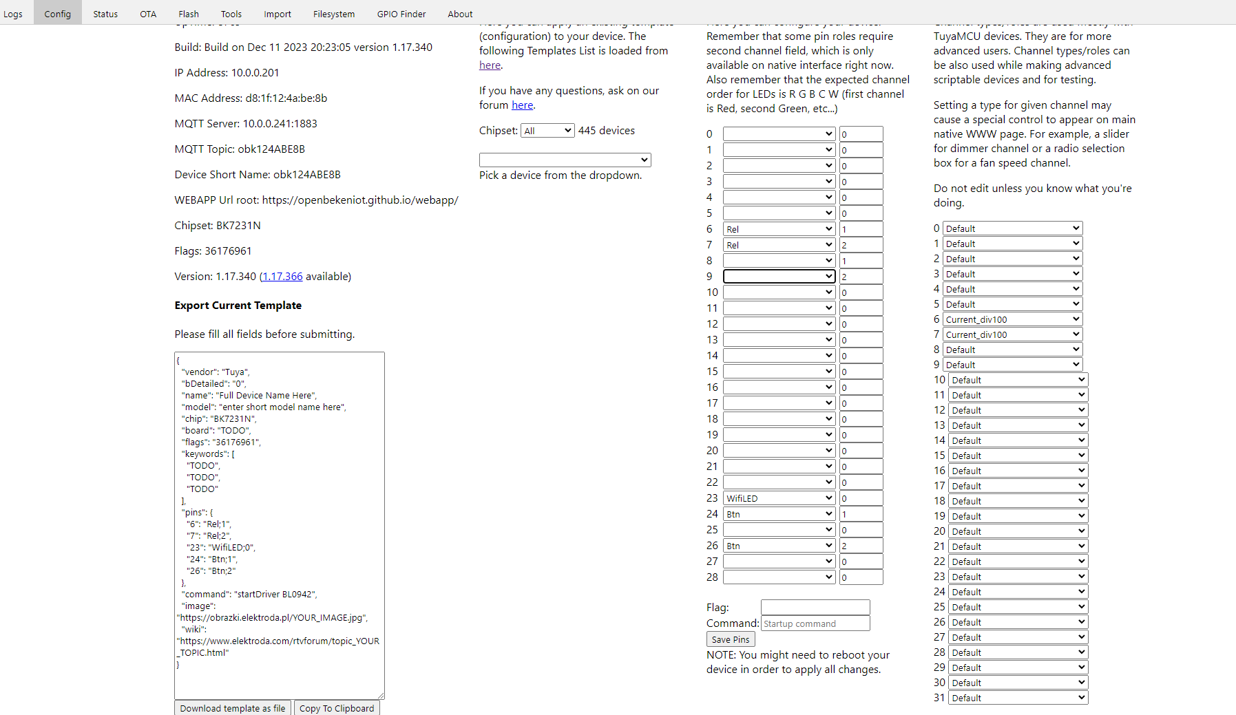

    Got these in today and found out they have the C2BS chips. First time messing with openbeken, have to say it was pretty simple.
    With these, after taking it apart and clamping on the mini alligator clips, I was able to flash with ease. Once you open BK7231 Easy UART Flasher, select the N chip. I left the default flash file it loads when you start the program, wanted to make sure OTA update worked after.
    When it says Getting bus... (now, please do reboot by CEN or by power off/on) all I did was hold both power buttons (black buttons) at the same time for close to 10 seconds. The flash program detected it and flashed away.
    Below is the extracted data
    - Button (channel 1) on P24
    - WiFi LED on P23
    - Relay (channel 2) on P7
    - Button (channel 2) on P26
    - Relay (channel 1) on P6
    Device seems to be using CB2S module, which is using BK7231N.
    and json data
    After rebooting the device, I was able to access the UI page and configure MQTT, showed up quickly in HA. This device does have 2 LEDs for each switch and also has energy monitoring when I had it added in smart life.
    I have found no devices like it to apply a configuration profile and I am unsure how to set all that up. Would it be possible to get help from the community to get this configured correctly?
    Much appreciated!!!!

    This plug has 2 LEDs under the power buttons for outlet 1 and outlet 2. I used the GPIO finder but cannot seem to locate which GPIOs are the LEDs to change colors.
    Screenshot of a smart device configuration interface. Visible GPIO list and MQTT settings.
    The other question is getting all of these config pieces into MQTT. Currently, all I have showing in MQTT is RSSI.

    Why do you have current_div channels?
    Do you know that you need to retry HASS discovery after changing config?
    Your relays should be properly discovered by HA

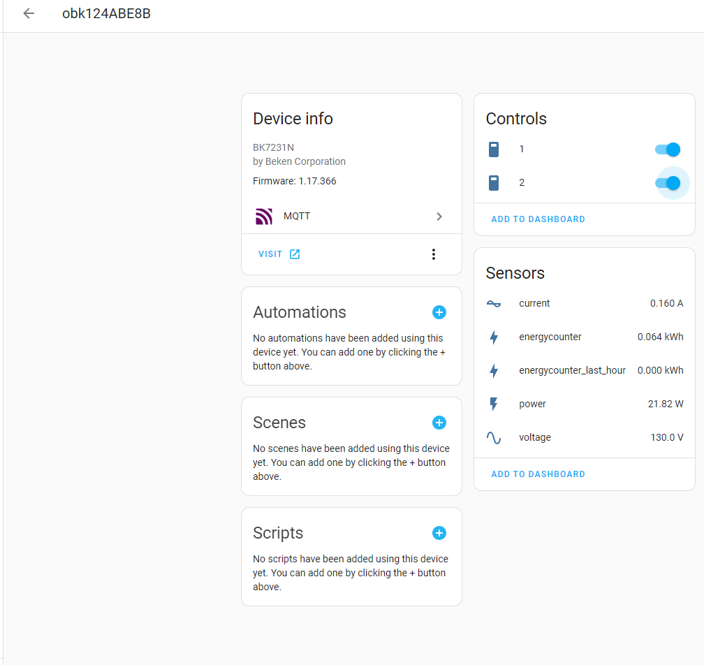

    I cleared out the current_div and also found out how to start the HA discovery, this is what I have now. Since it sees 2 switches, is it possible to see different amps for each outlet? I stumbled across this post https://www.elektroda.com/rtvforum/topic3887748.html and thought adding the sensor mqtt in config.yaml would show it, but it doesn't. Also any idea on the LEDs for the buttons? I'd like to change them to red when they are off.
    In the 99% of devices it is not possible. Do you have a single BL0942 inside, or two BL0942? Does the current driver for BL0942 shows power for both outlets together? If so, then it's not possible by design.
    In such cases it's often worth to check what Tuya app could do so we can reasonably know what to expect after firmware change.
    Again, considering that there is no mention about extra LEDs in JSON, and that you've found none of them with GPIO Doctor, I would say it's not possible and the LEDs are hardwired to buttons. Of course, if you were to open the device case, then you could easily reroute LEDs to the unused GPIOs and script them any way you want to. That would require a bit of soldering (and making jumpers from wires), but would work
