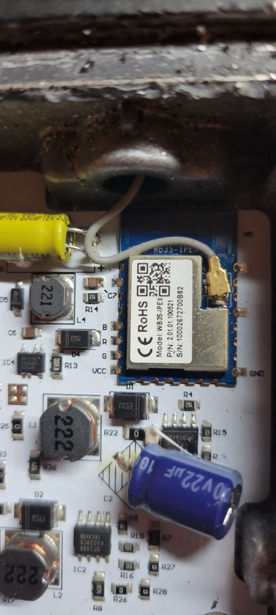

    Purchased a set of Novostella Blaze Floodlights a couple of years ago from Amazon. One of my floods, the blue color, stopped working, which Novostella warrantied replaced, so I decided to see what was under the glass.
    Product Photo:
    Novostella Blaze 25W RGB Flood Light Teardown
    Tear down:
    Chip Info:
    Uses a WB3S-IPEX which uses the BK7231T RF Chip.
    Flashing
    Was able to OTA Flash using Tuya Cloud Cutter and OpenBK7231T_UG_X.XX.XX.bin firmware.
    Setup OpenBeken
    Everything on the board was labeled nicely, so not too much trial and error to figure out the right settings.

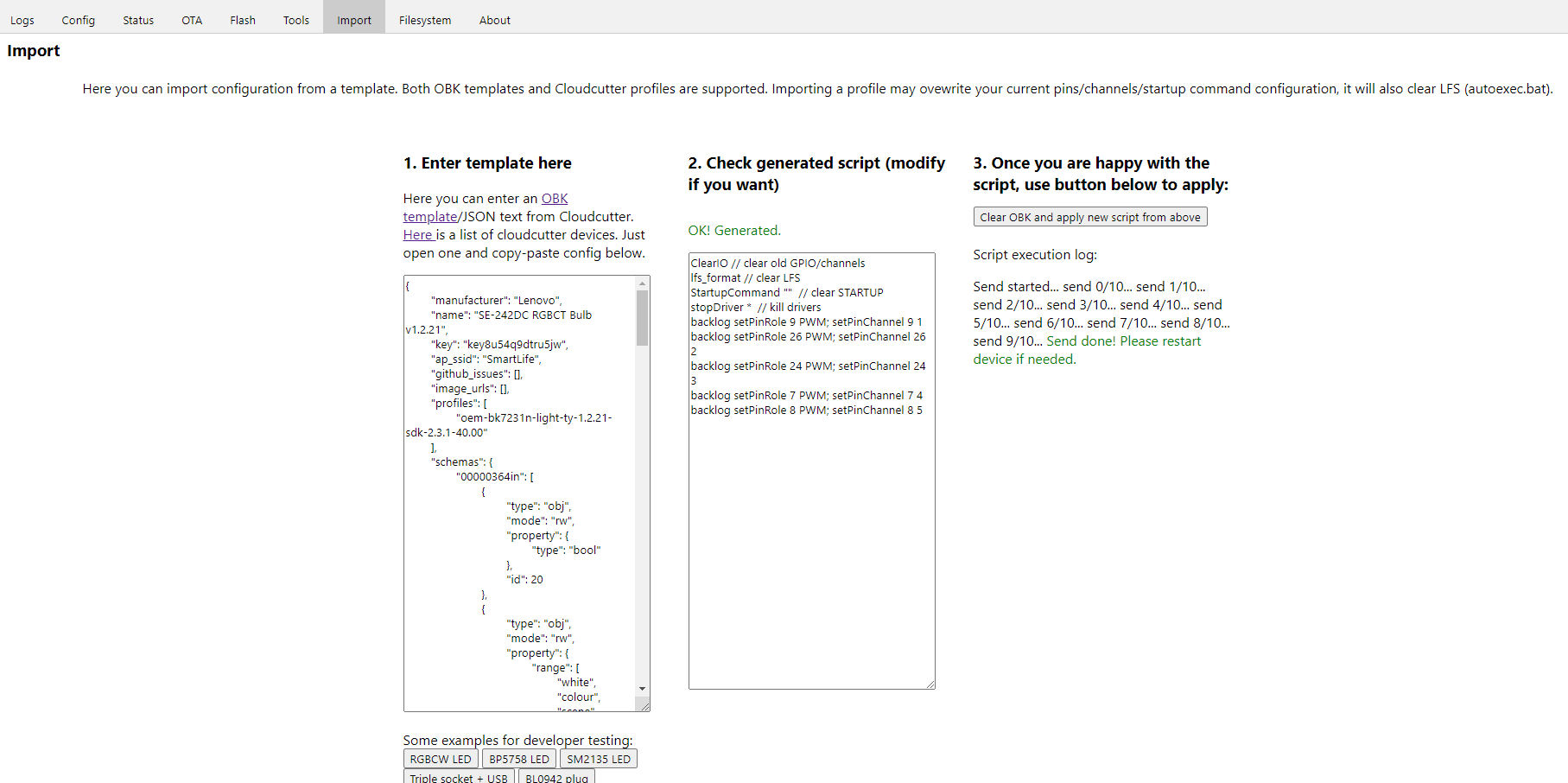

    Hello, thank you, which cloudcutter profile did you use?
    Don't forget that with new versions you can just import cloudcutter profile to get GPIO settings automatically:

    It's also nice to see that Tuya used here a WB3S-IPEX module, which features an external antenna connection
