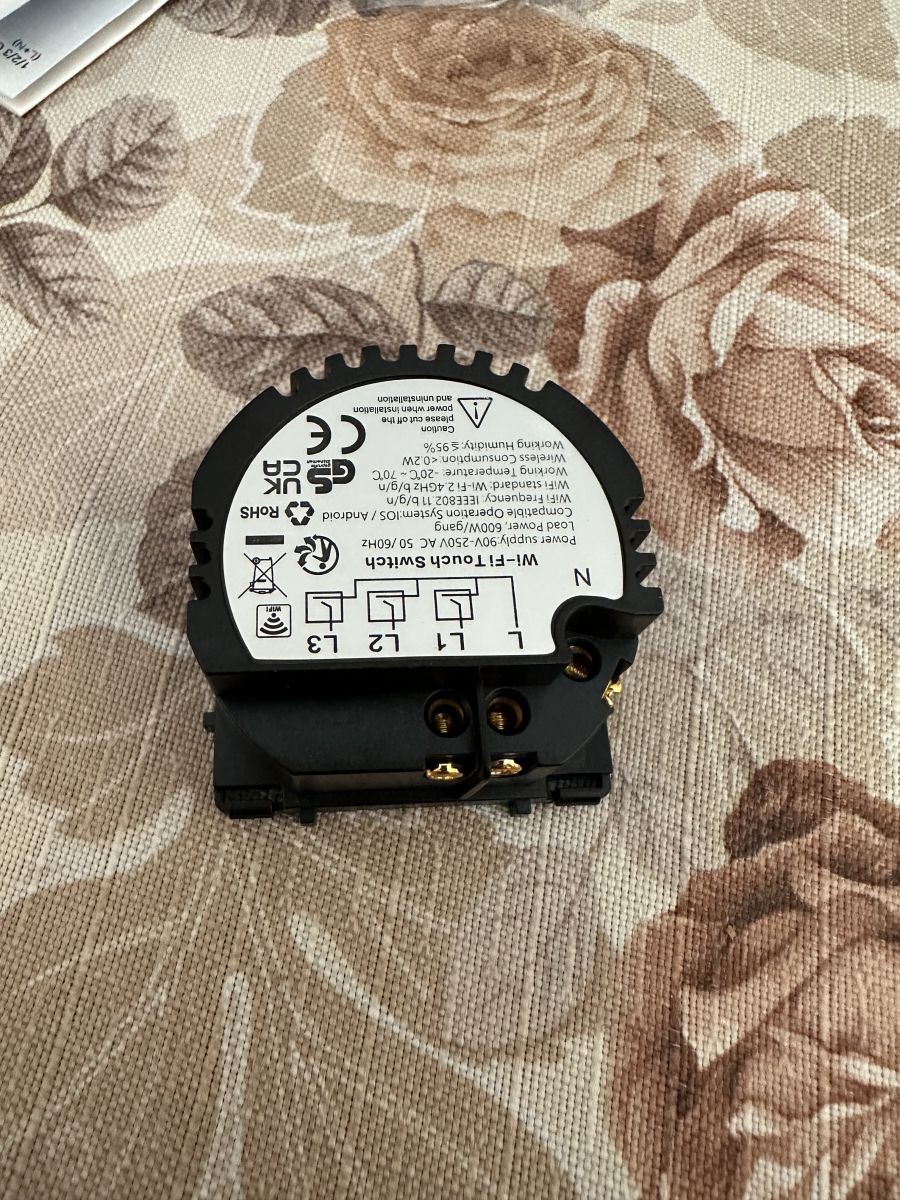

    I recently started doing the lighting in my home and came across different versions of WiFi switches.
    I bought the following: https://www.aliexpress.com/item/1005005221570334.html which turned out to be Bingoelec T34 modules, and came with bingoelec tape on the package.
    The actual wifi DIY module is this: https://www.aliexpress.com/item/1005004526708666.html

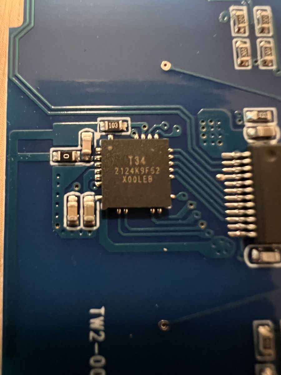

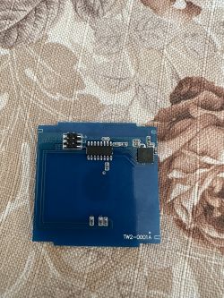

    Here are some pictures of the module:
    [BK7231N/T34] TW2-0001A -Bingoelec DIY Series Smart WiFi Wall Touch Switch Base [BK7231N/T34] TW2-0001A -Bingoelec DIY Series Smart WiFi Wall Touch Switch Base [BK7231N/T34] TW2-0001A -Bingoelec DIY Series Smart WiFi Wall Touch Switch Base [BK7231N/T34] TW2-0001A -Bingoelec DIY Series Smart WiFi Wall Touch Switch Base
    I did not want to reverse engineer the board so that I can flash it, but I tried and successfully flashed them with cloudcutter.
    Cloud Cutter option: 1.1.0 - BK7231N / oem_bk7231n_dctrl_switch
    Here is the config dump I made for the 1-Gang where Toggle 0 is the integrated relay and Toggle 1 is the backlight of the switch.

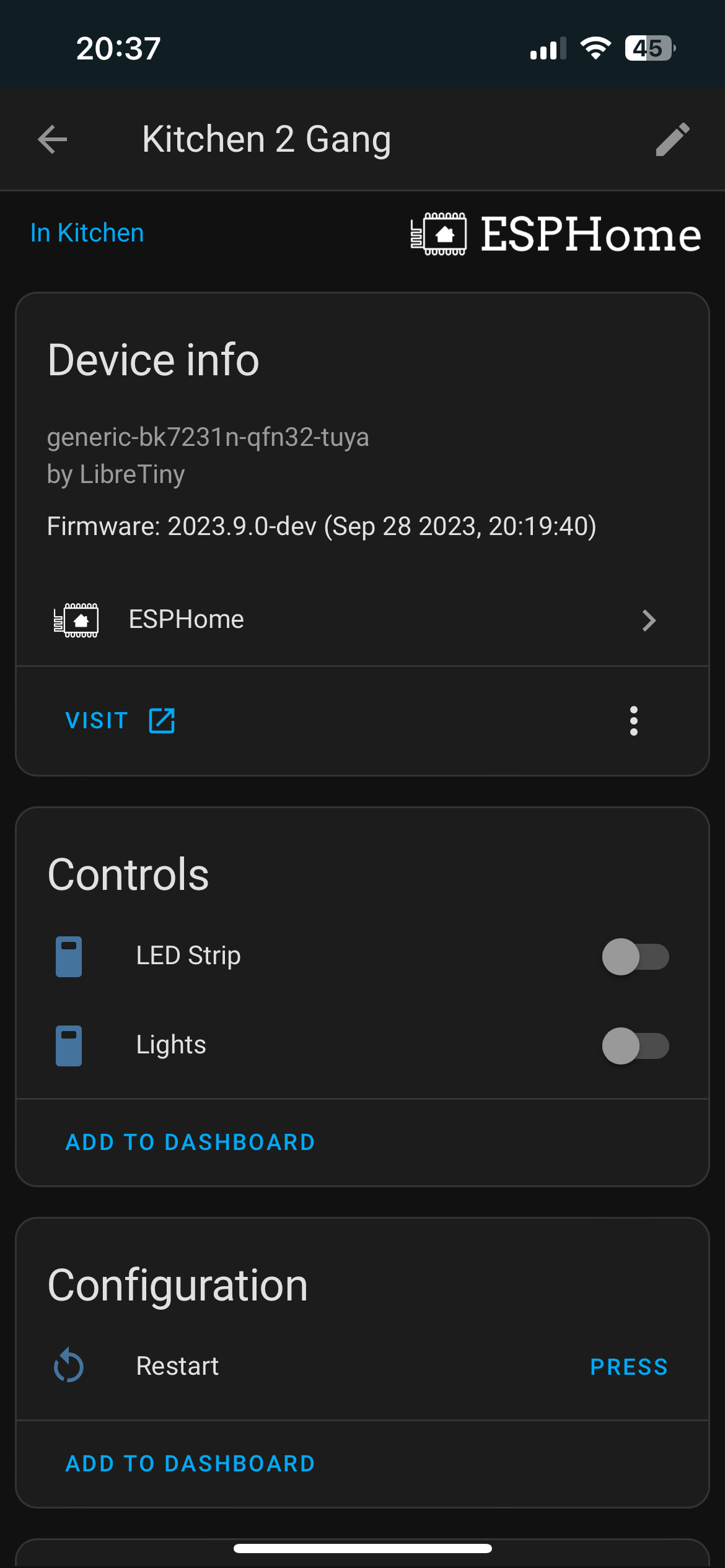

    danbratu
    Posts: 10
    Managed to flash it with libretiny ESPHome and it works like a dream, so I don't really need a new profile for CloudCutter. :)
    Screenshot of the ESPHome app showing device information in the kitchen.
  • ESPHome YAML for 2-gang BK7231N switch
    #7 20752395
    danbratu
    Posts: 10
    my esphome yaml for 2 gang switch:
    Code: YAML

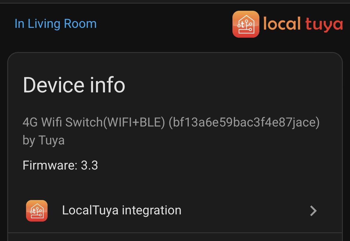

    1/2/3 gang bingoelec diy switch modules use the same chipset T34 FW version 1.1.0 (as 1 and 2 gang), so easy to flash it with esp home/libretiny, but 4 gang I believe it uses a different chip as fw is 1.0.6 and there's no mark with T34 on the board and due to touch buttons can't see anything.
    Some data from tuya cloud for 4 gang (maybe someone will manage to identify the chip based on this data):
    "product_id": "vinqmcfbtepzjbw7"
    "product_name": "四路开关(WIFI+BLE)"
    "name": "4G Wifi Switch(WIFI+BLE)"
    "category": "kg"

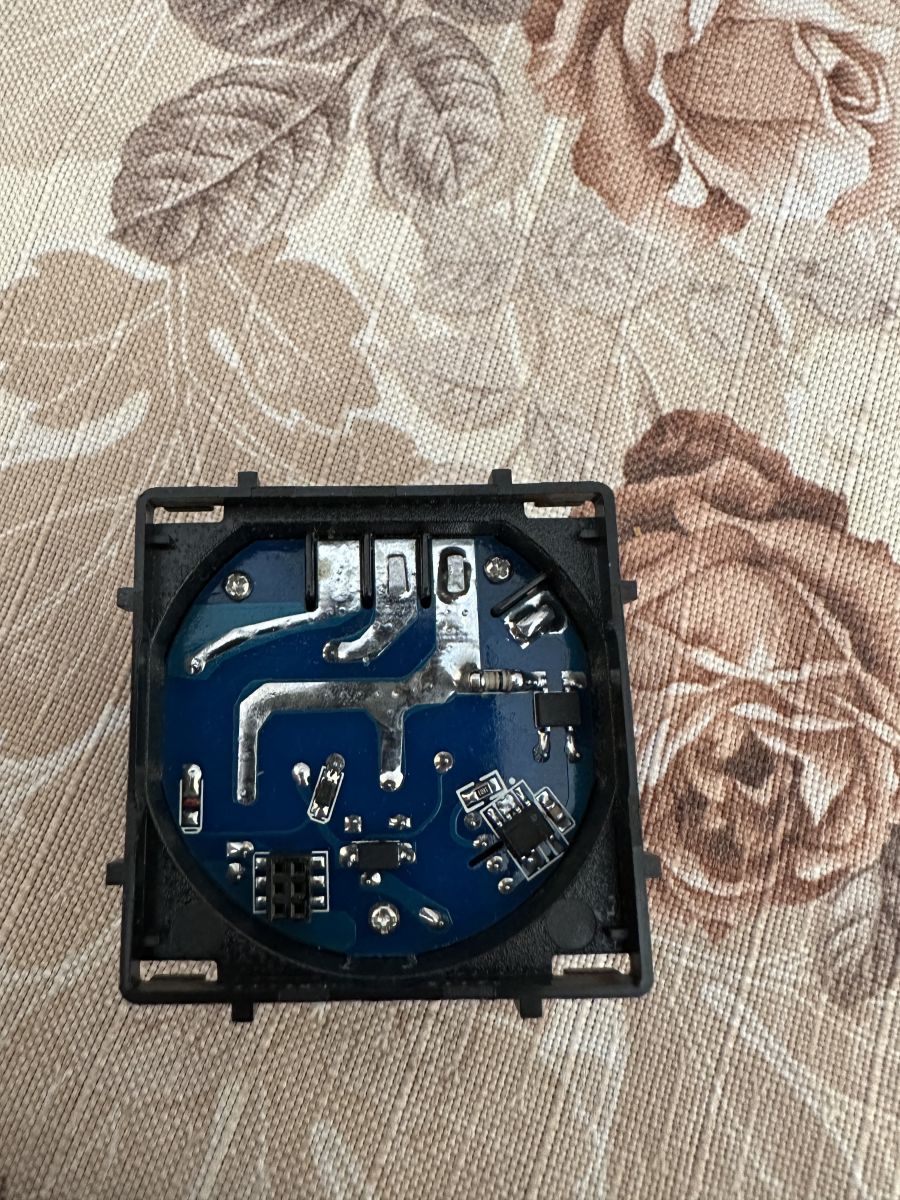

  • #9 20755135
    gyenchev
    Posts: 12

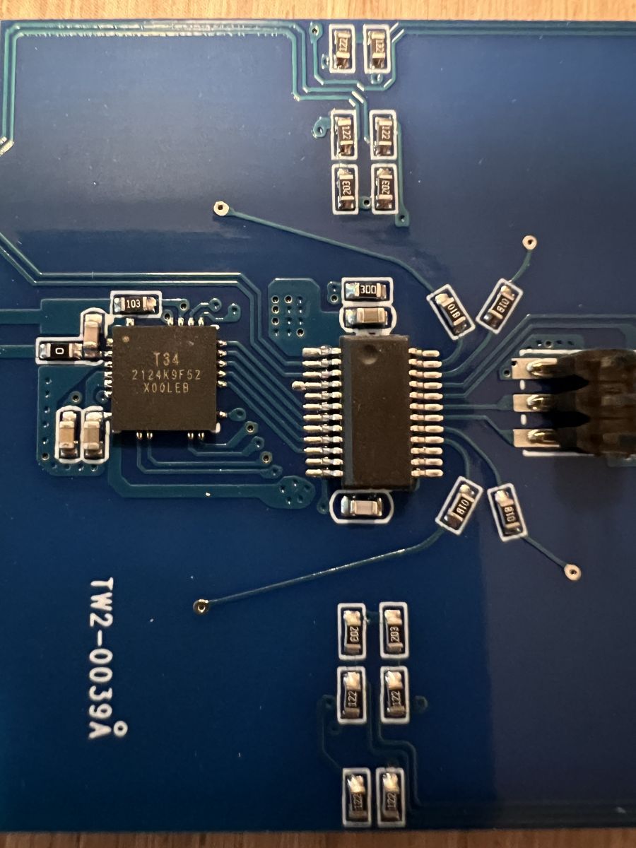

    Can you post pictures of the internals for 4 gang switch?

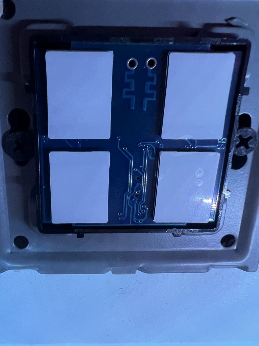

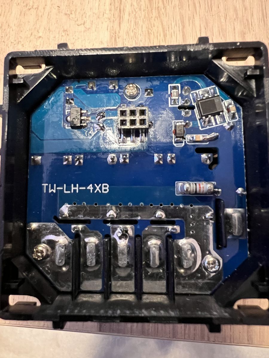

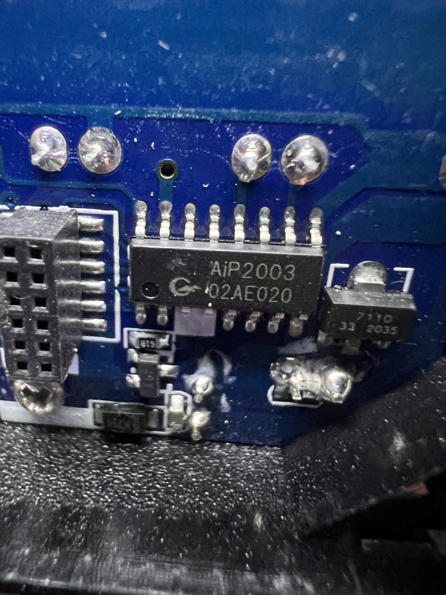

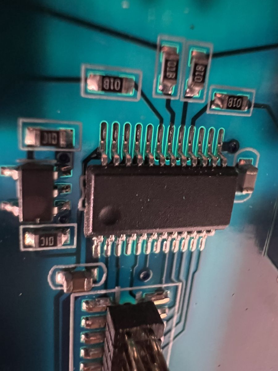

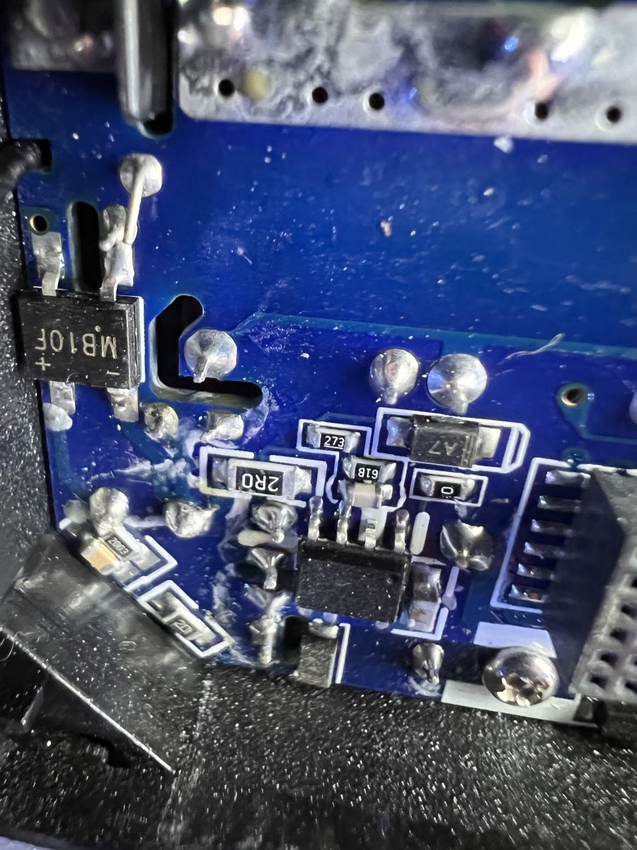

  • #11 20755179
    gyenchev
    Posts: 12
    The board can be removed from the power supply part. The microcontroller is on the other side. You can disassemble it and identify the controller. :)
  • Chip not found; suspect alternate board version
    #12 20756213
    danbratu
    Posts: 10
    Close-up of a circuit board with four large white rectangles and two round holes at the top. Close-up of an electronic board with a visible chip marked AiP2003. Close-up of the internal side of a blue printed circuit board with various electronic components. Close-up of a circuit board with an integrated circuit and resistors. Close-up of an AIP2003 integrated circuit on a blue printed circuit board with various electronic components.
    no luck finding the chip... it might be on the other side of the internal board. there are two versions though (first pic is from another switch bought from the same supplier 1 week before the second one but atm i don't have access to it to check the back of the board - it is installed at a different location)...

  • #15 20756739
    gyenchev
    Posts: 12

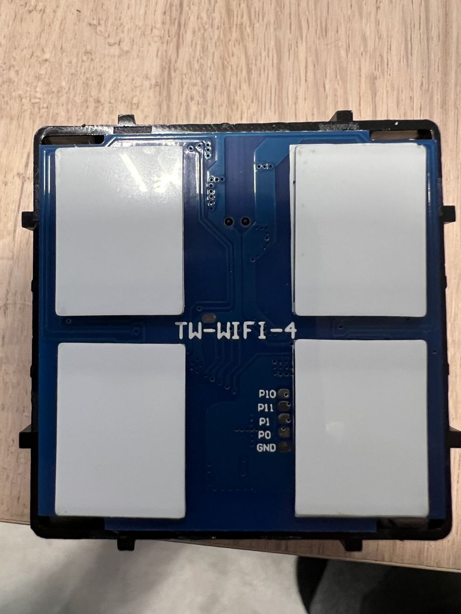

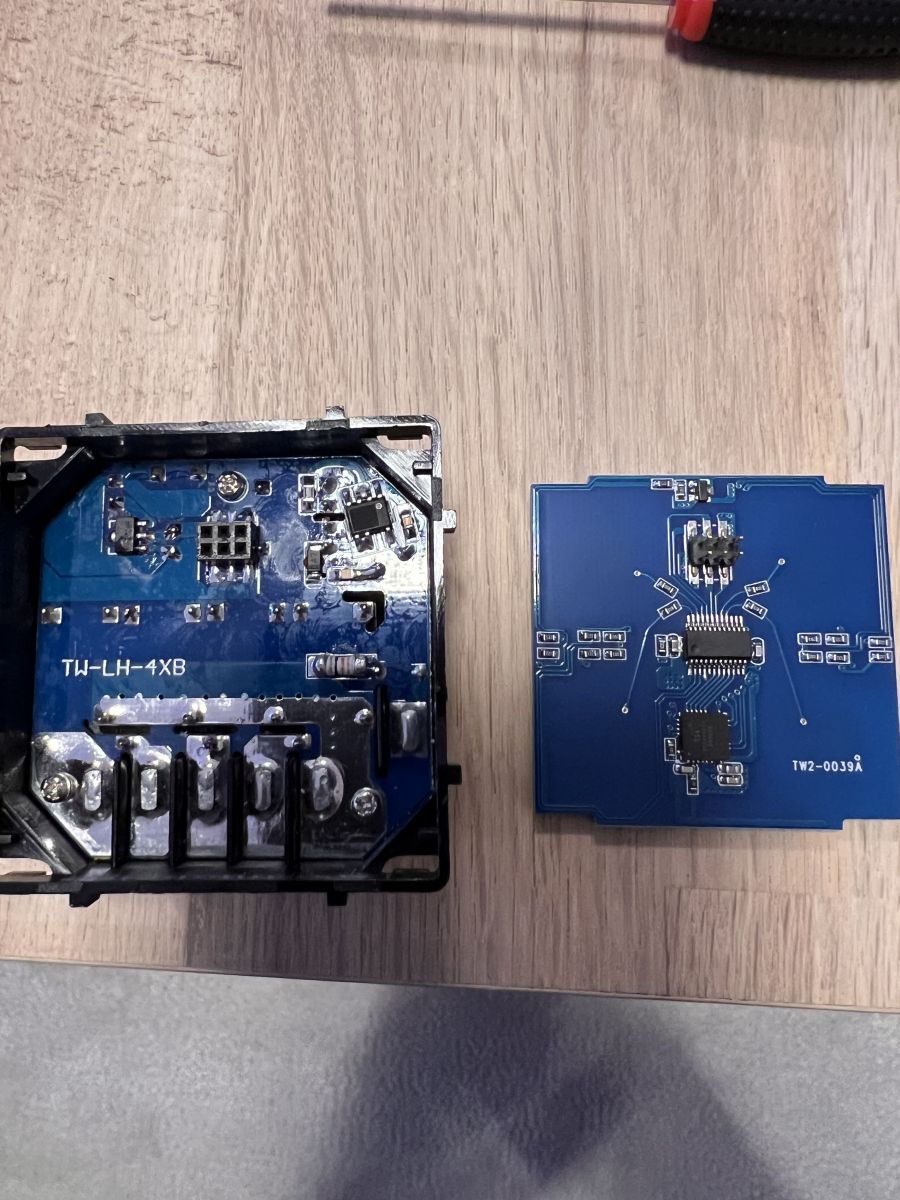

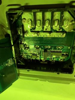

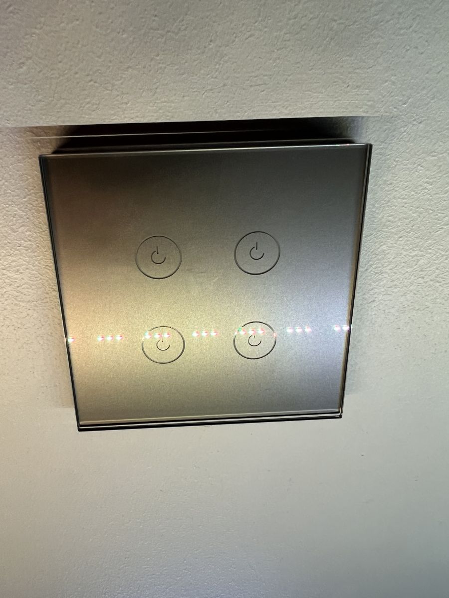

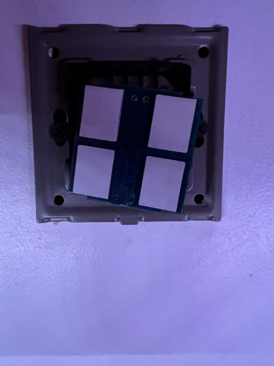

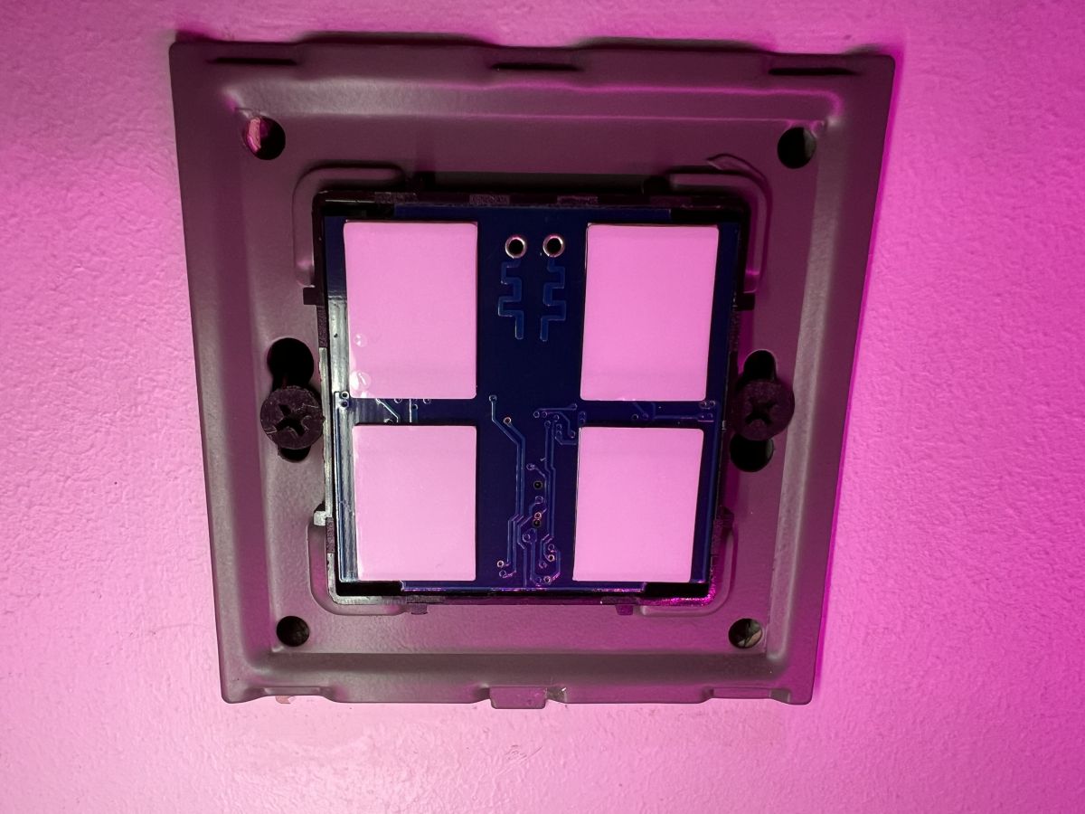

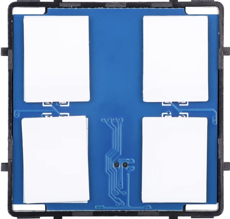

    Can you give overview pictures of the module that has the buttons on it? Front and Back. Most of the pictures you gave seem to be of the power supply side which we are currently not that interested in :D
  • Initial front panel and power supply photos
    #16 20756945
    danbratu
    Posts: 10
    One pic is from the front panel (the one with touch buttons) and one from the power supply. I'll take some better pictures later in the evening though.
    Added after 8 [hours] 8 [minutes]:
    Touch panel with four round buttons on a wall. Front panel with touch buttons mounted on a wall with purple lighting. Front panel with touch buttons on the wall. Person holding an electronic circuit board next to a wall-mounted panel. The image shows a section of a printed circuit board with electronic components and soldered connectors. Interior of an electronic device with visible circuit elements and connections.
  • Microcontroller likely on the rear power board

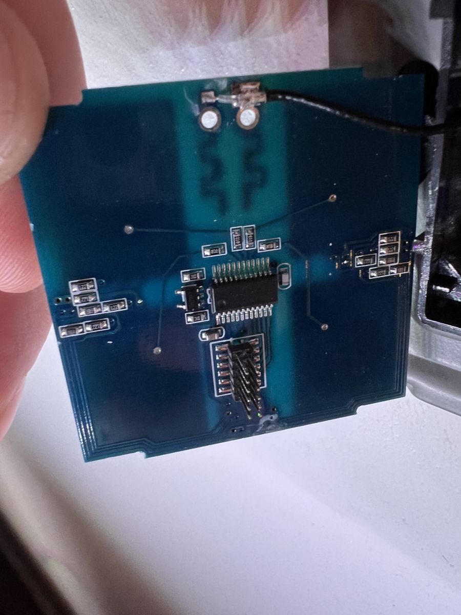

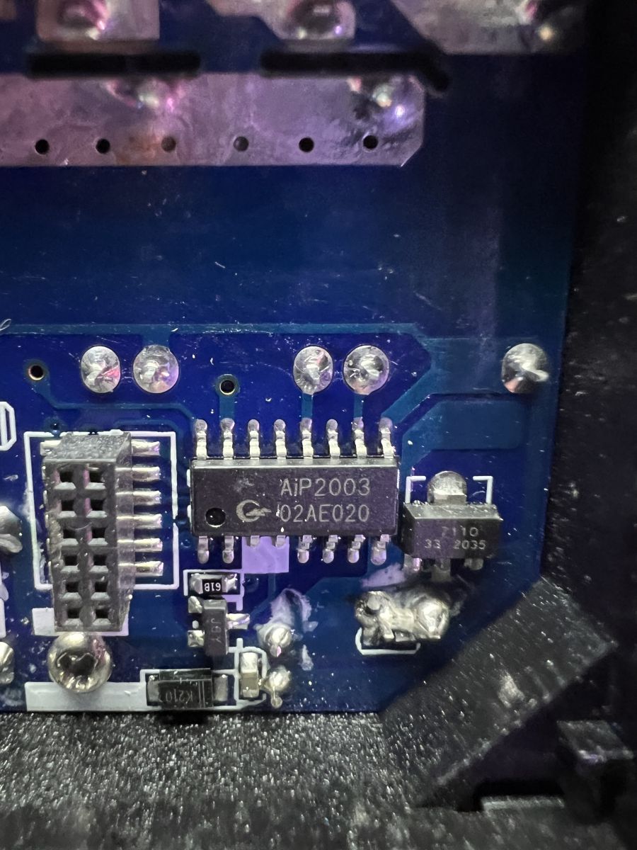

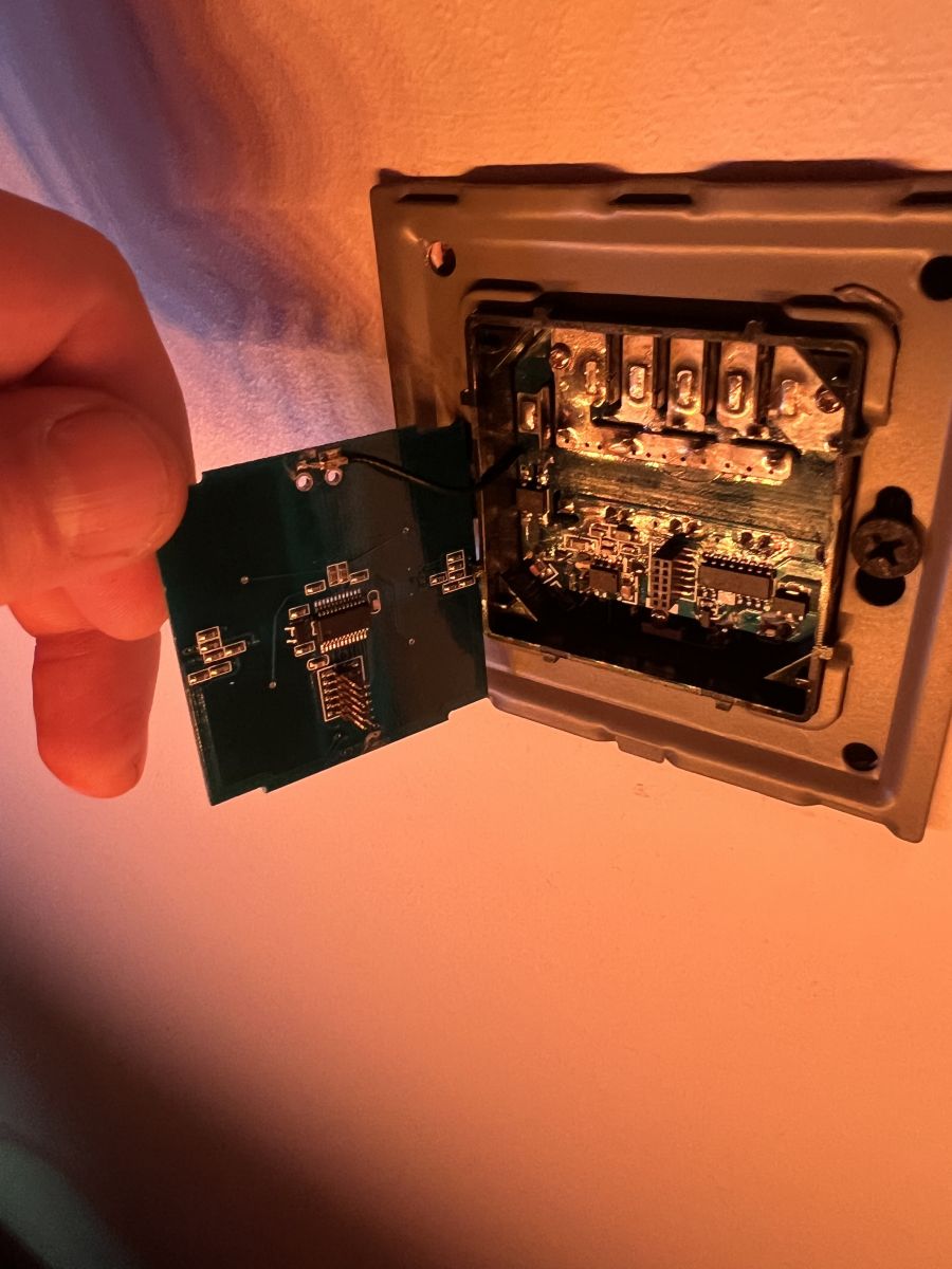

    #17 20774888
    gyenchev
    Posts: 12
    Sorry for the late reply, but I have noticed that you sent photos. Looking at where the WiFi antenna cable is going, I believe that the actual microcontroller is on the power board on the back. As far as I can see from the traces on the board with the buttons, there are just the buttons, the controller that takes the signal from them, and the WiFi antenna. So I would guess that the actual microcontroller is on the back of the internal board.
  • #18 20774998
    danbratu
    Posts: 10
    I'll try to remove the switch and reveal the microcontroller once I get back home somewhere around 1st of Nov.

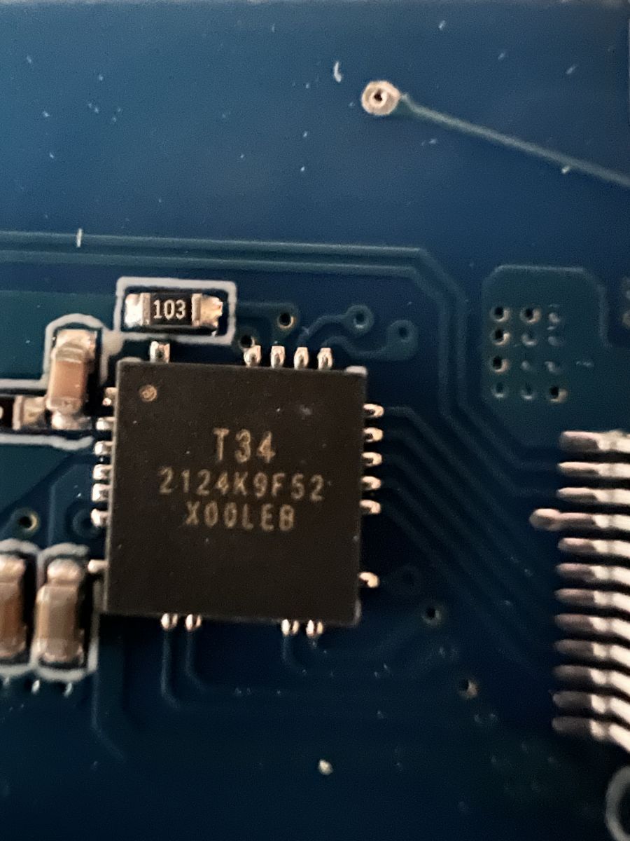

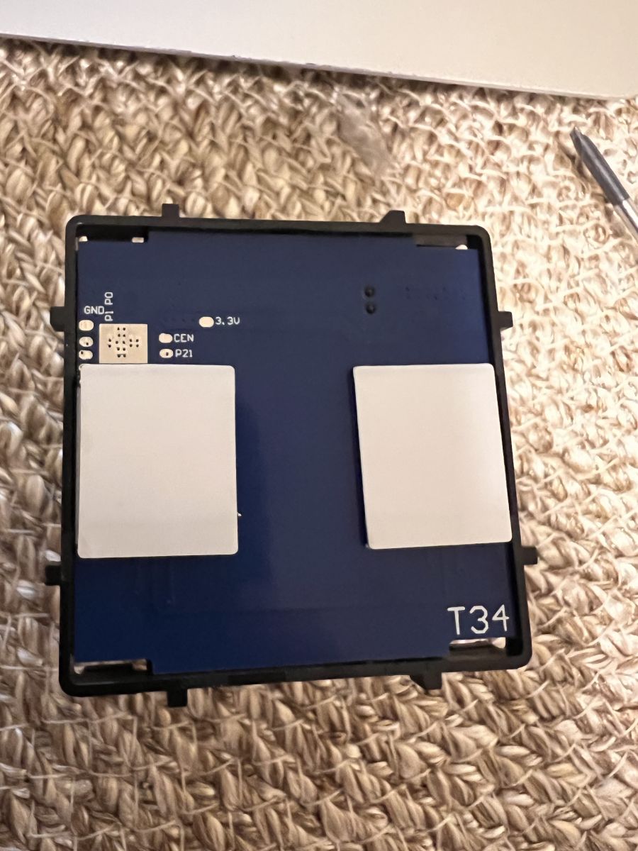

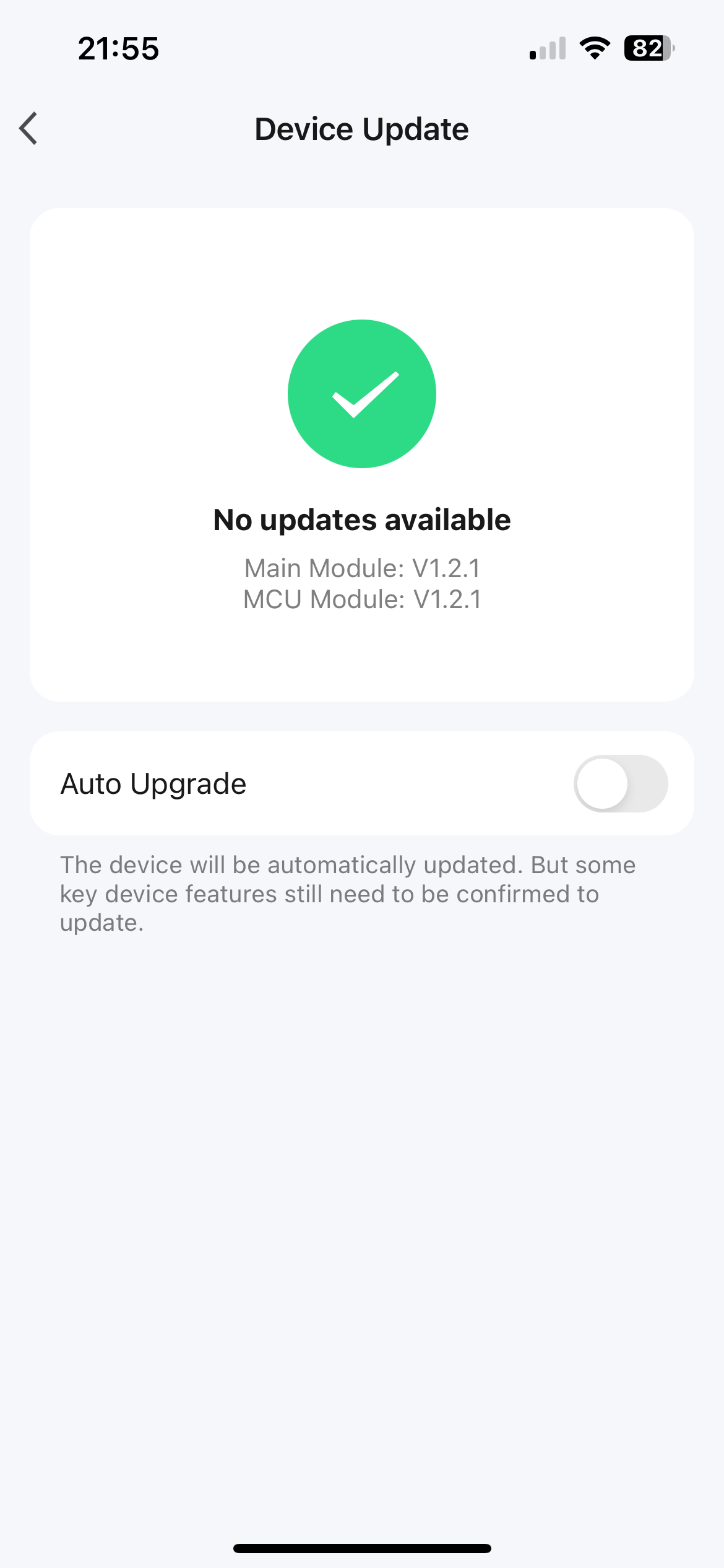

  • BK7231N T34 flashed with ESPHome YAML
    #19 20784301

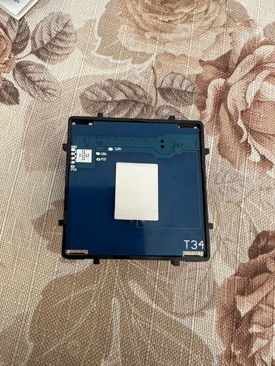

    danbratu
    Posts: 10
    Electronic board labeled TW-WIFI-4 viewed from above. Two Bseed 4Gang electronic modules on a table, showing components and circuitry. Interior of a Bseed 4Gang device with visible circuit board and electronic components. PCB with mounted electronic components, including a T34 microcontroller. Close-up of a circuit board with a T34 microcontroller visible. Close-up of T34 microcontroller on a circuit board. Device update screen showing no updates available.
    This is one of the two Bseed 4Gang I have. Microcontroller is T34 so easy to flash with ESPhome (chosen fw 1.2.1 dctrl switch in cloudcutter)
    Working like a charm :)
    The other one I'll dismantle it to identify the microcontroller when I'll be at the location where it is installed (pics posted in previous posts)
    ESPhome yaml (for 4gang with T34 microcontroller):
    Code: YAML
