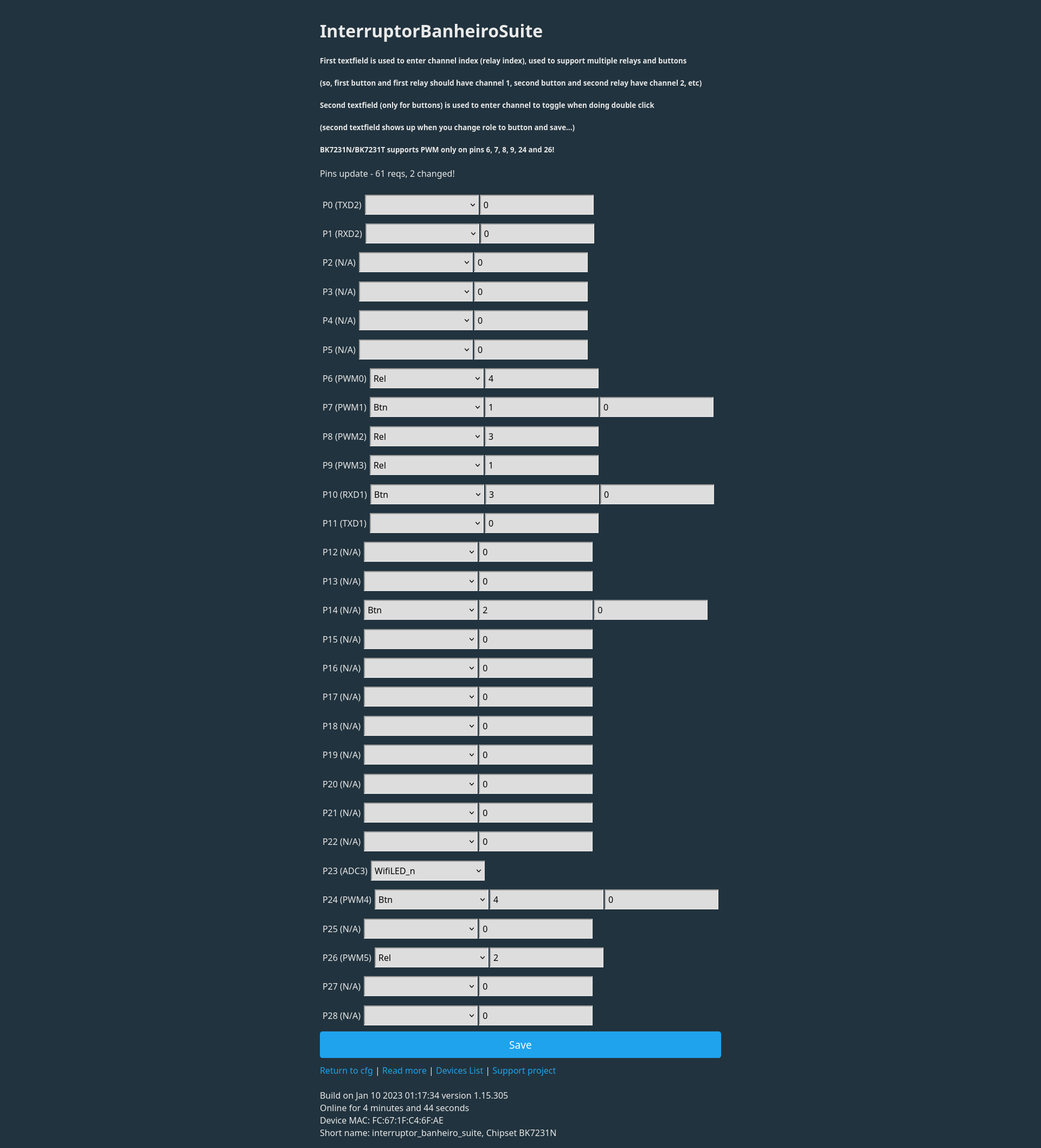

    I have configured it after flashing by using the web app and selecting Tuya Smart Wifi Switch 4 Gang from the pre-configured devices list. Some pins were wrong, but luckily the relays were mapped correctly.
    [BK7231N / CB3S] Aubess Tuya Wifi Smart Touch Switch 4 Gang W/ Neutral [BK7231N / CB3S] Aubess Tuya Wifi Smart Touch Switch 4 Gang W/ Neutral
    PinTypeChannel
    P6Rel4
    P7Btn1
    P8Rel3
    P9Rel1
    P10Btn3
    P14Btn2
    P23WifiLED_n-
    P24Btn4
    P26Rel2
    I could setup the relays, but unfortunately I couldn't map the physical buttons on OpenBK. I found out that pins P7, P14, P20 and P24 might be connected to the touch buttons; the way I tested it was by trial and error and set those pins as digital inputs. By doing so, the light of the corresponding touch button would turn red but nothing happened if I touched the button. When I change the state via the web interface, the lights change accordingly and the relays get triggered, but when touching the capacitive buttons nothing happens. I even tried setting those pins as actual buttons, but nothing worked.
    EDIT: turns out when resoldering the button controller IC I messed up and the IC wasn't properly soldered. After soldering it once again the buttons started working.
    As for the extra IC that I removed to flash OpenBK, I suspect it's a driver for the relays, as I tested with a multimeter and found out some of its pins are connected to the CB3S pins that drive the relays.
