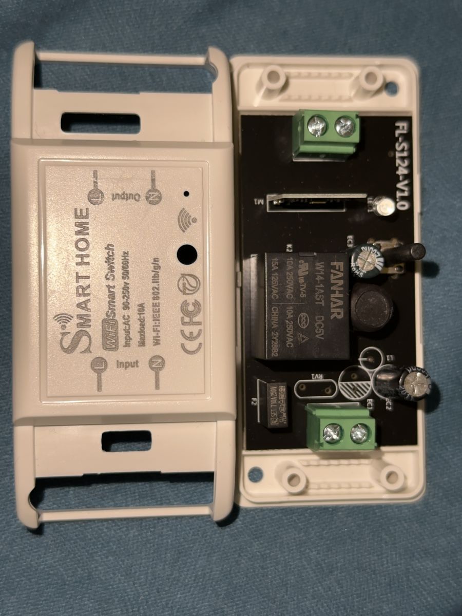

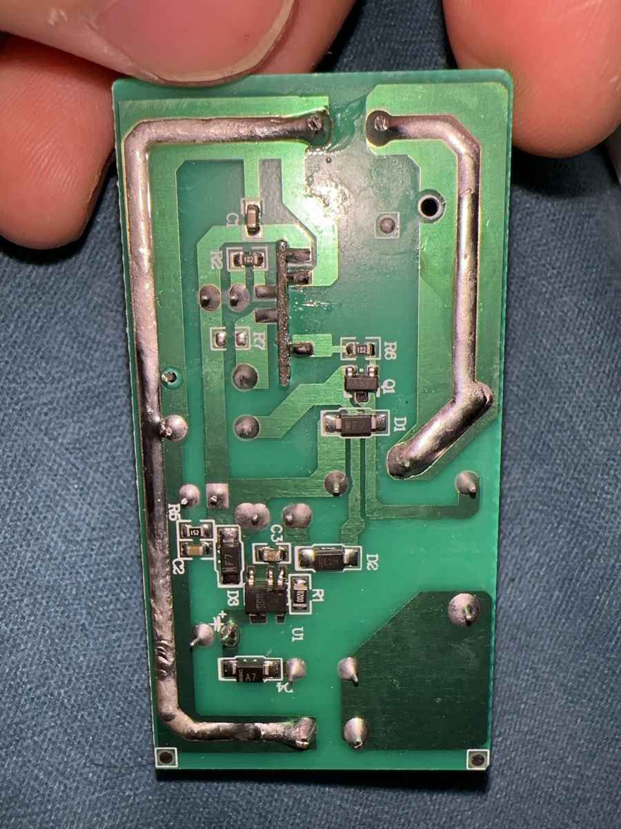

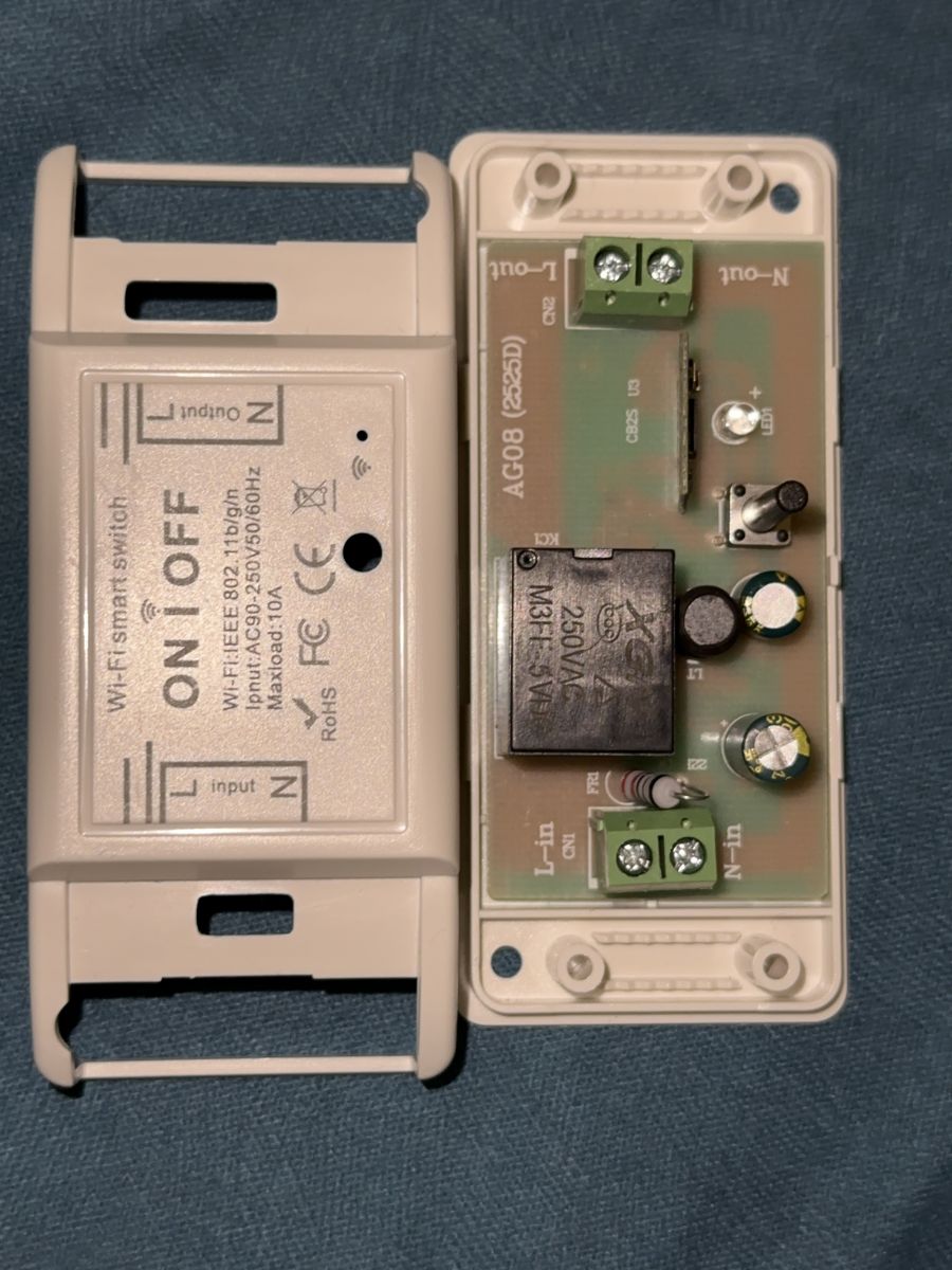

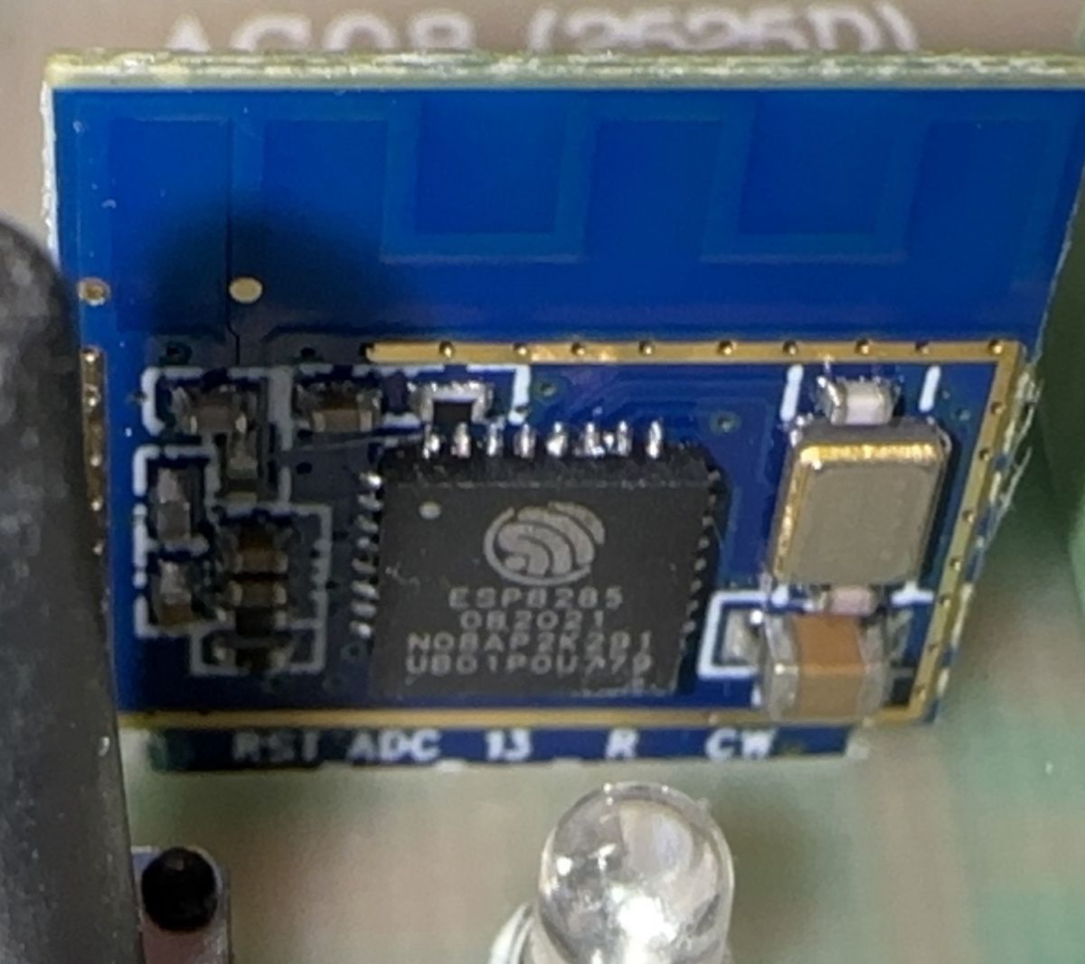

    I will condense 3 teardown into one post because they are very similar.
    They all use a variation of the TYWE2S module
    Teardown of 3 Generic Smart Switch Variants with ESP8265 10A TYWE2S Module & Flash Mode Guide
    First variant:
    Teardown of 3 Generic Smart Switch Variants with ESP8265 10A TYWE2S Module & Flash Mode Guide Teardown of 3 Generic Smart Switch Variants with ESP8265 10A TYWE2S Module & Flash Mode Guide Teardown of 3 Generic Smart Switch Variants with ESP8265 10A TYWE2S Module & Flash Mode Guide
    Pinout:
    GPIO 4 BUTTON
    GPIO 5 RELAY
    GPIO 13 LED

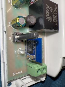

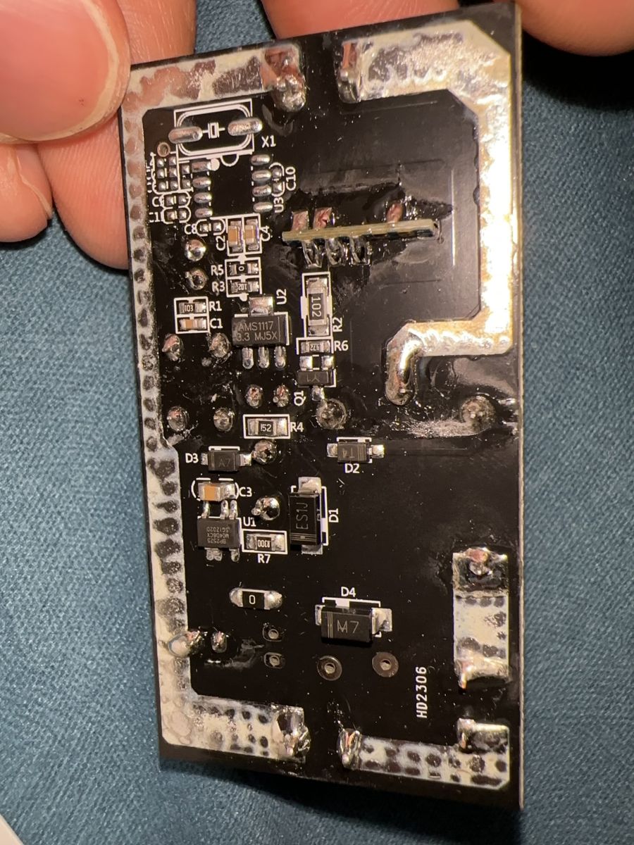

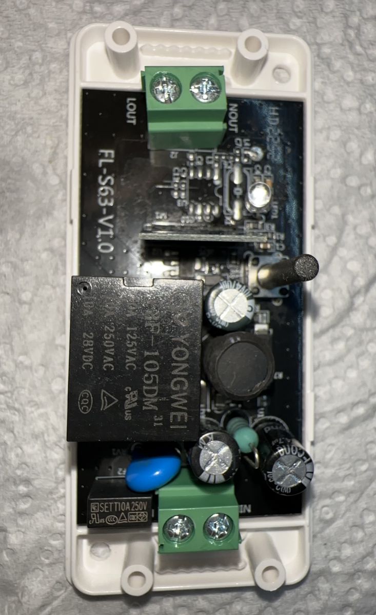

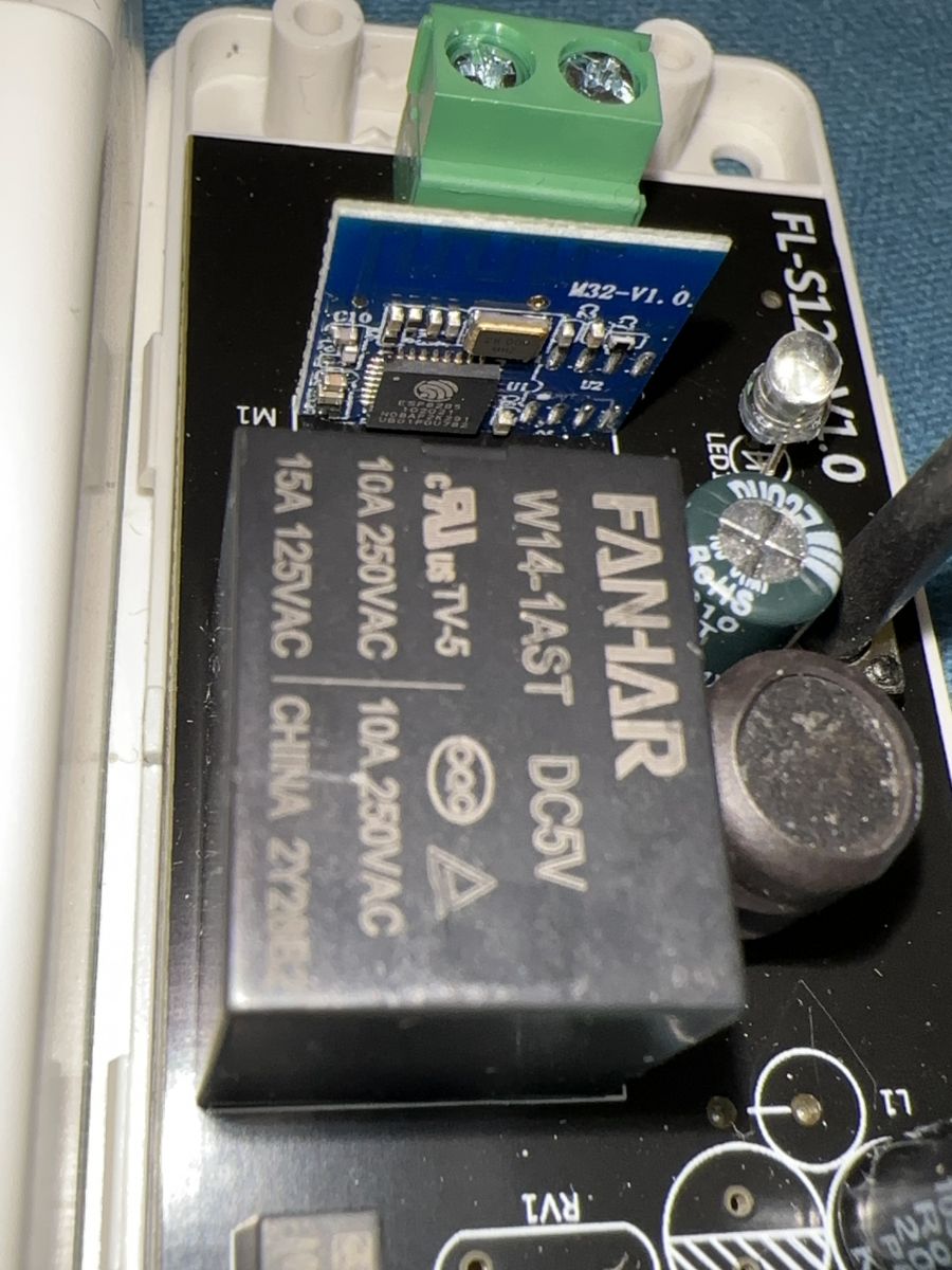

    Second variant:
    Pinout:
    GPIO 4 LED
    GPIO 12 RELAY
    GPIO 13 BUTTON

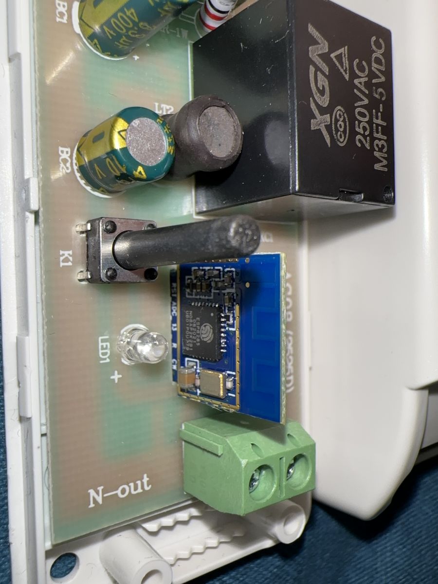

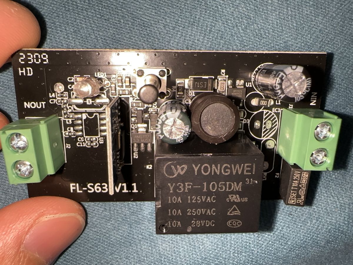

    Third variant:
    Pinout: (Same as first)
    GPIO 4 BUTTON
    GPIO 5 RELAY
    GPIO 13 LED

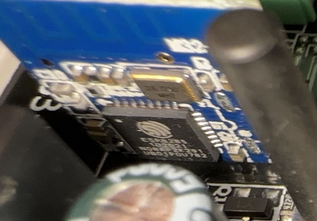

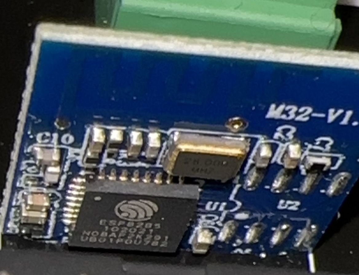

    They all have a GPIO 0 pin on a test pad on the back of the module. I used a multimeter probe to put it in flash mode.

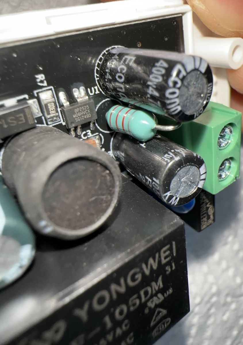

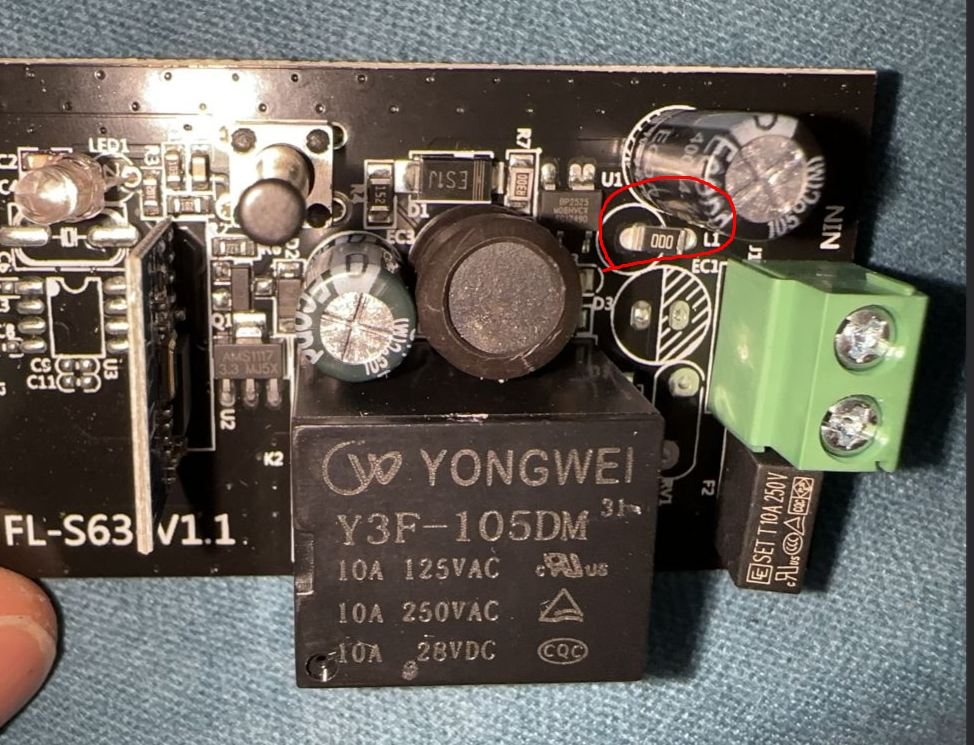

    It's a very nice comparison showing different manufacture approaches. Two of the models have single sided, cheap PCB, and third one has two sided one, but not populated.
    It's not a good sight to see empty place for varistor and other components. I can also see a spot for SOIC8 chip, it was most likely used in RF-enabled version.
    Are you able to tell the Tasmota template for this devices, and also, which power supply ICs are they using?

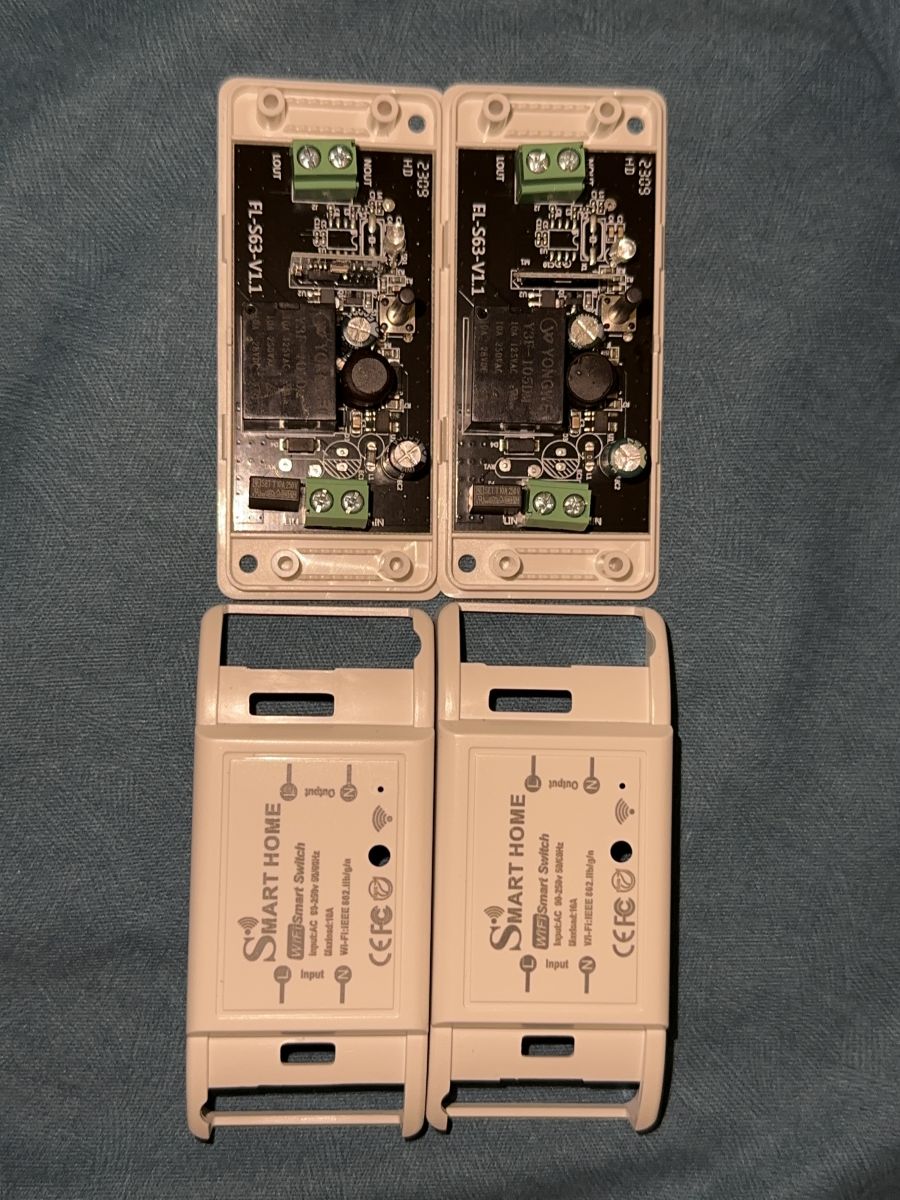

    First one is one sided so the front is quite busy. Other two are 2 sided.

    That 0 ohm jumper in place of an inductor that was supposed to form a filter with capacitors is also not a good sign:
    They usually put two electrolytic capacitors with an inductor between them, in that PCB, both inductor and one of capacitors are missing.

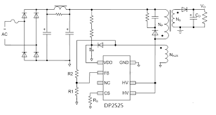

    I can also see power supply IC - BP2525, as usual.
  • Missing filter parts on cut-down switch variant

    Cracked open a new bunch of these and yep, some have the full circuit. From my basic understanding of electronics components some of the model I got have missing one electrolytic capacitor (Same value as the other black one), a ceramic capacitor and the resistor which I guess is current limiting (?).
    I should guess the cut down ones are fine to use? Worst case scenario I use them for stuff behind my UPS.
    Also considering that the versioning of the cut down is v1.1 I guess whoever made the circuit figured out that the filter was not strictly necessary so they bypassed it...

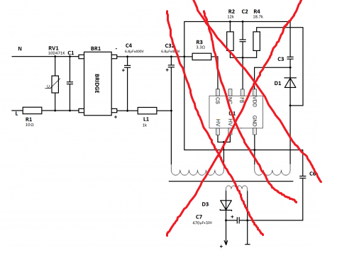

    This is how it was supposed to look like (except the crossed part, which is different on your power supply).
    The blue element, which is missing from some boards, is a varistor, marked RV1.
    Edit: maybe I was too eager to cross that part of schematic out, I can see you have BP2525 on the board, here's the BP2525 application:
    so it's just like first schematic, just note that second one is missing the varistor (RV1, both on your PCB, and on the schematic)
    Well, to be honest, I saw people using such IoT low-price low-quality switches even without varistors for a very long time, so it's not that it will immediately blow up when you connect power... but in general, the thing that Chinese sellers do is not a good practice.

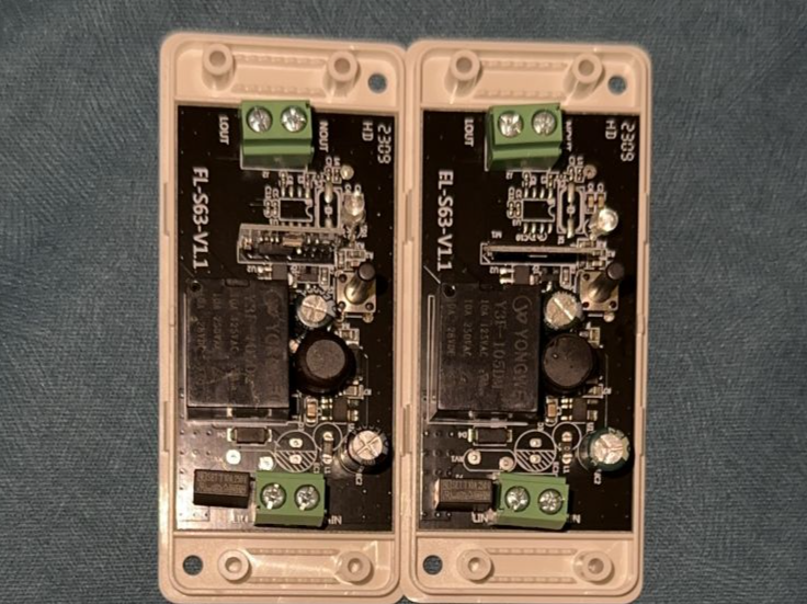

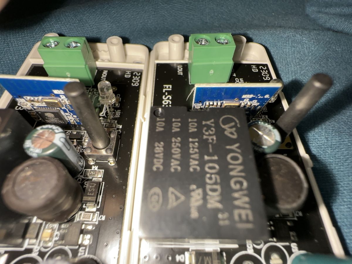

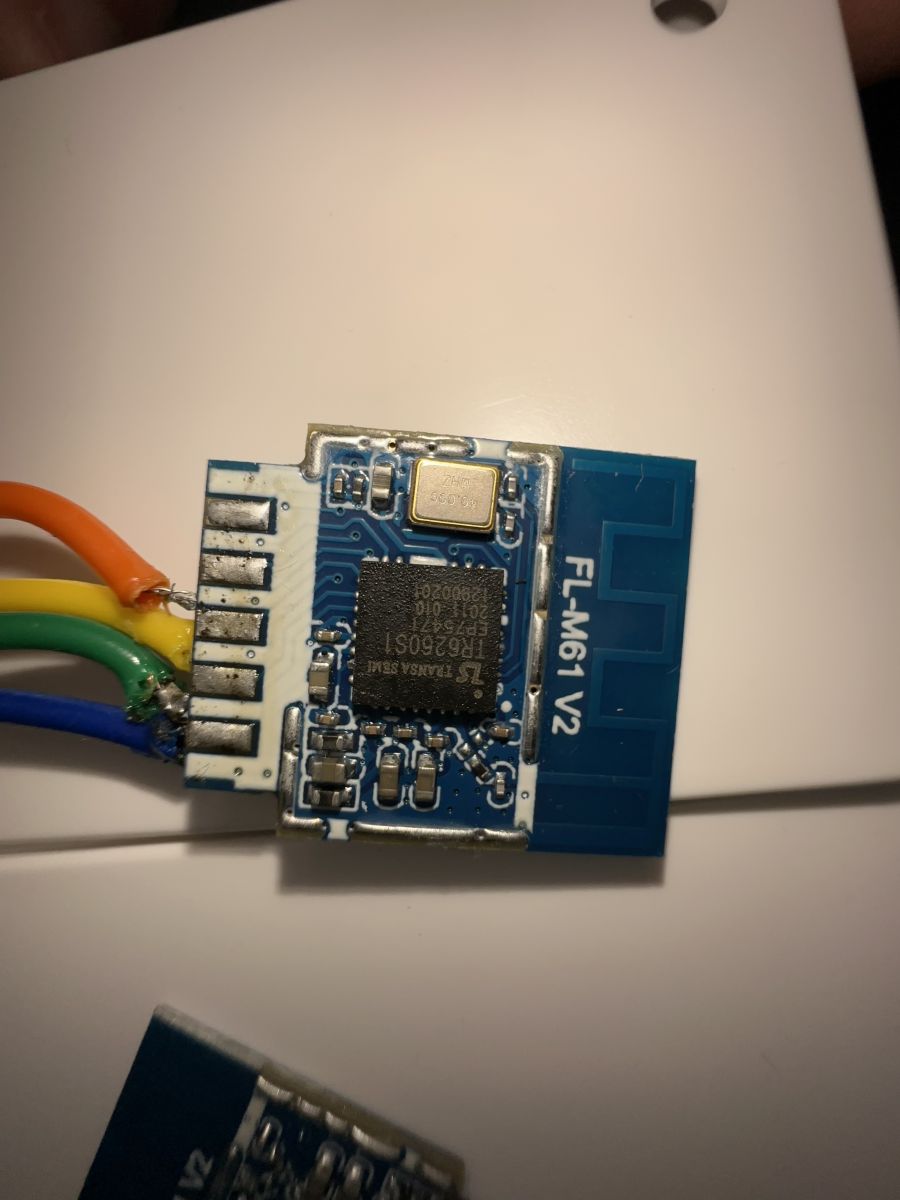

    Well, I found out these two that have the non-hackable chip. I will put them aside and deal with them later.
    Maybe this non esp chip need extra filtering to be stable?
  • #9 20589222
    Posts: 14755
    Rate: 12880
    Extra filtering/protection/etc should be always in smart relays, no matter what kind of WiFi chip is used.
    So FL-M61 V2 is TR6260? Not good. I was looking into that TR6260 recently, but there is no flash tool at all.

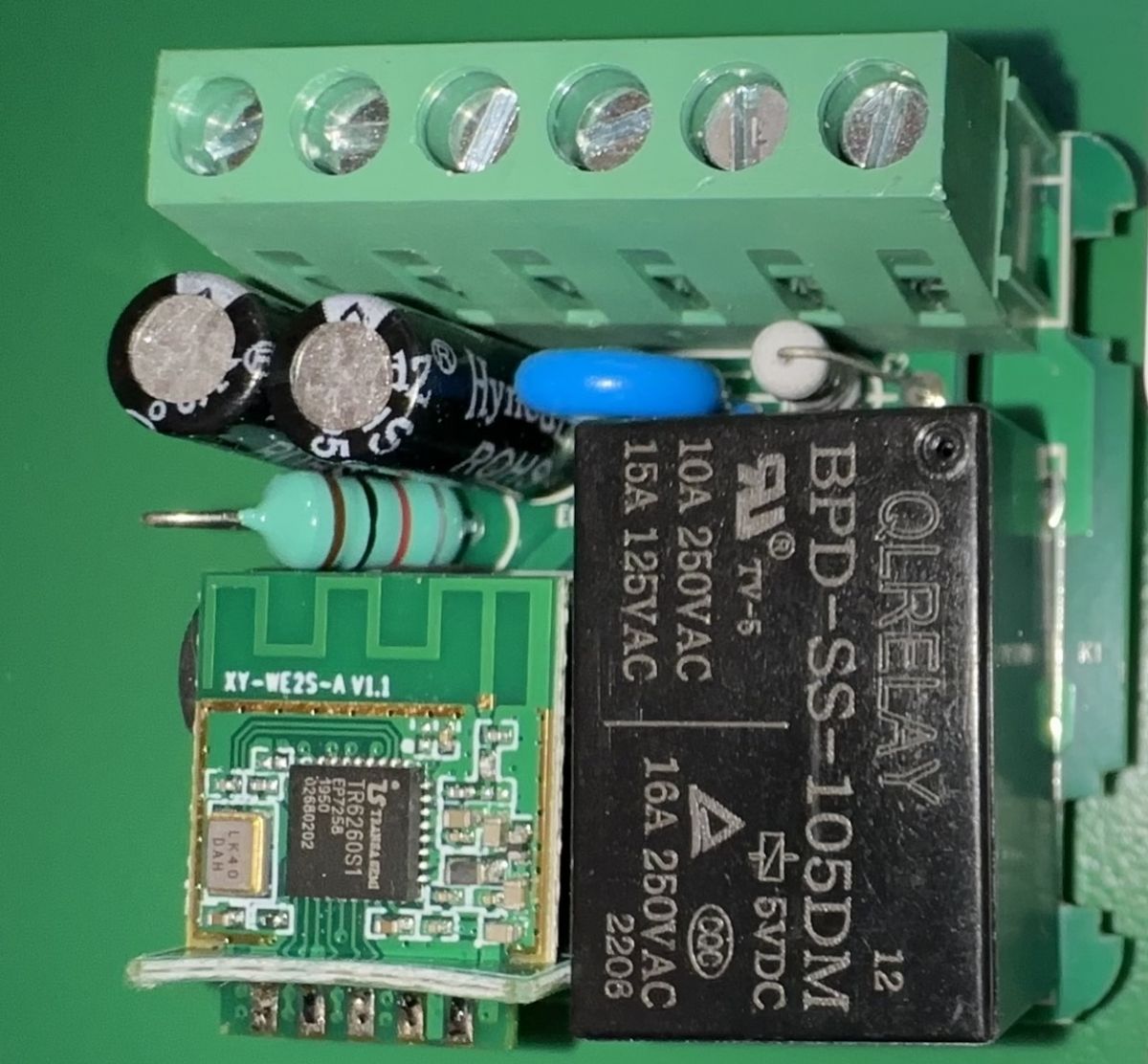

    I total I found two variants of this chip.
    This was the other one:
    Looks very similar. Luckily for me I bought so many of them that I won't have to for years.
  • #11 20589262
    Posts: 14755
    Rate: 12880
    XY-WE2S-A V1.1.. so many strange names...
    But you can replace it with ESP-02S.
  • #12 20589266
    erlipan2001
    Posts: 29
    I know but for some reason buying a replacement module costs more than what I paid for the whole thing. (I paid 1.79$ for the switch vs 4$ for the ESP-02S).
    So it makes more economical sense just to trash it and buy again considering that only 1 out of 20 had this chip.

    @erlipan2001 there is now a backup and flash tool and an OpenTR6260 firmware that can be flashed to these modules.
    If you're able to follow the new guide to backup the existing firmware, that would be very useful.
    https://www.elektroda.com/rtvforum/topic4093752.html
    @morgan_flint is battling with an XY-WE2S-A V1.1 right now to make a backup.

    That TR6260 device is Tuya? I wonder if it has a Tuya JSON in flash as well?
  • #16 21402359
    Posts: 5212
    Help: 446
    Rate: 914
    I'm hoping so. This is partly why I've been so excited about getting my hands on a Tuya TR6260!
  • #17 21402508
    morgan_flint
    Posts: 251
    Rate: 63

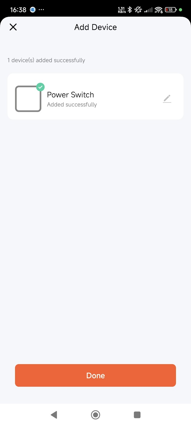

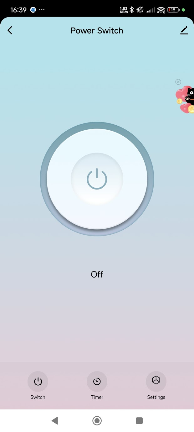

    >>21402346 Yes, I could control it with Tuya Smart App and also with Smart Life.
    @divadiow now has the full dump, once he checks it's alright, I'll post it here or, maybe better, in the flashing guide, you'll tell me where it should go

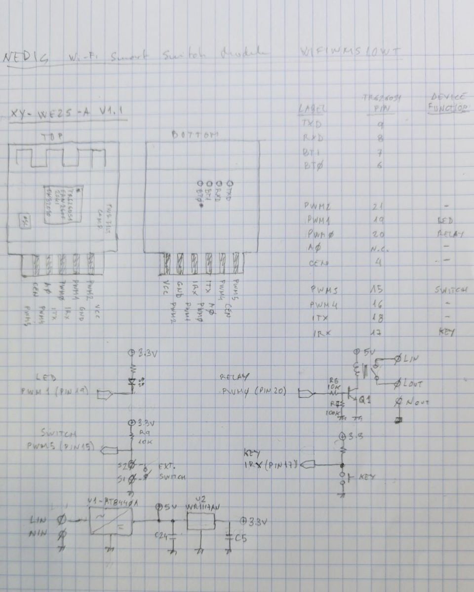

  • Schematic and flashing pads for TYWE2S module
    #22 21403163
    morgan_flint
    Posts: 251
    Rate: 63

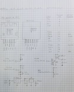

    divadiow wrote:
    I was wondering maybe if your device is pulling one of the GPIOs high and that's what is needed, but I guess not if you say it boots with the module desoldered.
    It's pulling high pins 15 and 17, but probably not needed, as it boots unsoldered from the device. I've just finished drawing the schematic:
    Diagram of a Wi-Fi Smart Switch circuit drawn on graph paper.
    For reading and flashing, the following pads at the bottom side are used: TXD and RXD to USB to serial adapter's RXD and TXD, respectively, BT0 to GND and Vcc to 3.3V (my USB to serial adapter is modified for 3.3V levels at TXD and RXD).
    I'm also attaching the full dump (the one I sent to @divadiow with the WiFi SSID and password removed by him, still pending to try to reset it with a long press of the key).
    • NedisWIFIWMS10WT_0x100000.bin (1 MB) You must be logged in to download this attachment.

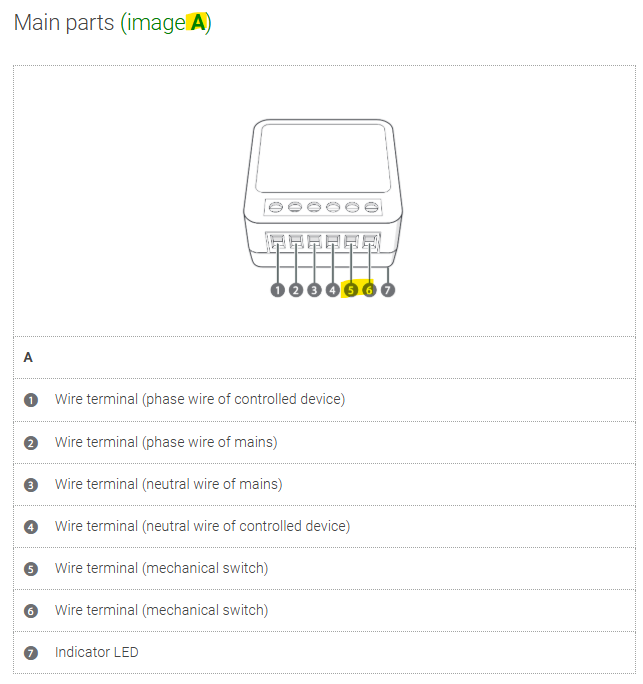

    #25 21403406
    Posts: 5212
    Help: 446
    Rate: 914
    I am further and almost had it paired. Removed the ESP adaptor from equation and used ext 3.3v PSU. It also joins an AP with your creds specified. I just need to get it to reset.
    Instructions excerpt:
    If the indicator LED A7 is not blinking
    a.
    Switch off the power group again.
    b.
    Check if all wires are connected well.
    c.
    Switch the power group back on.
    If the indicator LED A7 is blinking continue with step 5..
    If not, continue with step d..
    d.
    Switch the mechanical switch on and off 6 times to reset the product.
    If you have no mechanical switch connected to the product, bridge the wire terminal A5 to the wire terminal A6 with a wire 6 times to reset the product.
    manual
    Diagram showing the main parts of a device with labeled wire terminals and an indicator LED.
    I just need to work out if I can achieve that with just the module
    new boot log as I fiddle with GPIOs and resets
    Added after 4 [hours] 50 [minutes]:

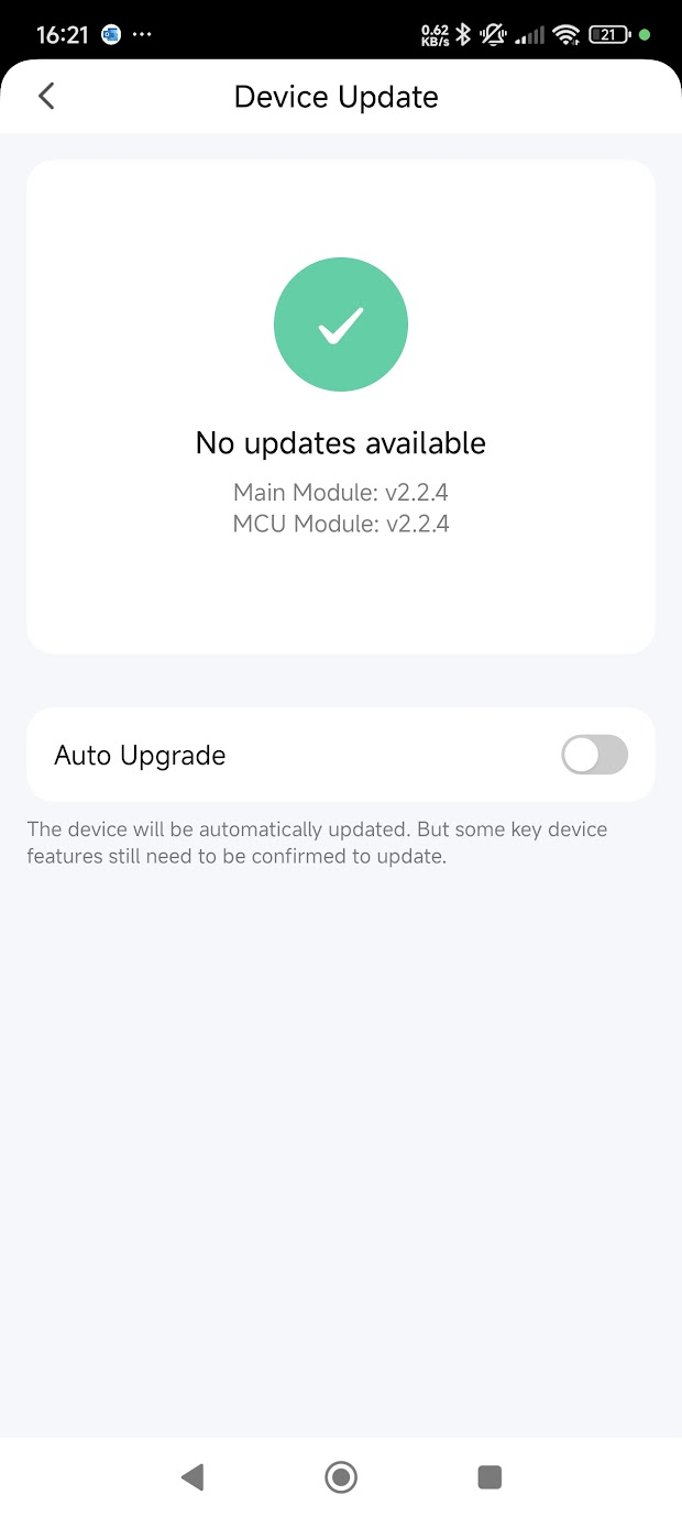

    OK. I paired it twice. Don't ask me how I got it into the right mode to stay in AP mode long enough. To pair you must use the slow-blink manual pairing mode in the app, if you ever get it to broadcast SmartLife AP long enough.
    Here's another part of the boot log, you can see the product and firmware keys I posted earlier
    App screen confirming the addition of the Power Switch device. App screen showing a power switch that is turned off. Device update screen showing no updates available.
    reset firmware (containing creds for AP SSID test password 1234abcd) will land here https://github.com/openshwprojects/FlashDumps/tree/main/IoT/TR6260
    Tuya_Nedis_WMS10WT_Breaker_(schemaID-000004f9cj)_shoyx238jhhnxbef_2.2.4.bin

TYWE2S variant 1 GPIO4 GPIO5 GPIO13 GPIO0 test pad on rear
TYWE2S variant 2 GPIO13 GPIO12 GPIO4 GPIO0 test pad on rear
TYWE2S variant 3 GPIO4 GPIO5 GPIO13 Same pinout as variant 1
TR6260 XY-WE2S-A V1.1 GPIO2 in boot log GPIO13 control line shown Use BT0, TXD, RXD, 3.3V pads

  • The three ESP8265/TYWE2S variants use two GPIO layouts: GPIO4/GPIO5/GPIO13 and GPIO13/GPIO12/GPIO4 for button, relay, and LED. [#20578046]
  • The ESP8265 flashing entry point is GPIO0 on a rear module test pad; the author grounded it with a multimeter probe. [#20578046]
  • The discussed power supply used a BP2525 IC, with some PCBs missing a varistor, one electrolytic capacitor, a ceramic capacitor, and a resistor. [#20586703]

Use two pinout families across the three 10A TYWE2S-style ESP8265 variants. Variant 1 uses GPIO4 for button, GPIO5 for relay, and GPIO13 for LED. Variant 2 uses GPIO13 for button, GPIO12 for relay, and GPIO4 for LED. Variant 3 repeats variant 1: GPIO4 button, GPIO5 relay, GPIO13 LED. Verify the board visually before flashing, because identical cases can hide different PCB layouts. [#20578046]
How do I put a TYWE2S ESP8265 smart switch module into flash mode using the GPIO0 test pad?
Ground GPIO0 during boot to put the TYWE2S ESP8265 module into flash mode. The thread identifies GPIO0 on a rear test pad of all three modules. A practical method used was touching that pad with a multimeter probe while applying power. Keep the serial adapter at 3.3V logic levels and avoid mains power during programming. [#20578046]

Why do some low-cost Tuya smart switches omit the varistor, inductor, or extra capacitors from the power supply circuit?
Manufacturers omit those parts to reduce cost and simplify the PCB assembly. The thread shows a cut-down v1.1 board with a 0 ohm jumper where an inductor should form a filter with capacitors. Other units had the fuller circuit populated. The expert comment was direct: removing protection parts in low-price IoT switches is "not a good practice." [#20586823]

The BP2525 is the power supply IC used on the discussed generic Tuya-style switch PCB. It belongs to the mains power supply section that feeds the low-voltage electronics. The thread shows the BP2525 application circuit and compares it with the board’s missing RV1 varistor. Treat this area as hazardous, because it connects to AC mains. [#20586823]
How safe is it to use a smart switch PCB that has a 0 ohm jumper instead of an inductor in the input filter?
It may operate, but the reduced input filter is a safety and reliability compromise. A 0 ohm jumper replaced the inductor that should sit between two electrolytic capacitors. One capacitor was also missing on that PCB. The forum expert noted such low-quality switches can run for a long time, yet the design remains poor practice. [#20586823]

How do single-sided and double-sided smart switch PCBs compare in cost, safety, and component layout?
The single-sided board packs more parts on the front, while the later boards use two sides. The discussion first described two cheap single-sided PCBs and one two-sided PCB, then clarified the first was one-sided and the other two were two-sided. Empty footprints for a varistor and SOIC8 chip indicate optional or omitted circuitry, not automatic safety improvement. [#20578088]

TR6260 is a Wi-Fi chip found in some replacement modules such as FL-M61 V2 and XY-WE2S-A V1.1. "TR6260" is a non-ESP Wi-Fi microcontroller platform used in Tuya devices, requiring different backup, flashing, and firmware tooling than ESP8265-based TYWE2S modules. In May 2023, the thread stated no flash tool existed; by January 2025, tools and OpenTR6260 were available. [#21400367]
How can I back up and flash firmware on a TR6260 module such as XY-WE2S-A V1.1 or FL-M61 V2?
Use the TR6260 backup and flash workflow, not ESP8265 tools. A working setup used TXD and RXD to a USB-to-serial adapter, BT0 tied to GND, VCC at 3.3V, and 3.3V TX/RX levels. The module was read and flashed from bottom-side pads. A full dump was attached after removing Wi-Fi SSID and password. [#21403163]

How do I reset a Nedis WIFIWMS10WT SmartLife power switch into pairing mode using the mechanical switch or bridged terminals?
Reset the Nedis WIFIWMS10WT by toggling the external switch connection 6 times. Use this 3-step method:
  1. Power the product and check whether indicator LED A7 blinks.
  2. Toggle the mechanical switch on and off 6 times.
  3. If no switch is connected, bridge terminal A5 to A6 6 times. Then use Smart Life slow-blink manual pairing if the AP stays available. [#21403406]
Where are the TXD, RXD, BT0, VCC, and GND pads used for reading or flashing a TR6260 smart switch module?
They are on the bottom side pads of the TR6260 module used in the smart switch. Connect module TXD to adapter RXD, module RXD to adapter TXD, BT0 to GND, and VCC to 3.3V. The adapter must use 3.3V TXD and RXD levels. This setup was used to read and flash the XY-WE2S-A V1.1-type module. [#21403163]
