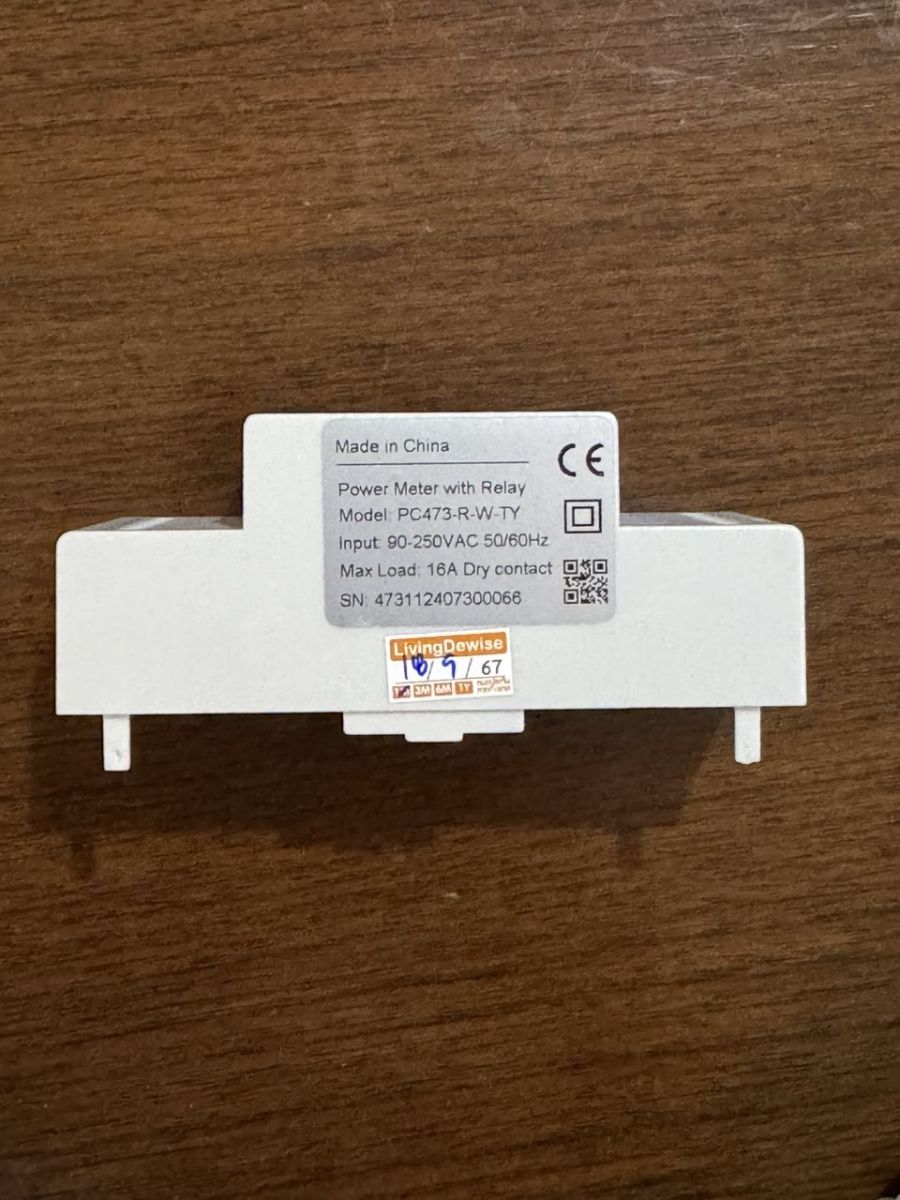

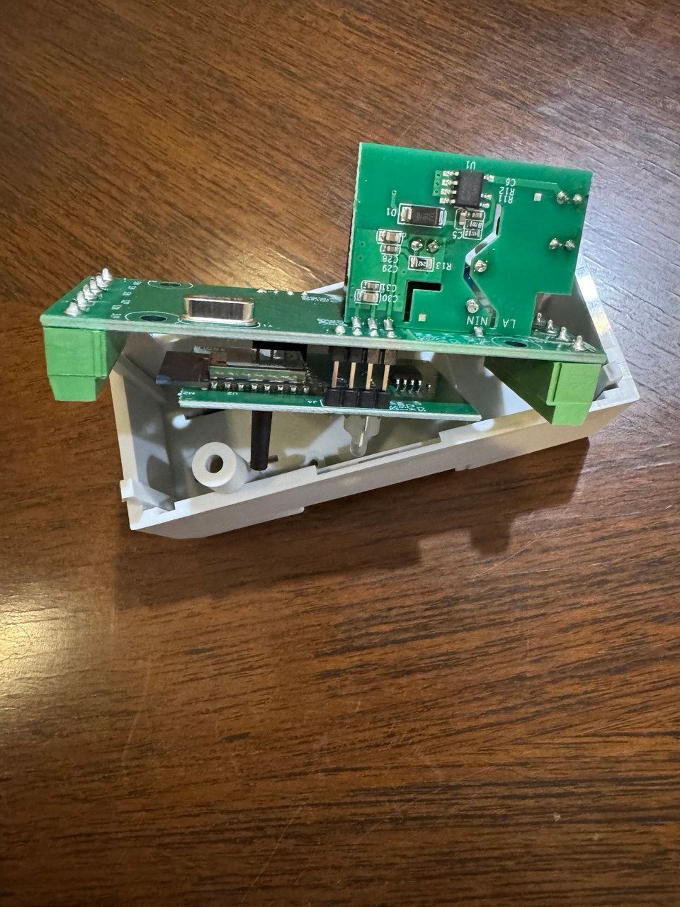

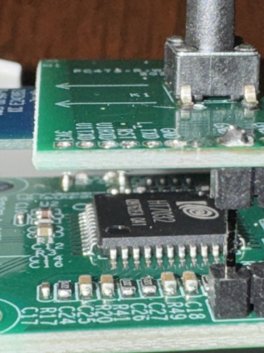

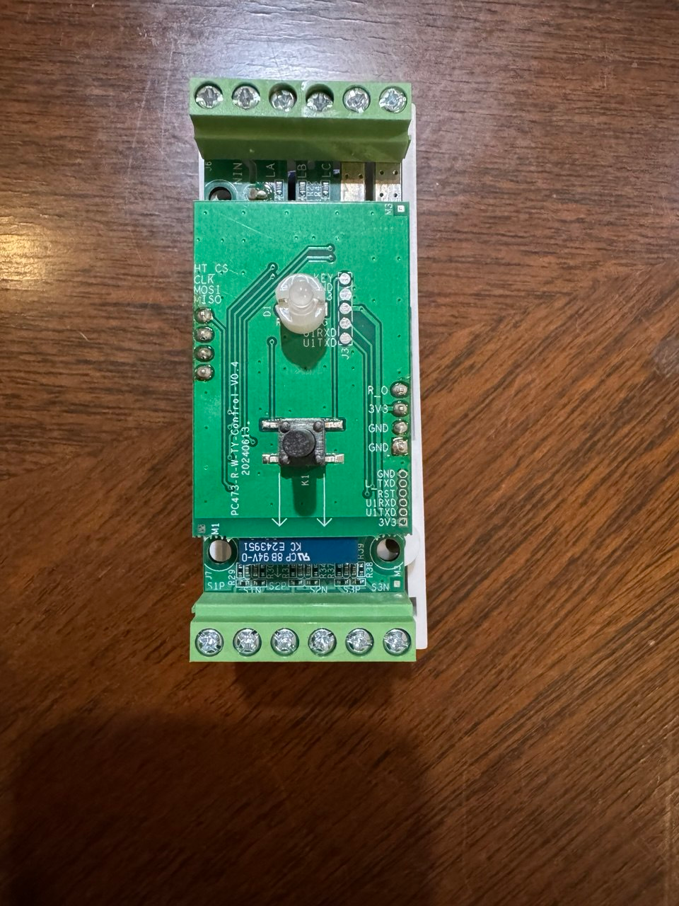

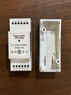

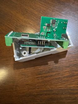

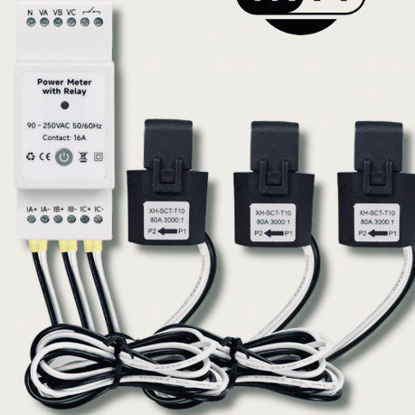

    Bidirectional 3-phase energy meter with a relay and three sensors.
    This device is two-way 3-phase energy metering with 1 channel relay communicating over wi-fi. It reports voltage, current, power factor, active energy, and reverse energy.

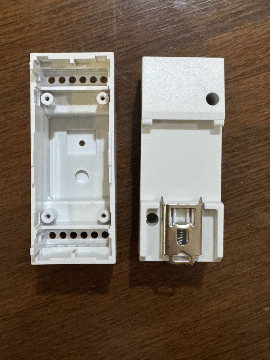

    The body can be removed by unscrewing 2 screws at the back and lightly pressing the 2 latches on top and bottom; be gentle at the latches as they easily break.
    There are 2 layers of PCBs stacked over each other, securely soldered and with precise spacing to fit top and bottom cases. I recommend not de-soldering the part.

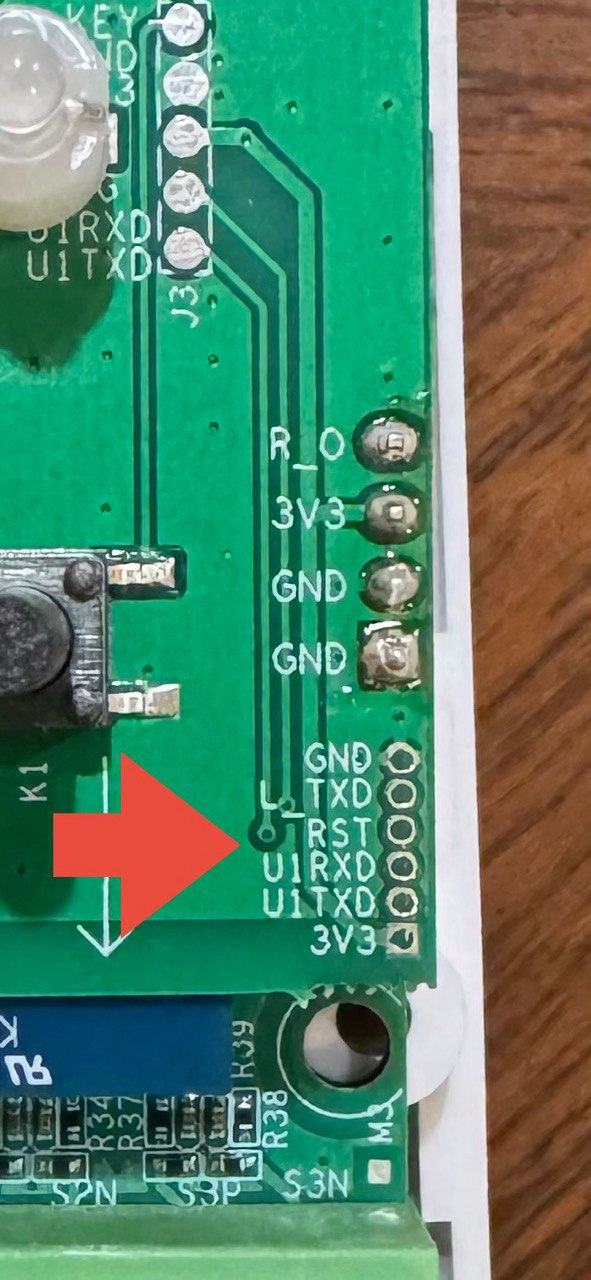

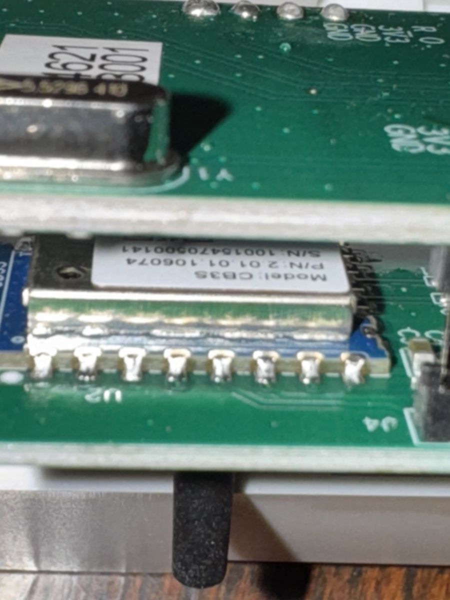

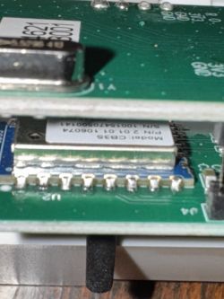

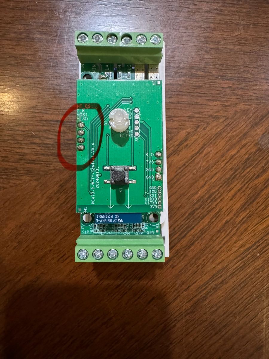

    I closely looked at the chip and it is CB3S. I managed to flash BK7231N, but cannot proceed with the config on dp_ids, still searching for a profile and template that would fit.
    Bidirectional 3-phase energy meter with visible PCB.
    Two-phase energy meter with visible two PCB layers.
    Flashing can be done by wiring to GND UIRXD UITXD 3V3.
    Close-up of a PCB with pin markings and a red arrow pointing to the UART section.

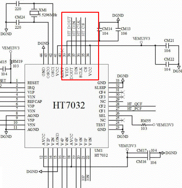

  • HT7032 metering chip identified from patent
    #4 21262967
    Posts: 14791
    Rate: 12937

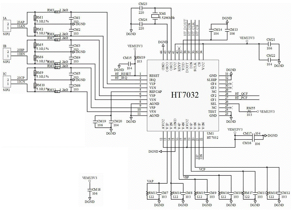

    So HT7032 connects to the WiFi module via UART?
    What did it report in Tuya app, did it report both WiFi module and MCU versions?
    Do you have 2MB flash backup?
    By the way... HT7032 ?
    https://patents.google.com/patent/CN216211301U/en
    6. The three-phase intelligent electric energy meter with the built-in electronic local load switch of claim 5, wherein the type of the metering chip is HT7032, the sampling resistor of the current sampling circuit is 0805 chip resistor, and the sampling resistor of the voltage sampling circuit is 1206 chip resistor.
    Electronic circuit schematic with HT7032 chip.
  • #5 21263124
    ipasitt
    Posts: 13

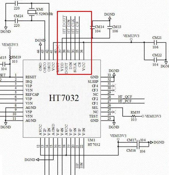

    Circuit board with labels and connectors for Wi-Fi communication.
    These 4 pins are which HT7032 communicates with Wi-Fi.

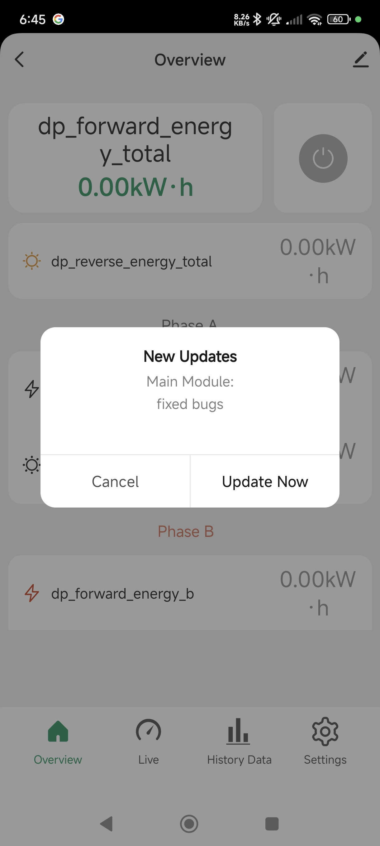

    storage area in this file contains:
    and the boot log

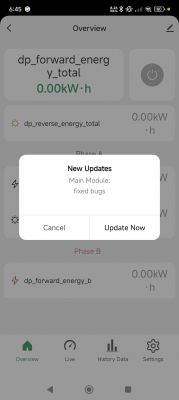

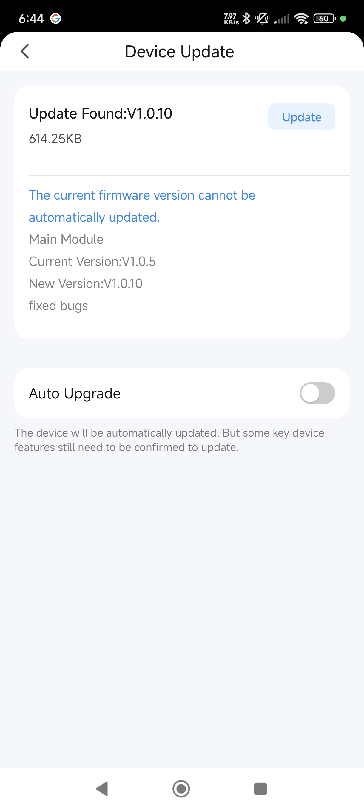

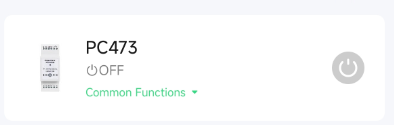

    When pairing with Tuya app you get offered an update from 1.0.5 to 1.0.10
    Device update to version 1.0.10 App display for device PC473 with on/off toggle option. Screenshot of an app with a software update notification.
    after pairing and on 1.0.5 the storage area now contains all the dpID info:
    not seeing any mention of baud speeds
    Added after 3 [minutes]:
    >>21263505
    this secondary binary is already 1.0.10 and contains the dpIDs. did you pair and update this one?
    could this mean it's either SPI, QSPI or SSI?

    I had already paired with TUYA app and upgraded to 1.0.10. Somehow the device still shows 1.0.5 maybe I did not power the device with AC current when I pair with Tuya app, but the upgrade process gone through. Currently I had already flash BK7231N. I don't know how to go from here.

  • Cloudcutter profiles added for both firmware versions
    #13 21263926
    Posts: 5232
    Help: 449
    Rate: 918
    ipasitt wrote:
    Is there any chance to get this device working with OpenBeken?
    well I guess OpenBeken will run now on the CB3S but it won't be much use. The communication with the HT7032 will need deciphering and some code writing to accommodate this meter.
    So no, OpenBeken will not give you a fully working non-cloud/Tuya device at present.

    I saw many config mention it is SPI communication between HT7032 to wifi. Correct me if I am wrong.

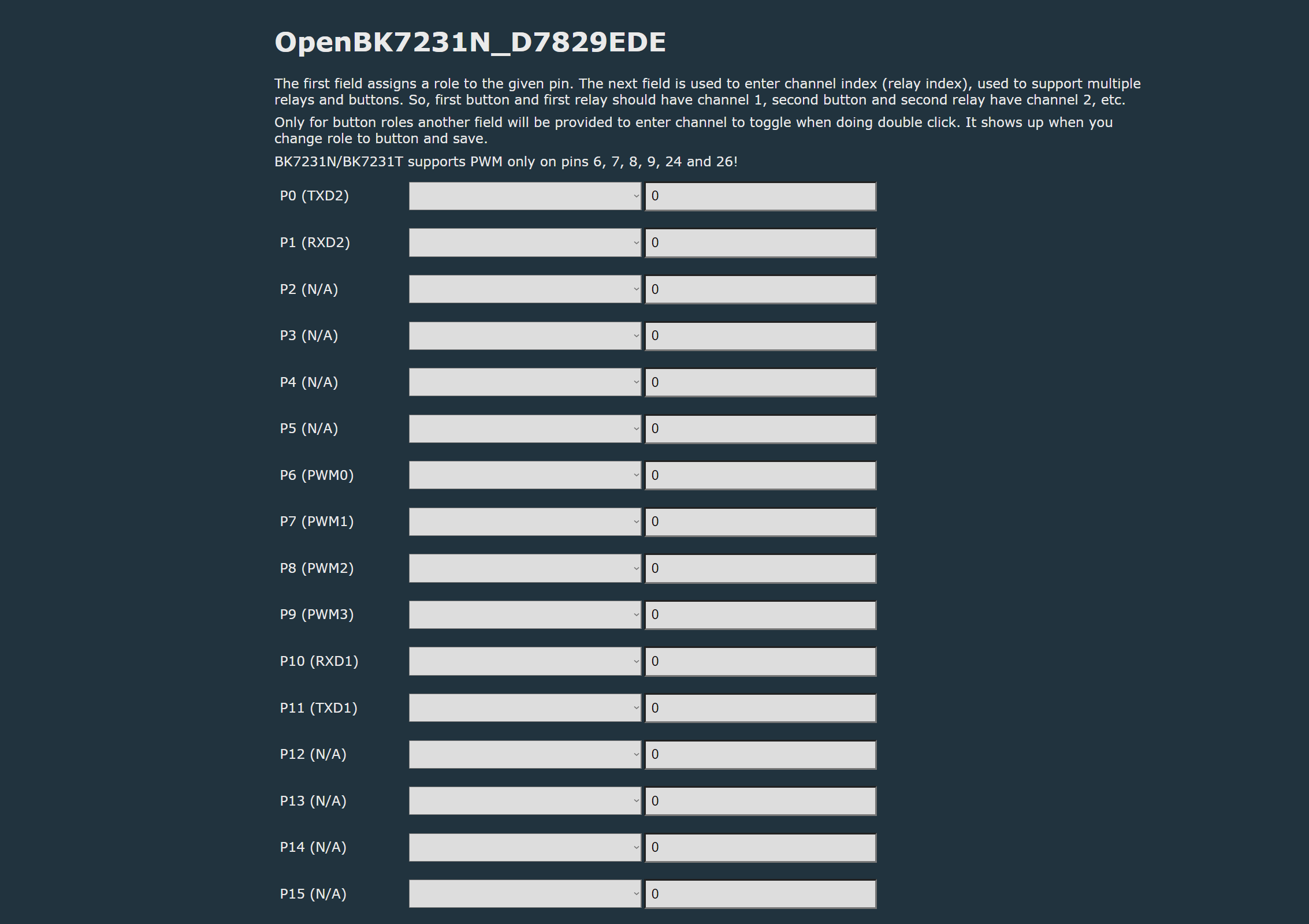

    Screenshot of the OpenBK7231N configuration with a list of available pins and their assignments.
    I mean I am stuck at the config page going nowhere. If I do it from the CloudCutter I would get the dp_id from there. Perhaps I am wrong.

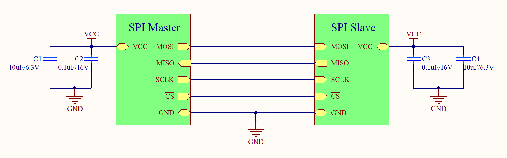

    TuyaMCU is UART only protocol, as far as I know. In order to support your device, we need either:
    - a full documentation of used chip along with SPI protocol specs (commands, etc)
    - some well described communication captures of the SPI lines made with some logic analyzer like Sigrok
    - a reference code of already existing and working driver for the mentioned SPI measurement chip

    The article you linked is only showing a generic basics of what SPI protocol is. It's a device-independent description of SPI and it's modes.
    We, on other hand, need a device-specific documentation of SPI commands and registers of HT7032.
    The best I can find is this chinese patent, but there doesn't seem to be any protocol details there...

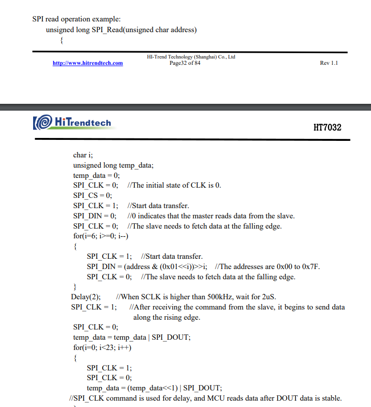

  • #24 21280945
    Posts: 14791
    Rate: 12937
    Very nice, they even include read operation sample, where did you find it?
    SPI read operation example in a Hi-Trend Technology document.
    There is also registers data in this document, but there is a lot of those registers.

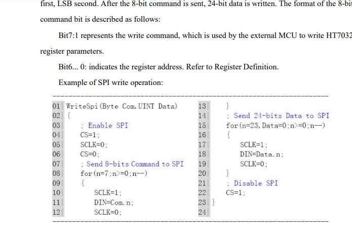

  • Formatted SPI read/write routines for the meter chip
    #26 21285031
    Posts: 14791
    Rate: 12937
    So here is formatted Read:
    Code: C / C++
    Write is in this document as well:
    Fragment of documentation showing an example of an SPI write operation.
    Hopefully I've wrote it down without errors:
    Code: C / C++
