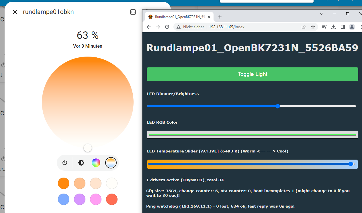

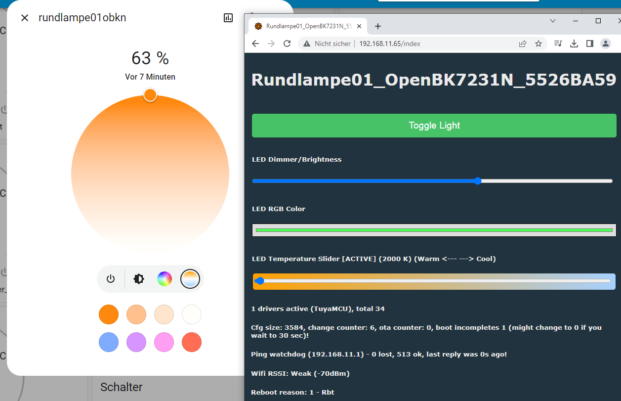

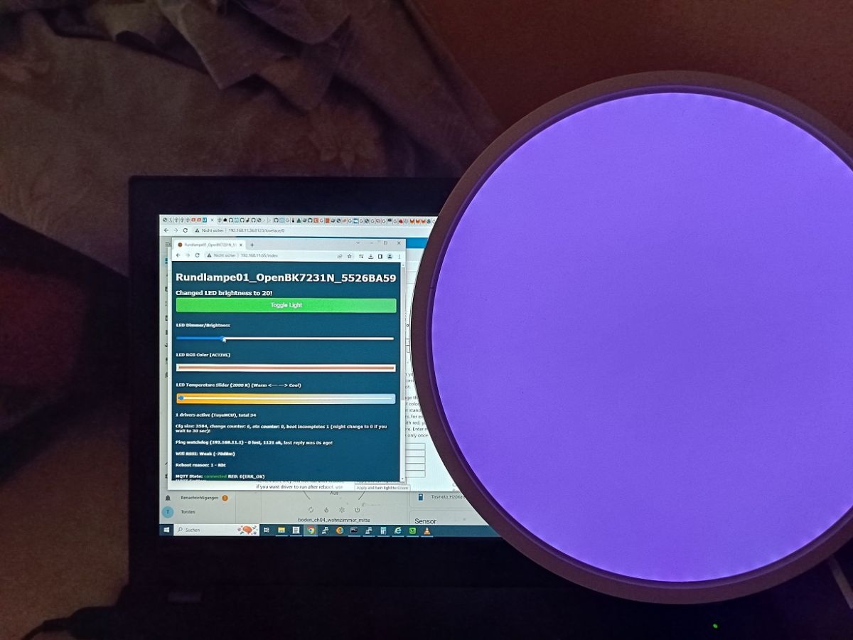

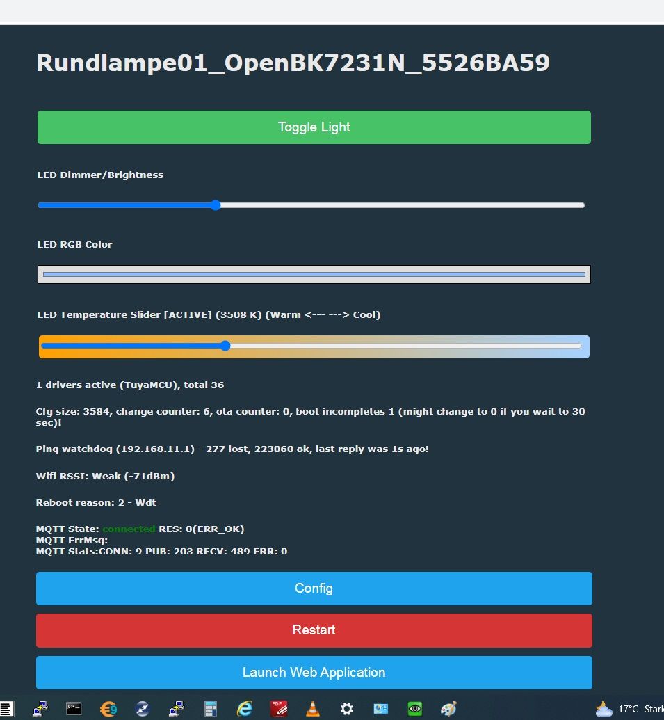

    I have seen a bug, I call it the white-temperature-reverse bug:
    The web interface shows cold white, but the lamp gives out warm white
    [BK7231N/CBU] LED Panel YB8007/300, BK7231Flasher Extraction of config, TuyaMCU LED?
    The web interface shows warm white, in reality, it is cold white now.

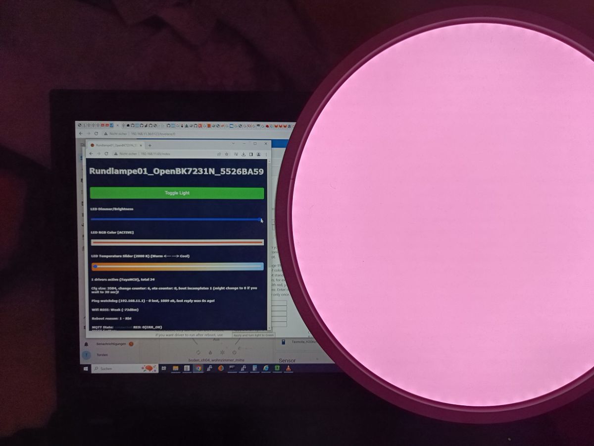

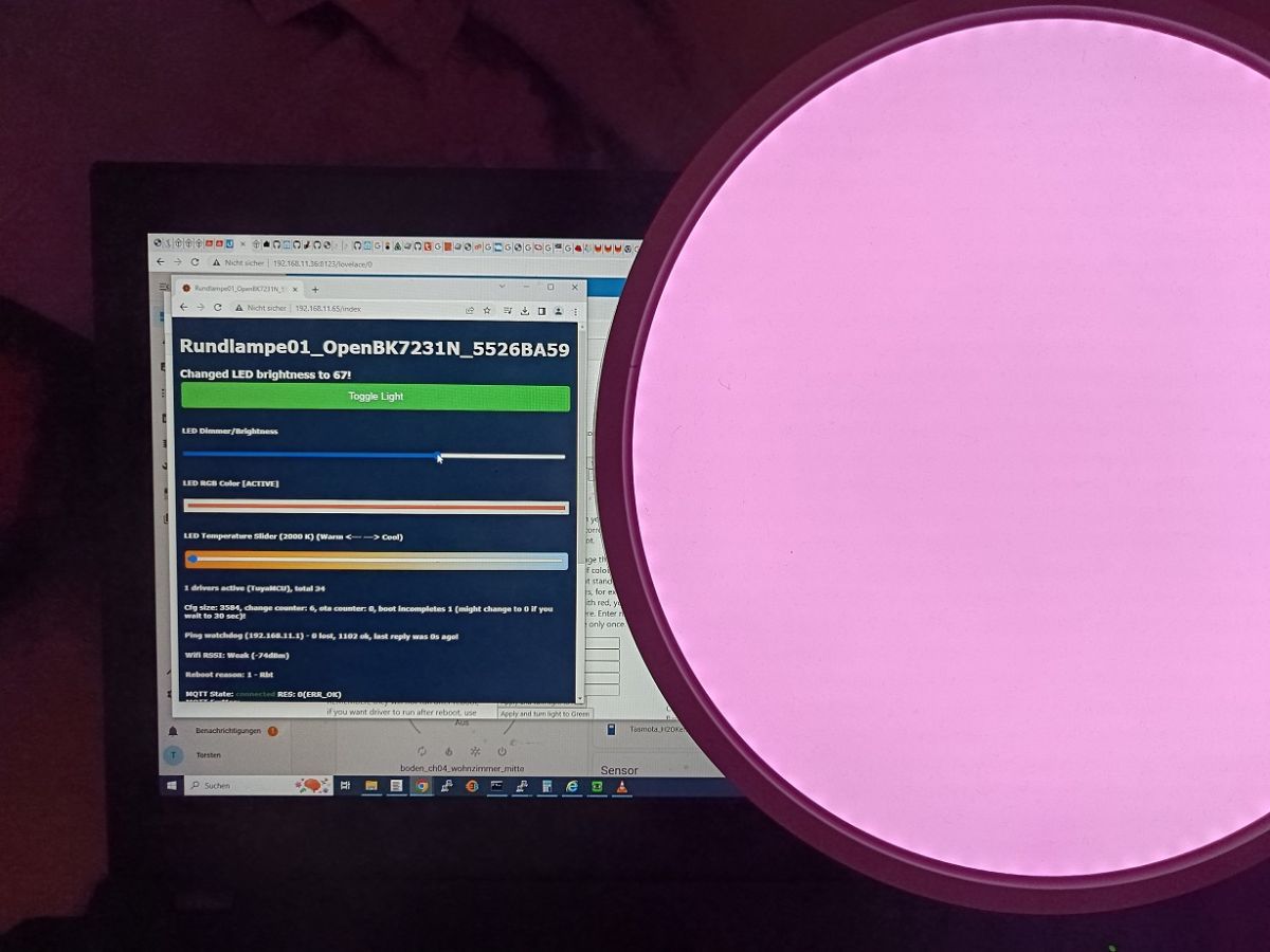

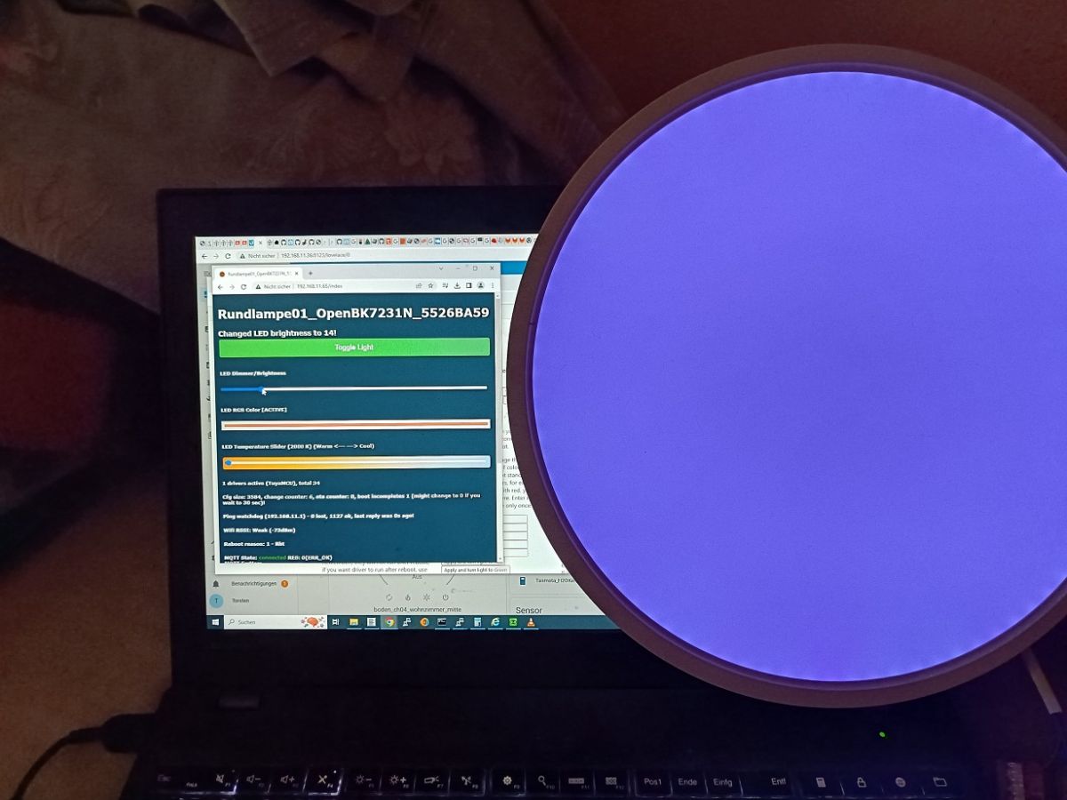

    Added after 15 [minutes]:

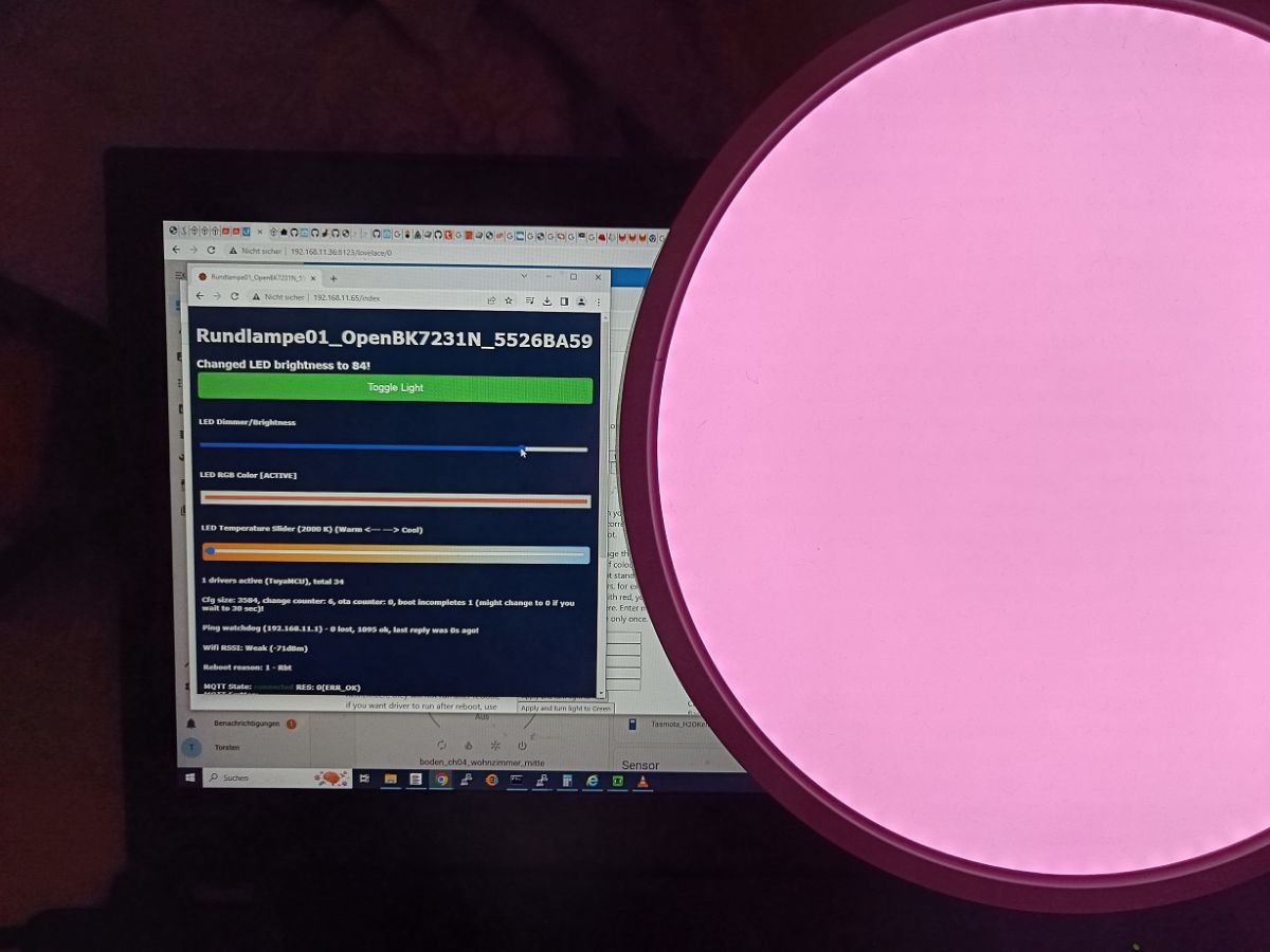

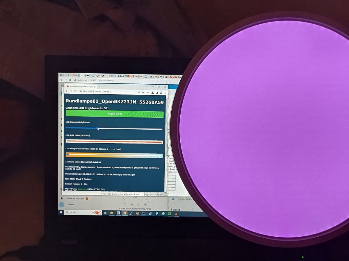

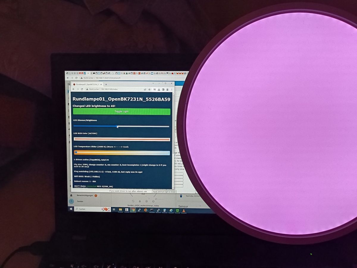

    Another thing is the brightness/dimmer in RGB mode.
    1. If the value is set below 13, the lamp is off (instead of darker). So the usable range starts at 13
    2. If the brightness of a "mixed" RGB color goes down, the color tends to go bluish.
    With "mixed" color, I mean when more than only one base color is used, for example: red: 30, green: 40, blue: 10
    I don't know if the effect comes because the lamp has quality problems in low brightness situations or the
    calculation of the real color (based on the color + brightness).
    Please see the pictures to see what I mean. I only changed the brightness.
  • #36 20718373
    Posts: 14792
    Rate: 12937
    So we need an option to reverse the CCT?
    Can you post your full current config?
  • Need an option to reverse CCT mapping
    #37 20720527
    nethawk
    Posts: 23
    I think, this would be great.

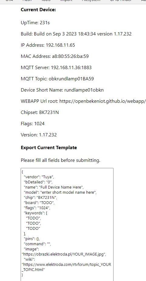

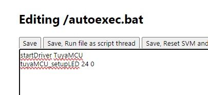

    Really nothing special there:
    Screenshot of IoT device configuration interface showing MQTT data.
    Text editor with open autoexec.bat file containing code related to TuyaMCU.
    mqtt:
      light:
      - unique_id: "Rundlampe01_OpenBK7231N_5526BA59_light"
        rgb_command_template: "{{ '#%02x%02x%02x0000' | format(red, green, blue)}}"
        rgb_value_template: "{{ value[0:2]|int(base=16) }},{{ value[2:4]|int(base=16) }},{{ value[4:6]|int(base=16) }}"
        rgb_state_topic: "obkrundlamp01BA59/led_basecolor_rgb/get"
        rgb_command_topic: "cmnd/obkrundlamp01BA59/led_basecolor_rgb"
        command_topic: "cmnd/obkrundlamp01BA59/led_enableAll"
        state_topic: "obkrundlamp01BA59/led_enableAll/get"
        availability_topic: "obkrundlamp01BA59/connected"
        payload_on: 1
        payload_off: 0
        brightness_command_topic: "cmnd/obkrundlamp01BA59/led_dimmer"
        brightness_state_topic: "obkrundlamp01BA59/led_dimmer/get"
        brightness_scale: 100
        color_temp_command_topic: "cmnd/obkrundlamp01BA59/led_temperature"
        color_temp_state_topic: "obkrundlamp01BA59/led_temperature/get"

    Ah okay, we still have other dpIDs hardcoded. Sorry, I work too much and I kinda forgot about! We will try to finalize it soon.
    I am also working on another TuyaMCU LED, but the individually-addressable one, in this topic:
    https://www.elektroda.com/rtvforum/topic3990646-60.html#20720640
    I pushed CCT reverse, can you check if it works for you?
    https://github.com/openshwprojects/OpenBK7231...mmit/40fcd158d3c93ad7583a9c3d85f8e7950537477d

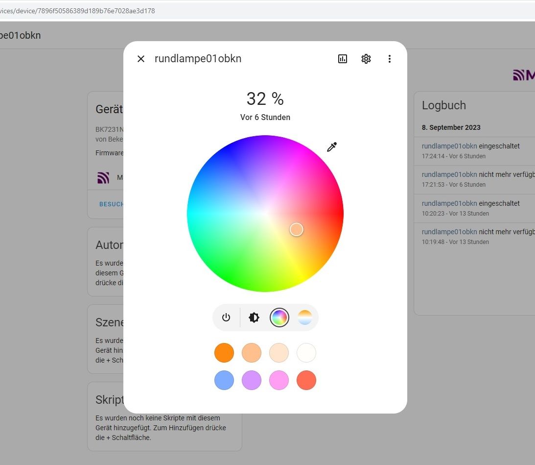

  • Repeated color changes do not freeze lamp response
    #44 20726434
    nethawk
    Posts: 23
    DeDaMrAz wrote:
    @nethawk can you change color in HA in a repetitive manner - like multiple times in a row.
    I have some issues where I can change color a certain number of times and then it will stop responding until I power cycle the device (light on/off)
    In my case the lamp stays responsive and doesn't stop working.
    I tested with the Home Assistant 2023.8.4
    Supervisor 2023.08.3
    Operating System 10.5
    Frontend 20230802.1 - latest
    Lamp control interface in Home Assistant with color and brightness level.
    and the OBK webinterface Version: 1.17.233
    Web interface for lamp control with brightness and color settings.

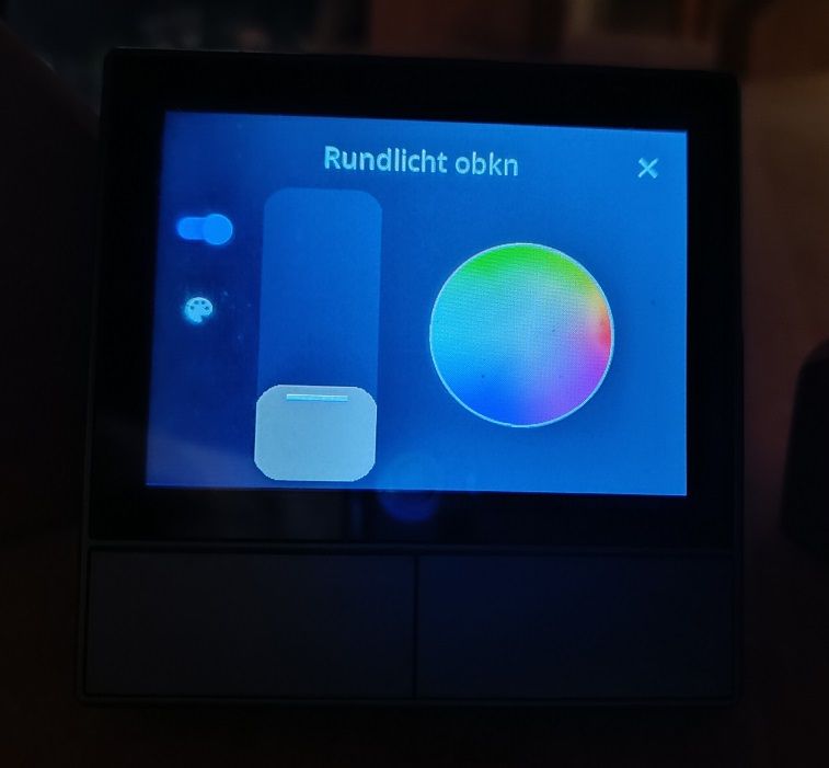

    and the NsPanel Lovelace UI on the nextion screen inside of NSPanel
    https://docs.nspanel.pky.eu/
    Touchscreen display showing a lighting control interface with a color selection option.
    On the NsPanel it is a little bit slow responsive, but I have this with other lamps too on NsPanel.

    O.k., color changed to blue, for around 1,5 seconds the OBK webinterface was unresponsive, but "it came back"
    and worked like before.
    In my case, it doesn't look as bad.
