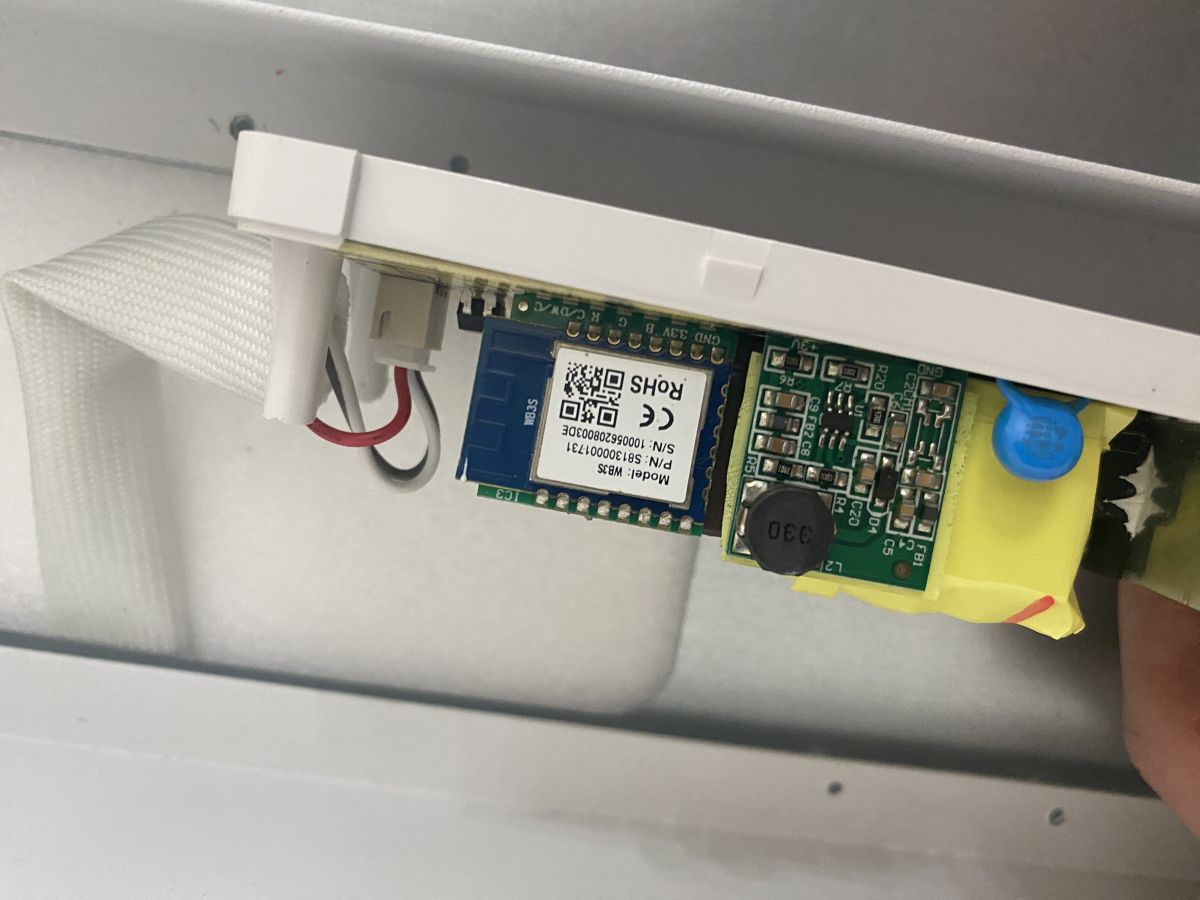

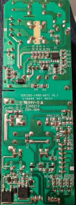

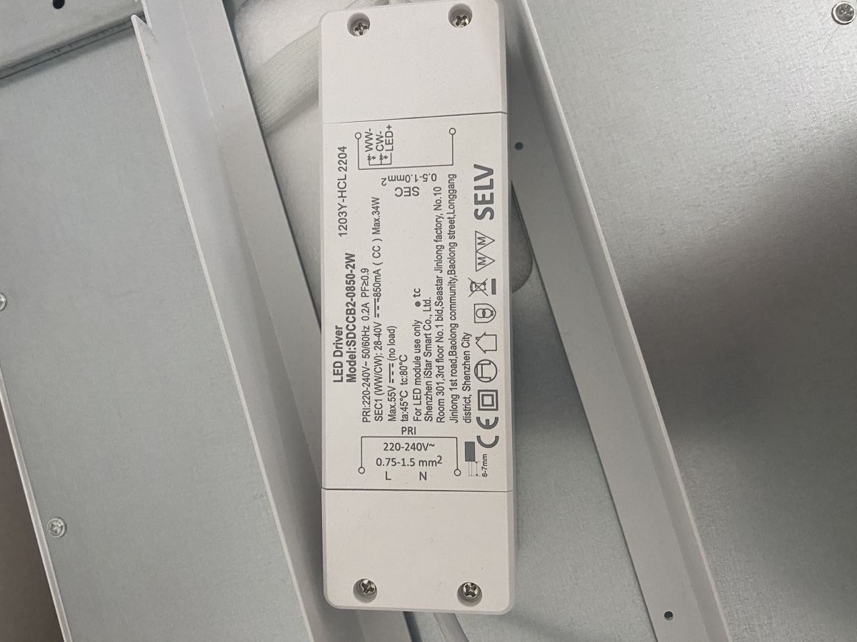

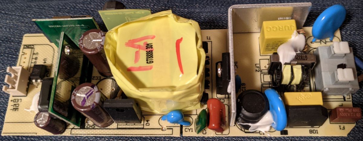

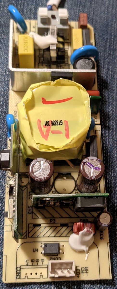

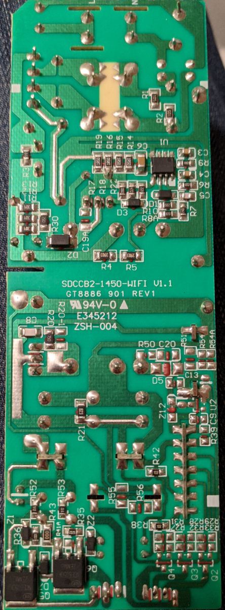

  • I got 3 LEDVANCE 60x60 LED panels with different software versions (1.1.6 and 2.9.16)
    All of them with WB3S modules, WIFI flashable with tuya-cloudcutter
    According to the manual there are different sizes available: 30x30 45x45 30x60 60x60 120x30
    Flashing has been done with tuya-cloudcutter as follows:
    * By firmware version and name
    * 2.9.16 - BK7231T / oem_bk7231s_light_ty (or)
    * 1.1.6 - BK7231T / oem_bk7231s_light_ty
    "Slow blinking mode" is done by either disconnection from tuya-cloud via app and/or via 10x power-off-on cycles. (5x starts fast blinking mode).
    The Cycles should be done with frequency of around 1 second (1/2 sec off, 1/2 sec on). A little bit faster or much slower will fail the mode switch I figured out. -- Took me some times ;-)
    After flashing:
    * Find new Accesspoint and connect to
    * Open your browser: http://192.168.4.1 and configure your WIFI
    * reboot
    * Find new (WIFI) IP address and connect to via browser
    * go to WEBAPP -> config
    * set: Pin6: PWM_n ; Pin8: PWN; Flag: 5888 -> Save Pins
    * OTA -> Make Upgrade (select Download, Download, select Disk, Start OTA)
    * at standard webpage -> Config -> Configure Names -> Set a short- and long name for your newborn baby
    * (optional) Configure MQTT, Home Assistant, etc.

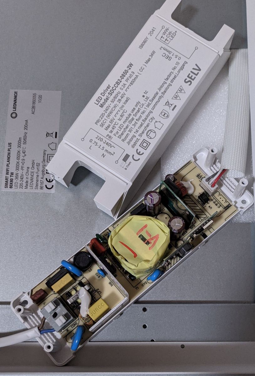

    LEDVANCE SMART+ PLANON PLUS tunable white packaging.
    Technical specifications of the LEDVANCE SMART+ PLANON PLUS 60x60 TW LED panel

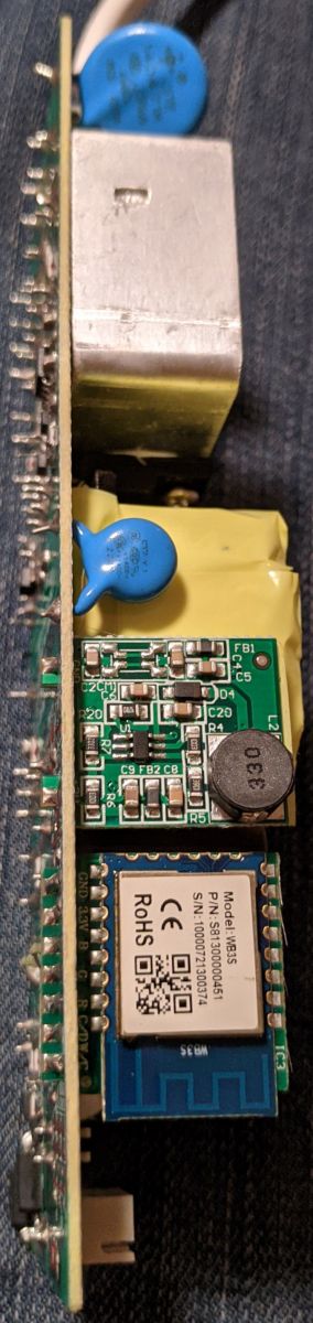

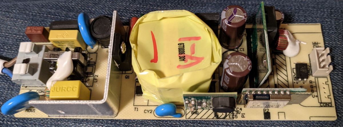

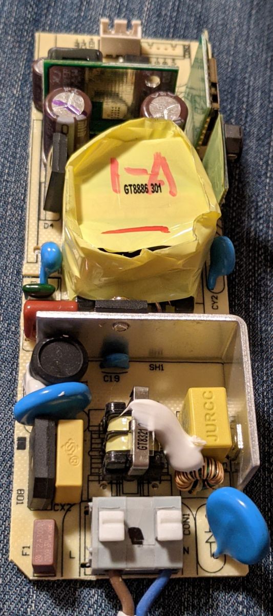

    LEDVANCE LED driver connected to an LED panel. Close-up of the interior of an LED panel showing electronic components and a LEDVANCE label. Close-up of a PCB from an LED panel with electronics and components. Printed circuit board with WB3S module. Electronic board with components and markings Close-up view of an LED module circuit board with component markings. Close-up of an LED printed circuit board with various electronic components and markings. LED module circuit board with various electronic components.

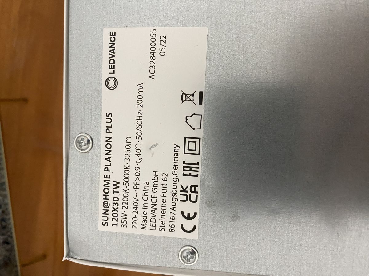

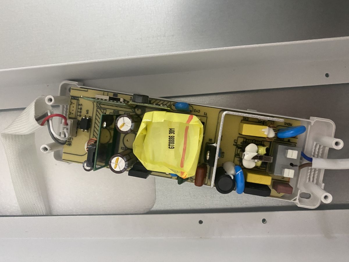

    #7 21395313
    Smartobias
    >>20890740
    i just got the LEDVANCE SUN@Home PLANON PLUS (120x30)
    (Different product line with CRI95 LEDs)
    it seems to use the exact same Driver
    Nameplate of LEDVANCE SUNHome PLANON PLUS with technical specifications.
    LED driver located on the back of an LED panel.
    Close-up of the LED driver inside the LEDVANCE Planon Plus lighting.
    LED driver board inside LEDVANCE SUNHome PLANON PLUS fixture.
