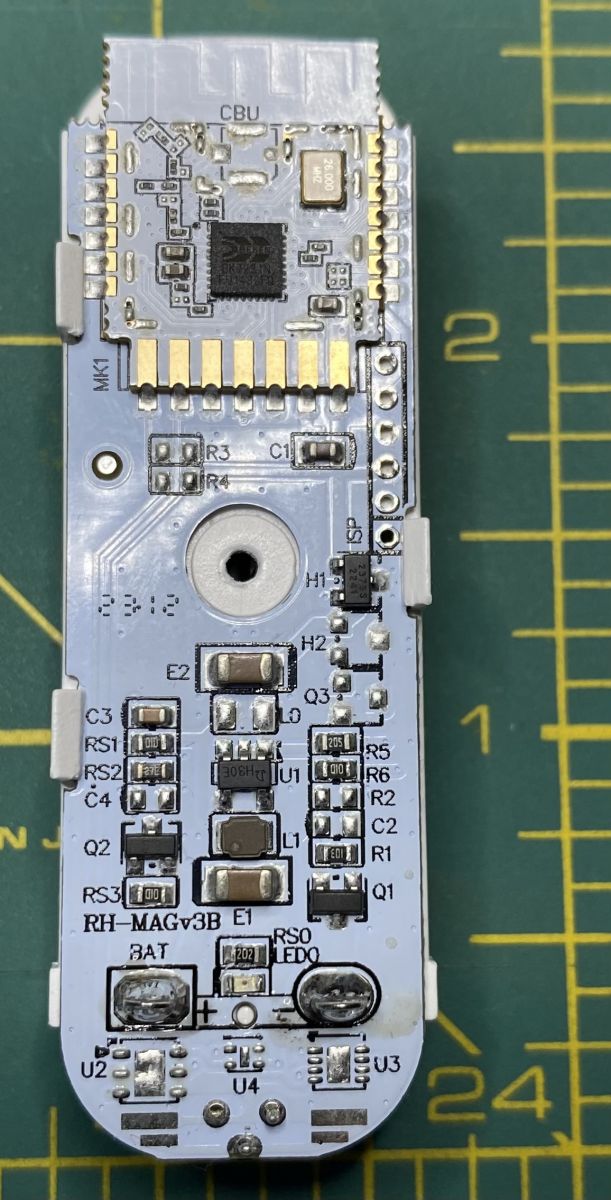

    Need detailed setup for flashing the TUYA-BK7231N/CBU-Wi-Fi-door sensor and Home assistant MQTT setup please. Thank you.
    Flashing and Deep Sleep Setup Guide for TUYA-BK7231N/CBU Wi-Fi Door Sensor with Home Assistant MQTT Flashing and Deep Sleep Setup Guide for TUYA-BK7231N/CBU Wi-Fi Door Sensor with Home Assistant MQTT
    2023-08-06 UPDATE:
    Here is a nice step by step guide for flashing it and deep sleep setup:
    [BK7231N/CBU] Door sensor without TuyaMCU - easy flashing and configuration guide
    NOTE: The following sensor is using BK7231 deep sleep, it has no TuyaMCU.

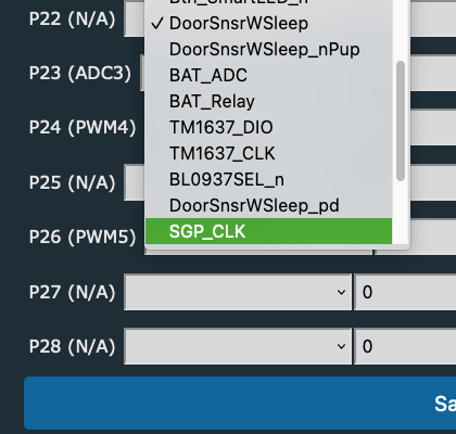

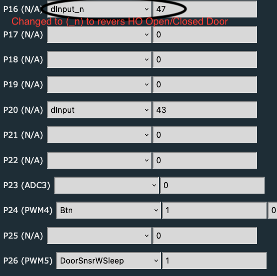

    - mqtt was discovered by HA. door sensor goes sleep but the deep sleep and push button are not working when sensor goes sleep. I have to manually turn it off and on every time it goes to sleep.
    - I do not have deep sleep in the drop down list (attached photo).
    Thank you.

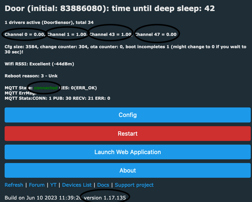

    weblog
    Info:MQTT:Channel has changed! Publishing 1 to channel 43
    Info:MQTT:Publishing val 1 to BK_DS1/43/get retain=0
    Info:MQTT:MQTT client in mqtt_incoming_publish_cb topic BK_DS1/43/get
    Info:MQTT:Channel has changed! Publishing 1 to channel 47
    Info:MQTT:Publishing val 1 to BK_DS1/47/get retain=0
    Info:MQTT:MQTT client in mqtt_incoming_publish_cb topic BK_DS1/47/get
    am going to try the deep sleep and the push button.

    Hello again, if the sensor does not wake up, it can mean that:
    - you have chosen wrong IO for sensor role
    - you have incorrect DSEdge setting (DSEdge 2 is default, there is also DSEdge 1 or DSEdge 0)
    - I do not have deep sleep in the drop down list ( attached photo).
    For which role are you looking for? It seems you have all required roles here. I can see one role for DoorSensor (the PD role, input with PullDown). If you want a pull-up input door sensor role, scroll up, it's a bit earlier on the list.
    Don't forget that if you set a Button role for pairing Button, it will also be able to wake up the device in the time of emergency. That way you can play around with settings and choose the ones that suits you best.

    #6 20612399
    khafif
    Posts: 16
    Flashing and Deep Sleep Setup Guide for TUYA-BK7231N/CBU Wi-Fi Door Sensor with Home Assistant MQTT Flashing and Deep Sleep Setup Guide for TUYA-BK7231N/CBU Wi-Fi Door Sensor with Home Assistant MQTT Flashing and Deep Sleep Setup Guide for TUYA-BK7231N/CBU Wi-Fi Door Sensor with Home Assistant MQTT

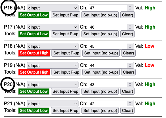

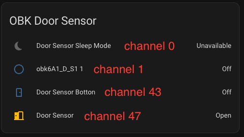

    1- I managed (don't ask how) to get these results.
    2- I cannot remove/find channel 1 in any setup?
    3- I had to use dInput_n to reverse HO sensor action.
    4- Door sensor sleep mode in HO not displaying ON or OFF?
    5- MQTT state not displaying disconnected when in sleep mode?
    6- How can I control the sleep mode duration (to reduce the time frame)?
    7- How to turn OFF LED, it is always on.
    8- Can we blink the LED (in Bright light) when awake mode triggered by Button or Door Sensor?

    DSEdge (the wake up edge of deep sleep, either "opposite of current", "rising" or "falling") and the exact Door Sensor pin type (pull up, no pull up, etc) can change between devices. Please always remember to set the Button role for your button so you can do an emergency wake up of the device if the door sensor GPIO is configured incorrectly.
