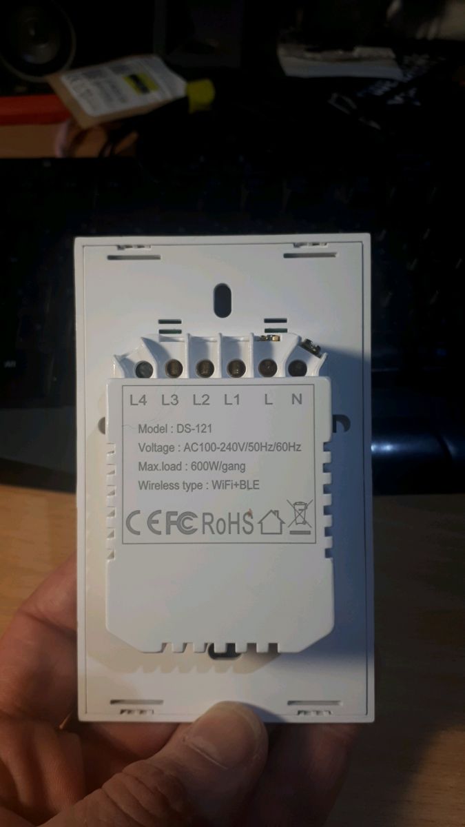

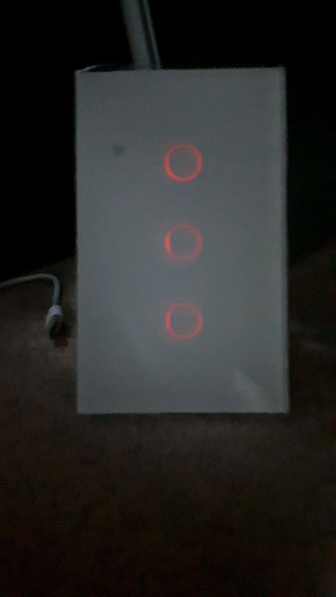

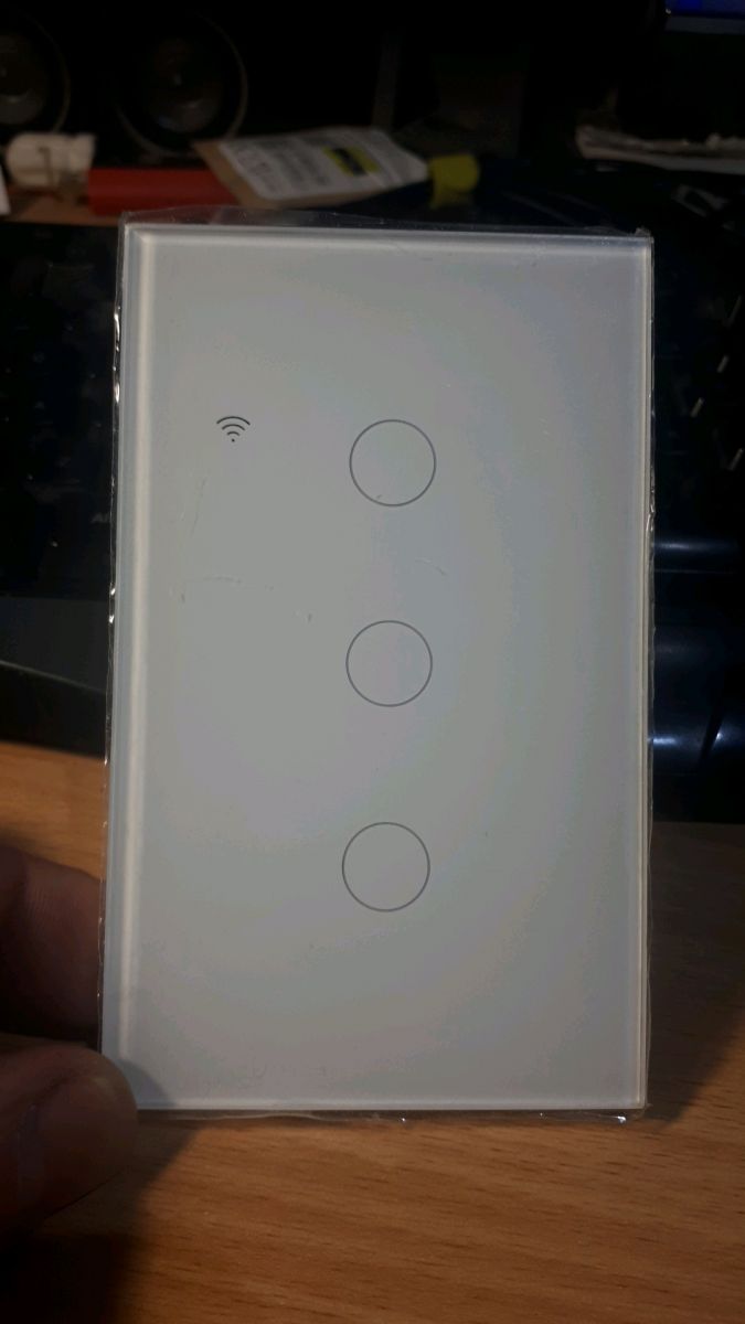

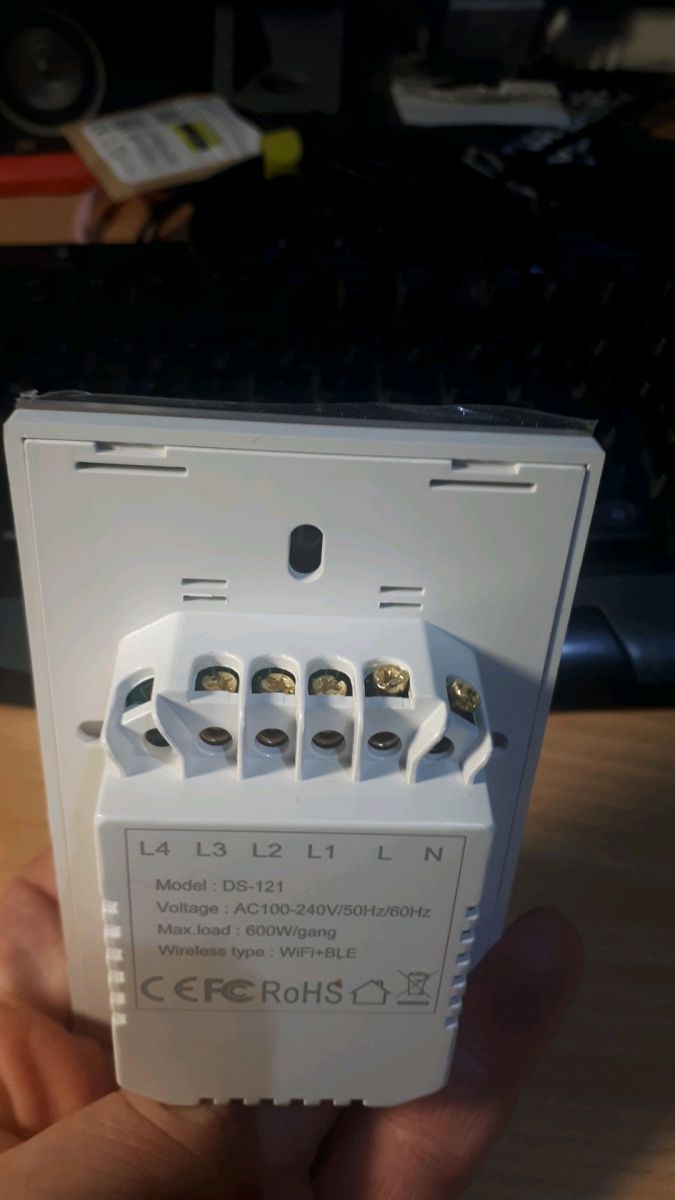

    Bought these from AliExpress for use in Australia.
    Have flashed with the latest OBK firmware and configured as shown.

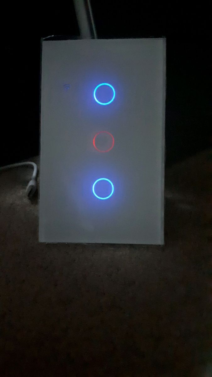

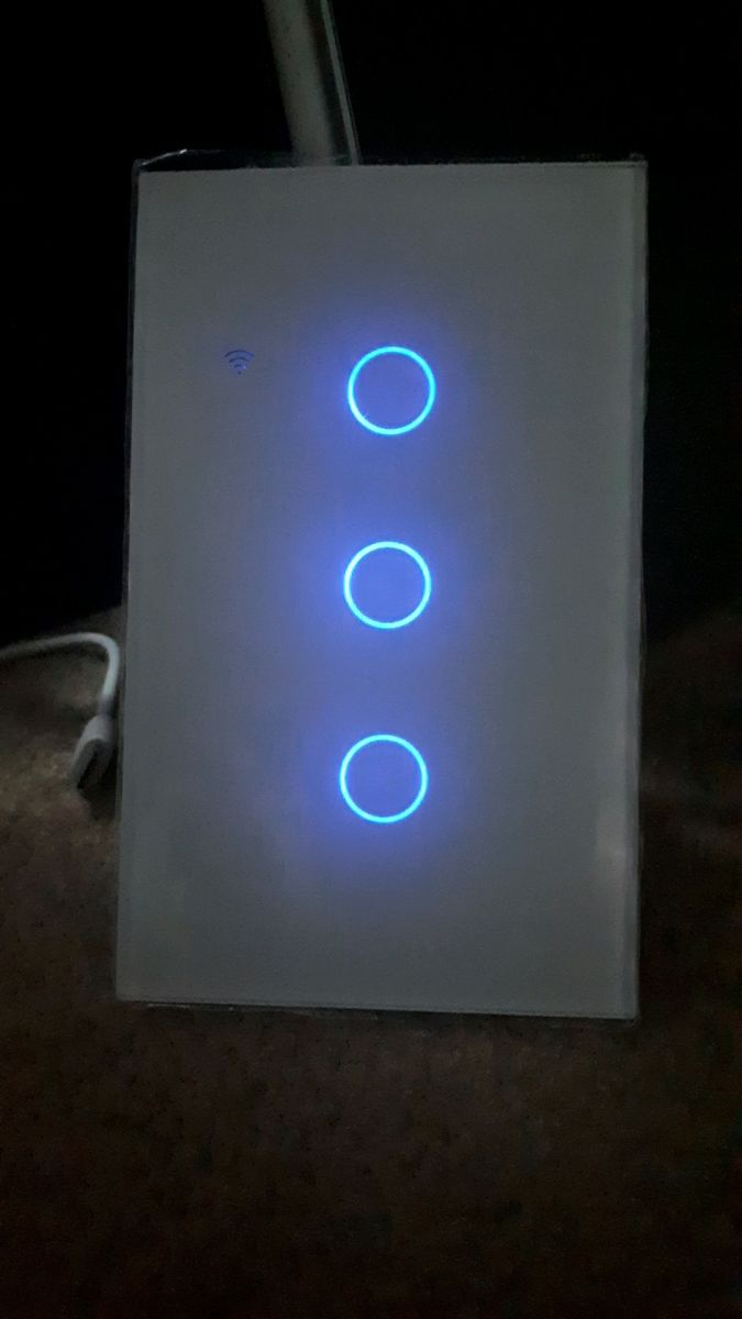

    Switches have a dull red backlight when off which swaps to a blue on indicator.
    Have configured WiFi LED to be off when connected, is a bright blue LED, brighter than the switch indicator lights.

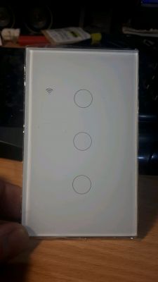

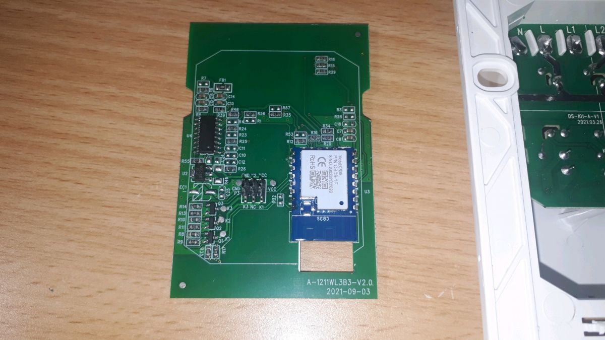

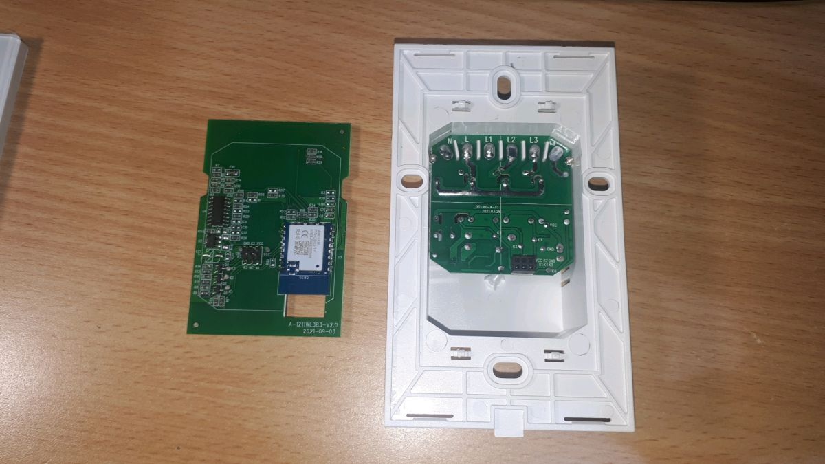

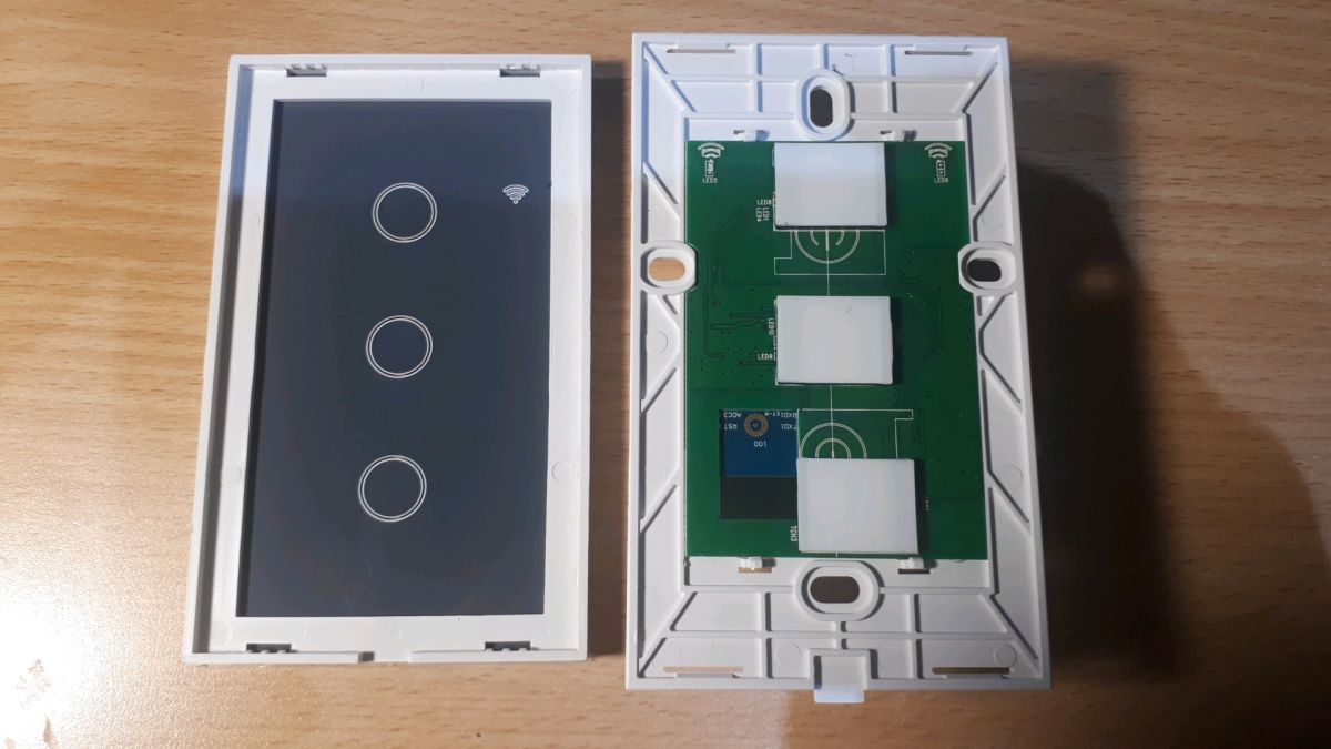

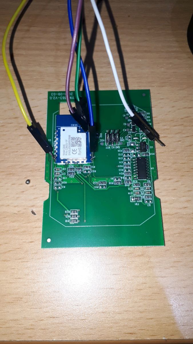

    Clip-on glass front panel that covers the sense board which includes a CB3S.
    [CB3S/BK7231N] Aubess WiFi US Smart Switch 3 Gang Light Switch Need Neutral Wire Tuya Smart Life APP [CB3S/BK7231N] Aubess WiFi US Smart Switch 3 Gang Light Switch Need Neutral Wire Tuya Smart Life APP [CB3S/BK7231N] Aubess WiFi US Smart Switch 3 Gang Light Switch Need Neutral Wire Tuya Smart Life APP

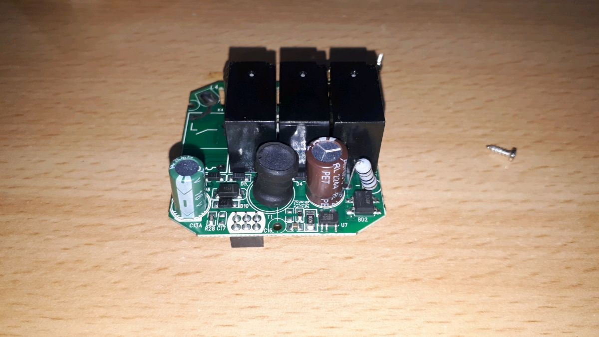

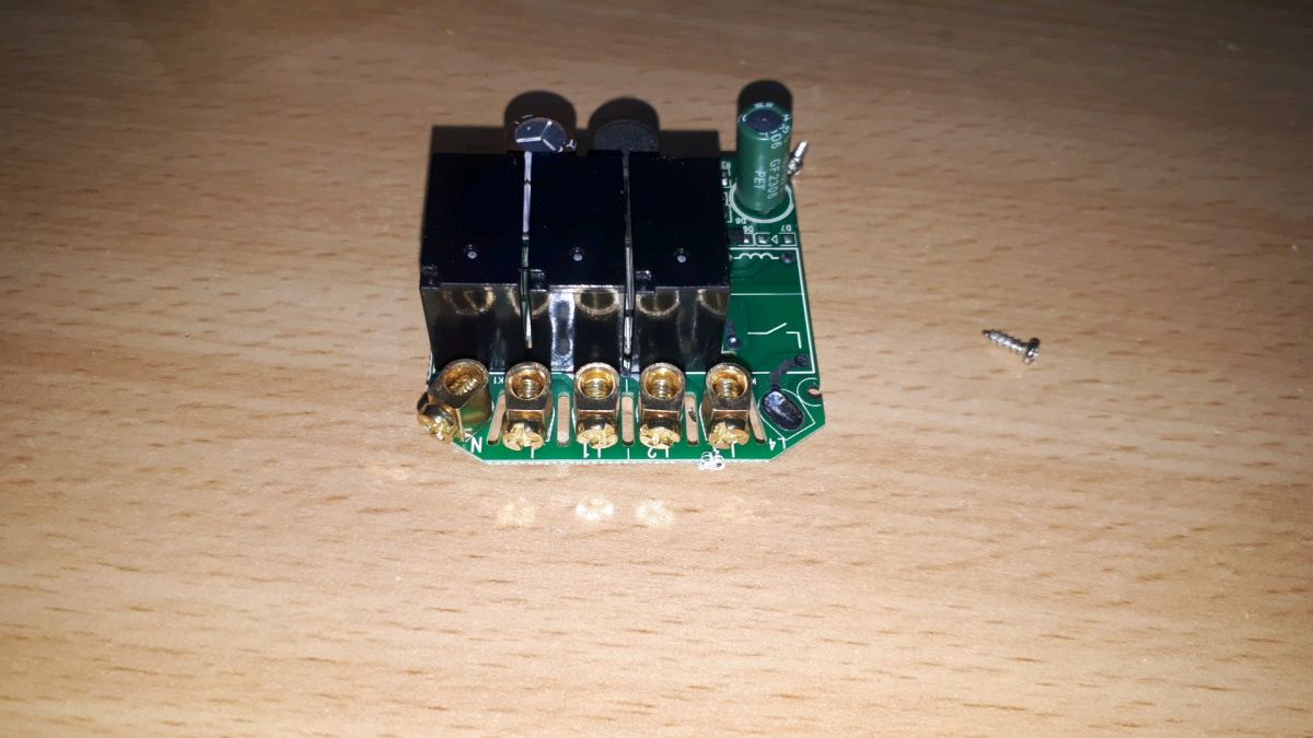

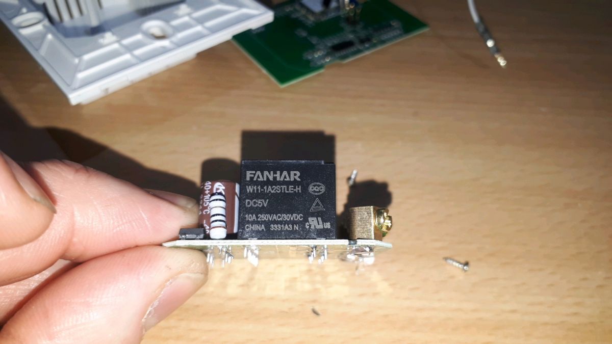

    High voltage is by a second board with the switching relays and power supply for the sense board.
    Reflashed the CB3S in place
    Configured as below;
