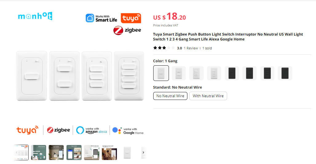

  • I've bought a wall switch from Manhot Store in aliexpress with 4 "clicky" buttons.
    AliExpress link: https://www.aliexpress.com/item/1005005901971631.html
    Four white wall switches with varying numbers of buttons are shown on an online store page.
    Manhot Store's BK7231N / CB3S Tuya Smart 4 Gang Switch: WiFi not Zigbee, CB3S Chip Inside

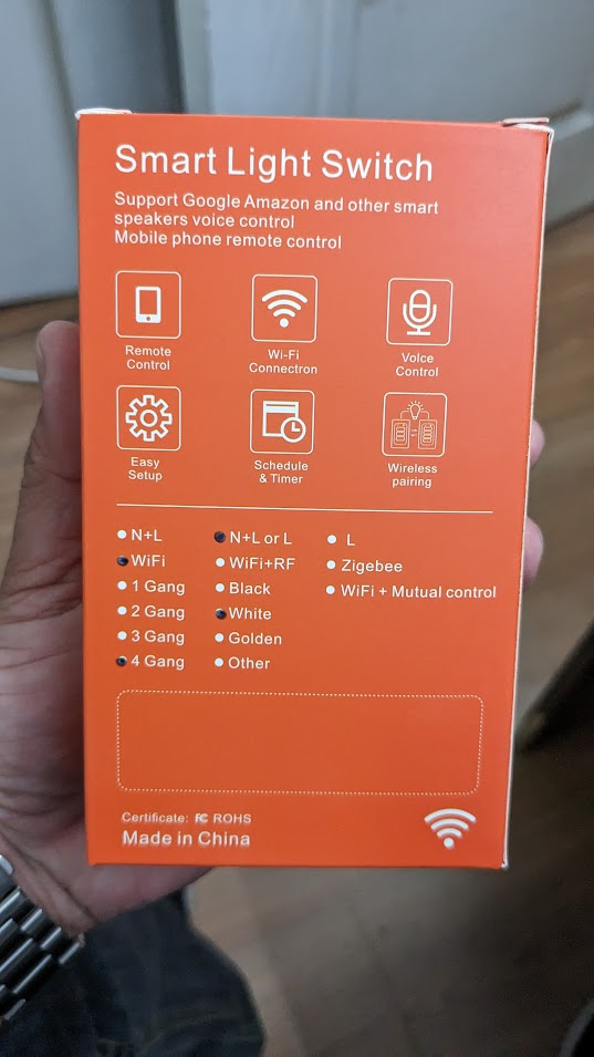

    The device is listed as a Zigbee Smart switch, but it's actually a WiFi switch!! with a CB3S chip inside.

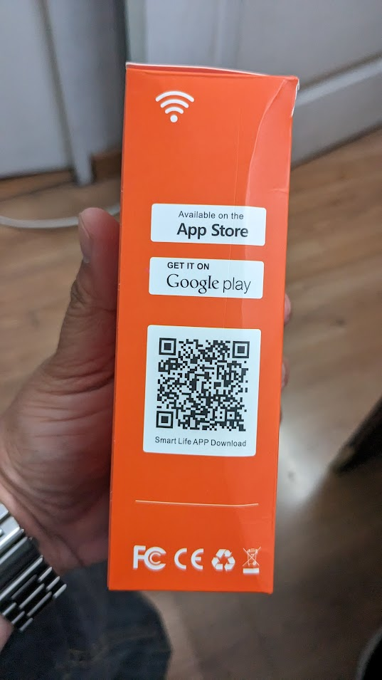

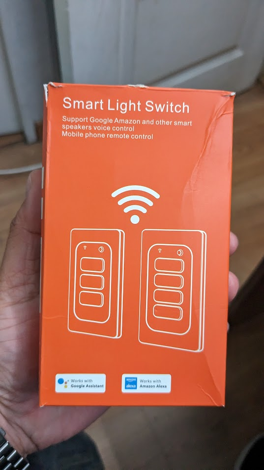

    Smart wall switch packaging with Wi-Fi and Zigbee features. Cardboard packaging of a Smart Light Switch with compatibility information for Google Assistant and Amazon Alexa printed on it. Orange box with a QR code and information about app availability on the App Store and Google Play.

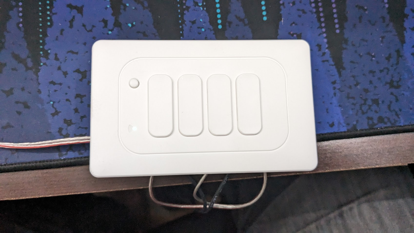

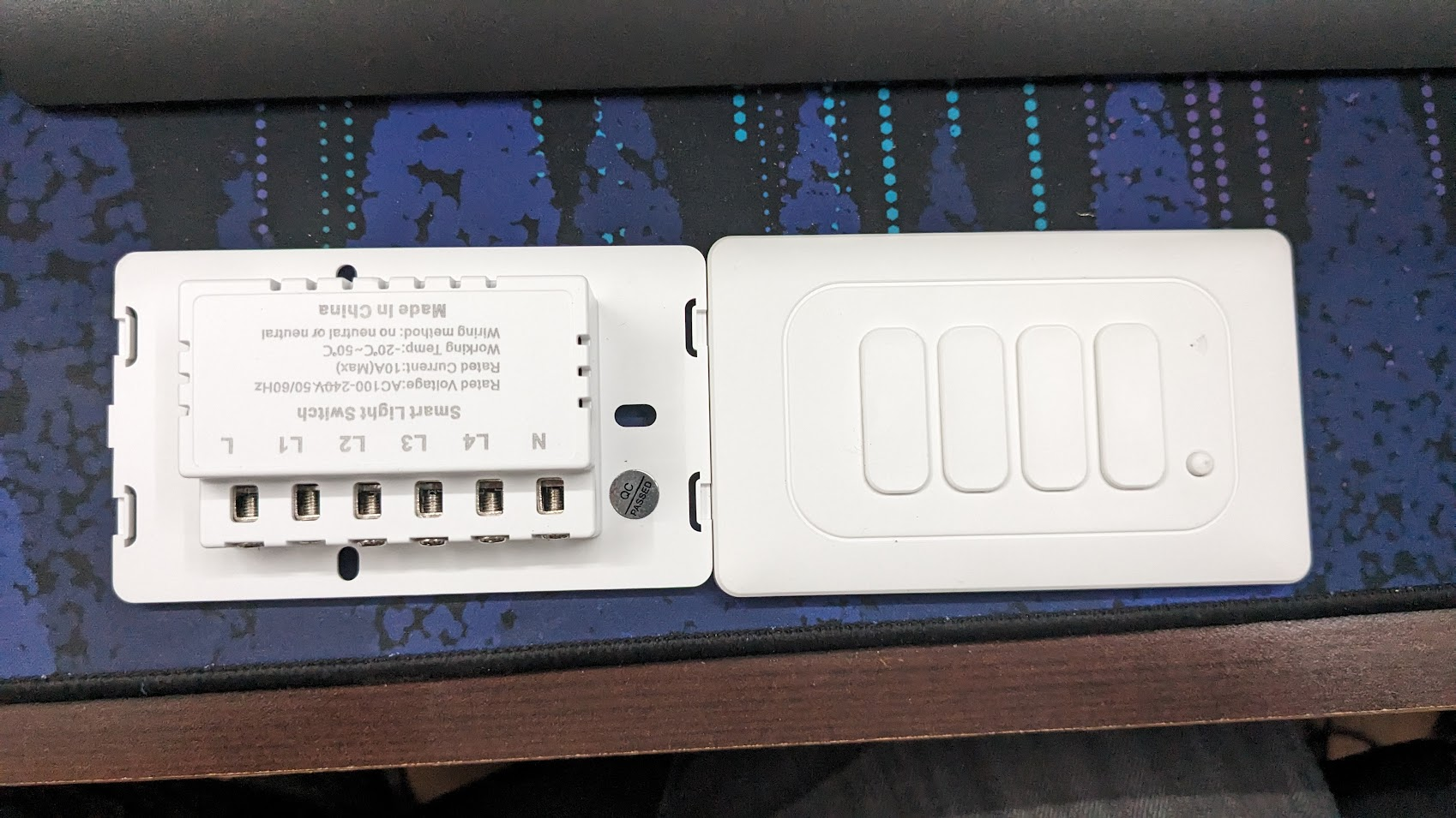

    White wall switch with four buttons and an LED indicator.

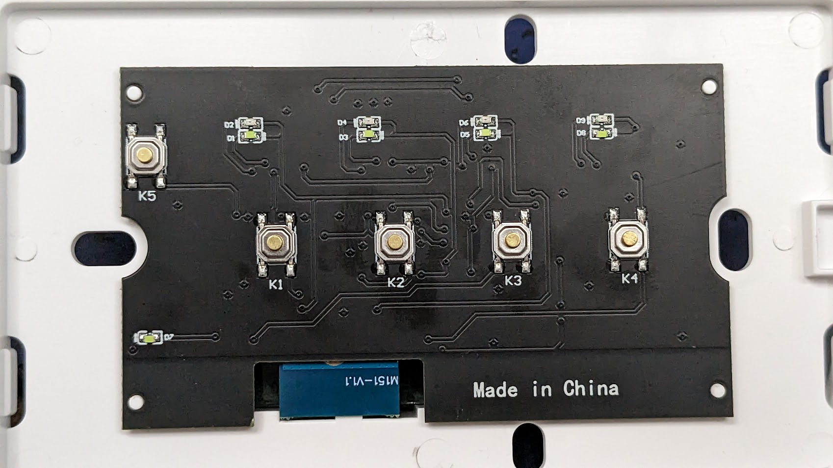

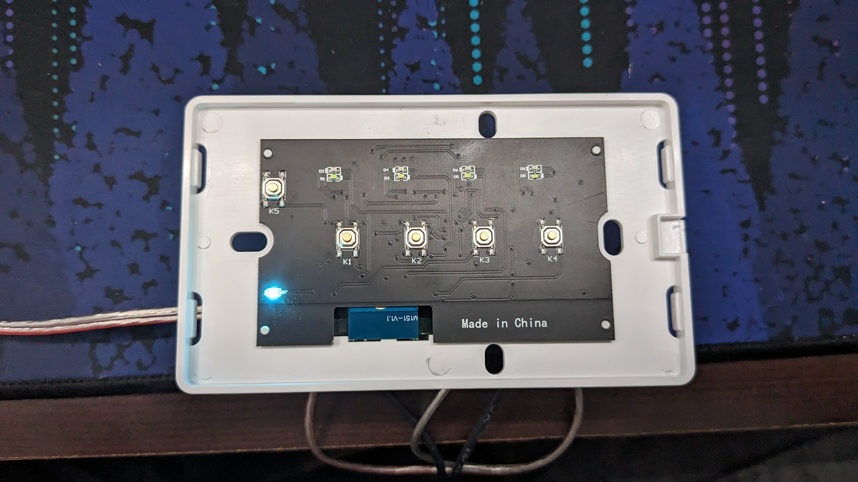

    Wall switch with four buttons and visible electrical connections. Interior view of a wall switch housing with five buttons and LEDs on a circuit board.

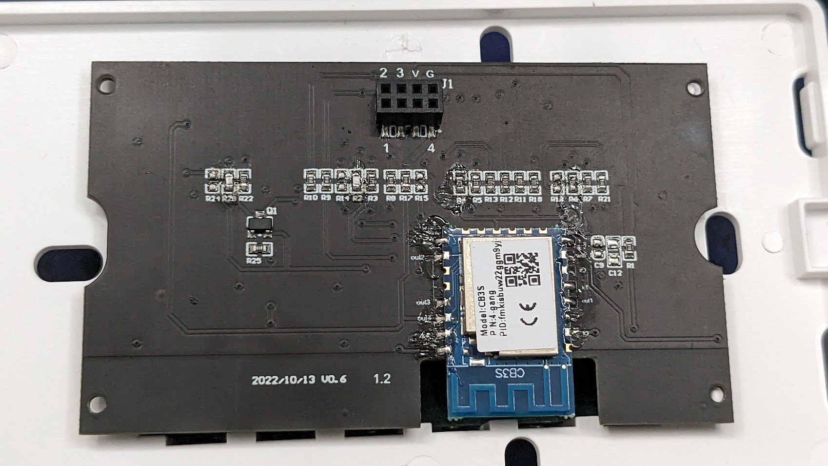

    Circuit board with visible buttons and Made in China labeling. Wall switch module with CB3S chip on a printed circuit board. CB3S module on a circuit board with visible traces and components.
    Regarding functionality, when a button is pressed, the corresponding relay is triggered.
    The button has a light that shows whether the relay is open or closed - it will show up as orange when the relay is ON and blue when the relay is OFF.

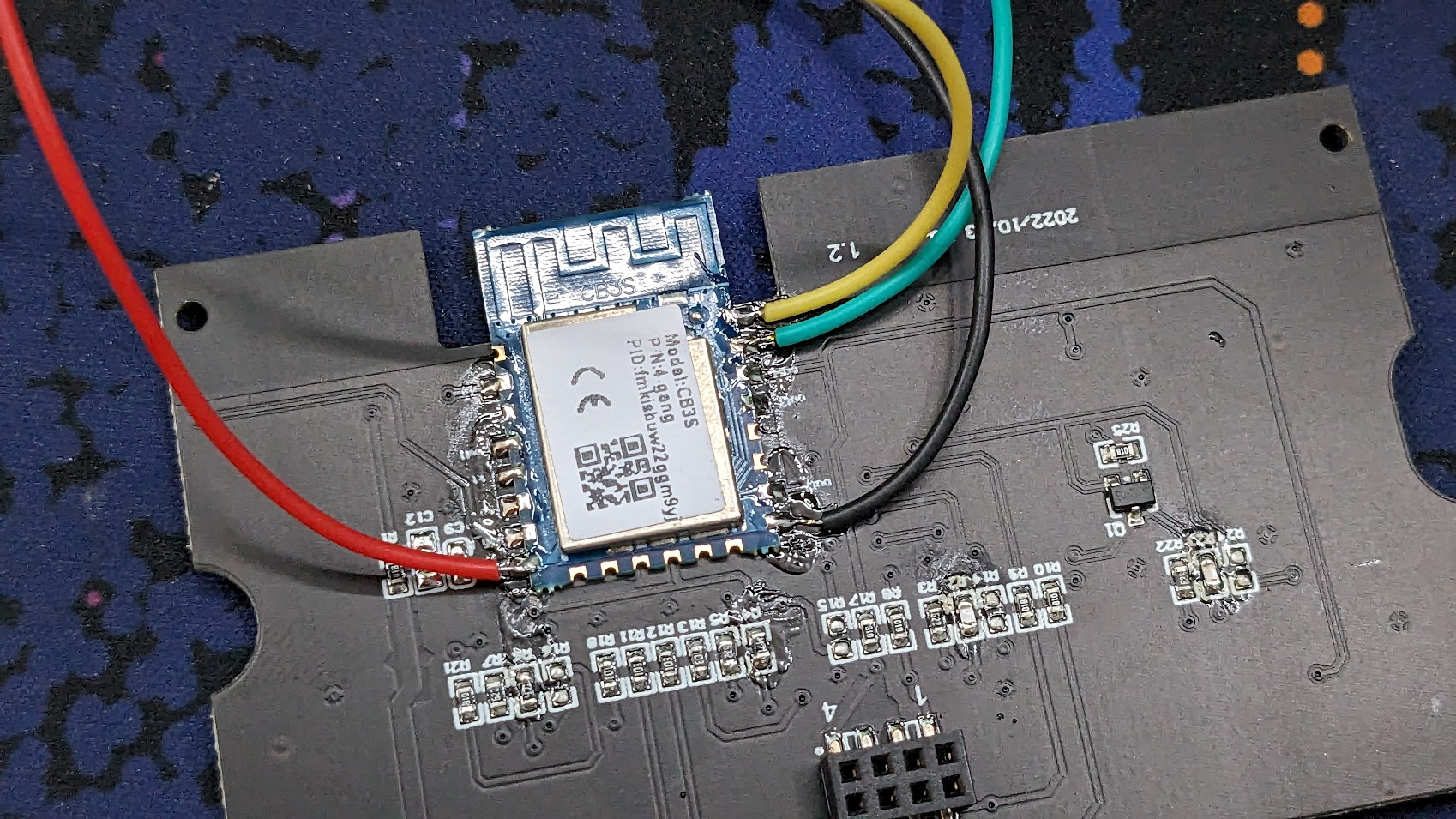

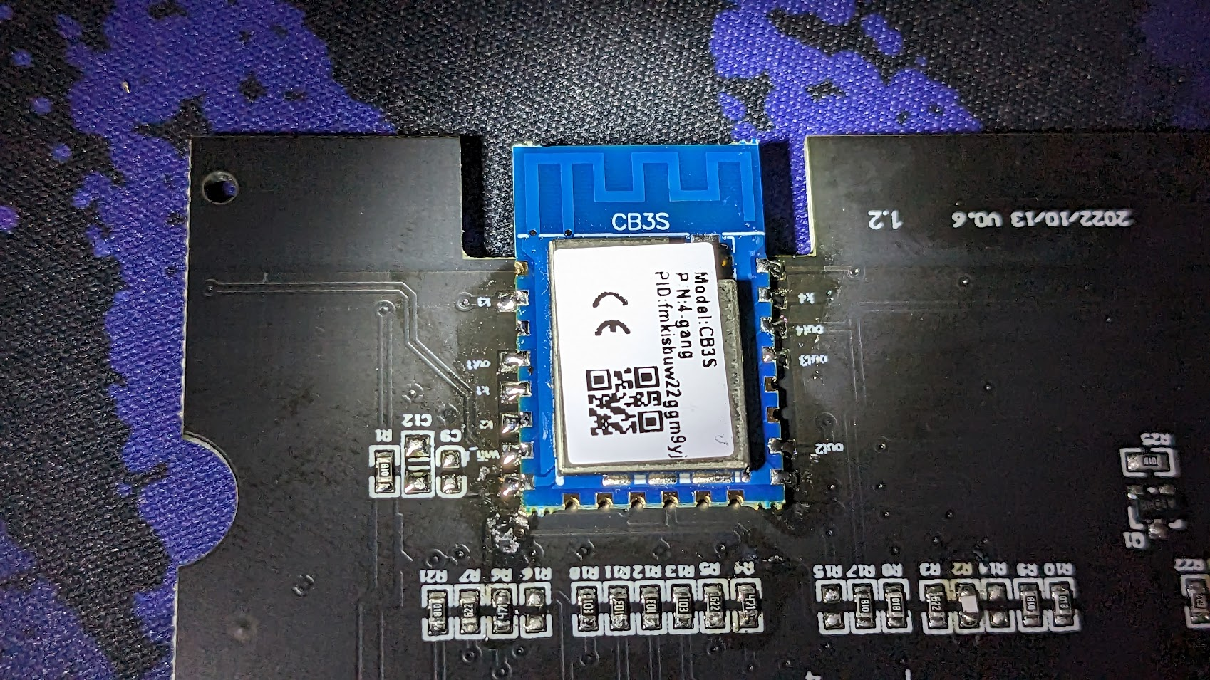

    The device is powered by a CB3S chip, although not all of its pins are soldered on the PCB. Upon checking the datasheet for the MCU, we can determine the required pins to flash the device:
    Datasheet: https://developer.tuya.com/en/docs/iot/cb3s?id=Kai94mec0s076

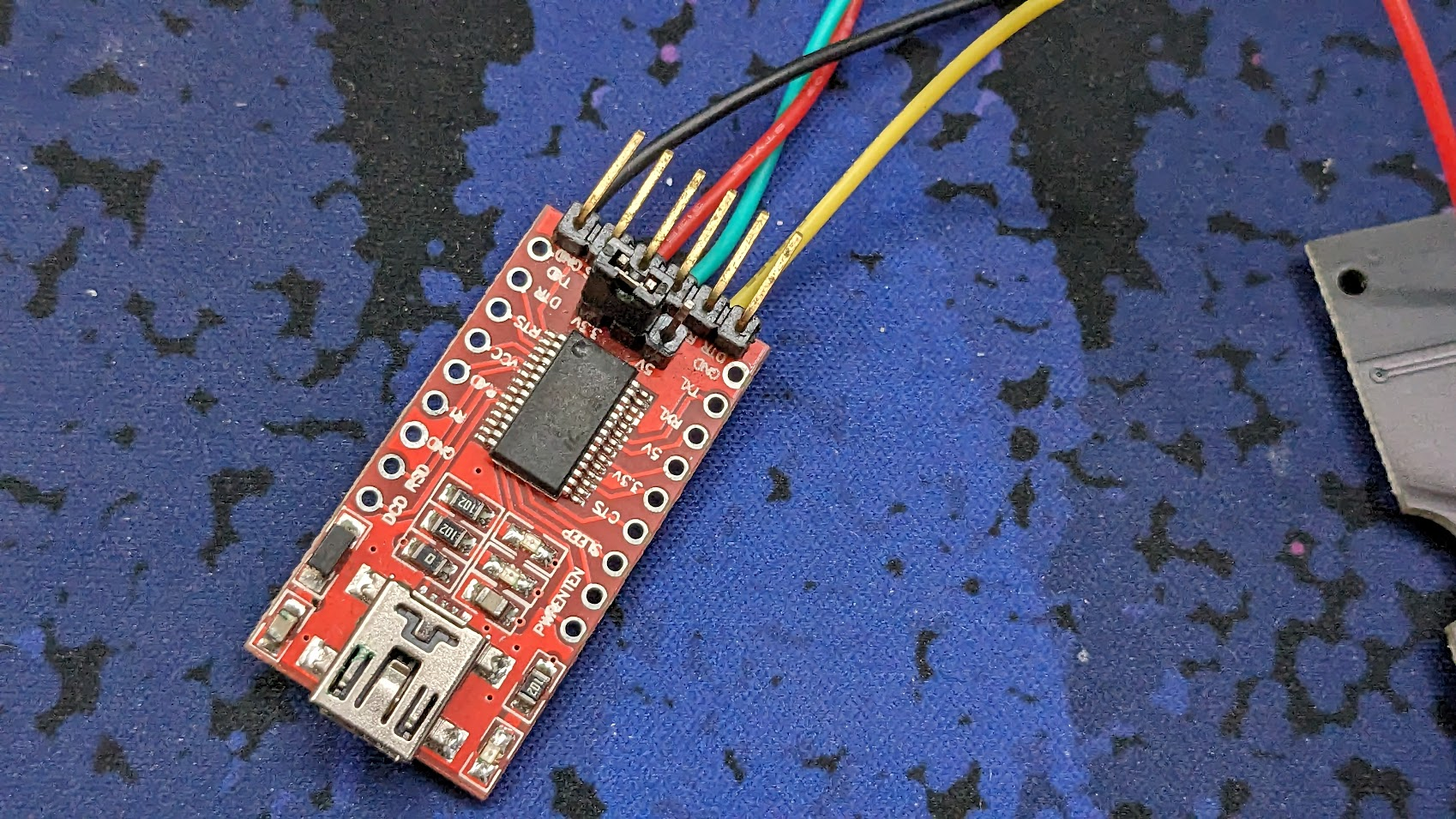

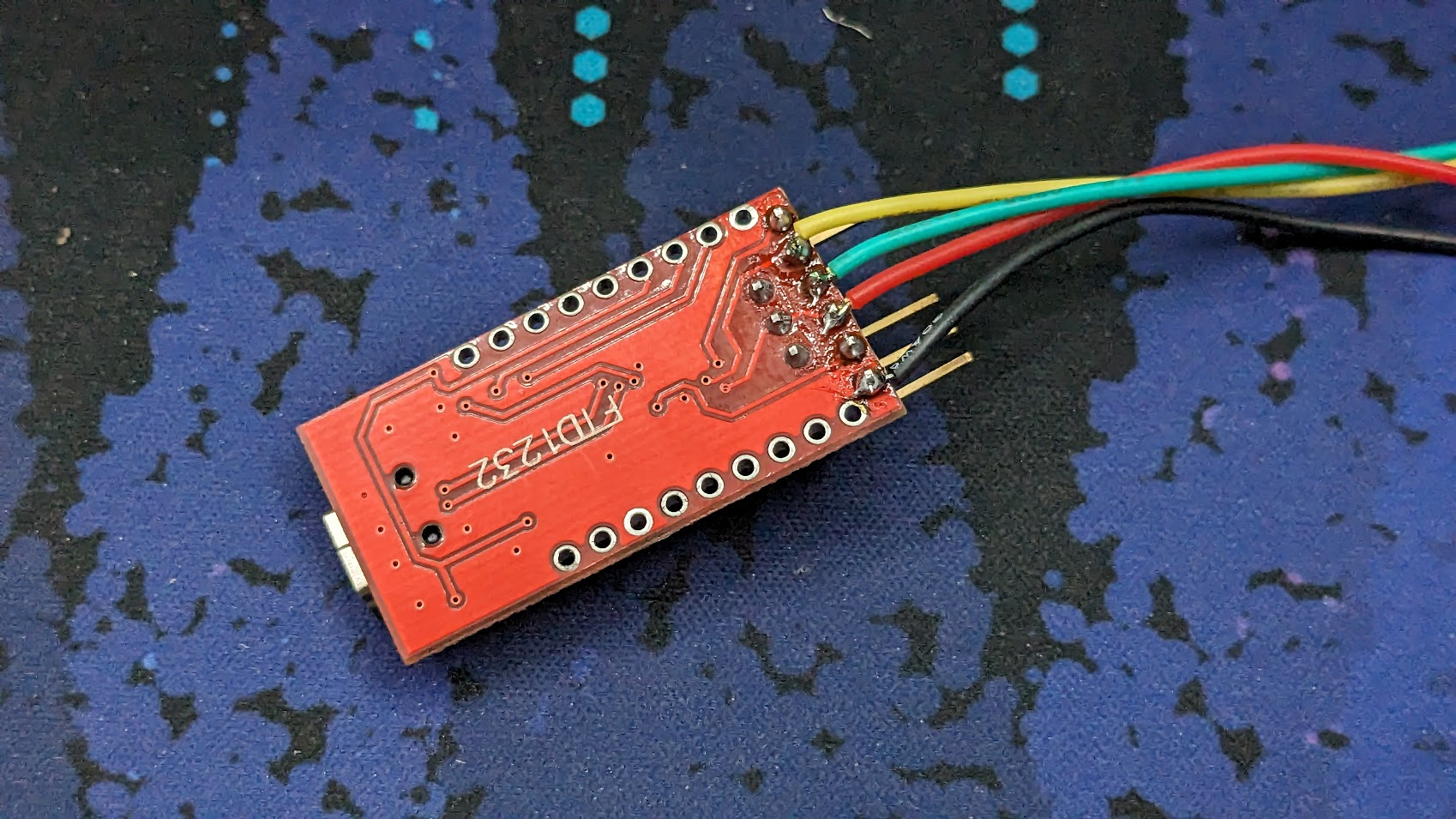

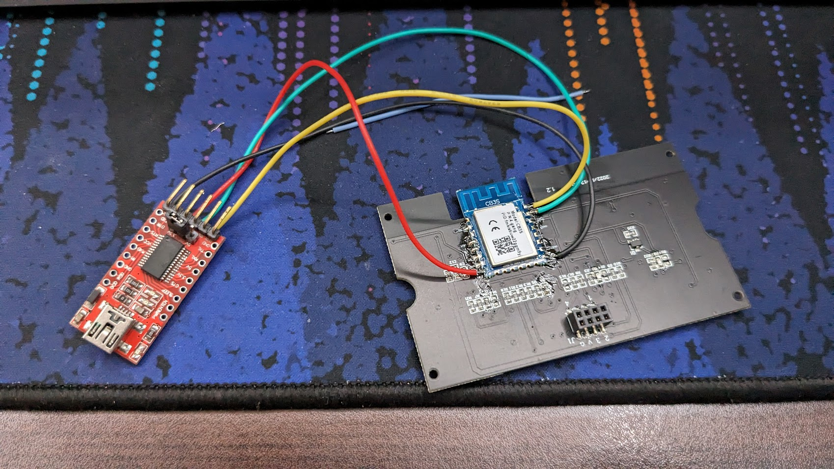

    Soldered a small wire to the CEN pin to put the device into bootloader mode in order to flash a new firmware.
    Pin Name Pin Number
    CEN 3
    VCC 8
    GND 9
    RX1 15
    TX1 16
    Circuit board with a CB3S module connected by wires to an adapter on a computer mat background.
    Close-up of a CB3S module on a circuit board with connected wires. Electronic module with connected wires on a blue background. Back view of a red circuit board with soldered wires.

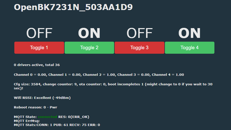

    I was able to flash OpenBK using the new BK7231GuiFlashTool and the OpenBK7231N_QIO_1.17.308.bin firmware under windows, but no luck using the flash tool under linux (ubuntu).

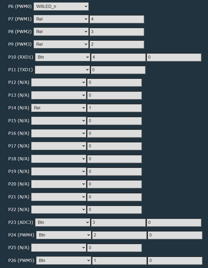

    This is the actual OpenBK pin configuration of the module.
    PinTypeChannel
    P6WifiLED_n-
    P7Relay4
    P8Relay3
    P9Relay2
    P10Button4
    P14Relay1
    P23Button3
    P24Button2
    P26Button1
    Now only the orange led turn on when the relay is on, but the blue light doesn't work. it's fine...
    Screenshot of the OpenBK7231N interface with toggle switch buttons.
    Screenshot of OpenBK module pin configuration for a Wi-Fi switch.

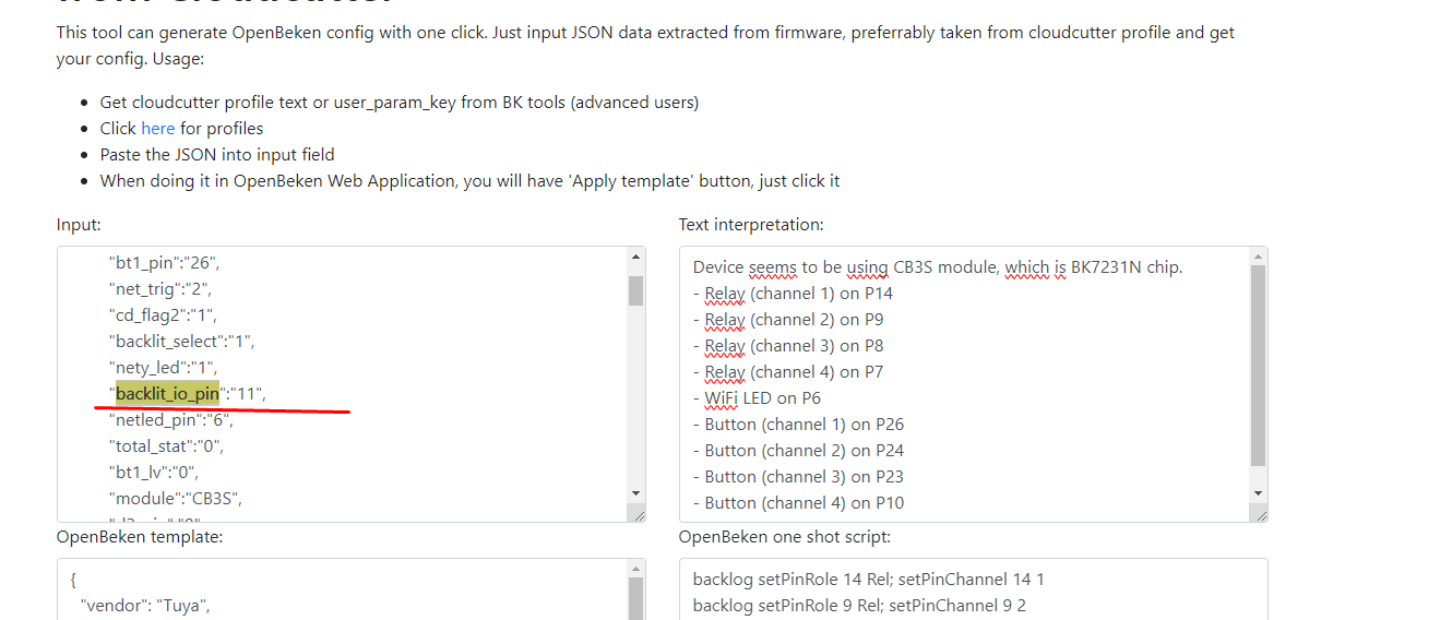

  • Pin 11 controls blue and orange LEDs
    #3 20843825
    celulari
    Hi!
    Playing a bit with the GPIO finder i've dicovered that PIN 11 controls the BLUE LEDS. Selecting "LED" for pin 11 turns on the blue LEDs when the relay is off. when the relay is on, le blue leds are off and the orange ones are on. Selecting "LED_n" on pin 11 the BLUE LEDs are off al lthe time, the orange ones only turn on when the relay is on. Is better that way so it doesn't looks like a christmas tree :)

  • #4 20843872
    Posts: 14791
    Rate: 12937
    That's interesting and very useful. By the way, If you want a permanent setting, you can change LED_n to AlwaysHigh or AlwaysAll.
  • LED_n can be set to AlwaysHigh or AlwaysAll

    Whoa, very good question! It seems that we've missed one pin:
    Screenshot showing OpenBeken configuration tool with highlighted backlit_io_pin element.
    It seems I need to add backlit_io_pin to our flasher soon.
    yes. I have a Tuya device with 3 LEDs and this in the keys.
    "backlit_io_pin": 23
  • #13 21310971
    Posts: 14791
    Rate: 12937
  • #14 21310982
    Posts: 5232
    Help: 449
    Rate: 918
    ah yes. a few commits not in June 5th build it seems
  • #15 21317010
    Posts: 5232
    Help: 449
    Rate: 918
    Screenshot of Tuya device configuration with highlighted elements.
    Device configuration with OneWire IO marked on P26.
    cool
    I've rather presumptuously given it a version of 1.3.4
