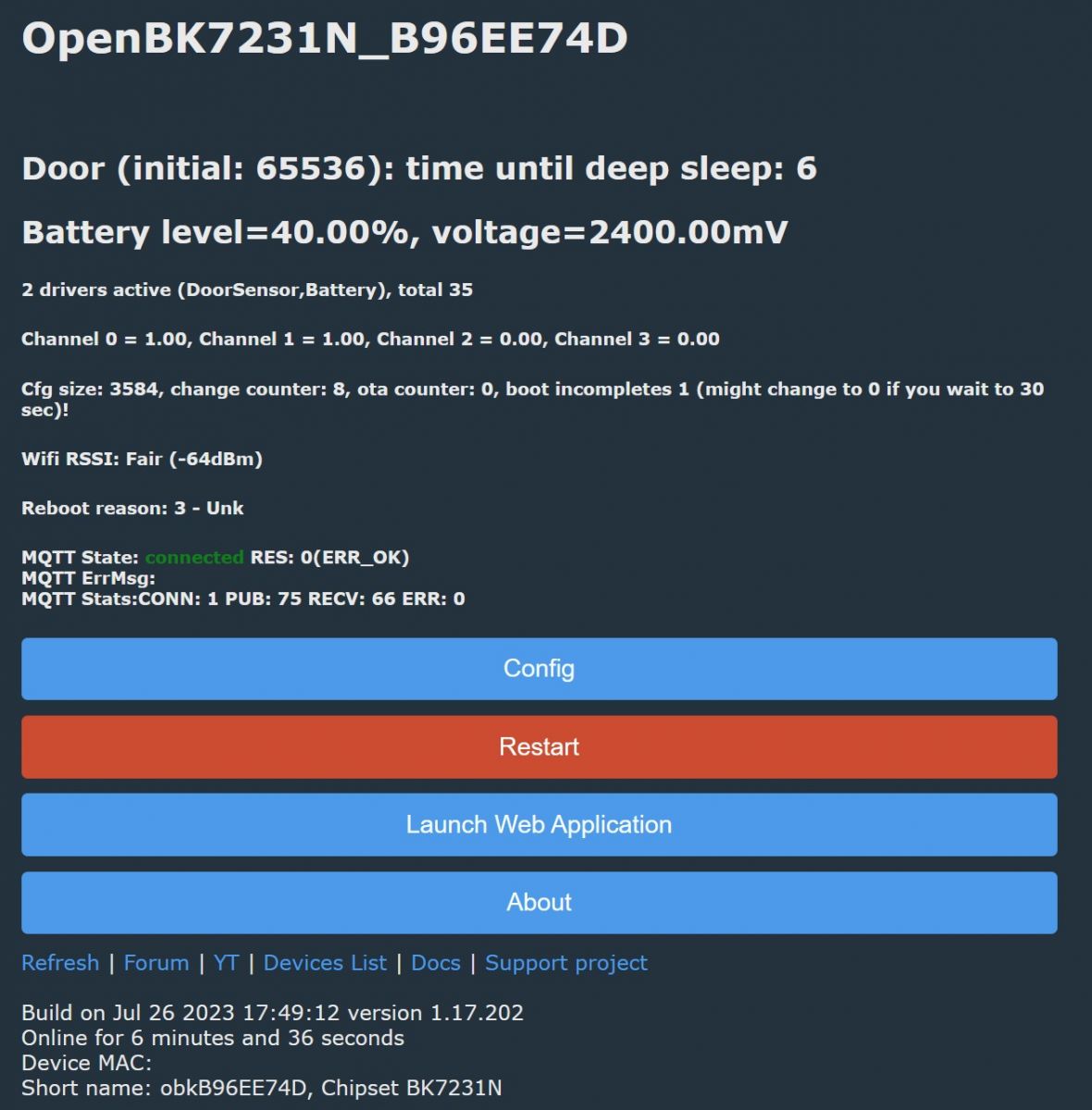

    After reboot we will see:
    Door/window sensor without TuyaMCU - deep sleep and energy saving, OpenBeken
    The sensor will "go to sleep" after this time:
    Door: time until deep sleep: 11
    Changing the door state resets this time, the countdown starts again.
    The sensor can wake up both the change of the door status and pressing the button.
    Starting an OTA (WiFi update) also blocks sleep.
    Lack of connection with MQTT also blocks sleep, but only for 300 seconds (the value will be changed in the configuration):
    The delay is to ensure that the sensor has time to report its status to the MQTT before bedtime.

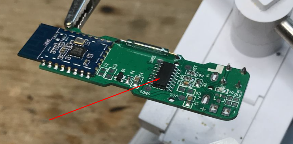

    Such a sensor is characterized by the presence of the MCU on the PCB:
    In his case, the TuyaMCU (microcontroller) handles the power supply of the WiFi module and the WiFi module is completely turned off through the transistor. He cuts off his power. This is different than the sensor from the topic. Here we see two different Tuya approaches to saving energy. One uses low power MCU and the other uses deep sleep on the WiFi module itself.
    Both approaches are supported by OpenBeken.

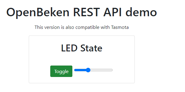

    These cm?cmnd even allows you to make your own REST page to control e.g. LED:
    Code: HTML, XML
    I remember about IP, although I don't know if it will significantly help the battery in the current version. It will definitely increase the reaction rate of HA, which is also a plus.

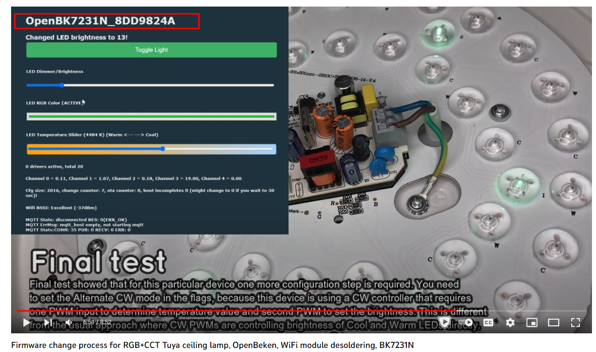

  • Overwritten RF partition caused zero MAC and weaker WiFi
    #23 20467352
    Posts: 14810
    Rate: 12977
    Wait a minute... @miroww1, how does a MAC end up with three null bytes? And the name of the device is all zeros (it comes from MAC)?
    This definitely proves that you clicked something wrong at the flashing stage (e.g. you tried to upload QIO to the offset behind the bootloader) and overwrote the RF partition, losing RF calibration at the same time, i.e. worsening the range of the device.
    I don't know exactly how it happened (it could also be different - as a result of playing with LittleFS and trying to format it to a larger size), but it definitely happened. I flash devices often and I never clean the RF partition by itself.
    At the moment you have two options.
    - or restore the original batch and then reload normally OBK without doing Erase All / without destroying the RF partition
    - or in our Launch Web Application, use the Restore RF partition button from the Flash tab, but it gives placeholder calibration data because we haven't figured out how to do the calibration fully correctly yet
    Your device is still fully functional, but may have poorer WiFi range than factory calibrated.
    See our video about the lamp:
    There we program with my flasher and after uploading there is a normal MAC (and a normal MAC-based device name), not 00 00 00:
    Added after 50 [seconds]:
    EDIT: for clarity , the RF partition is a bit further down the end of the OBK binary, so normal flashing doesn't overwrite it.

    #29 20670786
    taggbricka
    Posts: 48
    I have managed to get my copy of this device working. It was easy, this thread is accurate.
    Program version: 1.17.202
    Static IP.
    Excerpt from TUYA Config
    	"bt_pin":"20",
    	"status_led_pin":"26",
    	"rstcnt":"3",
    	"basic_pin_pin":"16",
    	"module":"CBU",
    	"jv":"1.0.5",
    	"bt_lv":"0",
    	"net_t":"180",
    	"samp_type":"1",
    	"basic_st":"1",
    	"basic_pin_lv":"1",
    	"samp_sw_pin":"17",
    	"max_V":"3000",
    	"min_V":"2200",
    	"samp_sw_lv":"1",
    	"status_led_lv":"1",
    	"samp_pin":"23",
    Two details remain:
    1.) After a button press or magswitch application this device wakes up, sends about 50 to 100 MQTT "get" messages before deep sleeping after 60 seconds.
    I expected only 1 "get" message.
    Can I change the deep sleep delay?
    2.) BAT_ADC on pin 23 reports very correctly below 2400 mV, anything above 2.4V reports as 2400mV
    The voltage on CBU pin 5 (ADC) is the battery voltage exactly, not hardware limited to 2.4V.
    Tested 2.0V to 3.3V from a lab power supply.
  • Check battery relay pin and DSTime deep sleep delay
    #30 20671018
    Posts: 14810
    Rate: 12977
    Hello, the Deep Sleep delay can be configured with this command:
    DSTime [timeInSec]
    See commands doc:
    Are you sure that you've got battery driver configured correctly? Do you have battery relay pin set? This pin is enabling correct voltage divider, but only for the time of measurement. So if you tested with multimeter with that divider deactivated, you will get incorrect results.
