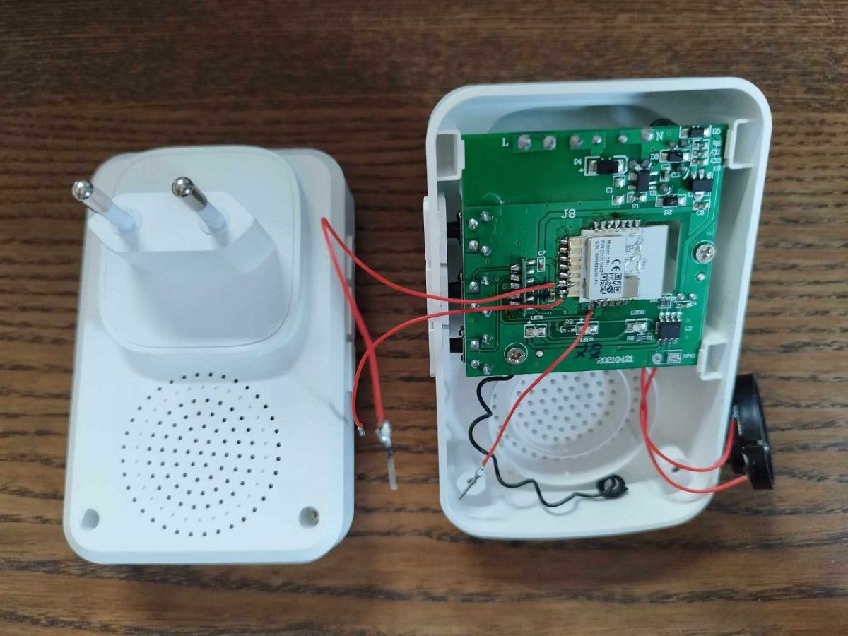

    I purchased two wireless Tuya-based doorbells from Aliexpress (WGH-ML-001). I knew it has a Tuya CBU module (see pictures).
    WGH-ML-001 Tuya Wireless Doorbell: Flashing OpenBeken, Adjusting Volume & Ringtone

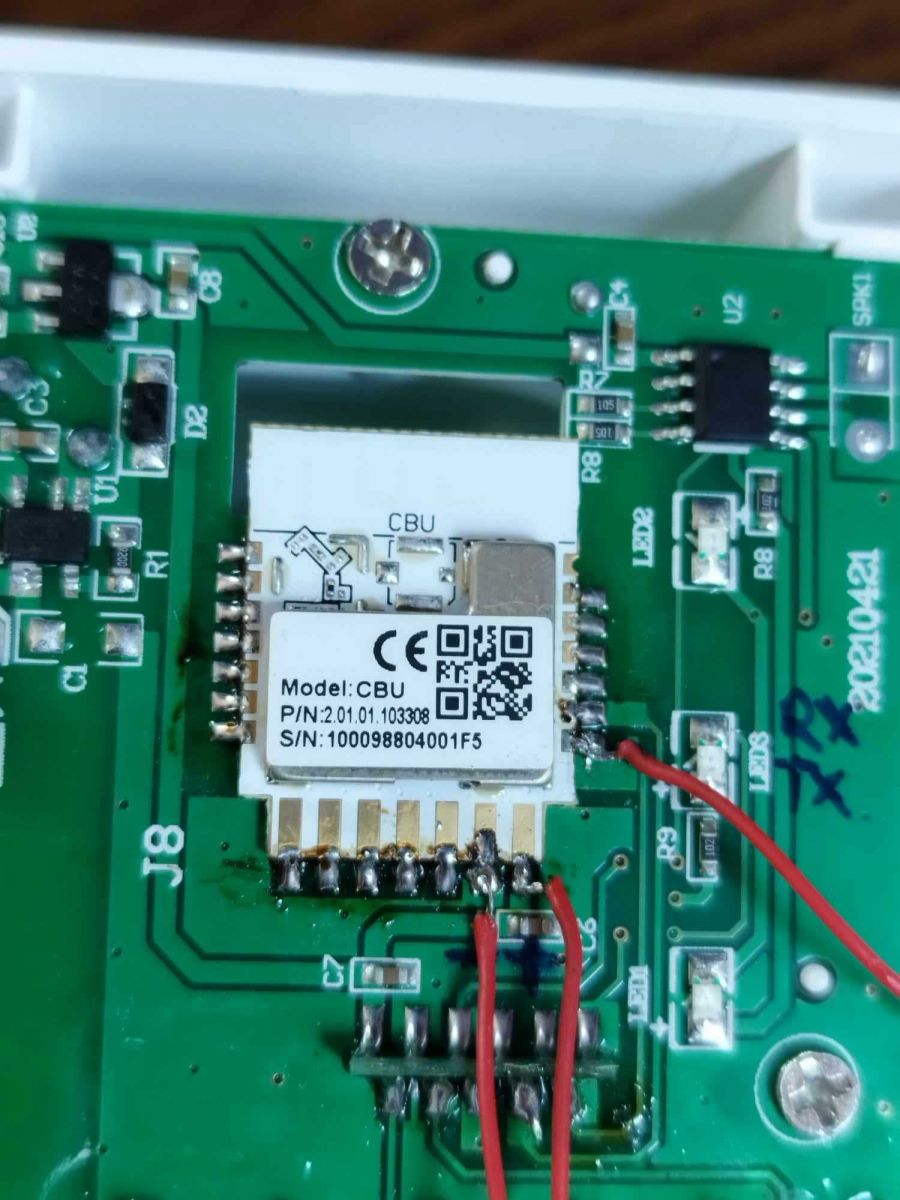

    I flashed OpenBeken to one of the devices, after sniffed the UART communication.
    To flash the image, I had to remove the module, because the TuyaMCU littered the TX/RX lines. I attached the original firmware to my post.

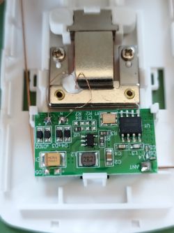

  • Batteryless self-powered doorbell transmitter observed
    #5 20635148
    Porkoltszaft
    Posts: 7
    Hi!
    The transmitter (doorbell button) has no battery. It self-powers when you press the button (it has a nice click to it. I think it pushes a magnet through coils and this powers the circuit). The AliExpress listing claimed it has an IP44 rating, but I doubt this... It's definitely not protected against moisture so I don't know how much it will last outdoors.

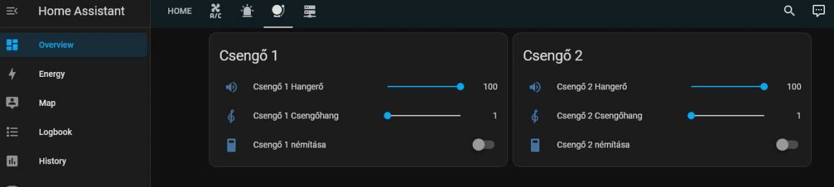

  • Home Assistant sliders control OpenBeken over MQTT
    #9 20644304
    Porkoltszaft
    Posts: 7
    Thank you very much, you always learn new things! I did not know you can make custom HTML pages hosted on these things. This is great!
    I also got it to work with Home Assistant, so the custom page might not be necessary, but I will experiment with that too.
    I created 4 input number helpers (2 for volume, 2 for ringtone since I have 2 receiver units). This way I can set different volumes and ringtones for each area. Also, HA allows me to set the slider min/max values.
    Then I created automations for each slider and send their values over MQTT to OpenBeken, like this:
    trigger:
      - platform: state
        entity_id: input_number.csengo_2_csengohang
      condition: []
      action:
      - service: mqtt.publish
        data:
          topic: wificsengok_2/2/set
          payload: '{{ states(''input_number.csengo_2_csengohang'') | int }}'
      mode: single
    I'm very happy to - with your help and work - achieve a cloudless solution. Thank you for developing this great firmware.
