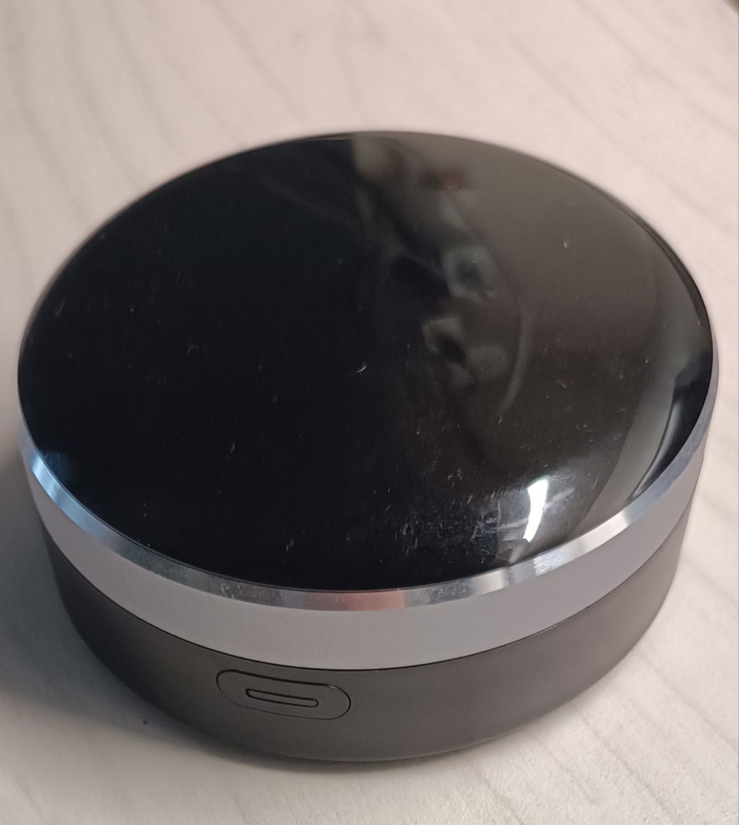

    Hello, I`ve had this remote for a long time and decided to flash it to work with HA, unfortunately I haven`t found it in device list, so I had to manually find GPIOs and decided to add config in case anyone have one. By the way, bought one from here
    Black, oval remote control with aluminum trim and a side button. Box of Smart Universal IR Remote Controller with Tuya logo. Label of CS-SSRC-IRC remote packaging with technical details.
    The device have IR and RF, but you can`t use RF, it`s unsupported in the flash
    It`s pretty easy to open, it has 4 screws on the bottom, but be careful - plastic is of poor quality

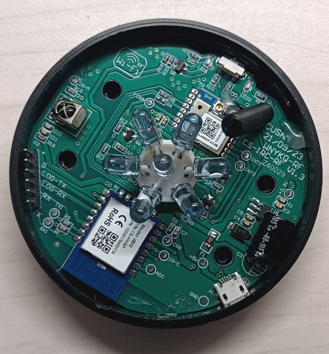

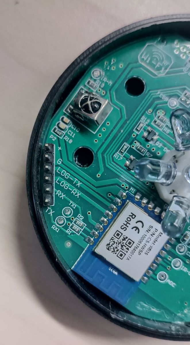

    There are 6 labeled holes, you can solder in pins:
    Close-up of a circuit board of IR+RF remote with labeled pins.Interior of an electronic device with visible wiring and components.

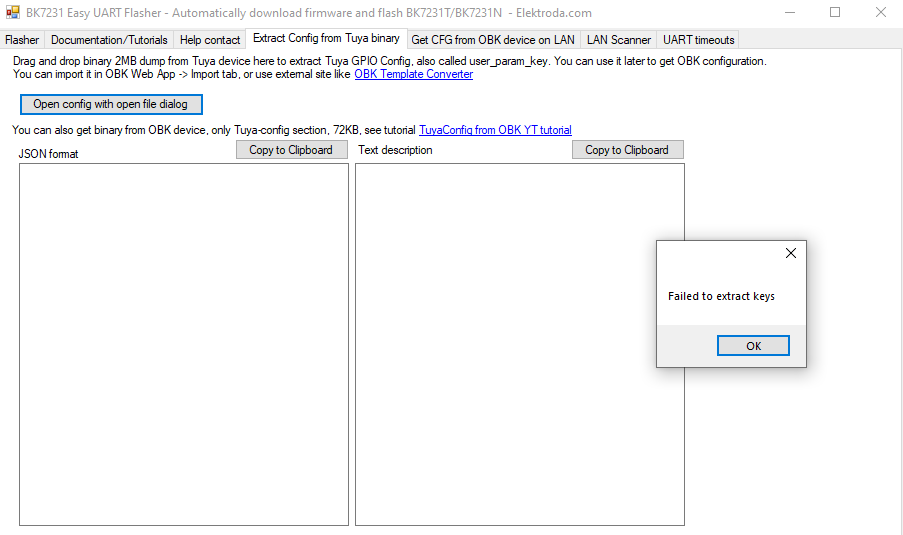

    I used an arduino instead of TTL converter and the baud rate of 115200, I had to manually find GPIOs, dump of tuya`s GPIOs config gave me nothing
    Screenshot of BK7231 Easy UART Flasher application with an error message.

    P.S: I`m not sure about the model, it is written CS-SSRC-IRC on the aliexpress page, but on the board it says CS-IRC-RF V1.3 (you can see on the image)
