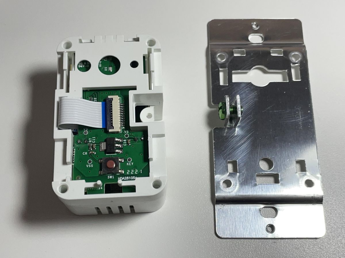

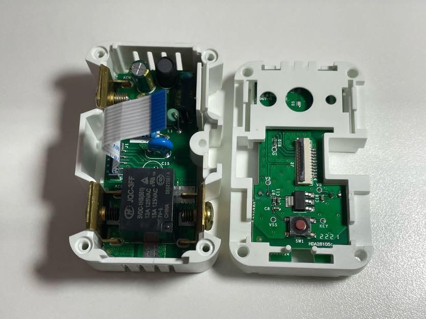

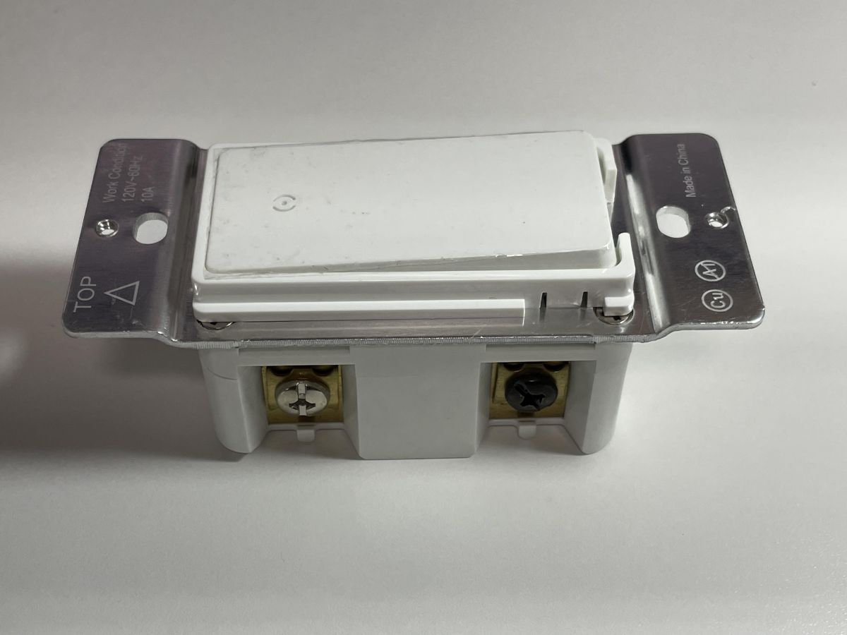

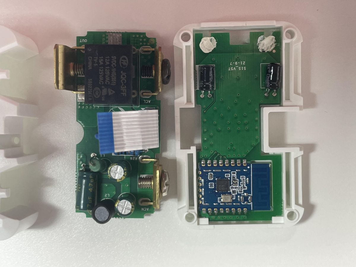

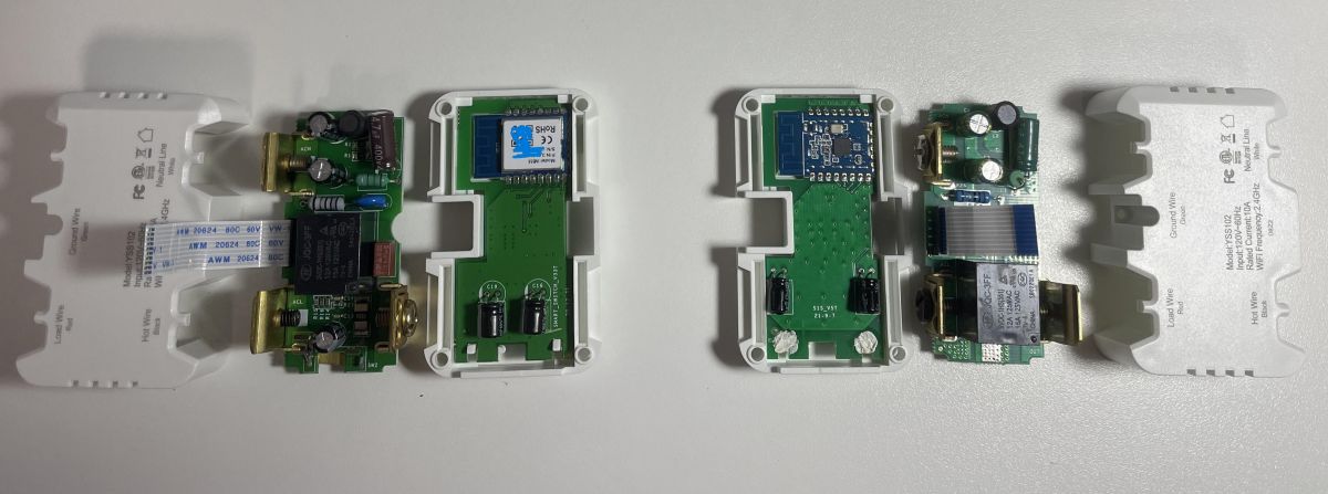

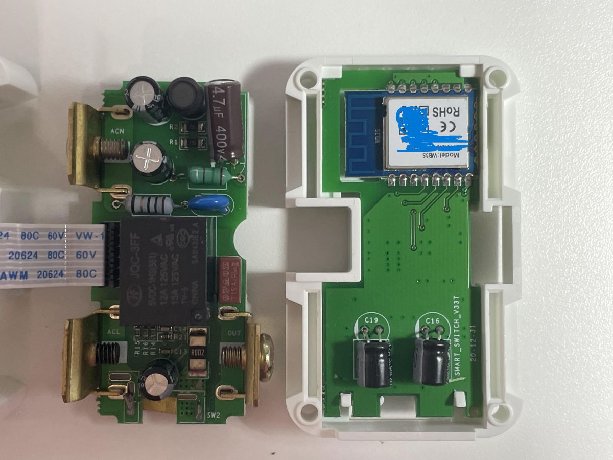

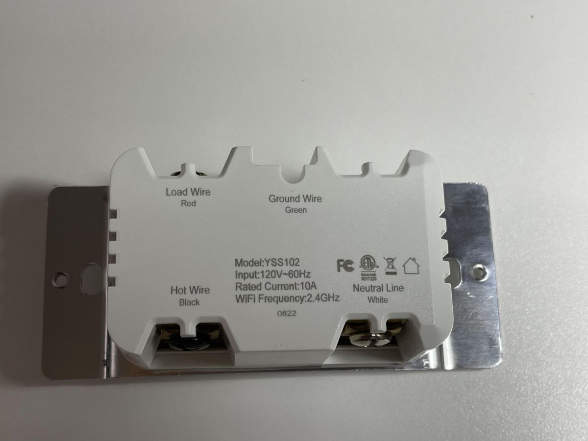

    Getting right into it, I ordered a two-pack and got two different versions of the same switch (in the same box!). Both are labeled as YSS102 - no model number or revision codes I can find. One with a green LED and one with a blue LED. One with a BK7231N and one with a BK7231T.
    Teardown:

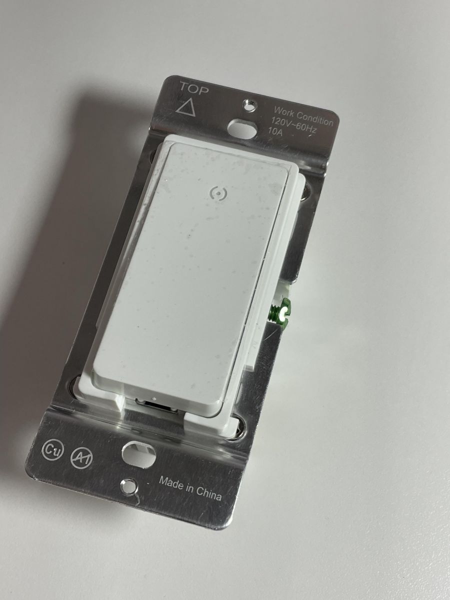

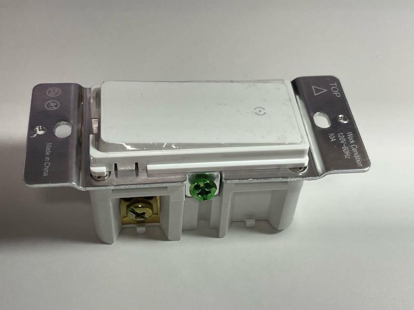

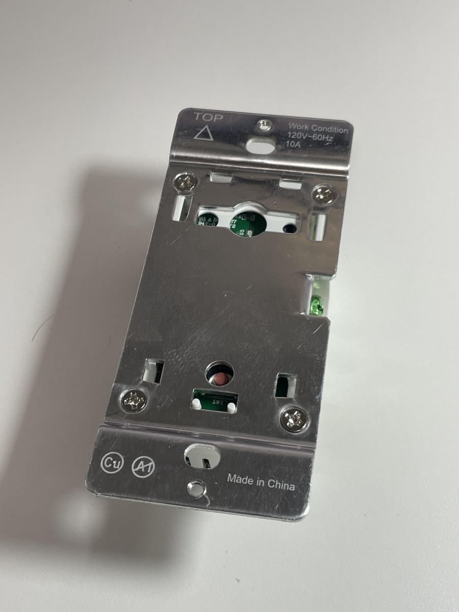

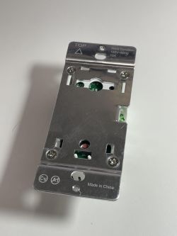

    Not to turn this into a review, but I actually like the form factor - screw terminals instead of tethered wires. Hefty metal grounded frame.
    But there appears to be a provision for another button or cut-off lever which is not used.
    Main Teardown...

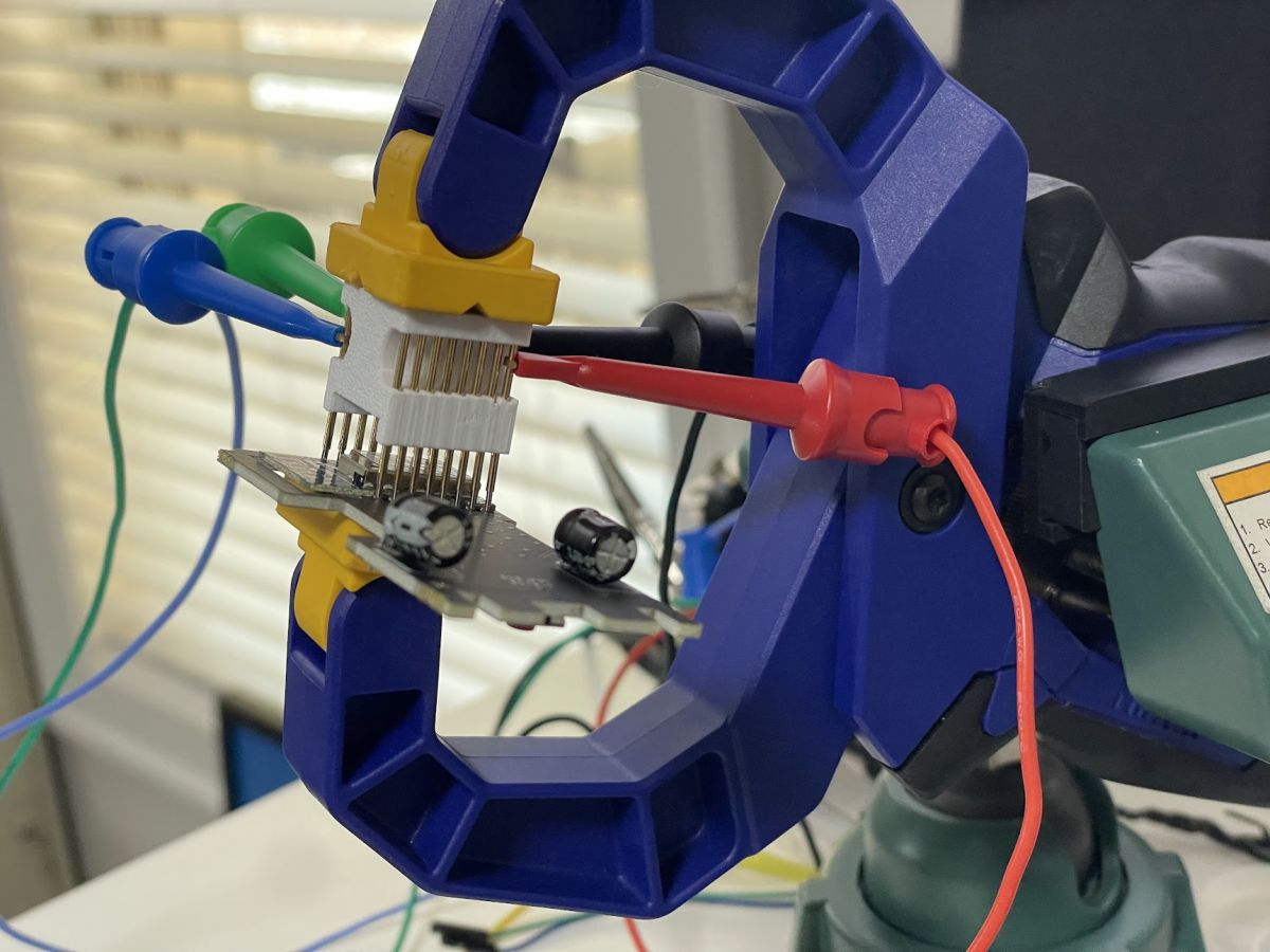

    Flashing
    * Confirmed that CloudCutter works (on the N) module (didn't test on T). But not sure I'd recommend this unless you first open it up and confirm the module.
    * I used a 3d printed pogo-pin flashing jig - worked like a charm
    * shoutout to the latest beta for the flashing app - much smoother than the (admittedly much older) version I'd been using!

    Interesting that the two different models have different pin configurations as well as the swapped out WB3S (BK7231T) and "bare" BK7231N modules.
    WB3S/BK7231T Model (Green LED*)
    1 - Btn - Ch1
    6 - Rel - Ch1
    14 - LED_n - Ch1 <-- this will make LED come on with the load
    BK7231N Model (Blue LED*)
    6 - Rel - Ch1
    7 - LED - Ch1 <-- this will make LED come on with the load
    9 - Btn - Ch1
    * not certain that the LED color will always match the module.
    I'll upload the JSON configs, but not sure how to go about the whole - one serial number, two modules thing :)
    Happy flashing!

    Can you write a few words about that flashing rig with pogo pins? That would make a great article for our tutorials section:
    https://www.elektroda.com/rtvforum/forum517.html
    I am mostly trying to populate it myself, but I do not plan on making a pogo pins adapter soon because I really like to solder, and I still have to resolve the heat creep issue on my Ender 3 Pro again. A step-by-step guide with photos and STLs, also info on where to buy pins, what is the cost, would be a great addition to our community!
    Regarding different templates - well, just post two of them, and I will add both of them to our teardowns list. Thanks!
  • #3 20637744
    mattj
    Posts: 42
    Rate: 16
    I could write something up, but I'd feel like I am plagiarizing. I completely followed this guide here by Digiblur.
    https://digiblur.com/2020/07/16/free-your-sma...soldering-the-tuya-clamp-for-tasmota-esphome/
    Pretty sure I used the exact same files and even the same clamp :) I posted a photo of it in action on my other more recent teardown.
    FWIW, I used a pretty mediocre printer I bought secondhand. I had to manually file things down since the tolerances for the pins were tight. I'll probably end up getting a proper printer later this year.
  • #4 20637795
    Posts: 14677
    Help: 656
    Rate: 12705
    What kind of filament did you use, just a PLA?
  • #5 20637805
    mattj
    Posts: 42
    Rate: 16
    Yep. Nothing special. Just whatever random PLA I had on hand.

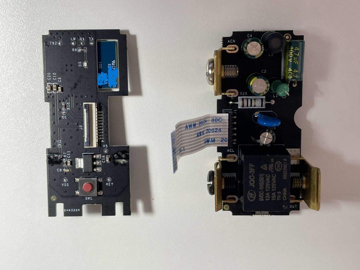

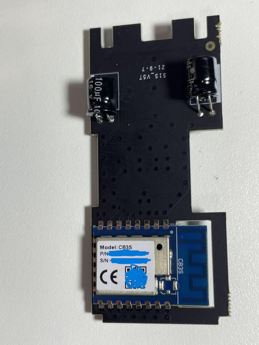

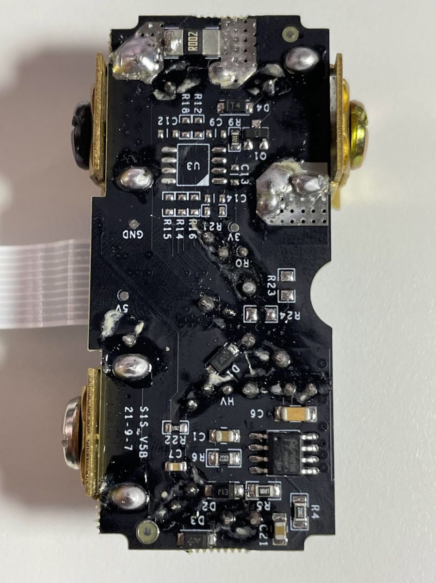

    Update with yet a third version! This time with a CB3S and black PCB.
    Comparative Teardown: Two Versions of YSS102 (Junlit) Single Pole Switch - BK7231N vs BK7231T Comparative Teardown: Two Versions of YSS102 (Junlit) Single Pole Switch - BK7231N vs BK7231T Comparative Teardown: Two Versions of YSS102 (Junlit) Single Pole Switch - BK7231N vs BK7231T Comparative Teardown: Two Versions of YSS102 (Junlit) Single Pole Switch - BK7231N vs BK7231T
    Appears to operate identical to the bare BK7231N board. Also with blue LED.
